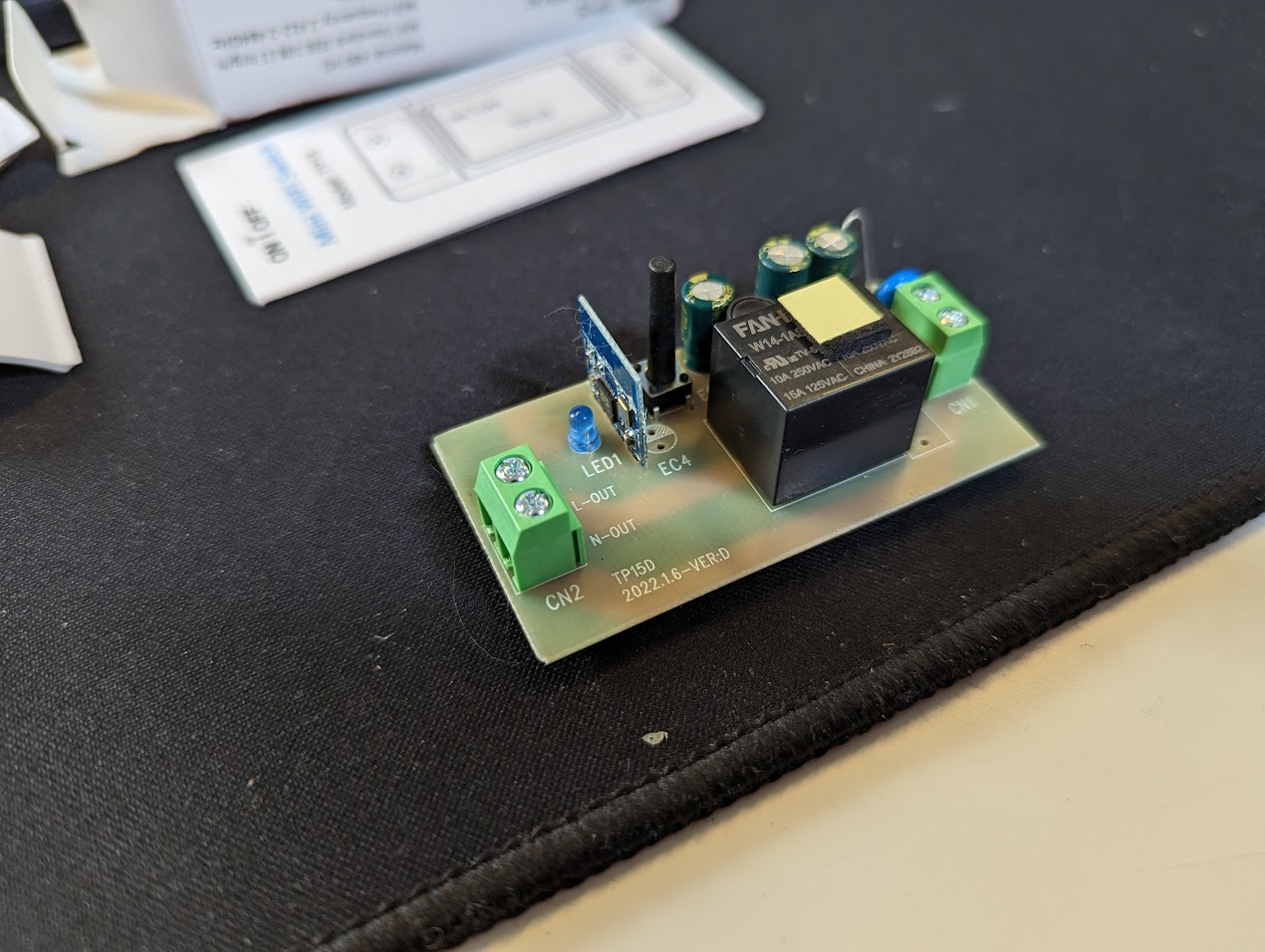

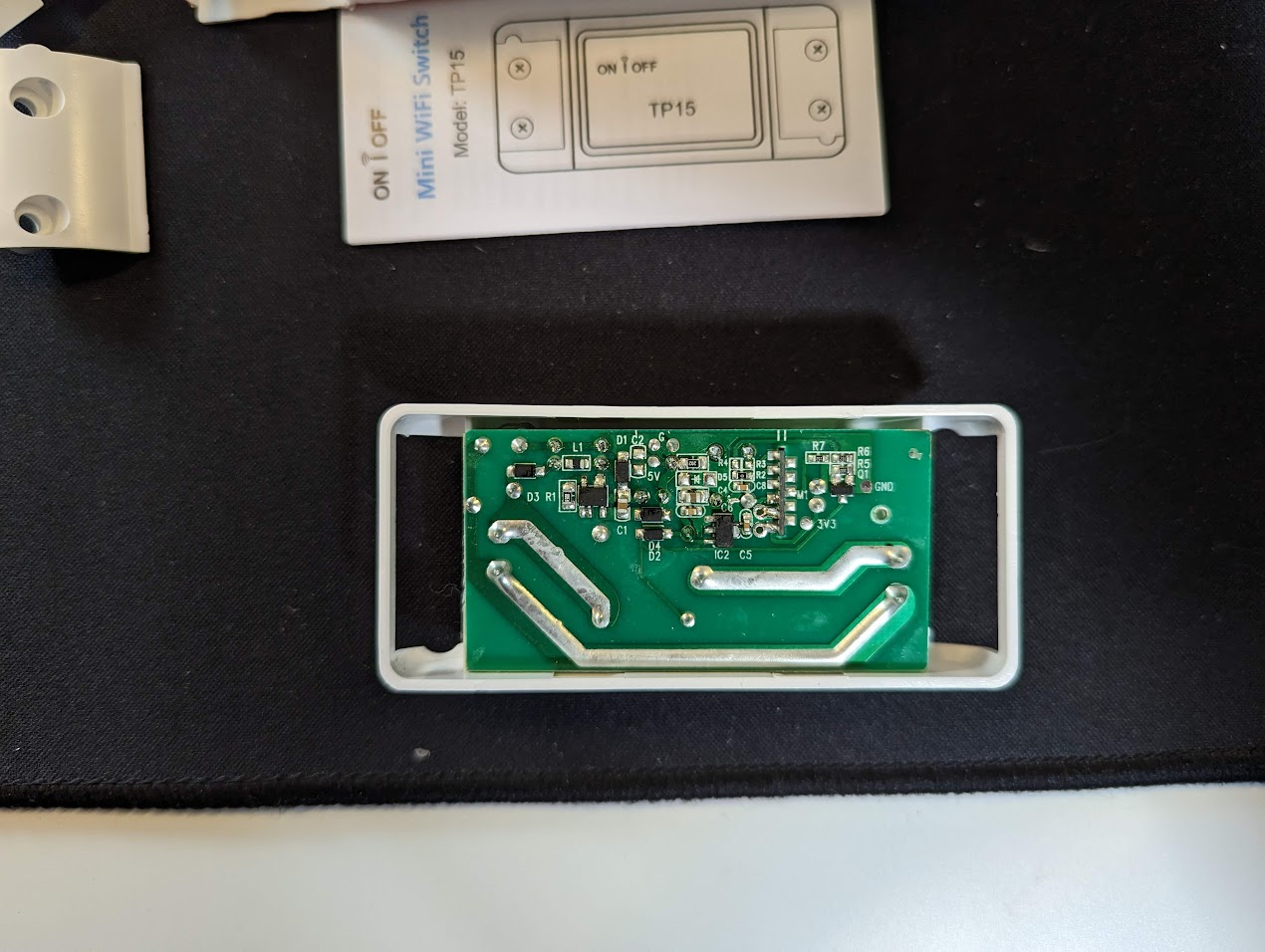

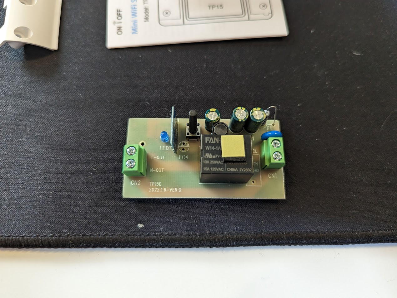

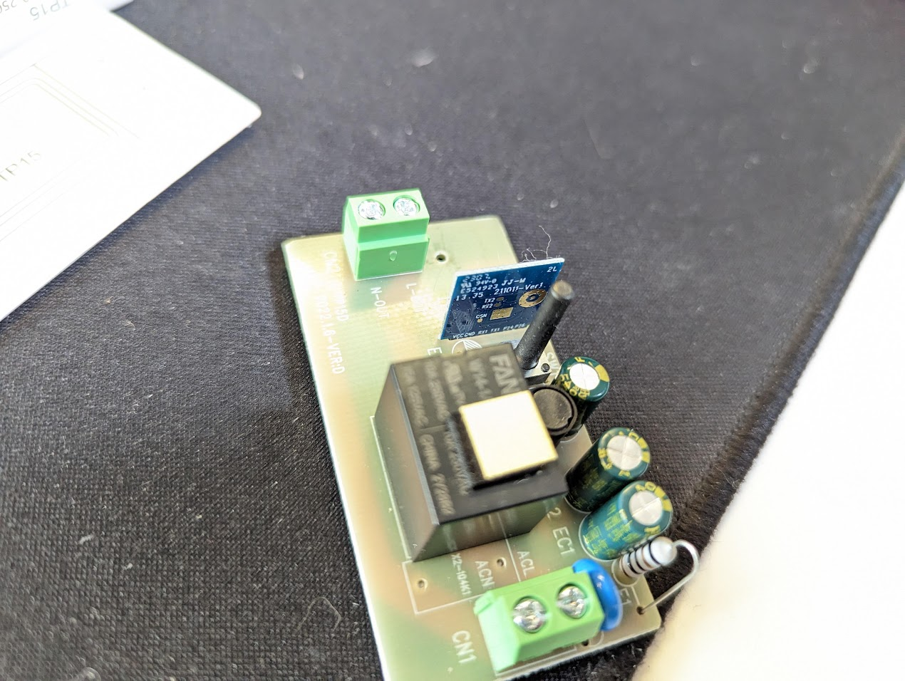

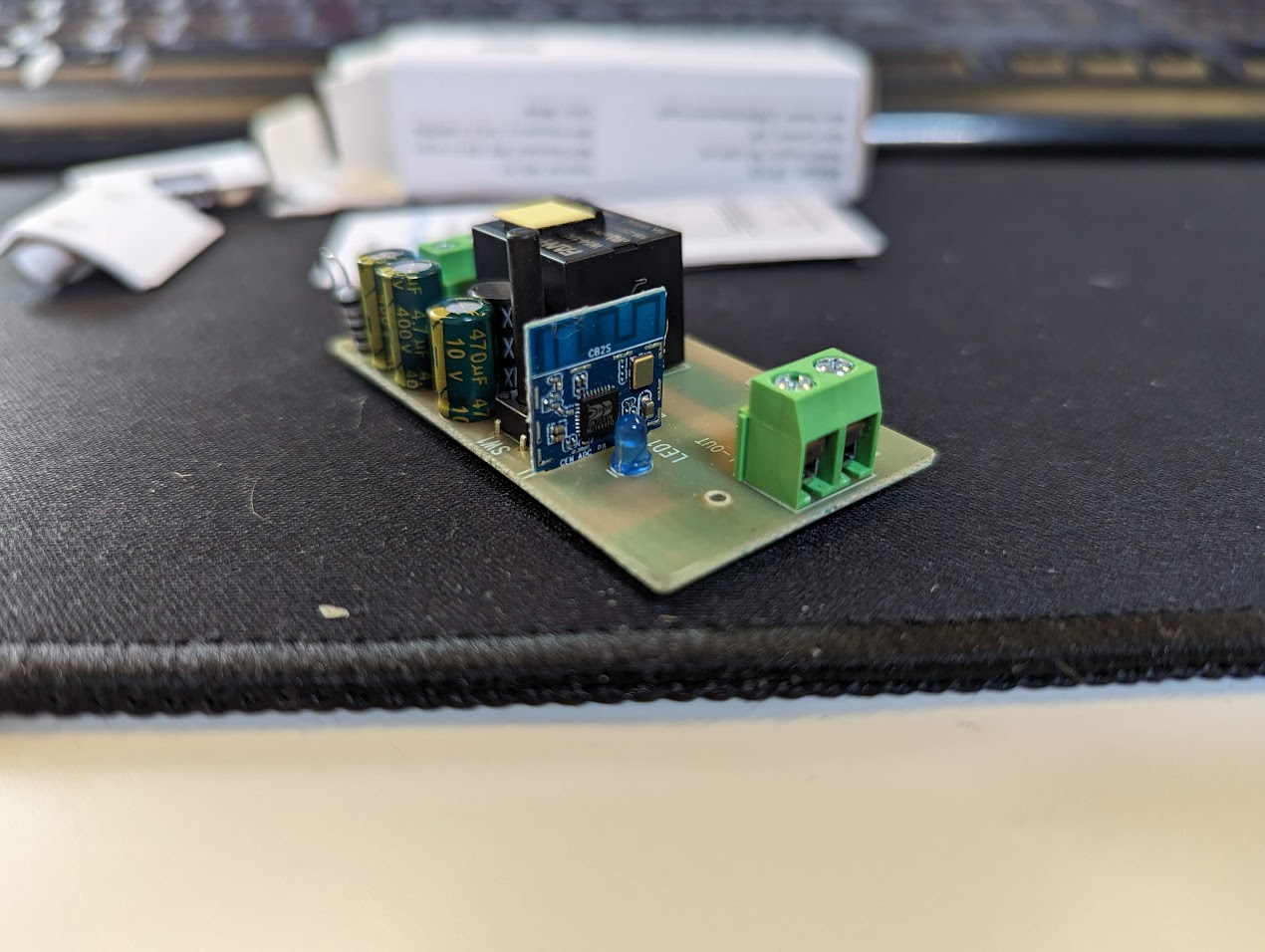

  • Teardown and OpenBK configuration of a TP15 10A 1Channel Breaker Wifi Switch based on BK7231N and CB2S hardware.

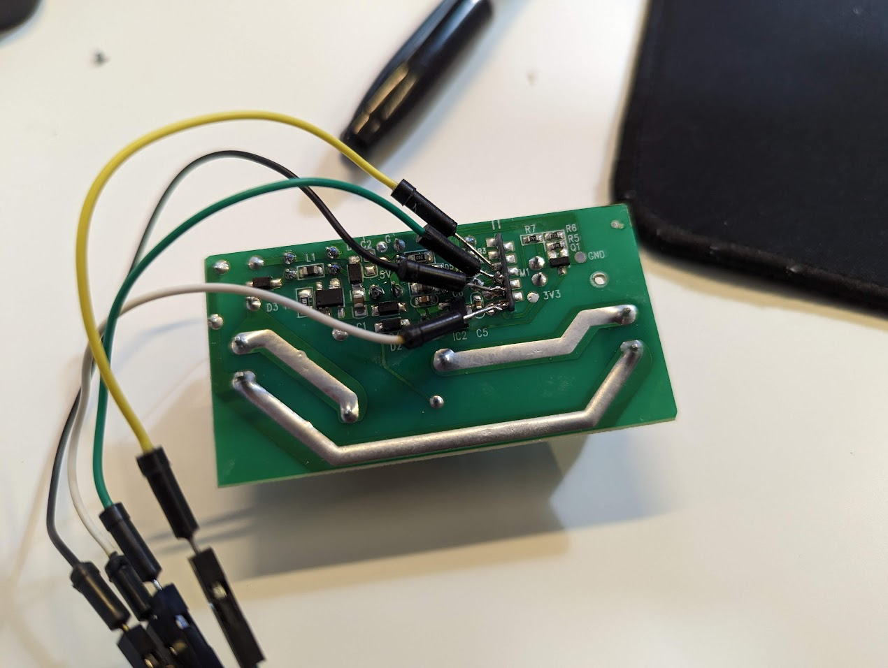

  • Tuya Cloudcutter failed because the correct profile could not be found, so the switch was flashed over serial instead, with the original firmware dump attached.
  • OpenBK pin config uses LED_n 8, Rel 24, and Btn 10.
  • Teardown and config for TP15 10A 1Channel Breaker Wifi Switch
    From recent AliExpress Choice Day sales.
    Couldn't figure out the correct profile to use Tuya Cloudcutter so flashed over serial.
    Original firmware dump attached.
    OpenBK Pin config
    LED_n - 8
    Rel - 24
    Btn - 10
