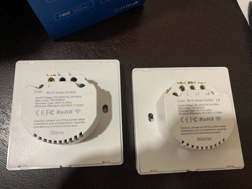

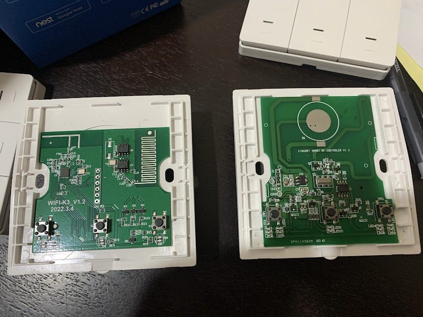

    Teardown Photos:
    Blue packaging of the 2Way Smart Switch. Blue box with barcodes and description in Chinese. Blue box with KingArt Smart Switch product parameters.
    Two white KingArt Wi-Fi switches: one labeled Slave and the other Master. Two white, touch wall switches on a black surface. The image shows two disassembled electronic modules on white casings with visible green printed circuit boards and various electronic components.

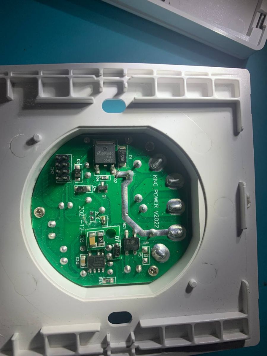

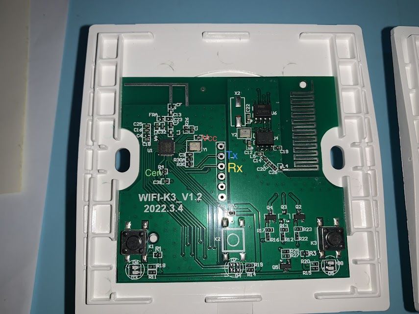

    Image showing a disassembled KingArt touch switch with BK7231N chip.

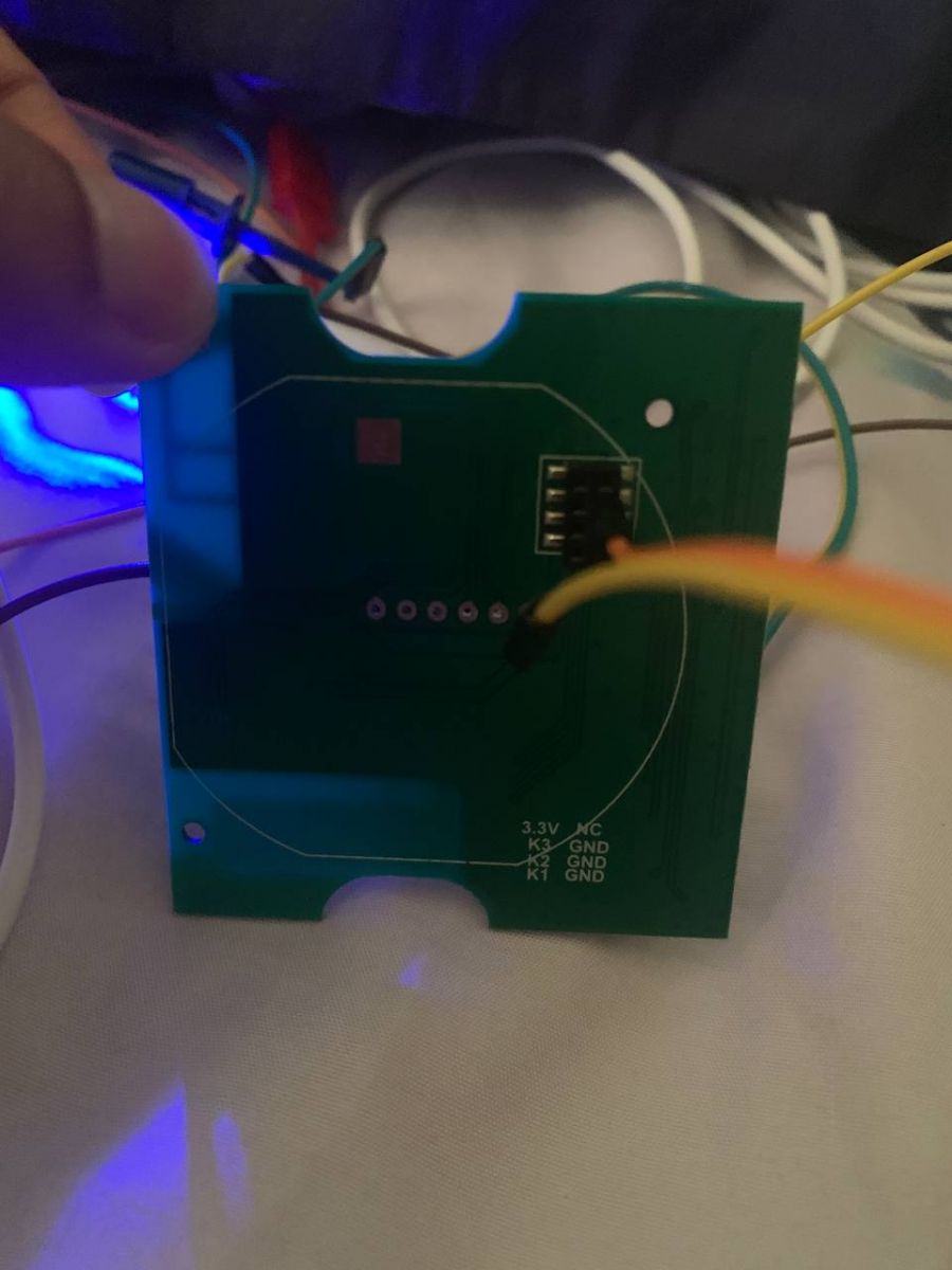

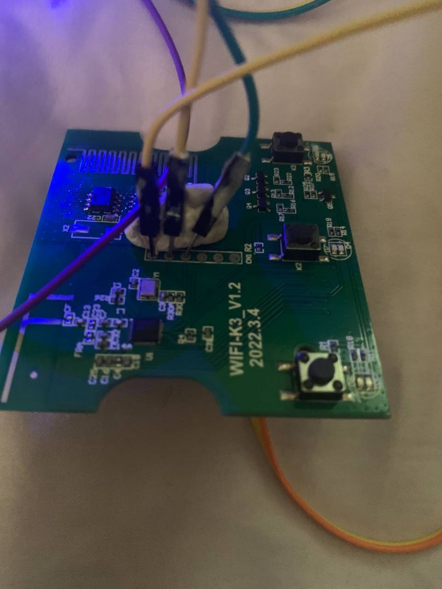

    Flashing:
    Using serial method.
    Wasn't sure which pad is the gnd so I just connect the 2nd female dupont connector on the back
    Internal view of the WiFi-K3 V1.2 circuit board in a white casing.
    Close-up of a printed circuit board assembled on a Wi-Fi device with several connected wires.
    Close-up of a circuit board with pins connected by wires.
    Pinout:
    - Button (channel 1) on P6
    - Relay (channel 3) on P17
    - LED (channel 1) on P8
    - Button (channel 3) on P16
    - LED (channel 3) on P26
    - Relay (channel 2) on P14
    - Button (channel 2) on P9
    - LED (channel 2) on P15
    - Relay (channel 1) on P7

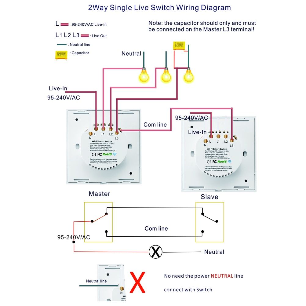

    The slave switch buttons toggles the relay on the master but the leds stays the same (blue color), red led does briefly light when the button is pressed.
    Since this one has dedicated pins for LED, it can be useful for detached mode.
    Capacitor needs to be on L3 on the light fixture for the switch to boot up.
    2-Way Single Live Switch Wiring Diagram
