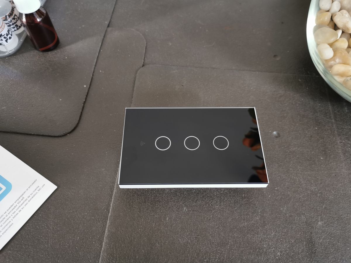

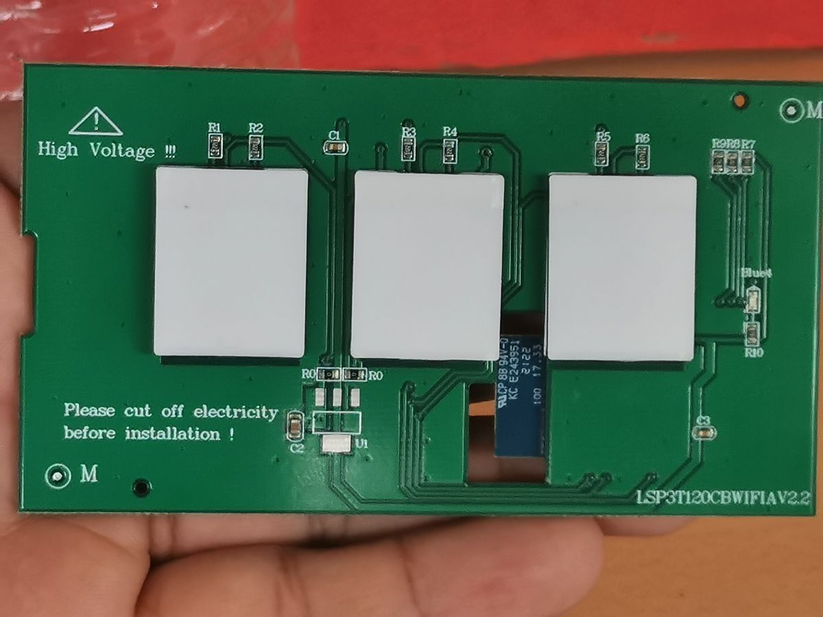

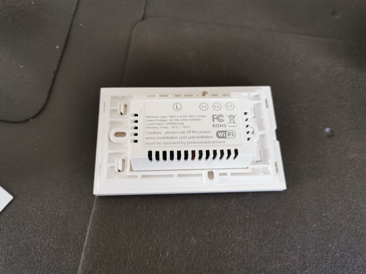

    I just bought a 3-way smart switch with a CB3S chip and I'm planning on flashing it. I have a vague idea of the process after watching several videos and doing some reading. When I disassembled it, I found that instead of relays, it has triacs. My question is whether they can be used as dimmers?.. I would appreciate any help, I've searched this forum and other pages but haven't found a similar device.
    [BK7231N - CB3S] Generic Tuya Wall Switch Touch Buttons 3 Gang No Neutral with Triac Outs [BK7231N - CB3S] Generic Tuya Wall Switch Touch Buttons 3 Gang No Neutral with Triac Outs [BK7231N - CB3S] Generic Tuya Wall Switch Touch Buttons 3 Gang No Neutral with Triac Outs [BK7231N - CB3S] Generic Tuya Wall Switch Touch Buttons 3 Gang No Neutral with Triac Outs [BK7231N - CB3S] Generic Tuya Wall Switch Touch Buttons 3 Gang No Neutral with Triac Outs [BK7231N - CB3S] Generic Tuya Wall Switch Touch Buttons 3 Gang No Neutral with Triac Outs [BK7231N - CB3S] Generic Tuya Wall Switch Touch Buttons 3 Gang No Neutral with Triac Outs [BK7231N - CB3S] Generic Tuya Wall Switch Touch Buttons 3 Gang No Neutral with Triac Outs
  • #2 20567157
    Posts: 14791
    Rate: 12937
    Hello, I don't think that you can convert a non-dimmer device to dimmer that easily. I think triacs are present here because it's a no-neutral device. They must have some kind of mechanism used to power device without neutral wire.
    Still, you can easily use it as a simple on/off light controller.

    Hello @armcamberos, I got the same model of switch. Did you successfully flash it? If so, could you share the pinout for buttons and outputs?
  • #6 20626159
    Posts: 14791
    Rate: 12937
    Hello @dead2112, we can extract GPIO from Tuya binary if you do a 2MB backup.

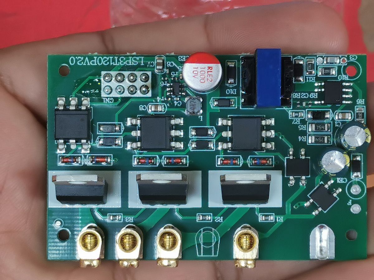

    The device is working correctly. The switch stays blue if the light is OFF and red if the light is ON.
    Can this light be switched? I find it more comfortable as red: OFF and blue: ON.
    I have already downloaded the Tuya GPIO config, but I can't figure it out.
  • #9 20632487
    Posts: 14791
    Rate: 12937
    You can invert LED roles by switching LED to LED_n or WifiLED to WifiLED_n. This, of course, works only if LED is on the separate GPIO.
    If your device has LED on the same GPIO as the relay, then it's impossible to switch LED via software. You would have to do the hardware hack.
  • #10 20633109
    dead2112
    Posts: 10
    Apparently the LED is in the same GPIO as the relay. Setting Rel_n also changes the LED color.
  • #11 20633174
    Posts: 14791
    Rate: 12937
    So you can change it only if you can solder and route some jumper wires.

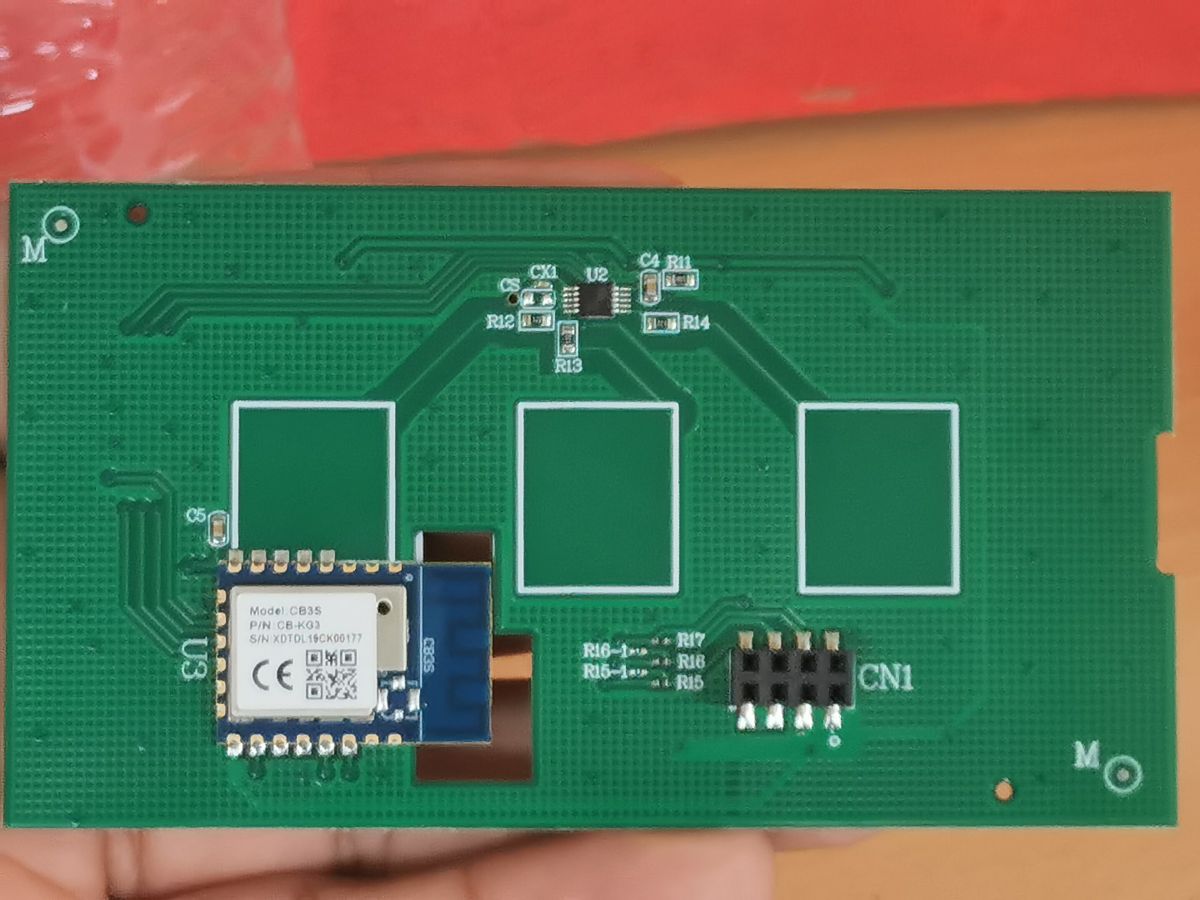

    I got the firmware dump from the OpenBK web app and put it in the BK7231GUIFlashTool to get the config:
    JSON:
    	"rl1_lv":"1",
    	"netled_lv":"0",
    	"bt_type":"0",
    	"bt1_pin":"14",
    	"rl3_pin":"9",
    	"rl3_lv":"1",
    	"rand_dpid":"18",
    	"net_trig":"2",
    	"cd_flag2":"1",
    	"led_dp":"15",
    	"jv":"1.0.0",
    	"backlit_select":"0",
    	"nety_led":"1",
    	"netled_pin":"6",
    	"total_stat":"2",
    	"bt3_lv":"0",
    	"bt1_lv":"0",
    	"reset_t":"5",
    	"rl2_lv":"1",
    	"ch_flag1":"1",
    	"ch_flag3":"1",
    	"inch_dp":"19",
    	"module":"CB3S",
    	"bt3_pin":"24",
    	"ch_cddpid1":"7",
    	"init_conf":"14",
    	"rl2_pin":"8",
    	"light_status_select":"0",
    	"bt2_pin":"26",
    	"ch_cddpid2":"8",
    	"ch_cddpid3":"9",
    	"backlit_dp":"16",
    	"cyc_dpid":"17",
    	"ch_num":"3",
    	"bt2_lv":"0",
    	"rl1_pin":"7",
    	"ch_dpid3":"3",
    	"netn_led":"0",
    	"ch_dpid1":"1",
    	"ch_dpid2":"2",
    	"crc":"111"
    Text Description:
    - Button (channel 1) on P14
    - Relay (channel 3) on P9
    - WiFi LED on P6
    - Button (channel 3) on P24
    - Relay (channel 2) on P8
    - Button (channel 2) on P26
    - Relay (channel 1) on P7
    Device is working fine, it is a shame you can't control the LED with software, but it is a minor thing.
