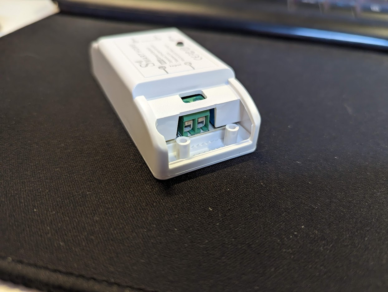

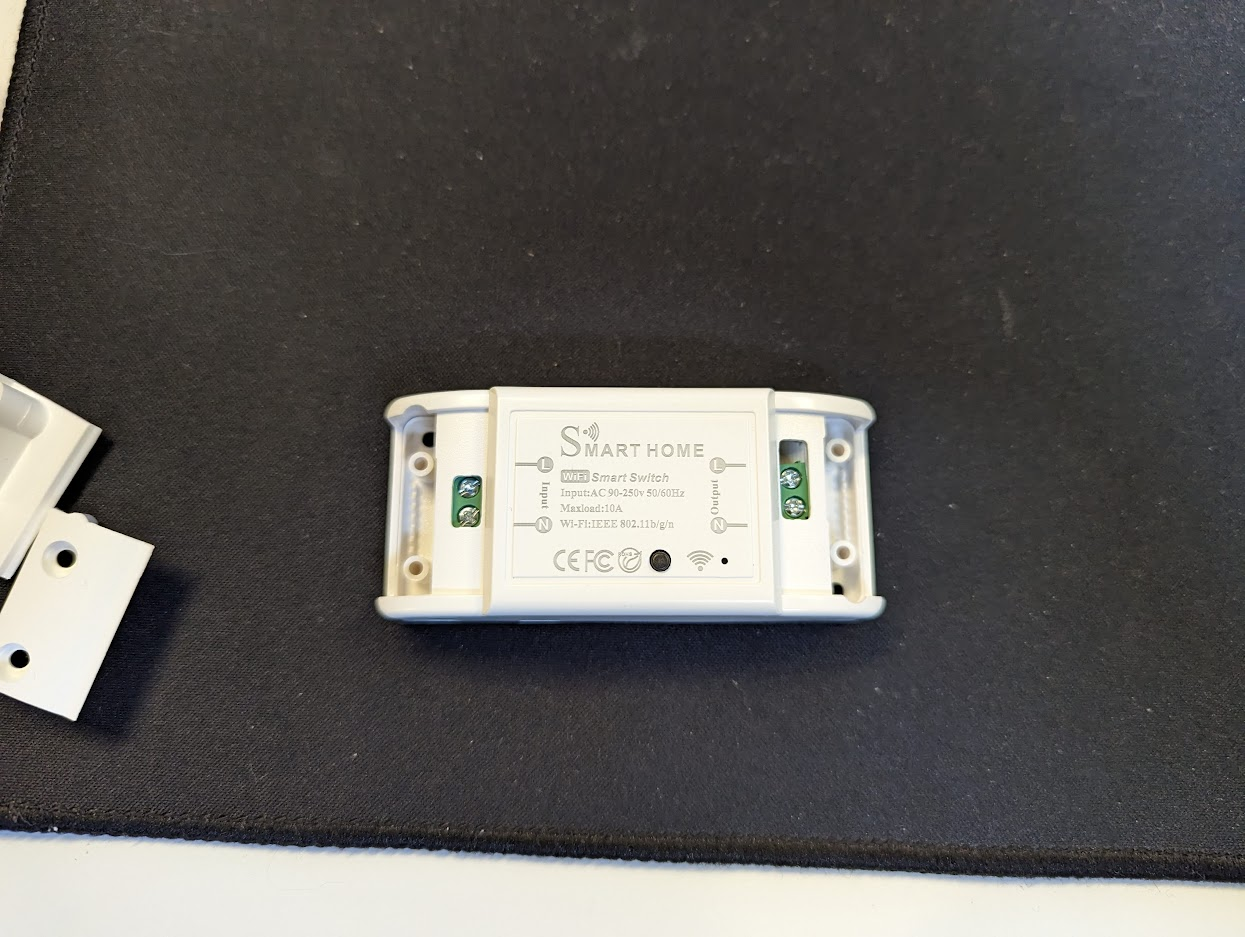

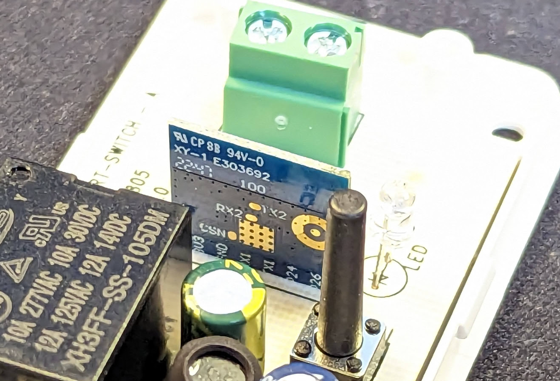

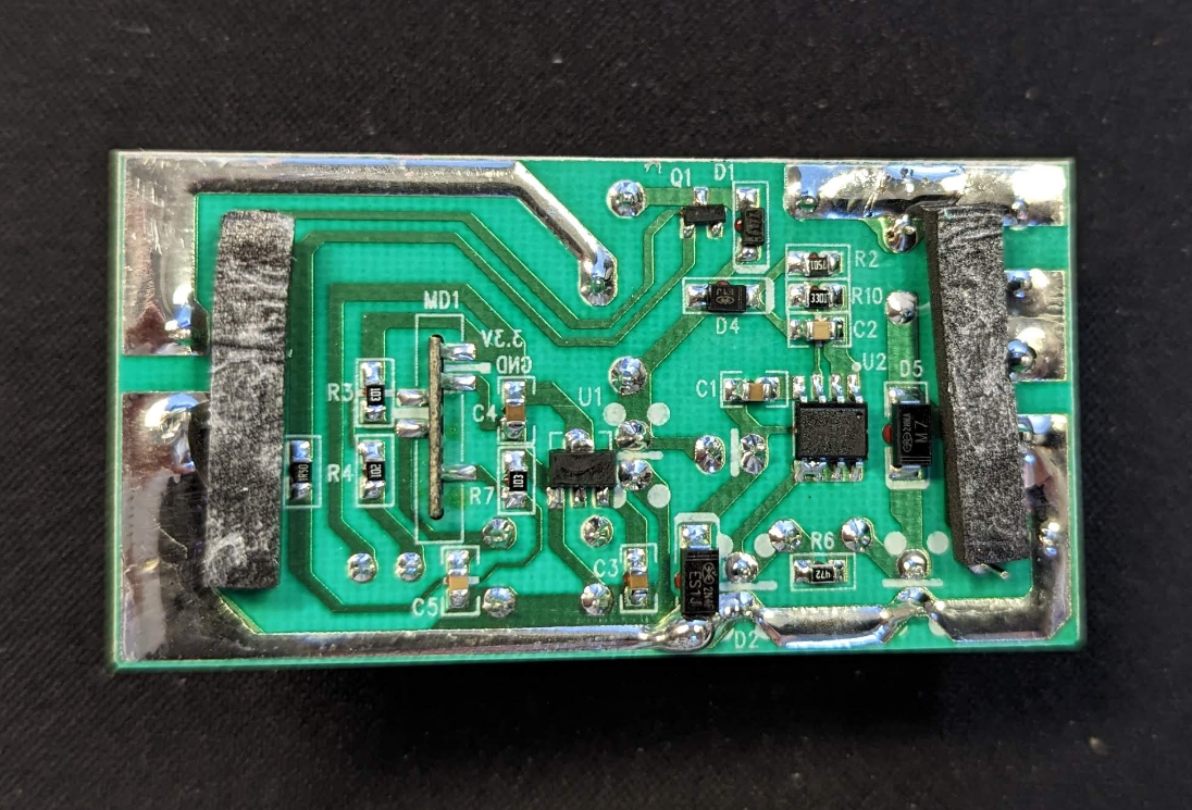

    Teardown and config for Smart Home Wifi Smart Switch 10A - 1 gang
    From recent AliExpress Choice Day sales.
    Used tuya-cloudcutter to flash OpenBK (didn't even set up in SmartLife app - just went straight to cloudcutter)
    These cloudcutter settings allowed the exploit
    > By firmware version and name
    > 1.2.1 - BK7231N / oem_bk7231n_control_switch
    > Aubess
    > 16A Mini Smart Switch
    Pin config
    LED_n - 7 - ch1
    Rel - 24 - ch1
    Btn - 8 - ch1
    Photos of teardown
    Teardown, Configuration, and OpenBK Flashing of BK7231N CB2S 10A 1-Gang Smart Switch Teardown, Configuration, and OpenBK Flashing of BK7231N CB2S 10A 1-Gang Smart Switch Teardown, Configuration, and OpenBK Flashing of BK7231N CB2S 10A 1-Gang Smart Switch Teardown, Configuration, and OpenBK Flashing of BK7231N CB2S 10A 1-Gang Smart Switch Teardown, Configuration, and OpenBK Flashing of BK7231N CB2S 10A 1-Gang Smart Switch Teardown, Configuration, and OpenBK Flashing of BK7231N CB2S 10A 1-Gang Smart Switch Teardown, Configuration, and OpenBK Flashing of BK7231N CB2S 10A 1-Gang Smart Switch Teardown, Configuration, and OpenBK Flashing of BK7231N CB2S 10A 1-Gang Smart Switch Teardown, Configuration, and OpenBK Flashing of BK7231N CB2S 10A 1-Gang Smart Switch Teardown, Configuration, and OpenBK Flashing of BK7231N CB2S 10A 1-Gang Smart Switch Teardown, Configuration, and OpenBK Flashing of BK7231N CB2S 10A 1-Gang Smart Switch
