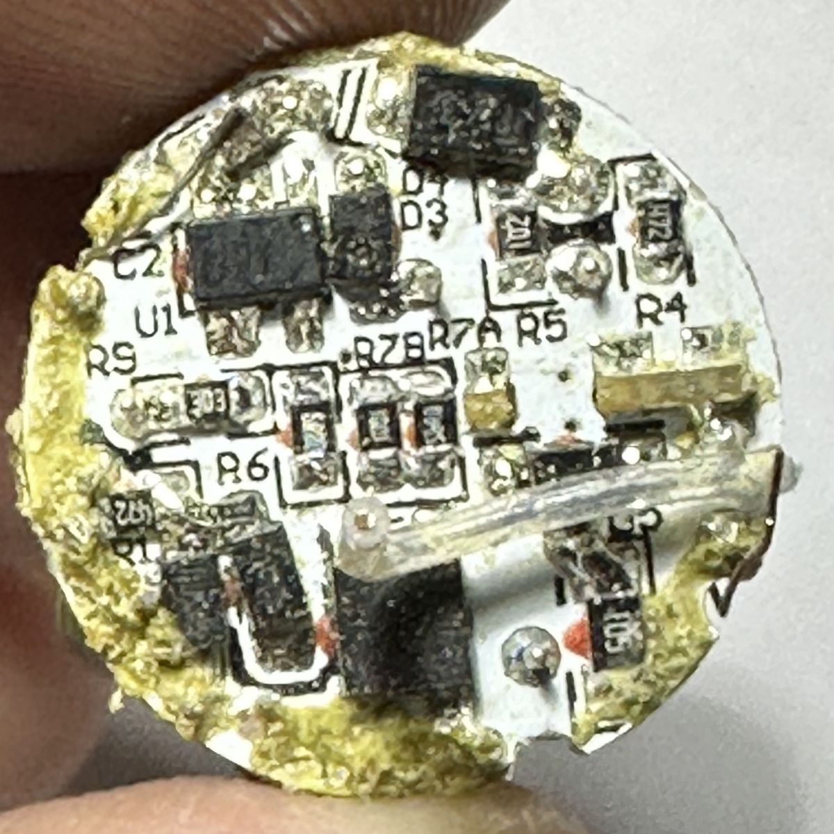

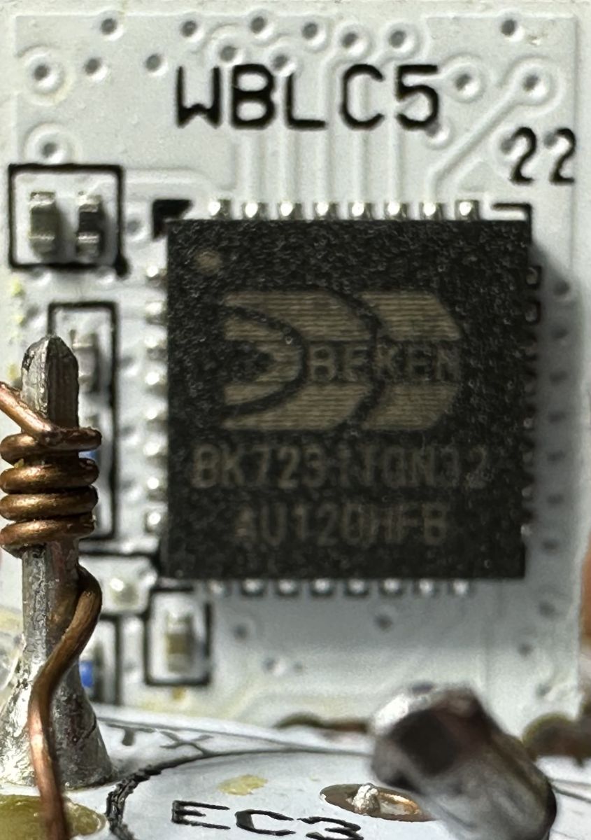

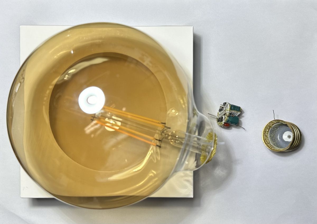

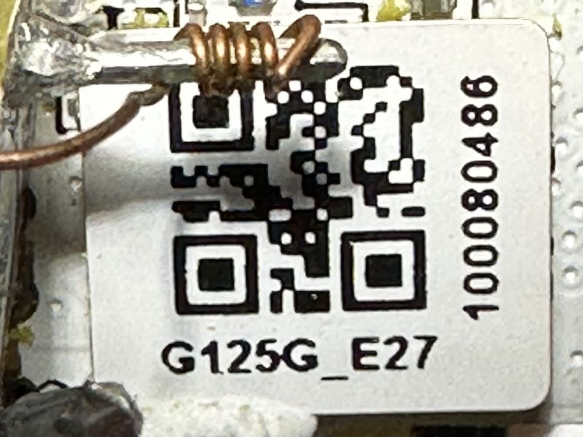

  • Hello everybody,
    This is my first teardown of a bulb that I would be happy to "cloudcut" ... :)
    (Below you'll find the pictures I took from the teardown)
    Manufacturer: LEDVANCE
    Model: Filament Globe 125 53
    Socket: E27
    Luminous flux: 680 lm
    Power: 6W
    Board: Beken 7231T
    WiFi-Module: WBLC5
    I am not sure: what would be the next steps to get a pull request to the TUYA cloud cutter?
    Any help would be really appreciated -
    thank you!

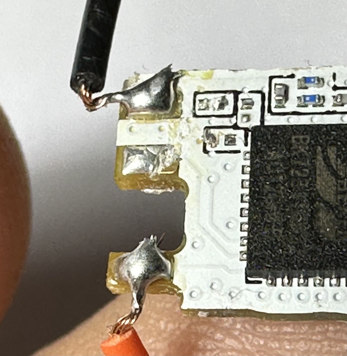

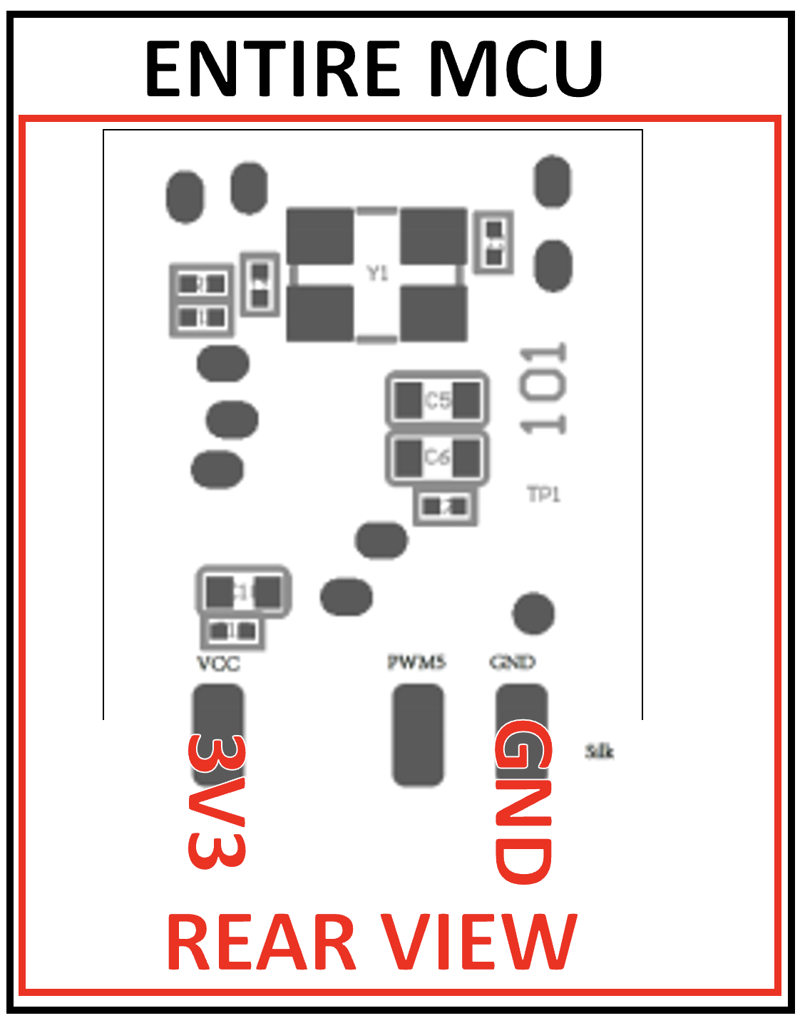

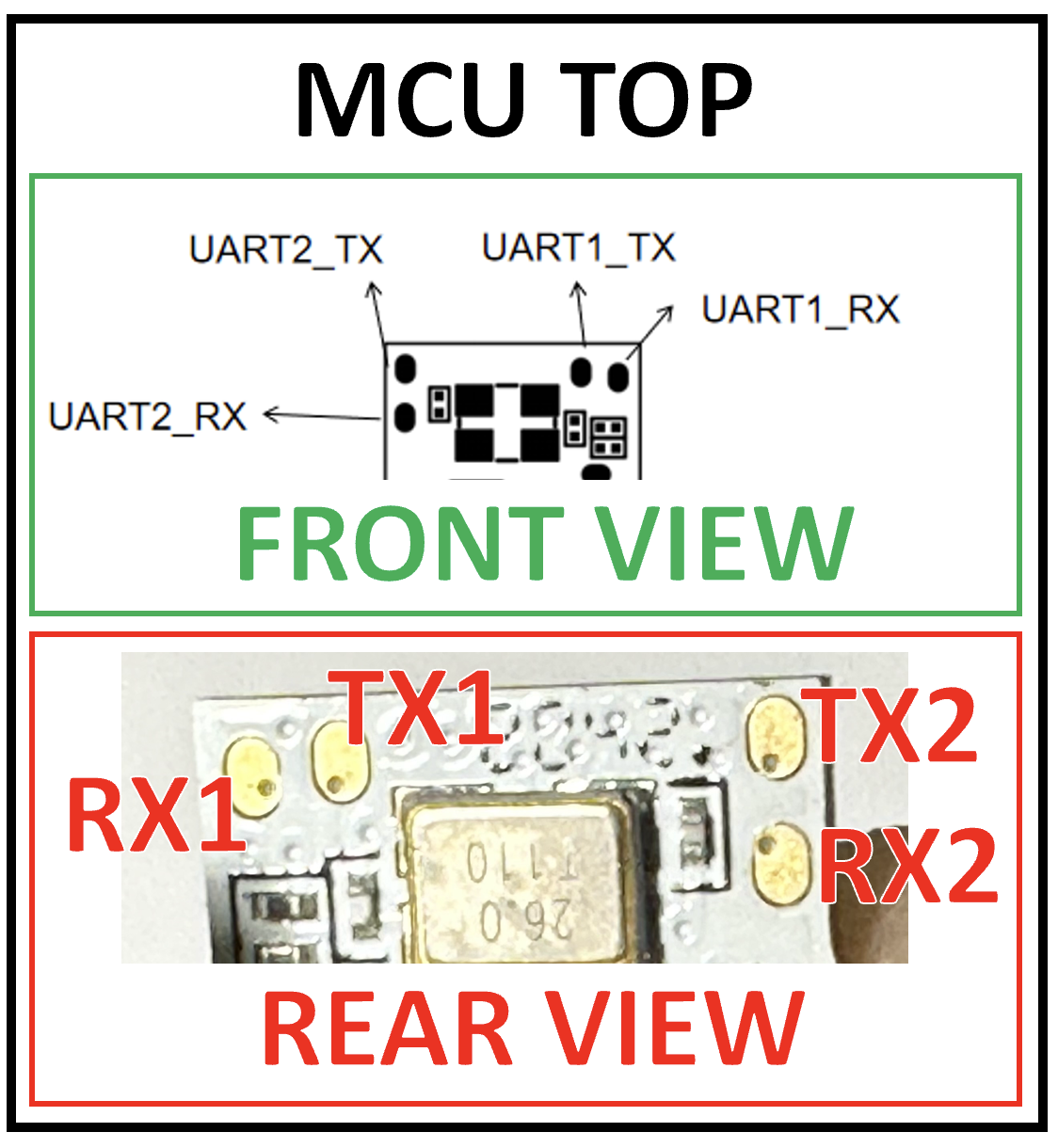

  • Clarifying whether to use RX/TX 1 or 2
    #3 20884501
    gramais
    Posts: 48
    Hi P.!
    Piotr? or Patryk?
    Hm, I realize I´m really old fashioned: feels somehow strange to me talking to someone without knowing his name....
    In any case, thank you for your answer !
    Now, according to this description I hope I could figure out the soldering tips correctly (see pics below), but I am not sure whether to use RX/TX 1 or 2: do you have any idea?
    gramais
    Rear view diagram of a microcontroller with labeled components. Diagram of the microcontroller top with UART labels and rear view.
  • UART1 for flashing, UART2 for debug logs
    #4 20884687
    Posts: 14797
    Rate: 12954
    I think you may have got it right at the first try. Regarding the UART port - well, you should check our YT channel for detailed flashing process presentations:
    You can also check our flash tool docs/readme:
    But to answer your question, always UART 1 (RX1/TX1) port is used for flashing. The UART2 is used for debug log output.
    Just please, remember to make 2MB backup first, so first do "read" operation, not "write"!

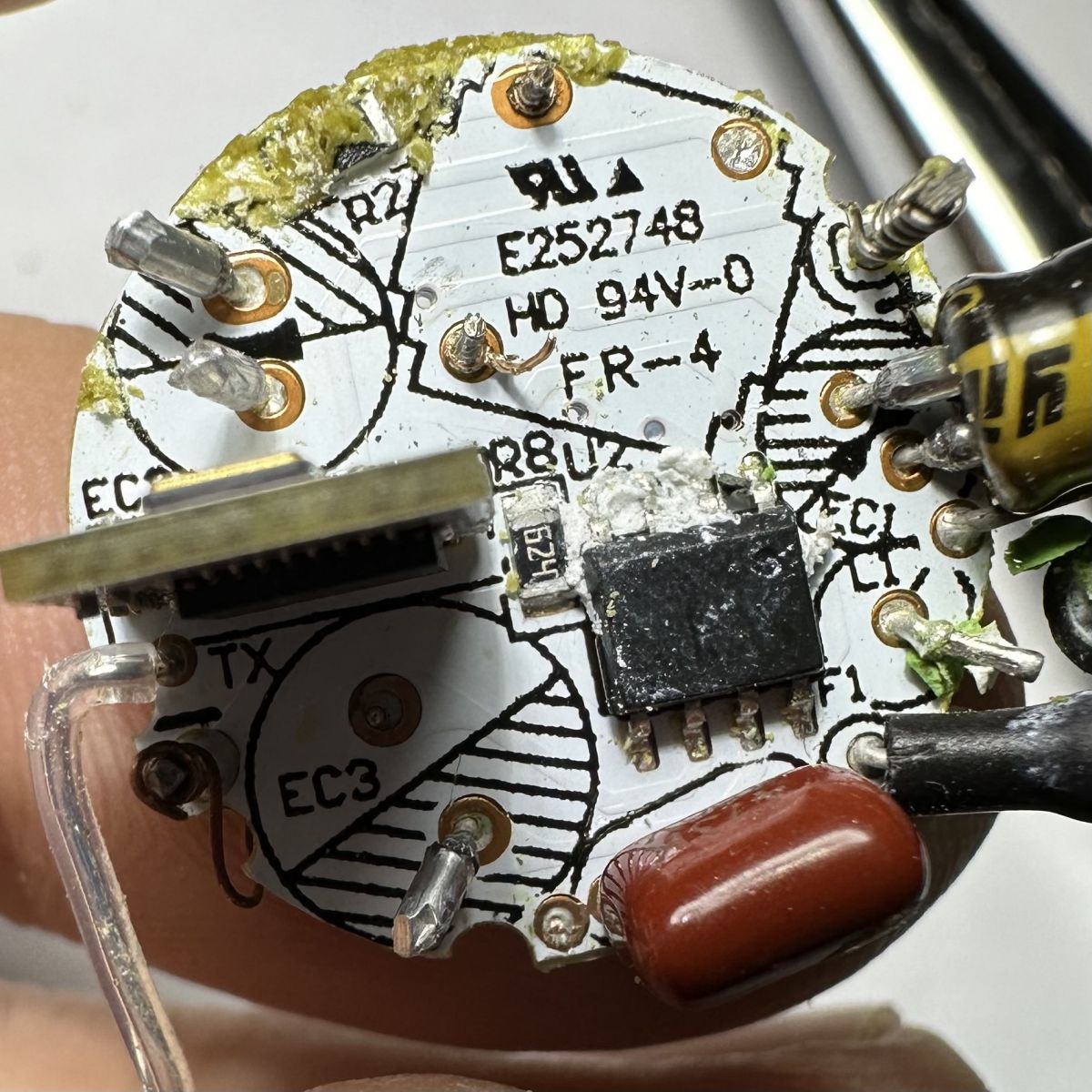

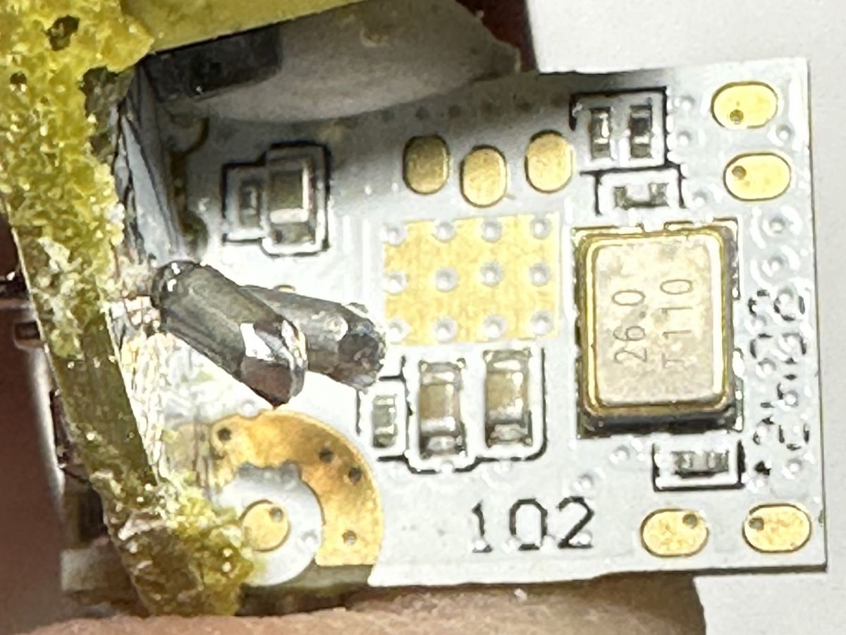

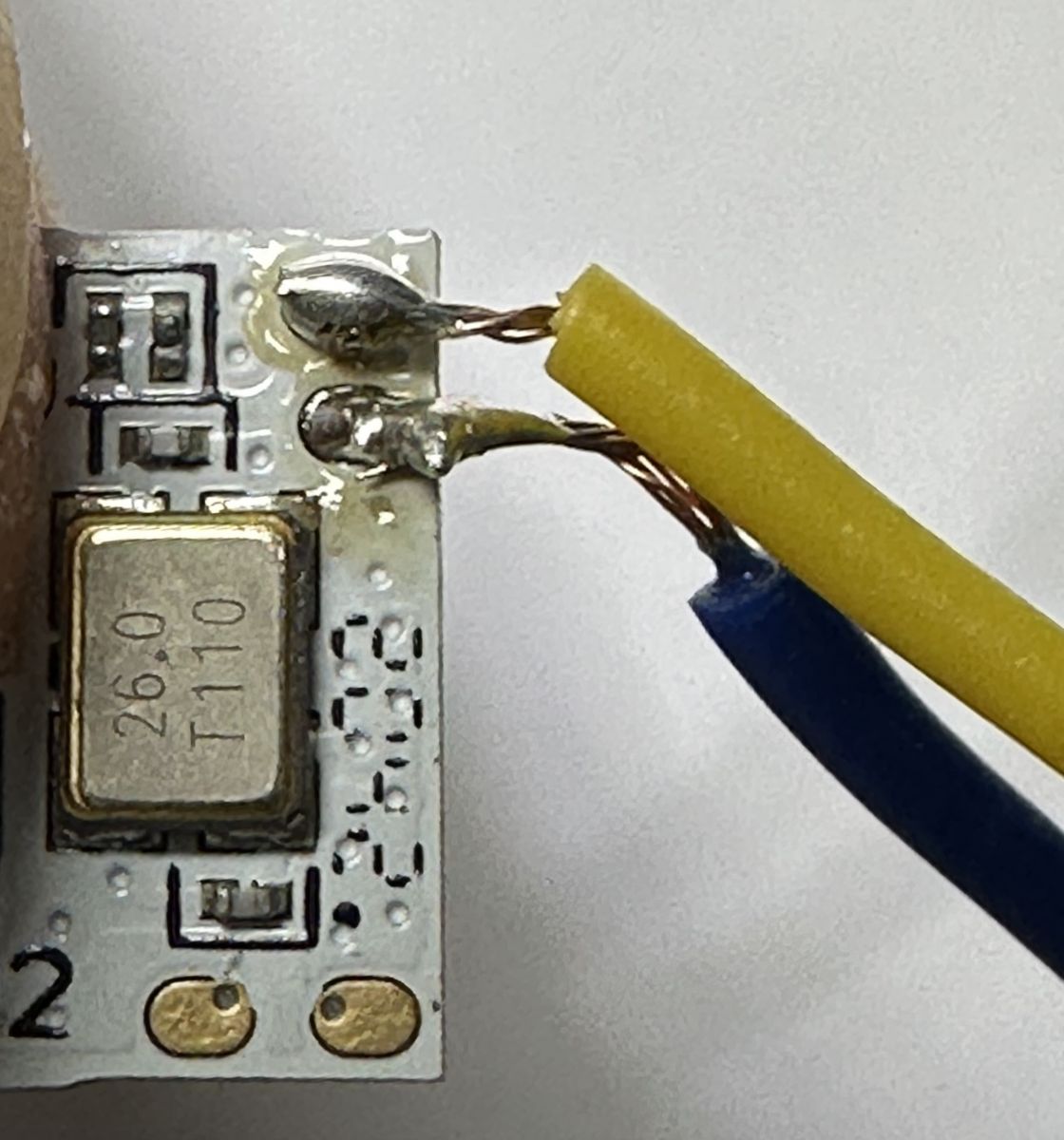

  • Request for wiring check after UART downloader fails
    #5 20887318
    gramais
    Posts: 48
    Okay, so I started the first attempt - unfortunately without success :(
    I double-checked everything and swapped RX/TX to be on the safe side, but maybe you could take another look: the photos are below.
    I tried it via PINs 8=TX, 10=RX, 17=3V3, 25=GND of the GPIO port (/dev/ttyAMA0) and alternatively via a USB-UART converter (/dev/ttyUSB0).
    python3 uartprogram firmware.bin -d /dev/ttyUSB0 -r
    resp.
     python3 uartprogram firmware.bin -d /dev/ttyAMA0 -r
    or
    python3 uartprogram firmware.bin -d /dev/ttyUSB0 -r -s 0x0 -l 0x200000 -b 115200
    resp.
     python3 uartprogram firmware.bin -d /dev/ttyAMA0 -r -s 0x0 -l 0x200000 -b 115200
    The program waits indefinitely for a response via the GPIO port:
    UartDownloader....
    Read Getting Bus...
    Via USB I get this error message:
    Cannot get bus.
    Traceback (most recent call last):
     File "/home/kay/hid_download_py/uartprogram", line 56, in <module>
       downloader.read(args.filename, args.startaddr, args.length)
     File "/home/kay/hid_download_py/bkutils/uart_downloader.py", line 83, in read
       self.pbar.close()
    AttributeError: 'NoneType' object has no attribute 'close'
    I interrupted the 3V3 again and again to achieve a reset.
    Any ideas? Do you notice anything wrong with the wiring in the photos?
    Close-up of a small PCB with attached colored wires. Close-up of a circuit board with attached yellow and blue wires. Close-up of solder connections on a circuit board.
    ... and before you ask: I have no access to a windows computer for the GUI, just a RaspberryPi and Mac with the same results shown above. ;)
  • #6 20887424
    ferbulous
    Posts: 419
    Help: 8
    Rate: 56
    Hi, how did you remove the bottom screw without breaking the glass?
    Is the stock tuya firmware patched?
  • #7 20887538
    Posts: 14797
    Rate: 12954
    How do you power it, how long are the wires, what kind of USB to UART converter? Have you tried swapping RX and TX?
  • Heated socket off and confirmed UART wiring details
    #8 20887621
    gramais
    Posts: 48
    Hey @ferbulous, I heated the socket with a heat gun until I could simply twist it off...
    I had imagined it would be more difficult, but then it went very easily.
    And as for the firmware patch: no idea, how do I find out?

  • #9 20887860
    Posts: 14797
    Rate: 12954
    Those wires seem very long. Futhermore, your USB to UART converter does not look like the one that can provide enough current for flashing. Use a better 3.3V source and shorten your wires. Have you watched our tutorials?

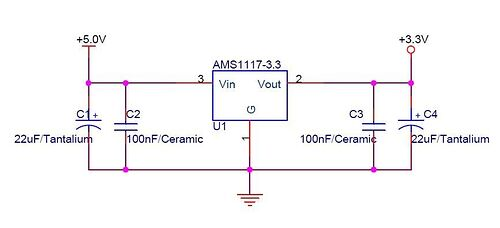

    Well, to be precise, it's 100nF, I assume, not 100pF. That pF is probably a mistake on Darkman's side. Still, the value is not critical and should be on board already.
    Sample circuit:
    Circuit diagram of AMS1117-3.3 voltage regulator with capacitors.

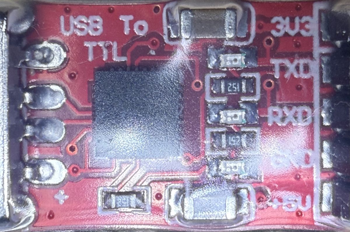

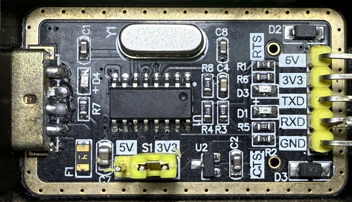

  • Comparing USB-UART adapters and AMS1117 capacitor codes
    #17 21651648
    gramais
    Posts: 48
    >>21651380
    So, these are the two USB-UART adapters I have: from a technical point of view, one looks better than the other. I'm sure you've already gained some experience: or is one the same as the other?
    USB to UART converter board with visible pins and electronic components.
    Close-up of a USB to TTL converter module on a red PCB with labeled signal connections and components.

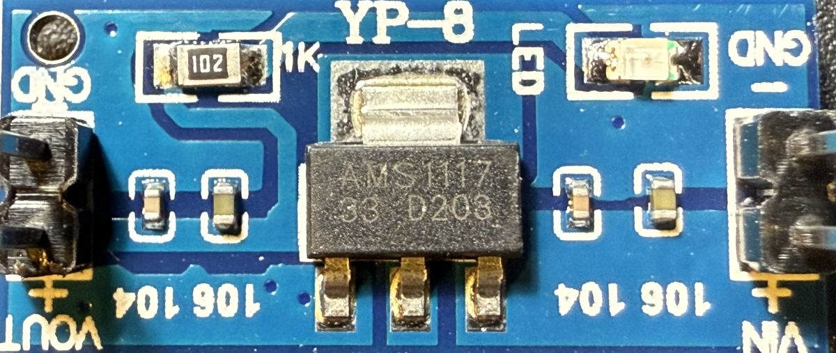

    And finally, my AMS1117. But I'm not sure why there are two codes on each side:
    Voltage regulator module with AMS1117-3.3 chip on a blue PCB
    104 = 100nF and (at the same time?)
    106 = 10 µF
    Can that be right?
