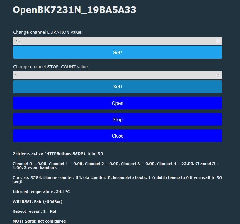

  • OpenBeken pin map and autoexec for Teekar curtain switch
    #4 21236706
    formeTA
    Thank you for showing the details.
    Based on your Input I flashed a Teekar Smart touch curtain switch the same way (cutting Pin 16 and after flashing with openbk resolder the pin).
    I found various possible pin and autoexec.bat files for this CB3S Board with BK7231N Chip.
    Right know I use a part from the template from P.Kaczmarek2 for the pin setup.
    And the autoexec.bat from (Etersky) Wifi Roller Curtain Shutter Switch (WF-CS01) in the openbeken database.
    Code: Arduino
    I changed some data in autoexec.bat to meet the pin setup with the result, that I am able to
    open
    close
    stop
    curtain action via http.
    I am struggeling with the hard buttons on the switch. When I press
    open - > it does stop
    stop -> it does down
    down -> is does up
    The LED´s are mixed up also.
    I need some help to get the right setup for the hard buttons and for the led´s. I already searched the forum but couldn´t find a hint.
    Any support is appreciated. Thank you in advance.
    OpenBK7231N user interface with three curtain control buttons: Open, Stop, Close.
    @ElektrodaBot

  • #6 21241604
    formeTA
    Thank you! LED configuration is perfect now. Relay had to be changed to 9 instead of 26. Also good now.
