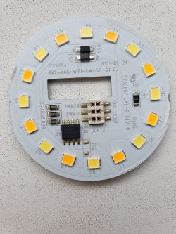

    I followed the instructions from the YouTube movie and managed to flash a B02-BL-A60 bulb. The wifi part works, I added it to the home assistant, and there it is ok and the switch works, software everything is ok but physically the LEDs don't light up anymore. What could it be, did I burn something?
  • #2 20918274
    Posts: 14797
    Rate: 12954
    Have you configured the pins as PWMs? You can also try, just temporary, setting their roles to 'Relay' and see if that works.
  • #3 20918305
    betinelu
    Posts: 13

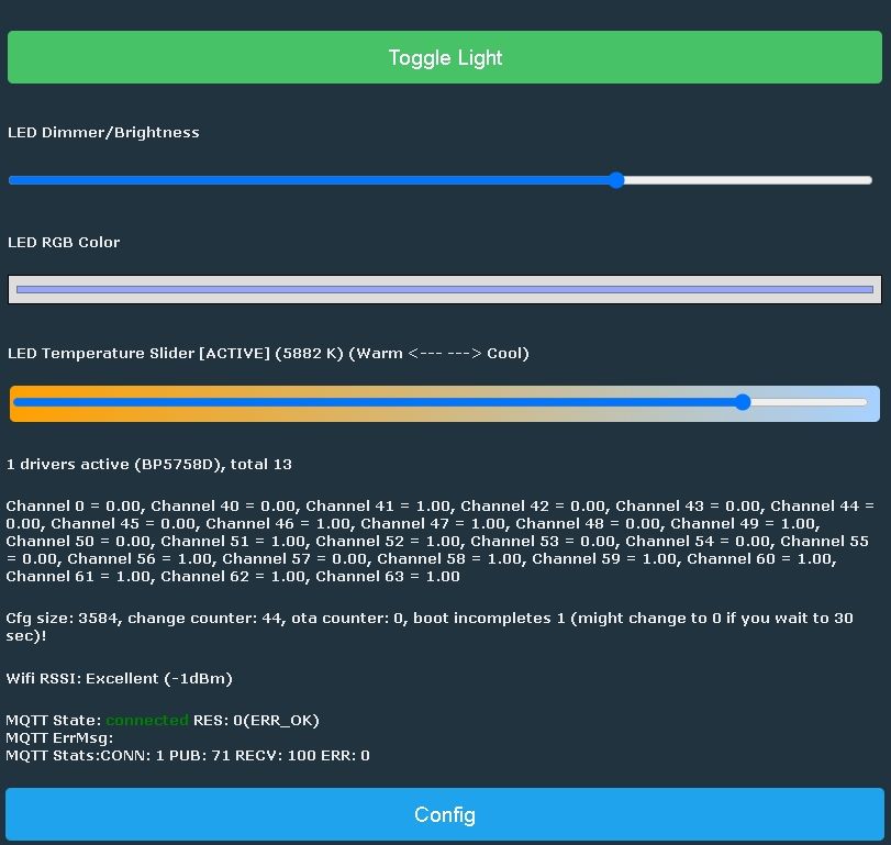

    I only configured Pin 2: BP5758D_CLK on channel 0 and Pin 21: BP5758D_DAT on channel 0. Exactly like in the movie, I don't know anything else. How to configure them as PWM? Please teach me what to do!
  • #4 20918333
    Posts: 14797
    Rate: 12954
    Ah, sorry, I don't remember the exact configuration of this device. I assumed it may be PWM based, but it seems to be using an I2C-like LED driver.
    Futhermore, the device config might have changed in the future revisions.
    Okay, so, is there BP5758 IC on the board with LEDs?
  • #5 20918638
    betinelu
    Posts: 13
    Oh, no. It's not, it's BP6772. Are there PWM settings for this IC?
  • #6 20918662
    Posts: 14797
    Rate: 12954

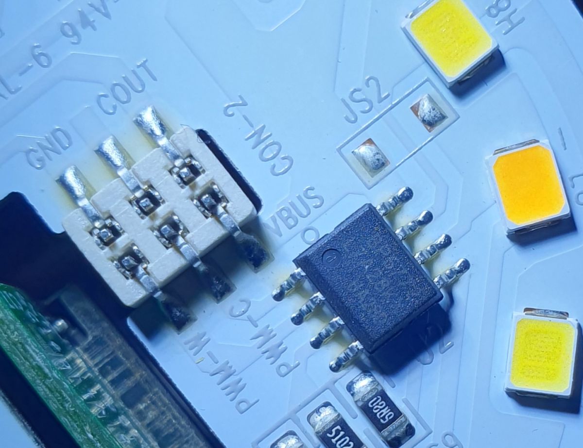

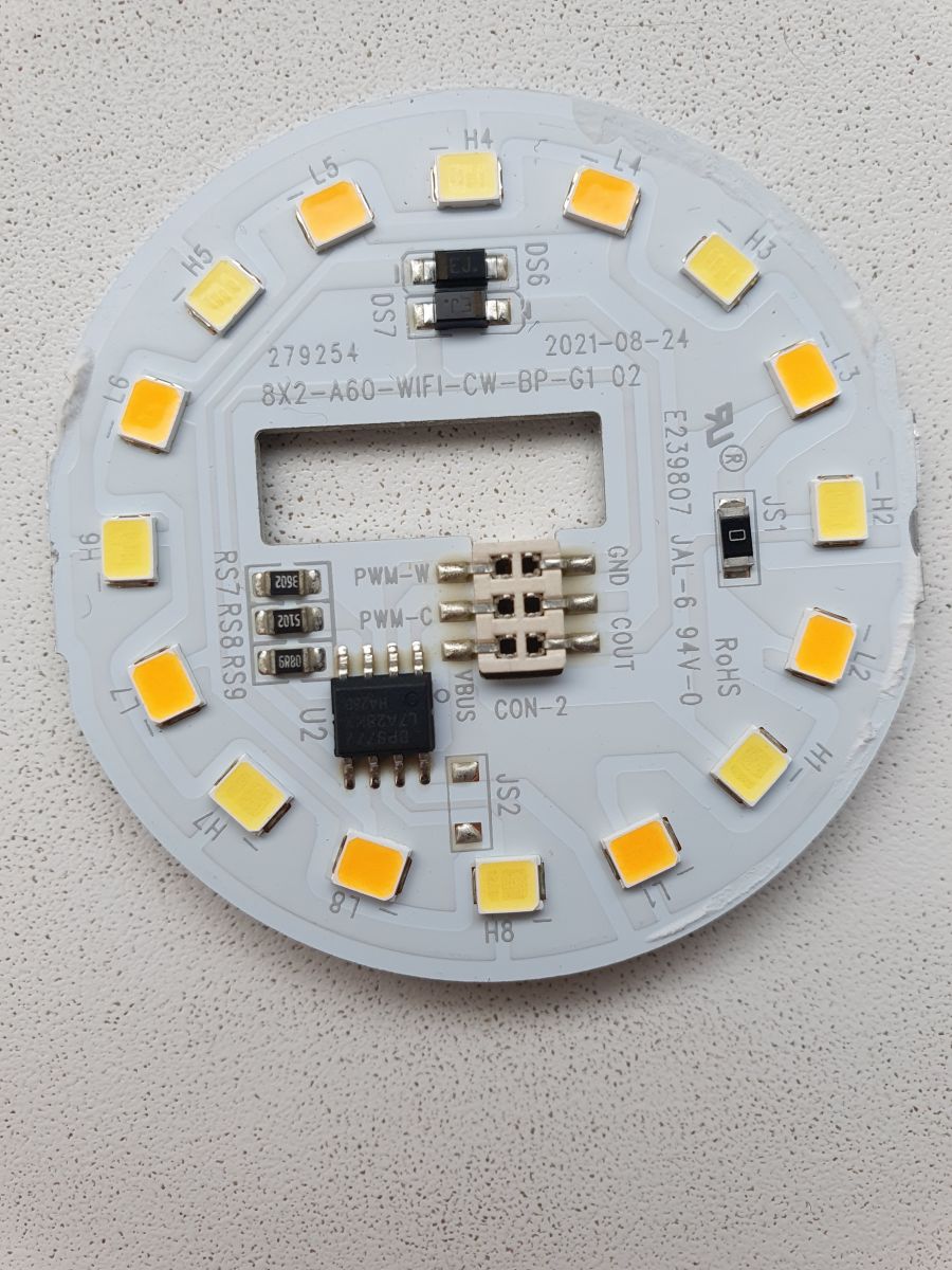

    There seems to be nothing in Google about BP6772. Can you make a photo of LED board?
  • #8 20918834
    Posts: 14797
    Rate: 12954
    So it's a PWM based device. You can clearly see the marking on the silk screen.
    Please open Web App and use GPIO doctor to guess which GPIOs are used for Warm and Cool white LEDs control. Then change their roles to PWM.
  • #9 20918914
    betinelu
    Posts: 13
    Thank you very much! Unfortunately, I did not manage to solve it. The LEDs do not light up. The buttons work but the LEDs do not light up. I did not find settings for BP6772 User interface for LED light control.

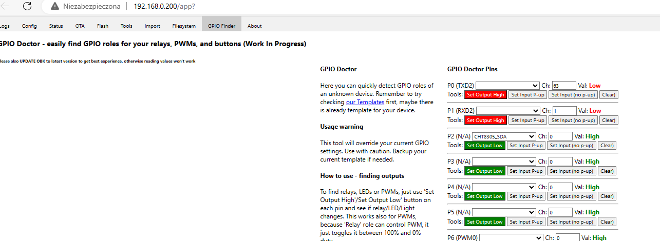

    Okay, let's do this step by step.
    For a start, you should open GPIO doctor:
    [BL602] Sonoff B02-BL-A60 CW CCT only bulb template and flashing
    Then , slowly, press "Set High" and "Set Low" button several times for each GPIO and watch the LEDs. If any of the pins can make Warm/Cool LEDs light up, write the pin number down.
    Then, let me know which pin you have found this way.
  • #11 20918989
    betinelu
    Posts: 13
    P20 and P21 light up my LEDs. :)
  • #12 20919025
    Posts: 14797
    Rate: 12954
    So, the next step is to clear whole IO config, for example, with the following command:
    ClearIO
    or you can just clear it manually in pins config, and then, you need to:
    - set channel 1 for P20, role PWM
    - set channel 2 for P21, role PWM
    If you have swapped Warm and Cool, then swap channels 1 with 2, because you haven't specified in your post which pin is which white temperature.

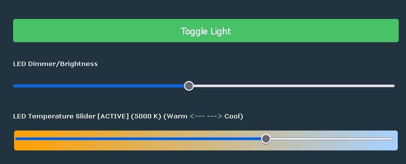

  • #13 20919078
    betinelu
    Posts: 13
    I put it as you said, the only thing I still have is that the line with RGB color no longer appears, only these appear. Do I still need to enter GPIO Doctor again and search again? LED lighting control panel with brightness and color temperature sliders.
  • #14 20919157
    Posts: 14797
    Rate: 12954
    Yes, RGB does not appear because your device is a CW only bulb. You can easily check it by looking at the LEDs. Your bulb has only cool warm and white warm LEDs. Futhermore, your device has only CW and WW PWM signals routed to board.
