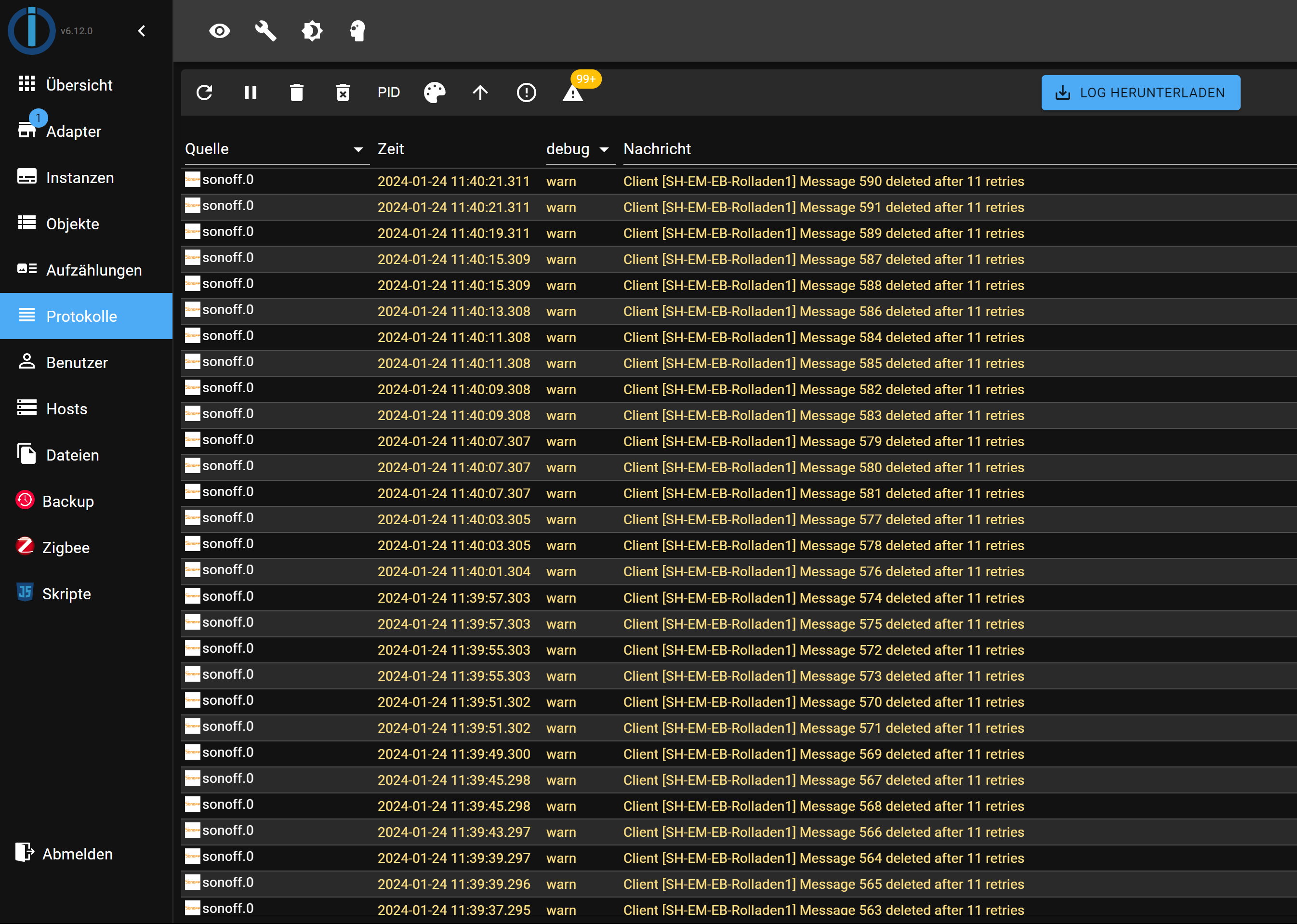

    Hey guys,

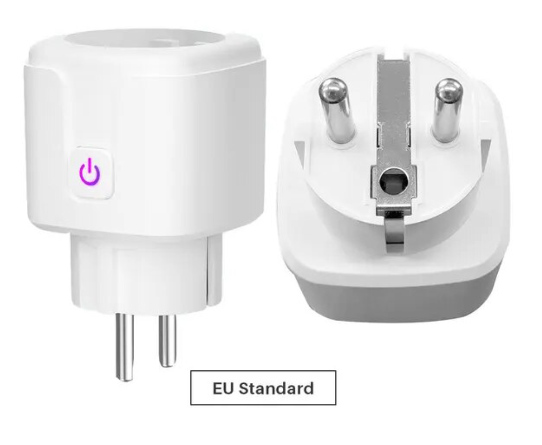

    I'm new to using the open source alternative software OpenBeken.
    I ordered some cheap current measurement power plugs from AliExpress and flashed the OpenBeken SW.
    Everything worked well. I connected the power plug via MQTT to my ioBroker.
    Now I get a ton of warning messages from the device, but I don't know what's wrong and why these messages appear.
    Can you please help me understand what's going on?

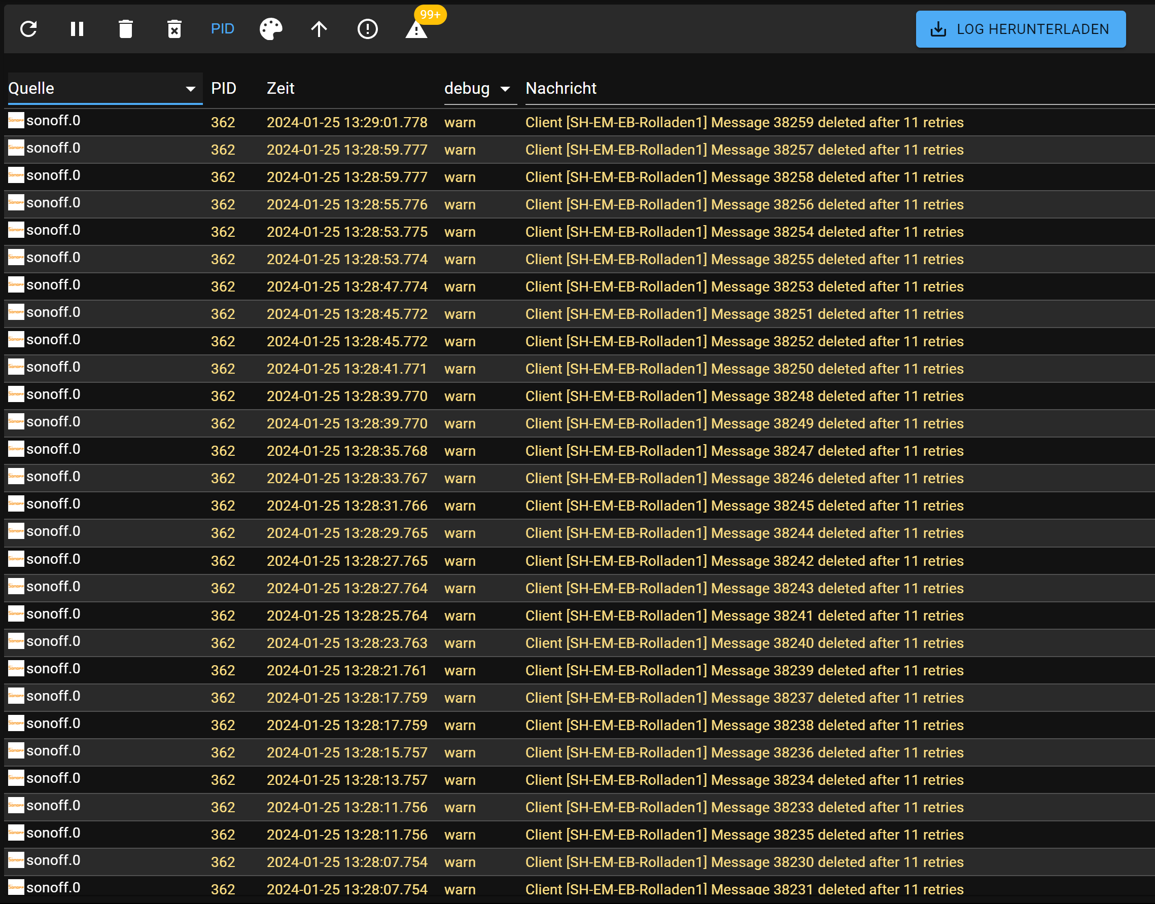

    Screenshot of logs from an application showing warning messages from sonoff.0 in ioBroker. Screenshot of OpenBeken application log showing MQTT operations and Wi-Fi status details.

    Posts: 14763
    Rate: 12896
    Hello, I haven't used much ioBroker, but can you show the content of this "message 590" or whatever that is?
  • No further details in the warning log

    TPTim
    Posts: 12
    Hi,
    Thanks for your reply.

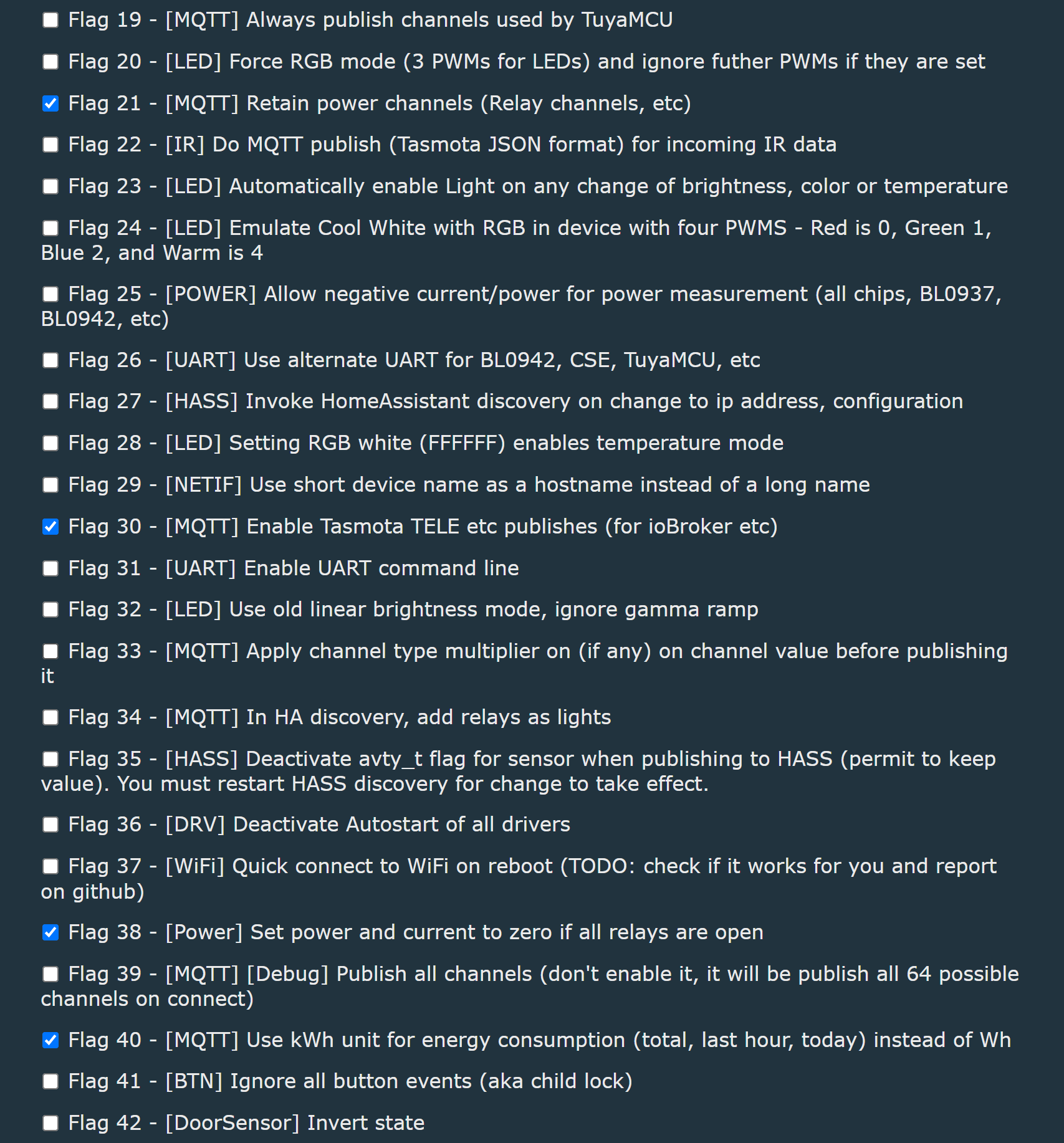

    The message itself is listed. There are no further details. Today I found over 38k messages in the log. See attachment.
    I found via google more users of OpenBeken in combination with ioBroker which have this problem, but nobody has a solution.
    The warning message in the error log appeared before I configured the flags. Is there something wrong?
    Hopefully,
    TPTim

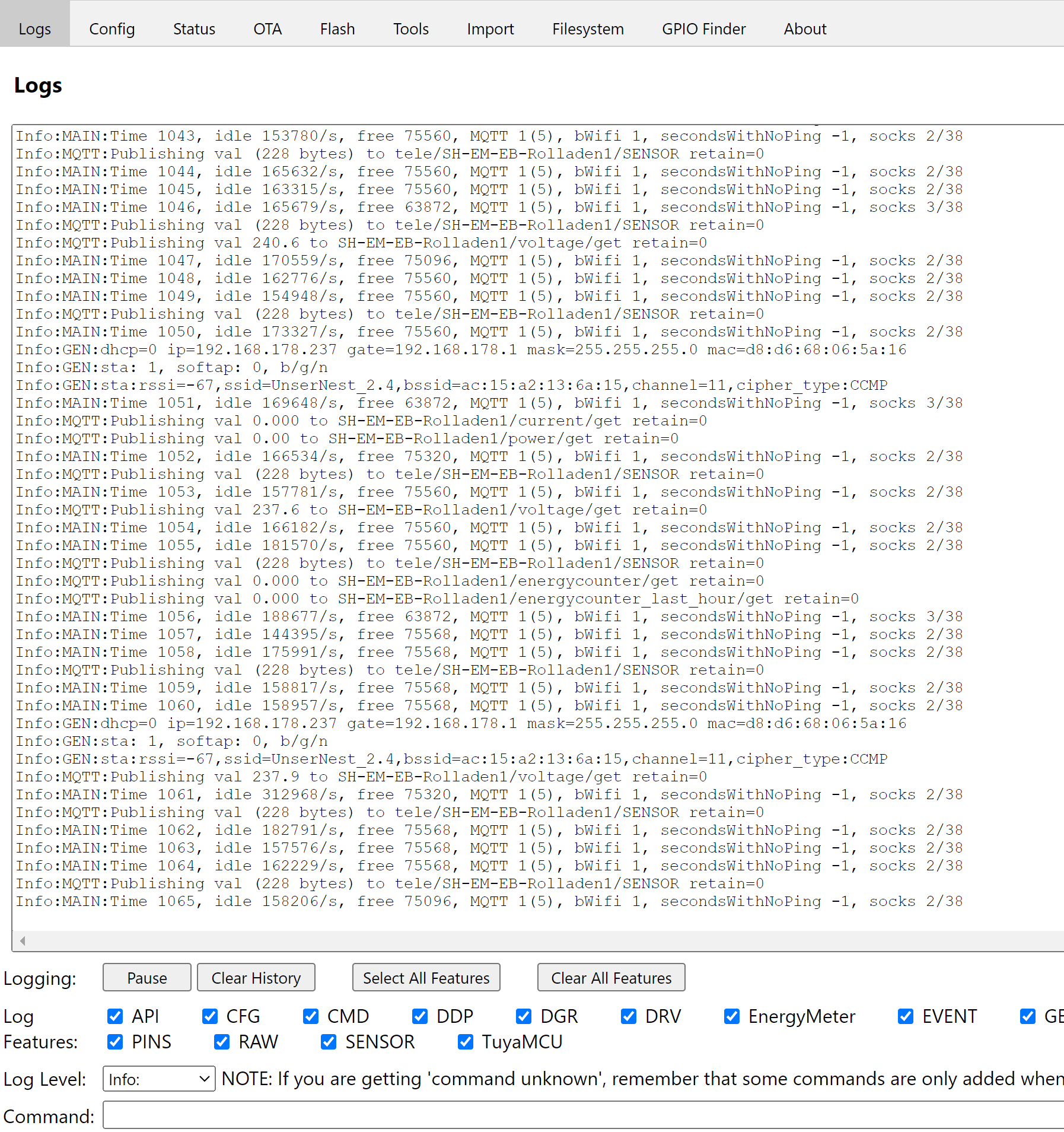

    Monitor screen showing error message logs in a black console with yellow text. Configuration flags list for MQ, LED, POWER, etc.

    Does OpenBeken send messages to the MQTT broker every second?

    You can customize TELE/STAT intervals with
    TasTeleInterval
    command, the default settings are:
    // interval for automatic publish of tasmota tele/sensor and tele/state
    static short g_teleState_interval = 120;
    static short g_teleSensor_interval = 3;
    See docs:
    Regarding the ioBroker message, I have tried searching on their Github but I haven't found any explanation what this might mean. I can change OBK behaviour quickly per request, but I would need to know what's going wrong in order to make a fix, and this message is so crypting that I have no idea what it relates to. Maybe we should first try asking ioBroker guy what does that mean so I can figure out a way to fix it...

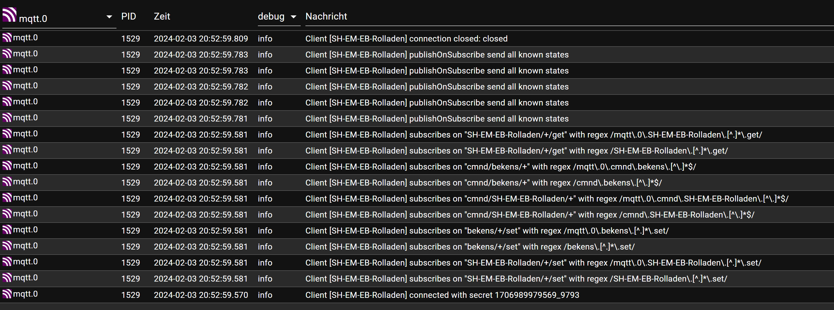

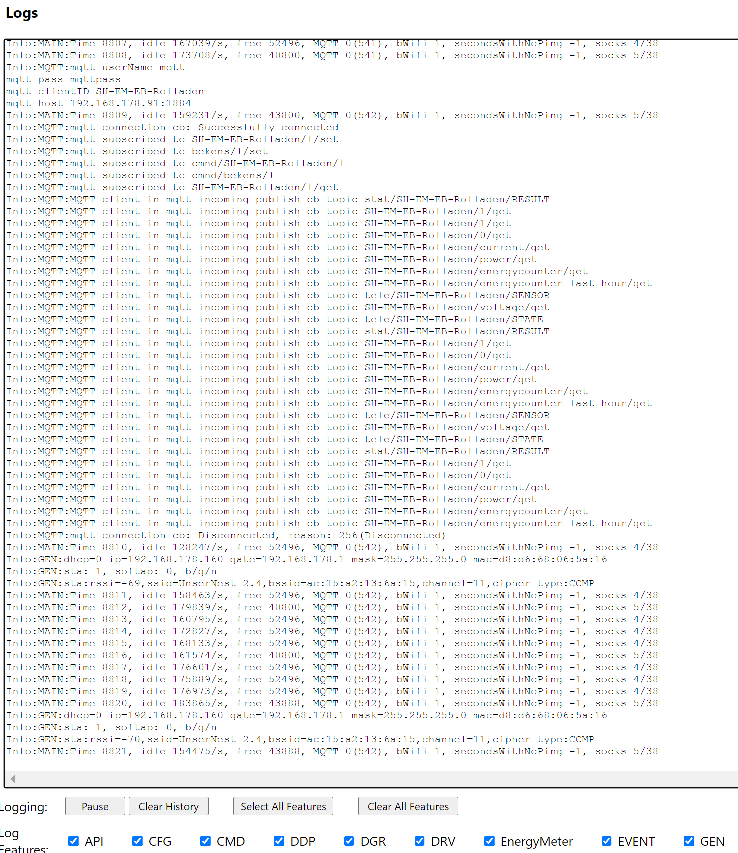

  • #7 20943380
    TPTim
    Posts: 12
    Hey,
    I am trying to figure out in a German forum the ioBroker problem. Until I found the root cause, I tried a different MQTT adapter.
    There I got this log and the connection is automatically closed. Can you tell me what is happening?
    Thank you !!
    Tim MQTT connection log showing various operations for client named SH-EM-EB-Rolladen. Screenshot of an MQTT log on a German forum.

    #8 20943750
    Posts: 14763
    Rate: 12896
    TPTim wrote:
    Someone wrote that it is related to MQTT messages without acknowledge flag. But I am not familiar enough to understand the behavior.
    Is this information helpful for you?
    Can you provide more information what is an ackownlodge flag and how it's set?
    We're using MQTT library from LWIP, here's how we publish data:
    Code: C / C++
    See more at:
    https://github.com/openshwprojects/OpenBK7231..._intf/lwip-2.1.3/src/include/lwip/apps/mqtt.h
    TPTim wrote:
    There i got this log and the connection is automatically closed. Can you tell me what is happening?
    For a start, I'd suggest to try connecting with the simplest device with no extra power metering topics. The disconnection reason is not shown on the log, it's just 256 - disconnected.

    2024-02-04 15:45:12.783 - warn: sonoff.0 (2269) Client [SH-EM-WZ-Stehlampe] Message 179 deleted after 11 retries
    2024-02-04 15:45:16.785 - warn: sonoff.0 (2269) Client [SH-EM-WZ-Stehlampe] Message 182 deleted after 11 retries
    2024-02-04 15:45:18.785 - warn: sonoff.0 (2269) Client [SH-EM-WZ-Stehlampe] Message 184 deleted after 11 retries
    2024-02-04 15:45:18.785 - warn: sonoff.0 (2269) Client [SH-EM-WZ-Stehlampe] Message 183 deleted after 11 retries
    2024-02-04 15:45:22.787 - warn: sonoff.0 (2269) Client [SH-EM-WZ-Stehlampe] Message 185 deleted after 11 retries
    2024-02-04 15:45:24.788 - warn: sonoff.0 (2269) Client [SH-EM-WZ-Stehlampe] Message 186 deleted after 11 retries
    2024-02-04 15:45:26.789 - warn: sonoff.0 (2269) Client [SH-EM-WZ-Stehlampe] Message 187 deleted after 11 retries
    2024-02-04 15:45:28.790 - warn: sonoff.0 (2269) Client [SH-EM-WZ-Stehlampe] Message 188 deleted after 11 retries
    2024-02-04 15:45:30.791 - warn: sonoff.0 (2269) Client [SH-EM-WZ-Stehlampe] Message 191 deleted after 11 retries
    2024-02-04 15:45:30.791 - warn: sonoff.0 (2269) Client [SH-EM-WZ-Stehlampe] Message 190 deleted after 11 retries
    2024-02-04 15:45:30.791 - warn: sonoff.0 (2269) Client [SH-EM-WZ-Stehlampe] Message 189 deleted after 11 retries
    2024-02-04 15:45:32.792 - warn: sonoff.0 (2269) Client [SH-EM-WZ-Stehlampe] Message 192 deleted after 11 retries
    2024-02-04 15:45:32.793 - warn: sonoff.0 (2269) Client [SH-EM-EB-Rolladen] Message 26 deleted after 11 retries
    2024-02-04 15:45:32.793 - warn: sonoff.0 (2269) Client [SH-EM-EB-Rolladen] Message 25 deleted after 11 retries
    2024-02-04 15:45:32.793 - warn: sonoff.0 (2269) Client [SH-EM-EB-Rolladen] Message 24 deleted after 11 retries
    2024-02-04 15:45:34.792 - warn: sonoff.0 (2269) Client [SH-EM-WZ-Stehlampe] Message 193 deleted after 11 retries
    2024-02-04 15:45:36.793 - warn: sonoff.0 (2269) Client [SH-EM-WZ-Stehlampe] Message 194 deleted after 11 retries
    2024-02-04 15:45:40.793 - warn: sonoff.0 (2269) Client [SH-EM-WZ-Stehlampe] Message 196 deleted after 11 retries
    2024-02-04 15:45:40.794 - warn: sonoff.0 (2269) Client [SH-EM-WZ-Stehlampe] Message 195 deleted after 11 retries
    2024-02-04 15:45:42.794 - warn: sonoff.0 (2269) Client [SH-EM-WZ-Stehlampe] Message 197 deleted after 11 retries
    2024-02-04 15:45:42.794 - warn: sonoff.0 (2269) Client [SH-EM-EB-Rolladen] Message 29 deleted after 11 retries
    2024-02-04 15:45:42.794 - warn: sonoff.0 (2269) Client [SH-EM-EB-Rolladen] Message 28 deleted after 11 retries
    2024-02-04 15:45:42.794 - warn: sonoff.0 (2269) Client [SH-EM-EB-Rolladen] Message 27 deleted after 11 retries
    2024-02-04 15:45:46.795 - warn: sonoff.0 (2269) Client [SH-EM-WZ-Stehlampe] Message 199 deleted after 11 retries
    2024-02-04 15:45:46.795 - warn: sonoff.0 (2269) Client [SH-EM-WZ-Stehlampe] Message 198 deleted after 11 retries
    2024-02-04 15:45:48.795 - warn: sonoff.0 (2269) Client [SH-EM-WZ-Stehlampe] Message 201 deleted after 11 retries
    2024-02-04 15:45:48.795 - warn: sonoff.0 (2269) Client [SH-EM-WZ-Stehlampe] Message 200 deleted after 11 retries
    2024-02-04 15:45:50.796 - warn: sonoff.0 (2269) Client [SH-EM-WZ-Stehlampe] Message 202 deleted after 11 retries
    2024-02-04 15:45:52.796 - warn: sonoff.0 (2269) Client [SH-EM-WZ-Stehlampe] Message 204 deleted after 11 retries
    2024-02-04 15:45:52.796 - warn: sonoff.0 (2269) Client [SH-EM-WZ-Stehlampe] Message 203 deleted after 11 retries
    2024-02-04 15:45:54.797 - warn: sonoff.0 (2269) Client [SH-EM-WZ-Stehlampe] Message 205 deleted after 11 retries
    2024-02-04 15:45:58.797 - warn: sonoff.0 (2269) Client [SH-EM-WZ-Stehlampe] Message 207 deleted after 11 retries
    2024-02-04 15:45:58.797 - warn: sonoff.0 (2269) Client [SH-EM-WZ-Stehlampe] Message 206 deleted after 11 retries
    2024-02-04 15:46:00.798 - warn: sonoff.0 (2269) Client [SH-EM-WZ-Stehlampe] Message 208 deleted after 11 retries
    2024-02-04 15:46:04.801 - warn: sonoff.0 (2269) Client [SH-EM-WZ-Stehlampe] Message 210 deleted after 11 retries
    2024-02-04 15:46:04.801 - warn: sonoff.0 (2269) Client [SH-EM-WZ-Stehlampe] Message 209 deleted after 11 retries
    2024-02-04 15:46:06.801 - warn: sonoff.0 (2269) Client [SH-EM-WZ-Stehlampe] Message 211 deleted after 11 retries
    2024-02-04 15:46:10.803 - warn: sonoff.0 (2269) Client [SH-EM-WZ-Stehlampe] Message 212 deleted after 11 retries
    2024-02-04 15:46:12.803 - warn: sonoff.0 (2269) Client [SH-EM-WZ-Stehlampe] Message 214 deleted after 11 retries
    2024-02-04 15:46:12.803 - warn: sonoff.0 (2269) Client [SH-EM-WZ-Stehlampe] Message 213 deleted after 11 retries
    2024-02-04 15:46:16.804 - warn: sonoff.0 (2269) Client [SH-EM-WZ-Stehlampe] Message 215 deleted after 11 retries
    2024-02-04 15:46:18.806 - warn: sonoff.0 (2269) Client [SH-EM-WZ-Stehlampe] Message 216 deleted after 11 retries
    2024-02-04 15:46:20.806 - warn: sonoff.0 (2269) Client [SH-EM-WZ-Stehlampe] Message 217 deleted after 11 retries
    2024-02-04 15:46:22.808 - warn: sonoff.0 (2269) Client [SH-EM-WZ-Stehlampe] Message 218 deleted after 11 retries
    2024-02-04 15:46:24.808 - warn: sonoff.0 (2269) Client [SH-EM-WZ-Stehlampe] Message 219 deleted after 11 retries
    2024-02-04 15:46:26.808 - warn: sonoff.0 (2269) Client [SH-EM-WZ-Stehlampe] Message 220 deleted after 11 retries
    2024-02-04 15:46:28.808 - warn: sonoff.0 (2269) Client [SH-EM-WZ-Stehlampe] Message 221 deleted after 11 retries
    2024-02-04 15:46:30.809 - warn: sonoff.0 (2269) Client [SH-EM-WZ-Stehlampe] Message 222 deleted after 11 retries
    2024-02-04 15:46:32.810 - warn: sonoff.0 (2269) Client [SH-EM-WZ-Stehlampe] Message 225 deleted after 11 retries
    2024-02-04 15:46:32.810 - warn: sonoff.0 (2269) Client [SH-EM-WZ-Stehlampe] Message 224 deleted after 11 retries
    2024-02-04 15:46:32.810 - warn: sonoff.0 (2269) Client [SH-EM-WZ-Stehlampe] Message 223 deleted after 11 retries
    2024-02-04 15:46:34.810 - warn: sonoff.0 (2269) Client [SH-EM-WZ-Stehlampe] Message 226 deleted after 11 retries
    2024-02-04 15:46:36.811 - warn: sonoff.0 (2269) Client [SH-EM-WZ-Stehlampe] Message 227 deleted after 11 retries
    2024-02-04 15:46:40.812 - warn: sonoff.0 (2269) Client [SH-EM-WZ-Stehlampe] Message 228 deleted after 11 retries
    2024-02-04 15:46:42.813 - warn: sonoff.0 (2269) Client [SH-EM-WZ-Stehlampe] Message 229 deleted after 11 retries
    2024-02-04 15:46:44.814 - warn: sonoff.0 (2269) Client [SH-EM-WZ-Stehlampe] Message 230 deleted after 11 retries
    2024-02-04 15:46:48.816 - warn: sonoff.0 (2269) Client [SH-EM-WZ-Stehlampe] Message 232 deleted after 11 retries
    2024-02-04 15:46:48.816 - warn: sonoff.0 (2269) Client [SH-EM-WZ-Stehlampe] Message 231 deleted after 11 retries
    2024-02-04 15:46:50.816 - warn: sonoff.0 (2269) Client [SH-EM-WZ-Stehlampe] Message 234 deleted after 11 retries
    2024-02-04 15:46:50.816 - warn: sonoff.0 (2269) Client [SH-EM-WZ-Stehlampe] Message 233 deleted after 11 retries
    2024-02-04 15:46:52.817 - warn: sonoff.0 (2269) Client [SH-EM-WZ-Stehlampe] Message 236 deleted after 11 retries
    2024-02-04 15:46:52.817 - warn: sonoff.0 (2269) Client [SH-EM-WZ-Stehlampe] Message 235 deleted after 11 retries
    2024-02-04 15:46:54.817 - warn: sonoff.0 (2269) Client [SH-EM-WZ-Stehlampe] Message 238 deleted after 11 retries
    2024-02-04 15:46:54.817 - warn: sonoff.0 (2269) Client [SH-EM-WZ-Stehlampe] Message 237 deleted after 11 retries
    2024-02-04 15:46:56.817 - warn: sonoff.0 (2269) Client [SH-EM-WZ-Stehlampe] Message 239 deleted after 11 retries
    2024-02-04 15:46:58.818 - warn: sonoff.0 (2269) Client [SH-EM-WZ-Stehlampe] Message 241 deleted after 11 retries
    2024-02-04 15:47:00.818 - warn: sonoff.0 (2269) Client [SH-EM-WZ-Stehlampe] Message 242 deleted after 11 retries
    2024-02-04 15:47:00.818 - warn: sonoff.0 (2269) Client [SH-EM-WZ-Stehlampe] Message 240 deleted after 11 retries
    2024-02-04 15:47:00.818 - warn: sonoff.0 (2269) Client [SH-EM-EB-Rolladen] Message 30 deleted after 11 retries
    2024-02-04 15:47:04.820 - warn: sonoff.0 (2269) Client [SH-EM-WZ-Stehlampe] Message 243 deleted after 11 retries
    2024-02-04 15:47:06.820 - warn: sonoff.0 (2269) Client [SH-EM-WZ-Stehlampe] Message 245 deleted after 11 retries
    2024-02-04 15:47:06.820 - warn: sonoff.0 (2269) Client [SH-EM-WZ-Stehlampe] Message 244 deleted after 11 retries
    2024-02-04 15:47:12.822 - warn: sonoff.0 (2269) Client [SH-EM-WZ-Stehlampe] Message 246 deleted after 11 retries
    2024-02-04 15:47:14.823 - warn: sonoff.0 (2269) Client [SH-EM-WZ-Stehlampe] Message 248 deleted after 11 retries
    2024-02-04 15:47:14.823 - warn: sonoff.0 (2269) Client [SH-EM-WZ-Stehlampe] Message 247 deleted after 11 retries
    2024-02-04 15:47:18.825 - warn: sonoff.0 (2269) Client [SH-EM-WZ-Stehlampe] Message 249 deleted after 11 retries
    2024-02-04 15:47:20.827 - warn: sonoff.0 (2269) Client [SH-EM-WZ-Stehlampe] Message 251 deleted after 11 retries
    2024-02-04 15:47:20.827 - warn: sonoff.0 (2269) Client [SH-EM-WZ-Stehlampe] Message 250 deleted after 11 retries
    2024-02-04 15:47:24.828 - warn: sonoff.0 (2269) Client [SH-EM-WZ-Stehlampe] Message 252 deleted after 11 retries
    2024-02-04 15:47:26.829 - warn: sonoff.0 (2269) Client [SH-EM-WZ-Stehlampe] Message 253 deleted after 11 retries
    2024-02-04 15:47:27.520 - info: web.0 (490) ==> Connected system.user.admin from ::ffff:192.168.178.12
    2024-02-04 15:47:28.830 - warn: sonoff.0 (2269) Client [SH-EM-WZ-Stehlampe] Message 254 deleted after 11 retries
    2024-02-04 15:47:30.831 - warn: sonoff.0 (2269) Client [SH-EM-WZ-Stehlampe] Message 256 deleted after 11 retries
    2024-02-04 15:47:30.831 - warn: sonoff.0 (2269) Client [SH-EM-WZ-Stehlampe] Message 255 deleted after 11 retries
    2024-02-04 15:47:32.832 - warn: sonoff.0 (2269) Client [SH-EM-WZ-Stehlampe] Message 259 deleted after 11 retries
    2024-02-04 15:47:32.832 - warn: sonoff.0 (2269) Client [SH-EM-WZ-Stehlampe] Message 258 deleted after 11 retries
    2024-02-04 15:47:32.832 - warn: sonoff.0 (2269) Client [SH-EM-WZ-Stehlampe] Message 257 deleted after 11 retries
    2024-02-04 15:47:34.833 - warn: sonoff.0 (2269) Client [SH-EM-WZ-Stehlampe] Message 260 deleted after 11 retries
    2024-02-04 15:47:36.833 - warn: sonoff.0 (2269) Client [SH-EM-WZ-Stehlampe] Message 261 deleted after 11 retries
    2024-02-04 15:47:40.835 - warn: sonoff.0 (2269) Client [SH-EM-WZ-Stehlampe] Message 263 deleted after 11 retries
    2024-02-04 15:47:40.835 - warn: sonoff.0 (2269) Client [SH-EM-WZ-Stehlampe] Message 262 deleted after 11 retries
    2024-02-04 15:47:42.835 - warn: sonoff.0 (2269) Client [SH-EM-WZ-Stehlampe] Message 264 deleted after 11 retries
    2024-02-04 15:47:46.837 - warn: sonoff.0 (2269) Client [SH-EM-WZ-Stehlampe] Message 266 deleted after 11 retries
    2024-02-04 15:47:46.838 - warn: sonoff.0 (2269) Client [SH-EM-WZ-Stehlampe] Message 265 deleted after 11 retries
    2024-02-04 15:47:48.839 - warn: sonoff.0 (2269) Client [SH-EM-WZ-Stehlampe] Message 267 deleted after 11 retries
    2024-02-04 15:47:50.839 - warn: sonoff.0 (2269) Client [SH-EM-WZ-Stehlampe] Message 268 deleted after 11 retries
    2024-02-04 15:47:52.841 - warn: sonoff.0 (2269) Client [SH-EM-WZ-Stehlampe] Message 271 deleted after 11 retries
    2024-02-04 15:47:52.841 - warn: sonoff.0 (2269) Client [SH-EM-WZ-Stehlampe] Message 270 deleted after 11 retries
    2024-02-04 15:47:52.841 - warn: sonoff.0 (2269) Client [SH-EM-WZ-Stehlampe] Message 269 deleted after 11 retries
    2024-02-04 15:47:54.841 - warn: sonoff.0 (2269) Client [SH-EM-WZ-Stehlampe] Message 272 deleted after 11 retries
    2024-02-04 15:47:58.843 - warn: sonoff.0 (2269) Client [SH-EM-WZ-Stehlampe] Message 273 deleted after 11 retries
    2024-02-04 15:48:00.843 - warn: sonoff.0 (2269) Client [SH-EM-WZ-Stehlampe] Message 275 deleted after 11 retries
    2024-02-04 15:48:00.844 - warn: sonoff.0 (2269) Client [SH-EM-WZ-Stehlampe] Message 274 deleted after 11 retries
    2024-02-04 15:48:04.845 - warn: sonoff.0 (2269) Client [SH-EM-WZ-Stehlampe] Message 276 deleted after 11 retries
    2024-02-04 15:48:06.846 - warn: sonoff.0 (2269) Client [SH-EM-WZ-Stehlampe] Message 277 deleted after 11 retries
    2024-02-04 15:48:08.846 - warn: sonoff.0 (2269) Client [SH-EM-WZ-Stehlampe] Message 278 deleted after 11 retries
    2024-02-04 15:48:10.848 - warn: sonoff.0 (2269) Client [SH-EM-WZ-Stehlampe] Message 279 deleted after 11 retries
    2024-02-04 15:48:12.849 - warn: sonoff.0 (2269) Client [SH-EM-WZ-Stehlampe] Message 280 deleted after 11 retries
    2024-02-04 15:48:14.850 - warn: sonoff.0 (2269) Client [SH-EM-WZ-Stehlampe] Message 281 deleted after 11 retries
    2024-02-04 15:48:16.851 - warn: sonoff.0 (2269) Client [SH-EM-WZ-Stehlampe] Message 282 deleted after 11 retries

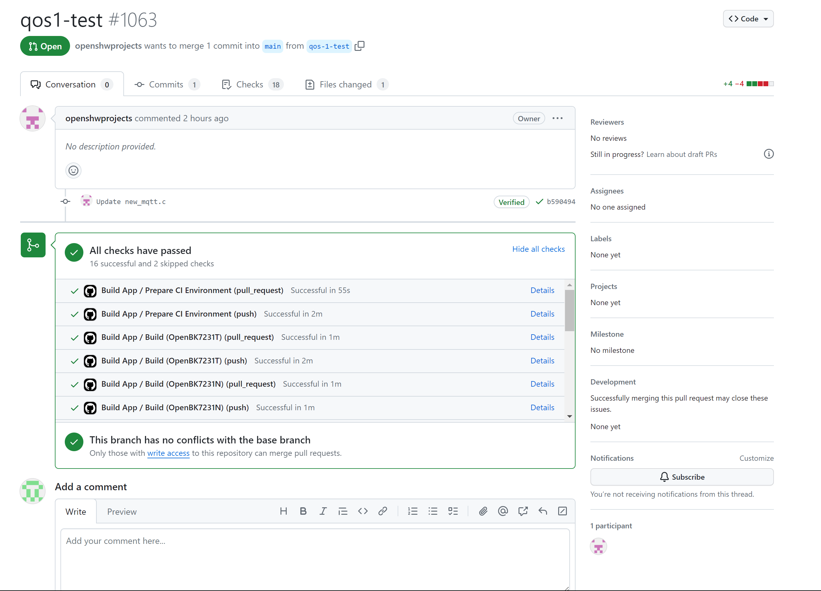

    But I have to annoy you again... I am on this page:
    Screenshot of a GitHub pull request titled qos1-test #1063.
    How do I get the firmware file? Best would be an OTA flash file.
    I am an electrical engineer but not very familiar with GitHub... :(

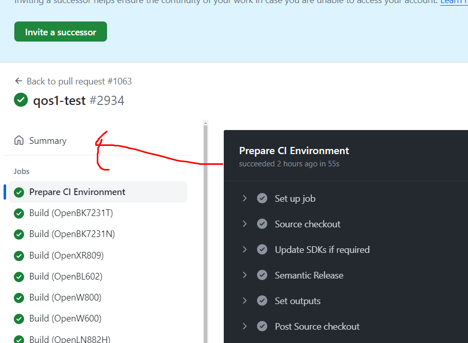

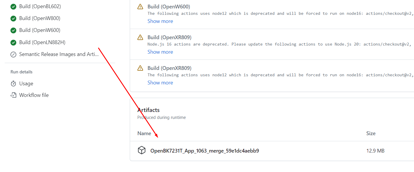

    Click details, then summary:
    Screenshot of a CI interface with a list of jobs.
    then scroll down:
    Screenshot of a version management platform showing build and artifact information.

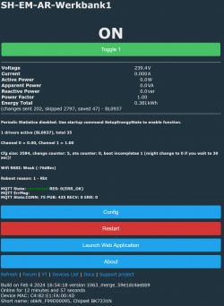

    I have now flashed both units with your new SW version and it works. I configured the one back to the power meter settings and that works too. No warning spam in the log.
    System log table with connection and script operation information.

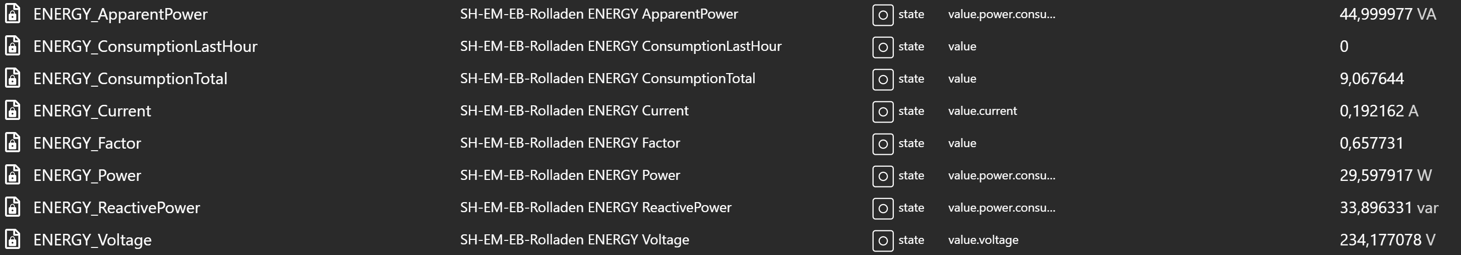

    There are two little things:
    Screen displaying technical data on electricity consumption, including voltage, current, active power, apparent power, reactive power, power factor, and total energy.
    How is it possible to get yesterday's energy consumption?

    If you can see, I have activated the flag:
    Checked option Flag 40 in settings, describing the use of kWh unit instead of Wh for energy consumption.
    It is displayed on the OpenBeken main page as kWh, but it is sent to the MQTT broker in Wh.
    I think if the user sets the flag, it should also be published in the same unit?

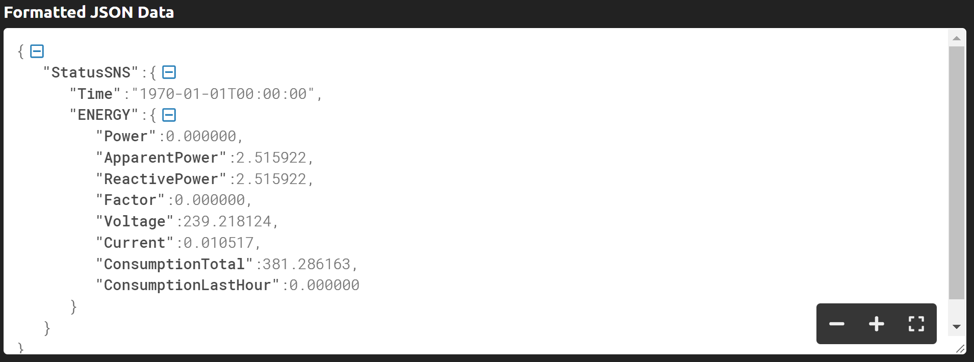

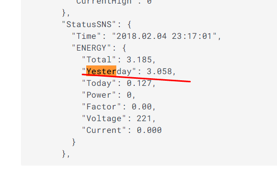

    I think I can add it for you, it's in StatusSNS in Tasmota:
    Screenshot of a JSON data snippet about energy consumption.
    It is displayed on the OpenBeken main page as kwh, but it is sent to the mqtt broker in wh.
    To which publishing are you referring? If you are talking about StatusSNS, then I don't see energy unit there in Tasmota.
  • tele/SENSORS as the default adapter data source

    Posts: 12
    Hey @ElektrodaBot,
    thanks! Ok, then the QOS flag is 1. This is the right value for working with IOBroker SonOff Adapter.
    How can I get this JSON Data overview? I did not find the http request syntax on GitHub :(

    I am referring to tele/SENSORS. This is used by the adapter as default data source.
    Best Regards
    Tim
  • Status 10 JSON provides tele/SENSORS data

    #17 20972750
    TPTim
    Posts: 12
    Hey @p.kaczmarek2,
    Thanks for your feedback. Sorry for the late reply, I'm working on other smart home stuff at the same time :)

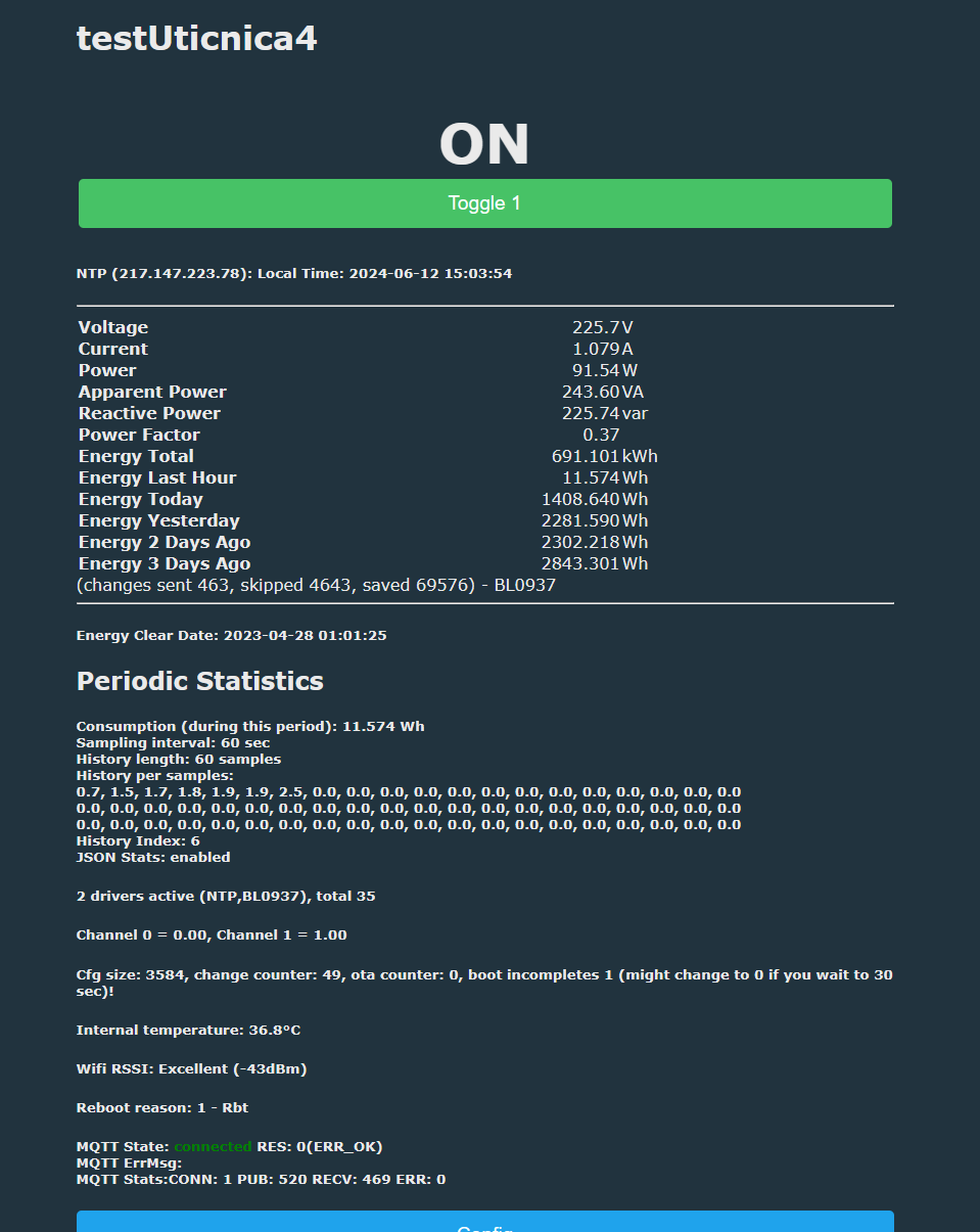

    Regarding your snippet, I tried to get the energy data as 'yesterday'. But my SNS data does not provide that information.
    This is what I get back by reading 'http://192.168.178.161/cm?cmnd=Status%2010':
    Screenshot of formatted JSON data regarding energy consumption.
    And the web view does not provide it either:
    Smart socket user interface screen showing various energy parameters.
    The hardware is an energy meter plug with a BL0937 power meter chip:
    Energy meter plug with BL0937 chip, EU standard.
    Is it just a setting of open beken, or is it related to the firmware used?
    Best Regards
    Tim

  • #20 21116324
    Posts: 14763
    Rate: 12896
    I suspect that QOS 2 is not implemented in our MQTT library... that's why QOS 1 is the solution.
    I updated PR to the latest main version:
    https://github.com/openshwprojects/OpenBK7231T_App/pull/1063
    @divadiow @DeDaMrAz can you check that PR with MQTT (Home Assistant) and tell me if it's keeps the stability of the main releases, so I can merge it?

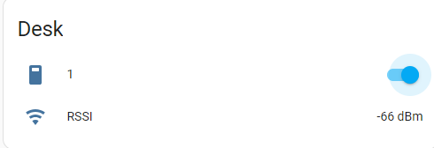

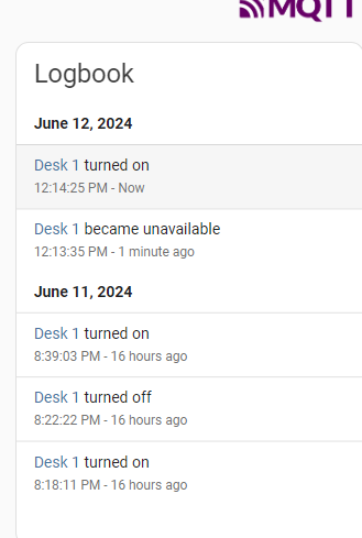

  • #21 21116371
    Posts: 5215
    Help: 448
    Rate: 917
    tested on BK-T plug.
    1063_merge_e4f2580591cb works. it communicates with HA/MQTT
    Desk 1 activity log from June 2024.
    Screenshot of a control interface for a device named Desk with RSSI value -66 dBm and an active toggle.
    Not sure about stability over time.
