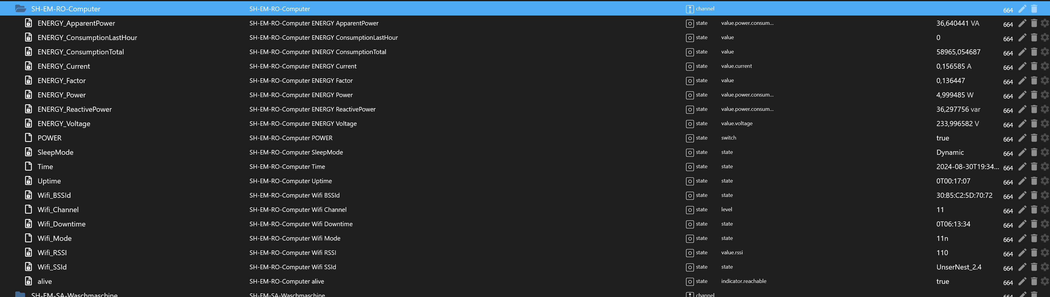

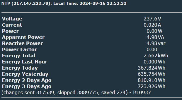

    I am using OpenBeken on my Tuya sockets. It works fine and sends the data via MQTT to my iobroker server.
    The following data is visible in the GUI:
    View of the OpenBeken energy monitoring system control panel.
    The IObroker side receives the following data:
    Screenshot of IObroker interface showing energy data list.
    You can see that the values Energy Today and Energy Yesterday are missing. These are not transmitted by OpenBeken.

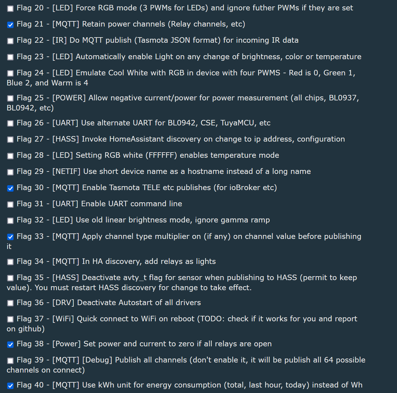

    These flags are enabled:
    Screenshot of the OpenBeken program flag settings list on Tuya devices.

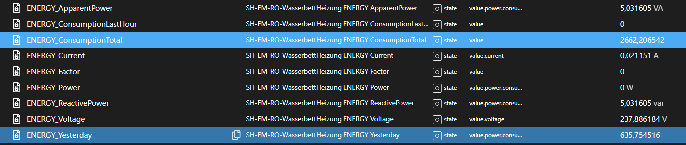

    After installing the new version 1.17.670 of OpenBeken to my sockets, the Datapoint "Yesterday" appeared.
    Screenshot showing information on energy consumption from the previous day in kWh.
    Now only the Datapoint "Energy Today" is missing.

    One more thing about this is the unit "Wh". Basically, I prefer to work with kWh instead of Wh. So I selected flag 40 in the OpenBeken settings.
    Screenshot of Flag 40 setting in OpenBeken.
    But i reseive the energy values despit it in Wh instead of kWh. See here:
    Screenshot showing energy values from an OpenBeken device.
    See blue color:
    Screenshot displaying energy data in an interface.
