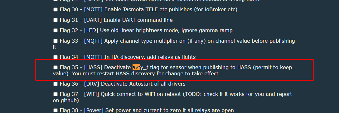

    Hello, are you using it with Home Assistant?
    If you are using it with Home Assistant, then the recommended solution is to disable the availability topic so the state of the door is retained:
    openBeken MQTT: Configuration option to get persistent messages on broker available

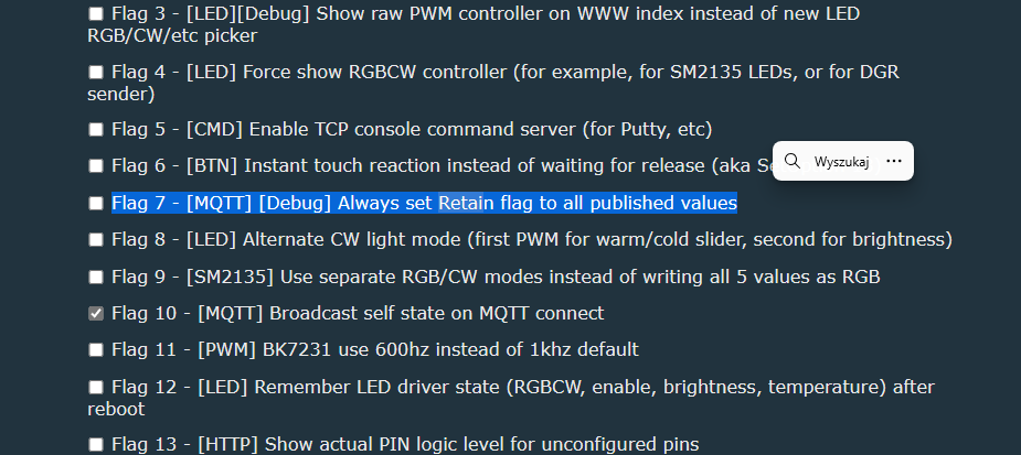

    Maybe this retain flag can help?

    With setting this flag, at least the last message stays on the broker side, even if the client goes offline. So I can't see the whole history, but at least the latest message. šŸ‘
