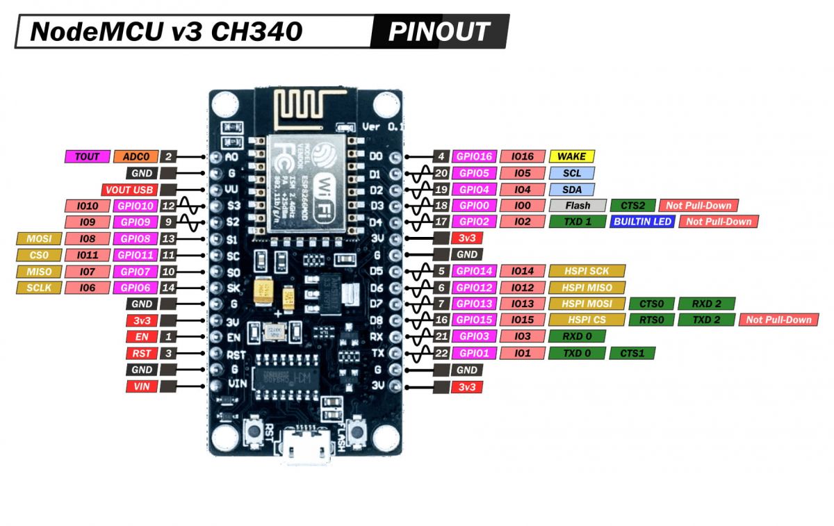

    As in the subject, I have a module esp8266 to control a garage door with a reed switch sensor,
    everything works as expected until the power goes out :/ and the board does not want to start if it has a high state on the D8 pin (reed switch connected)
    Please suggest how to do it differently or how you connect it,

    I've just come across the same thing ^^ I was looking at a voltage divider that I'm making for another board iii ehh I've been messing around again instead of putting 10k pulled up to GND and seeing what happens then and it will probably work I've been messing around for 2h :) Thank you for your help I'll check tomorrow to see if it works :)

    I don't play with the ESP8266 too much, but from what you describe I think you have a NodeMCU v3.
    It also has the SD card support pins brought out. What if you used any of them, they seem "more normal" than the basic ones.
    These are the ones on the left from GPIO6 to 11:
    NodeMCU v3 CH340 pinout diagram with GPIO pins 6 to 11 highlighted on the left side. .

    thanks for your help, I managed by adding 10k on GND relative to the input as a pull-down and everything started and no problems on reset :)
