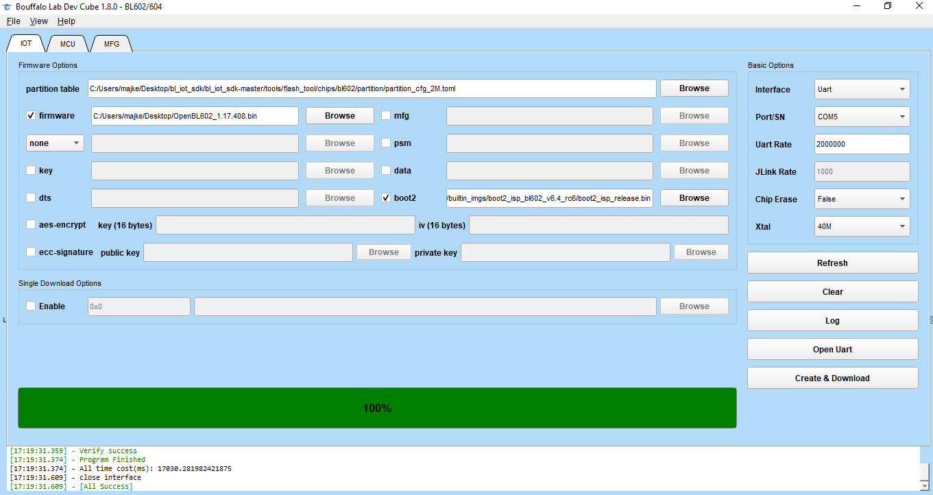

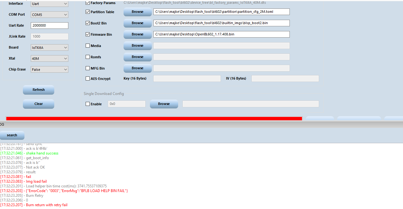

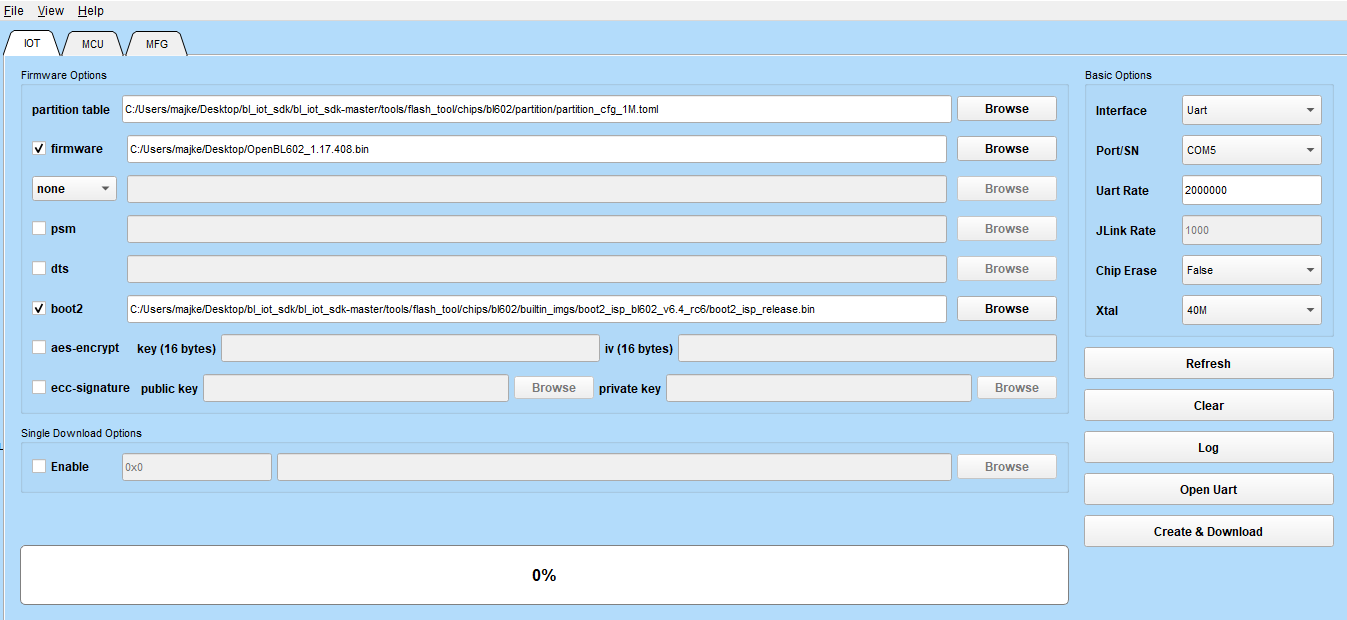

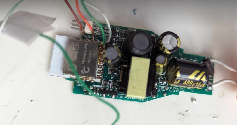

    I have recently uploaded the OpenBL602 program to the BL-200 module - Cozy Life bulb. For this I used the BLDevCube software version 1.8.
    Screenshot of Bouffalo Lab Dev Cube 1.8.8 software configuration interface for BL602/604.
    Image of an electronic circuit board with visible components, including a WiFi module.
    The process went well but after desoldering and connecting 230V the hotspot does not start for some reason. I connected the device to the recommended terminal and found this information:
    [ 0][[31mERROR [0m: hal_board.c: 942] wifi NULL.
    [ 0][[31mERROR [0m: hal_board.c:1075] bt NULL.
    It looks like the wifi module is not detected. Can something be done about this?
    I am also attaching the logs.

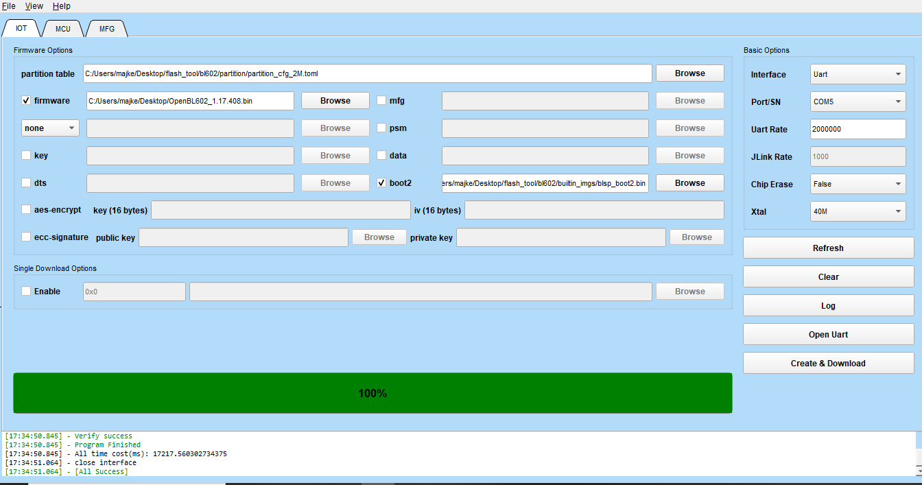

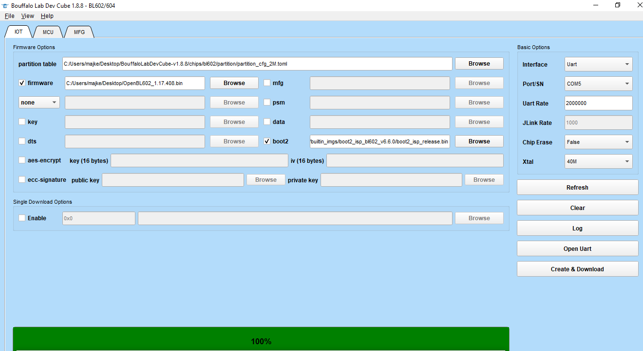

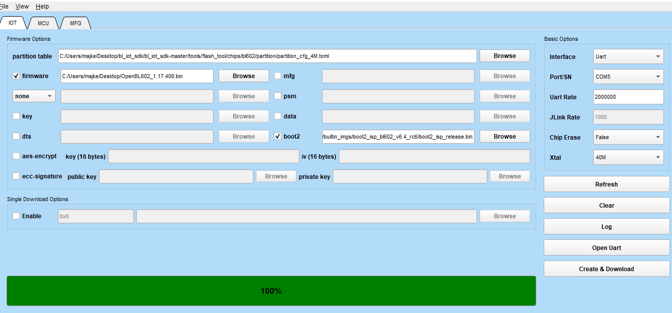

    Hi,
    I have tried several times. In version 1.4.8 I have the error:
    Screenshot of a programming tool showing configuration and error during firmware upload.
    Then I tried different combinations - version 1.8 with parameters 1.8 and 1.8 with parameters 1.4.8 - still unfortunately no hotspot appears.
    User interface of Bouffalo Lab Dev Cube 1.8.0 program with configured firmware options.
    Screenshot of a microcontroller programming application with filled configuration fields.
    Additionally I did a test on the second module to exclude damage and the behavior is the same - but after uploading with parameters 1.4.8 it stopped responding after the COM port. The programmer is rather ok because I have programmed several ESPs. Do you have any idea what could be wrong?

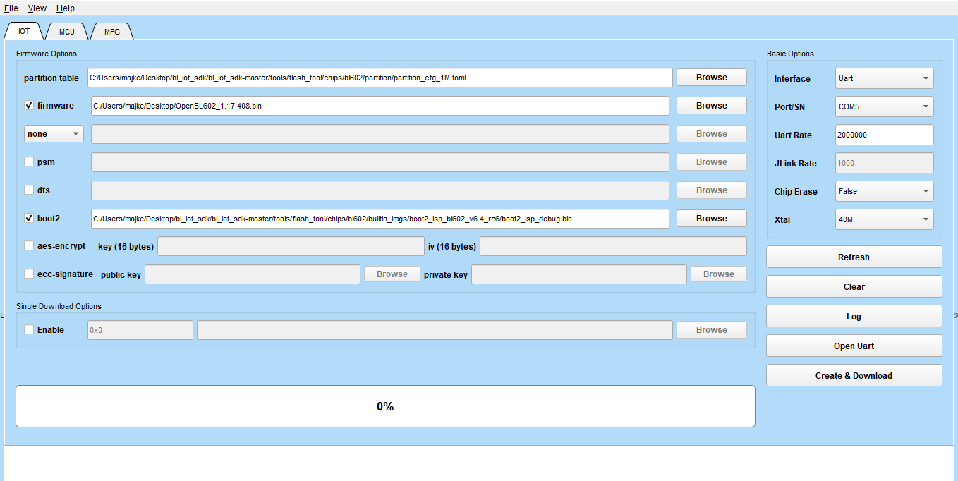

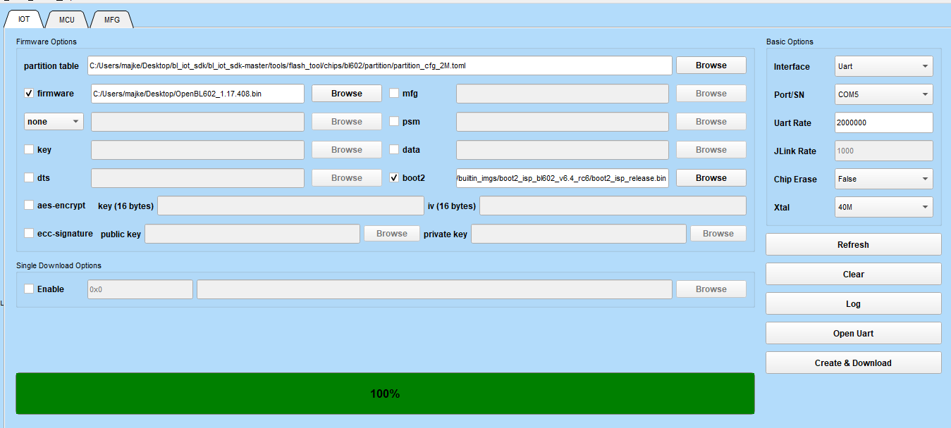

    Hi,
    I did a lot of testing today - my logs look similar. I read through the serial port after uploading various *.toml, boot*.bin files and unfortunately none of the configuration fired up the wifi. I am attaching the configuration and logs.
    The *.toml files mentioned vary between versions - I have used from 1.4.8 through 1.8.0 to 1.8.8 and none fixed the issue.
    If there is a need to download the contents and upload, I can do so, just need to be supplied with the knowledge of how to do it. Thank you for your help!

    These TOML files what they say you are uploading are from the latest SDK from Github, from Bouffallo Lab?
    If so, then try to use files from our old SDK, the one that OpenBeken/OpenBL602 uses:
    https://github.com/openshwprojects/OpenBL602/
    In other words, BLDevCube use new but TOML old.
    But as I say, it's basically guessing, with BL602 I had little to do, it's not a very popular platform...
