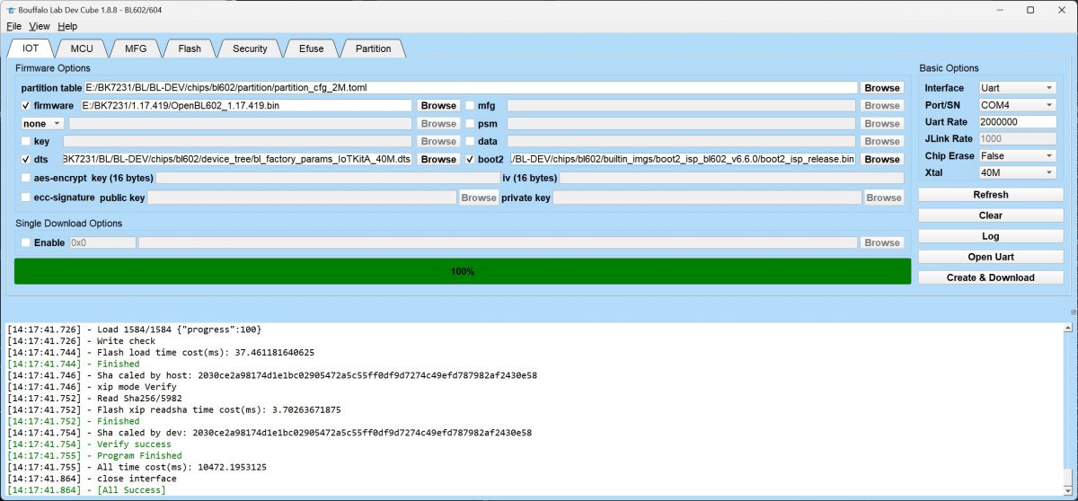

    I researched the BL602 flashing procedure again, and it seems that the way I flash the BL602 may not be 100% correct. So, I followed a YouTube tutorial using BL-DEV.
    Now, all my WiFi sockets have their own MAC addresses :) Bouffalo Lab Dev Cube 1.8.8 software interface with BL602 flashing settings.

    This solution resolved my problems :) both sockets get their own MAC address. Thanks sonnyk88

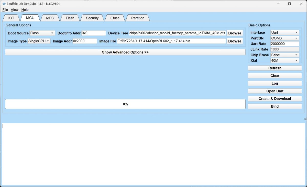

    I think BL602 firmware does not have a problem with the MAC address. Because of how I've flashed the BL602 originally. I wasn't using all files. Partition table (toml), firmware (bin), boot2 (bin), and dts (dts). Because I saw a YouTube tutorial about the settings (4 items). I filled in all four items. After flashing BL602, the original MAC showed up. :)
    This is what I used originally, which caused the MAC issue.
    Screenshot of Bouffalo Lab Dev Cube showing settings for BL602.
    But I still couldn't figure out how to dump the whole flash from BL602 using the advanced option. :(

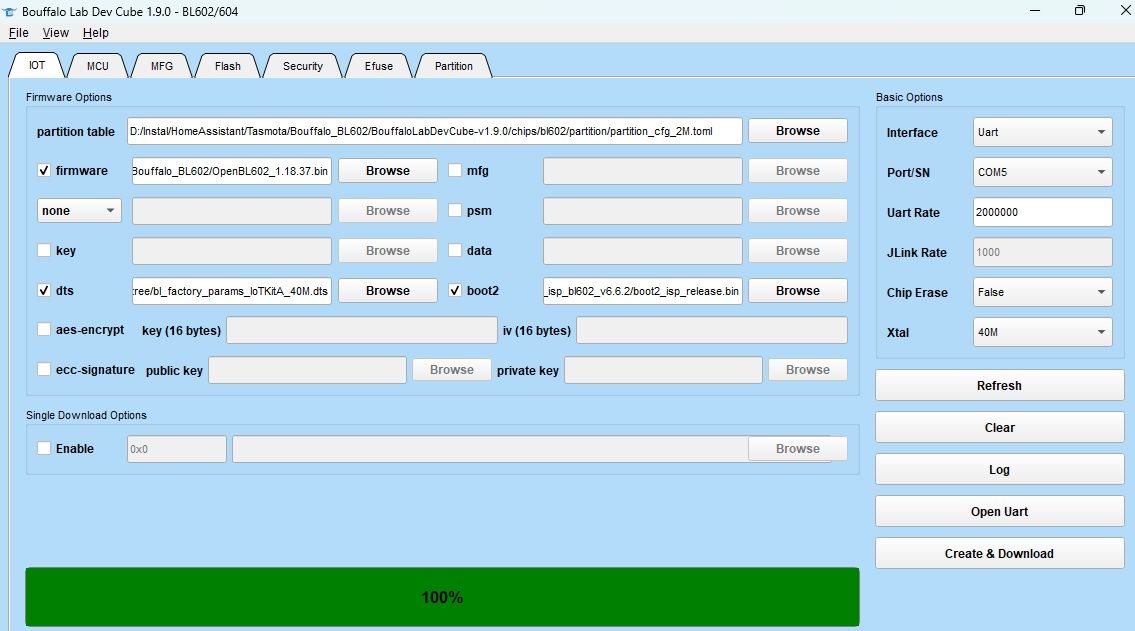

    Oh, I wasn't paying attention and I got into the same situation. Two sockets originally eWeLink RMC021s BL602L20. Flash and both same MAC address C0:50:43:C9:00:01. Problems with assigning IP address.
    I checked the video again and the problem is that I forgot to mark boot2 and dts.
    After re-flashing, the socket will get the original MAC address and can set a unique IP.
    Thank you very much
    Radek
