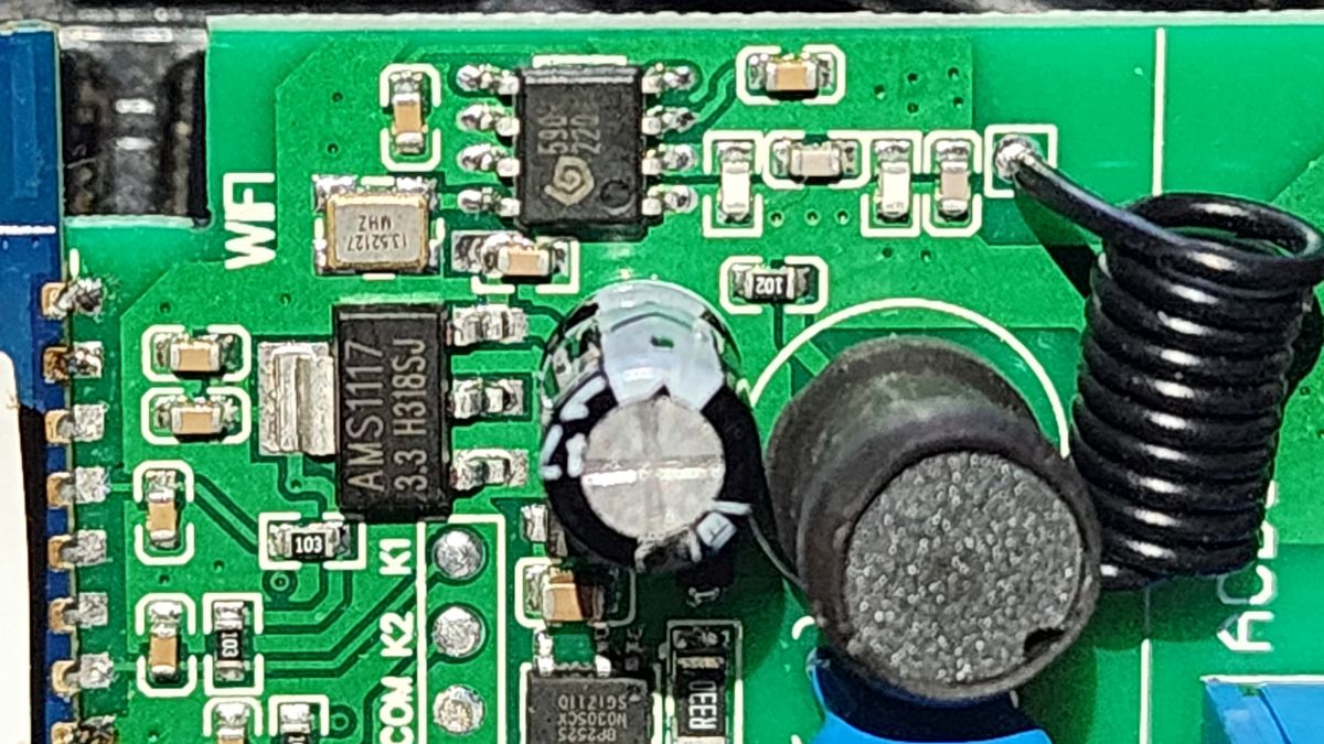

    Hi guys,
    I bought a 2CH switch that supports remote function for RF433. I found it difficult to configure or find something similar to it.
    However, I managed to make controllable relays using the GUI or buttons. I am unsure what to do next.
    pins:
    "6": "Rel_n;1",
    "8": "Btn;0",
    "9": "Btn;2",
    "14": "Rel_n;2",
    "24": "Btn;1",
    "26": "WifiLED_n;0"
    I need help figuring out how to use the reset button ("8") and programming/using the RF function. Can someone please assist me?

    How is RF on your device implemented? Is it done via separate IC that handles buttons, or is RF receiver connected directly to WiFi module?
    If the external IC is handling RF, then it should still work after firmware change. On the other hand, if RF receiver is connected directly to WiFi module, then you have to wait a bit, we don't have a driver for that yet, there is some initiative to do some porting: https://www.elektroda.com/rtvforum/topic3983995.html#20940597

    Thanks for the response.
    I suspect that it is wired on the IC in the photo. If you can confirm this, I would appreciate it if you could tell me how to create channels to learn the remote. Previously, I was able to do this through the Tuya app, but after the firmware change, I'm having trouble figuring out how to do it.
    Close-up of an integrated circuit on a circuit board with visible electronic components.
  • #4 21219677
    jahara
    Level 4  
    The 433 MHz remote signal is available on P7. I was able to get access to it using Esphome Libretiny.
