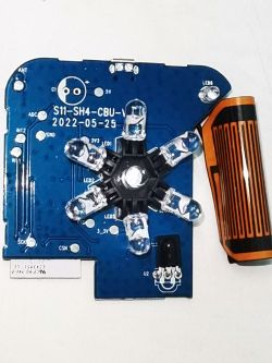

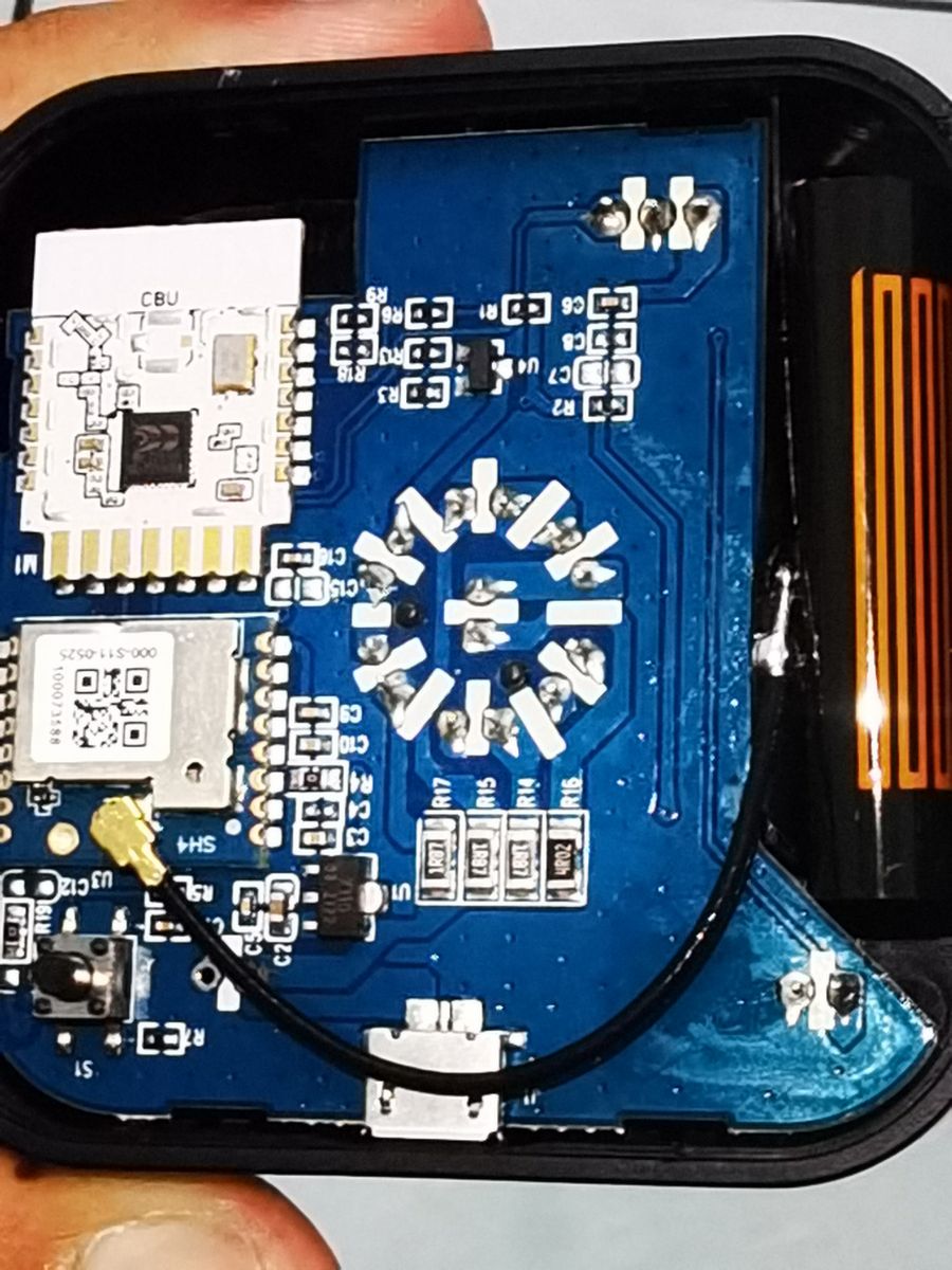

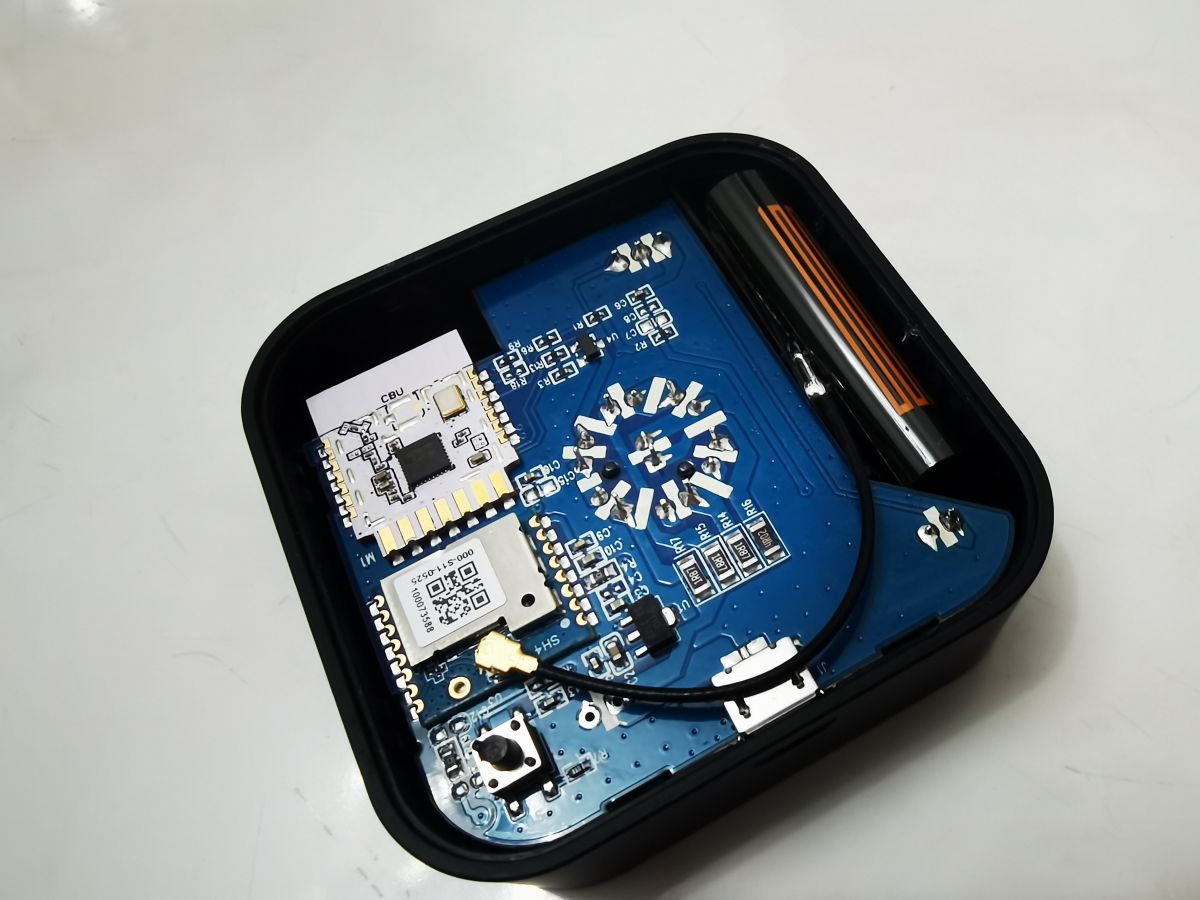

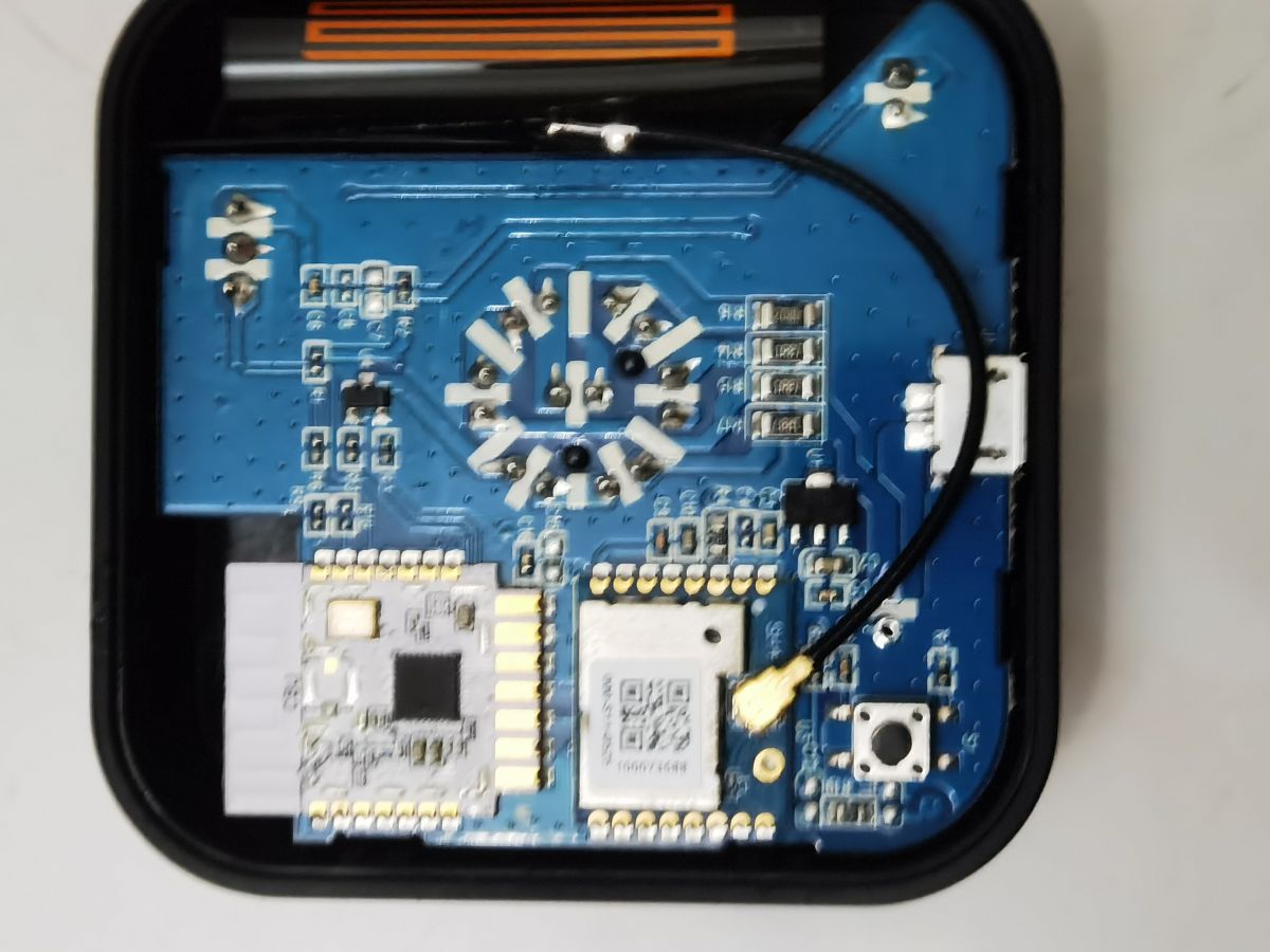

Tuya SmartLife Universal IR+RF WIFI REMOTE Control Smatrul PCB CODE S11-SH4-CBU-V2.4
hakimmuhiddin 12909 32
  • #1 20618377
    hakimmuhiddin
    Level 4  
    PCB CODE: S11-SH4-CBU-V2.4
    Tuya SmartLife Universal IR+RF WIFI REMOTE Control Smatrul PCB CODE S11-SH4-CBU-V2.4 Tuya SmartLife Universal IR+RF WIFI REMOTE Control Smatrul PCB CODE S11-SH4-CBU-V2.4 Tuya SmartLife Universal IR+RF WIFI REMOTE Control Smatrul PCB CODE S11-SH4-CBU-V2.4 Tuya SmartLife Universal IR+RF WIFI REMOTE Control Smatrul PCB CODE S11-SH4-CBU-V2.4 Tuya SmartLife Universal IR+RF WIFI REMOTE Control Smatrul PCB CODE S11-SH4-CBU-V2.4 Tuya SmartLife Universal IR+RF WIFI REMOTE Control Smatrul PCB CODE S11-SH4-CBU-V2.4
    Added after 11 [minutes]:
  • #2 20618479
    Posts: 14615
    Help: 655
    Rate: 12632
    Hello, can you attach the OBK template from the Web App? The JSON template?

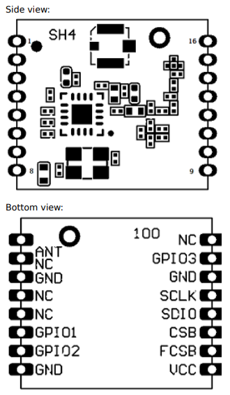

  • #4 20625156
    hakimmuhiddin
    Level 4  
    • SH4 Module Datasheet_Documentation_Documentation.pdf (667.86 KB) You must be logged in to download this attachment.
    • IR RF Remote Control_Documentation_Documentation.pdf (91.33 KB) You must be logged in to download this attachment.
