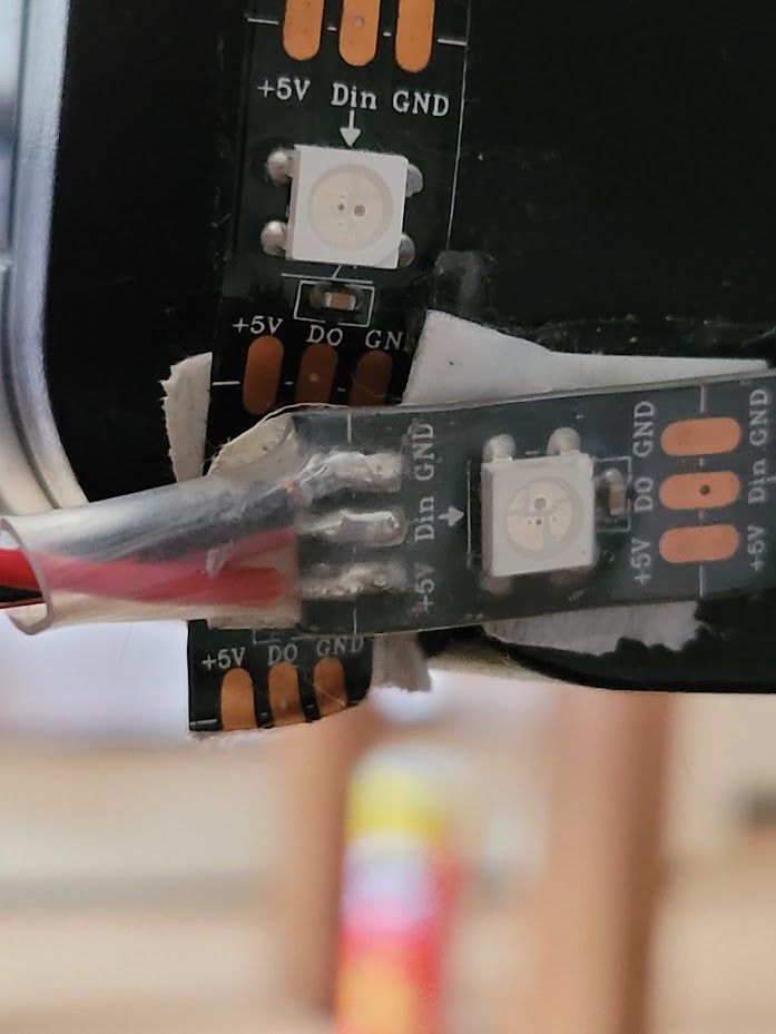

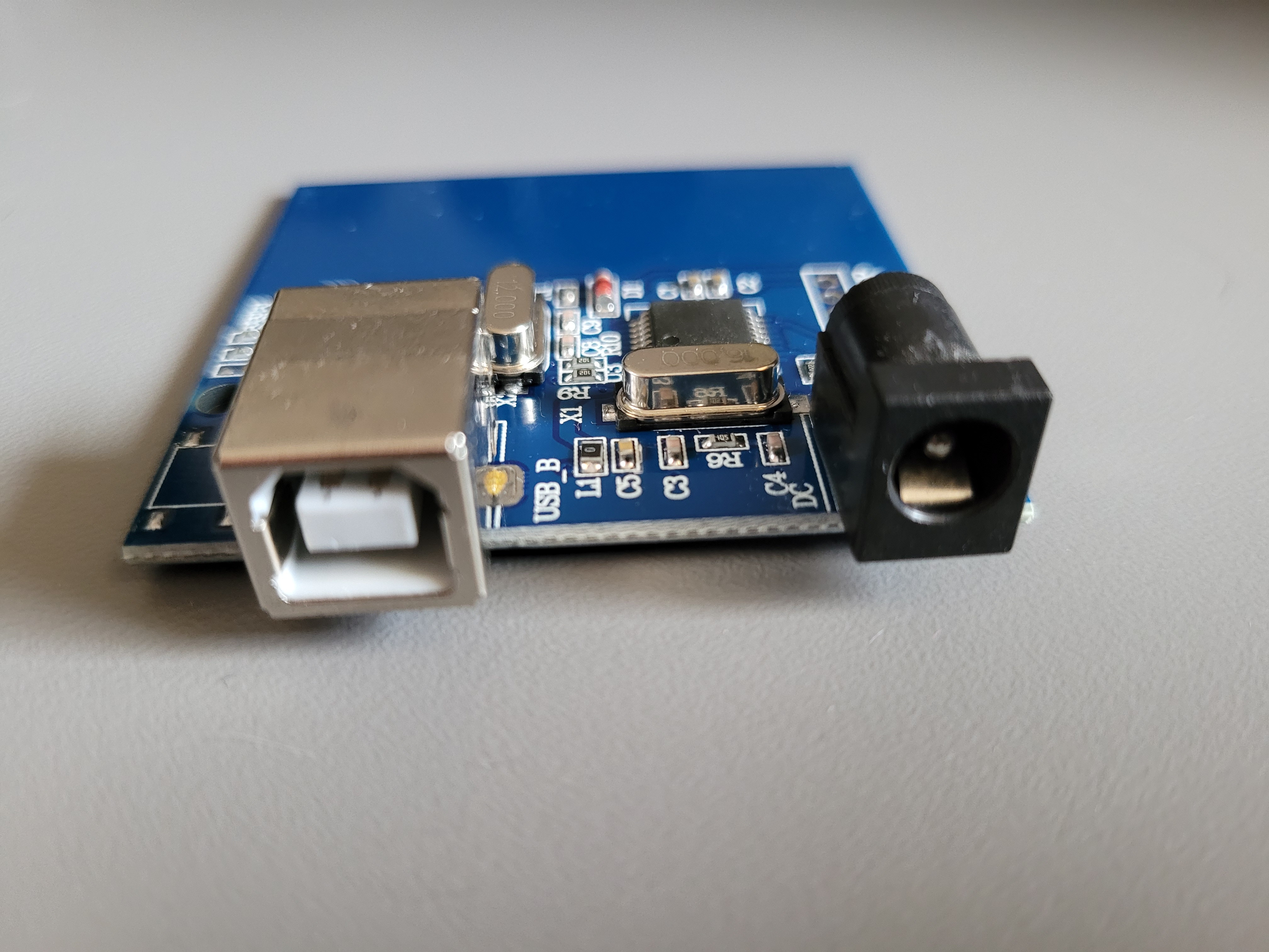

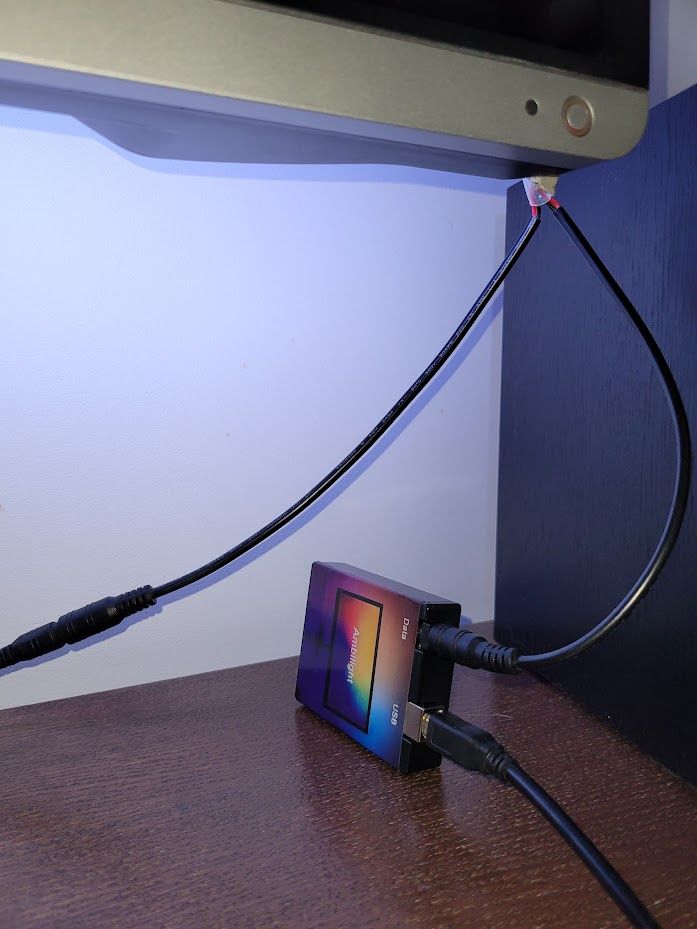

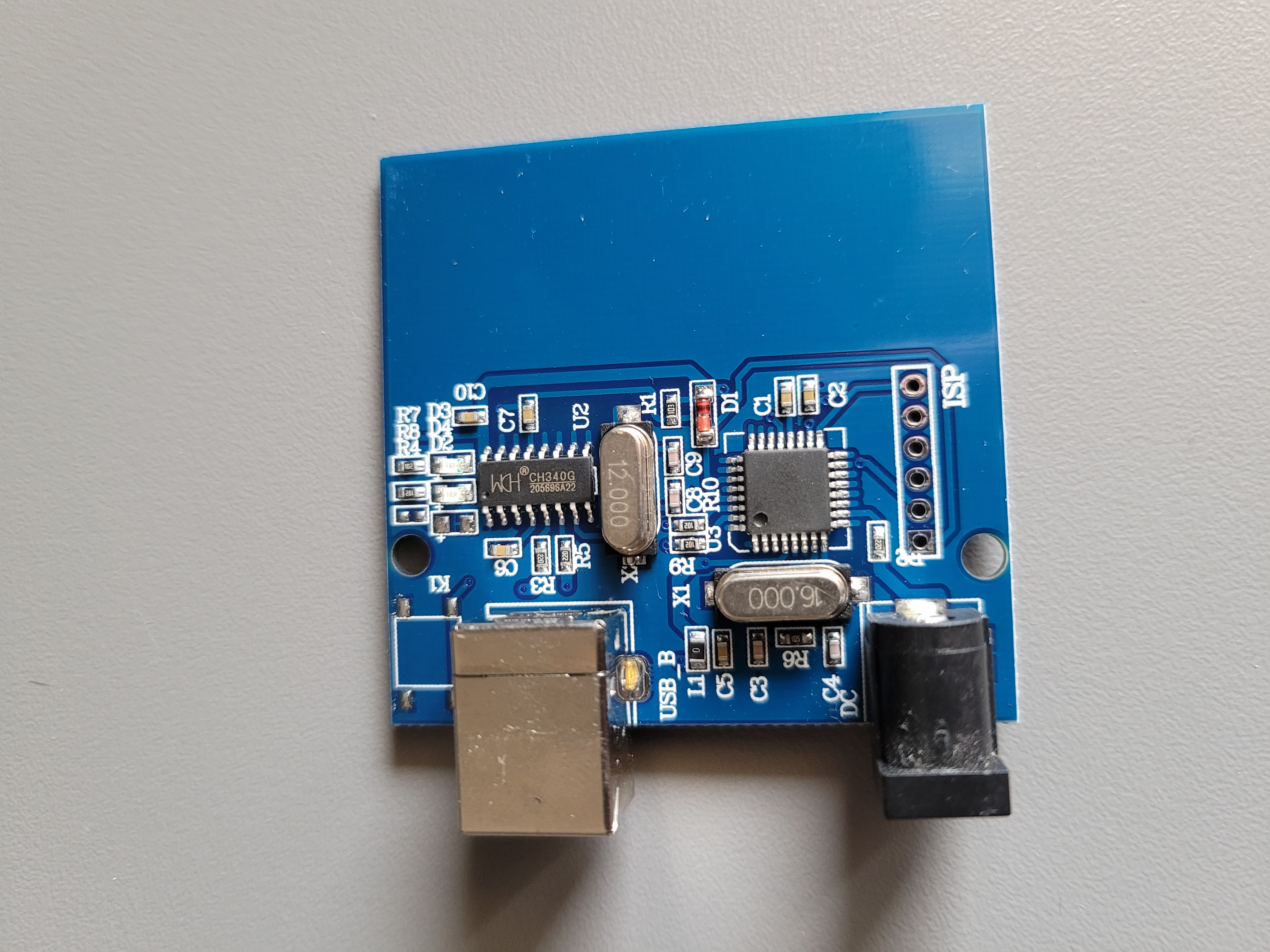

    I once bought an ambilight kit consisting of ws8212b led tape + some unspecified controller + power supply, and I would like to replace this controller with an ESP8266 to be able to upload WLED and manage the leds via the network, but I want to use the same power supply.
    Actually, it looks like I have 4 cables coming out of the led strip in two pairs (red + black), one pair to the power supply, while the other (data) to the controller + in the controller there is a USB input for image capture.
    Is there a chance in a relatively simple way to connect this strip and power supply to the ESP8266?

    I'm guessing the cables are made for the particular controller that came in the kit (from the led list I have two plugs, one goes to the power supply and the other to the controller). This is how you look at the output from the list
    LED strip segment with visible +5V, Din, GND labels and diodes.
    LED controller connected to a TV and power supply on a shelf.
    How do I hook this up with ESP?
    WLED setup and double-ground wiring for ESP8266

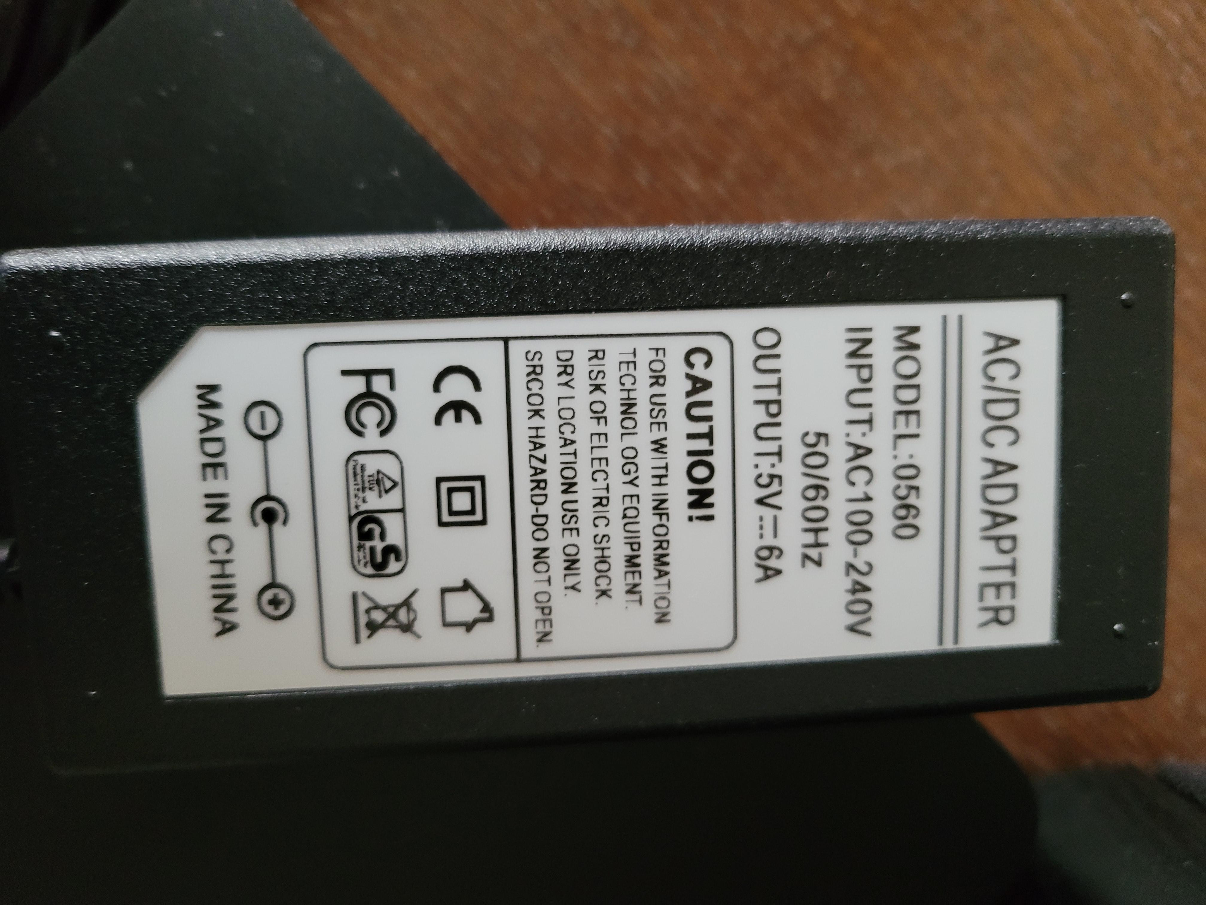

    w3501yyyy wrote:
    You connect the power supply and the "thicker" ground to the power supply. To the ESP you connect (in addition to the power supply) the "thinner" ground from the ribbon, and the signal cable.
    I understand that I leave the power supply as it is clipped now in the picture, yes? I connect the other two cables to the ESP (ground - black and signal red), and the power supply somehow I have to add separately?

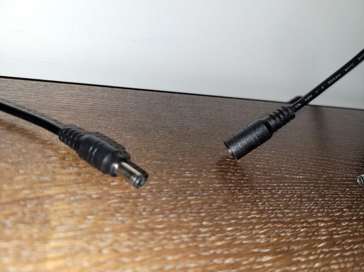

    malymakar
    Posts: 17
    So I would have to somehow distribute these PSU outputs into two?

    The ESP8266 has a 3.3V logic, it requires a 3.3V power supply, most modules can be powered from 5V, but it depends on what module you have. Leds won't necessarily work getting a 3.3V signal either, interference can occur.
