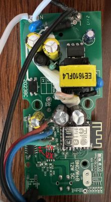

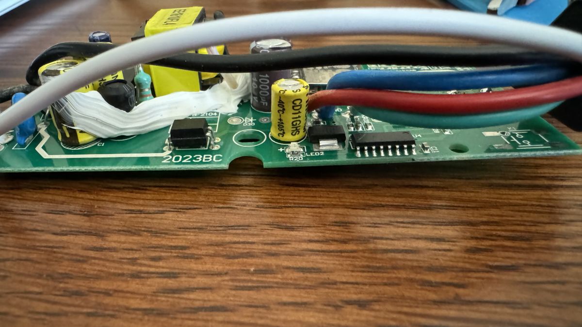

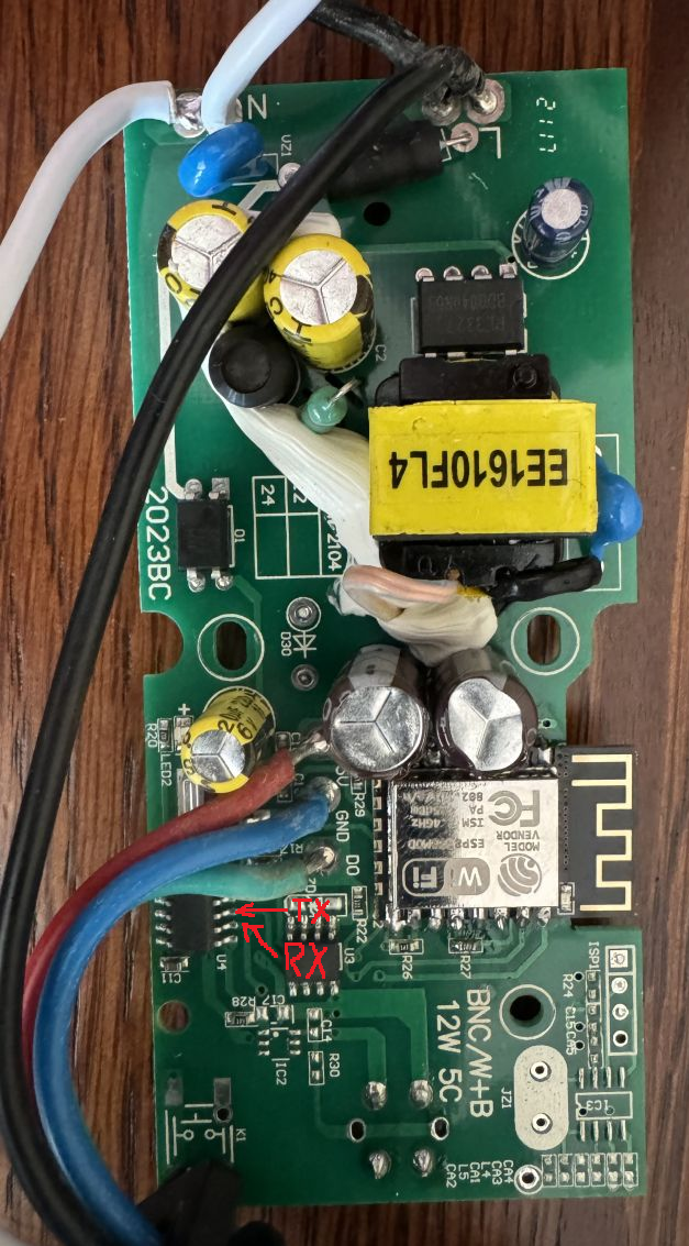

    Hello all, I have done a teardown of the HBN 36ft String Lights. I am trying to replace the brains from the WB3S that it came with to an esp8266, however I think I need to do something to cut the Tuya MCU's out of the mix. Could I please get some help identifying what it is that I need to do in order to get this working? I can provide additional images as needed.
    PCB with electronic components for HBN 36ft string lights. Close-up view of a circuit board from HBN 36ft String Lights with multicolored wires and a 2023BC marking. Close-up view of a PCB with electronic components.

    What kind of device is that? Is it RGB? RGB+CW? And if so, is RGB individually adressible or all LEDs are the same color?
    How are LEDs connected?
  • Tuya MCU still drives the RGB-WW LEDs
    #3 21105961
    brianroy86
    Posts: 31
    They are individually addressable lights, RGB-WW lights. It runs off of mains, there's a converter to drop it down to 5v, but the mains power runs through the cord and there is a plug at the far end of the LEDs so you can use it as an extension cord of sorts. However when I swapped the chip out and plugged it in, I still see the same effects as it had when the W3BS was there so the Tuya MCU must still be going something.
    Edit: the leds are connected via those 3 wires, red green and blue.

    Still.. for Tasmota, you need to desolder the TuyaMCU totally and connect DIN of LEDs to your ESP.
    Which of the SOIC chips on board is connected to RX/TX of the WiFi module and to the DIN of LEDs?

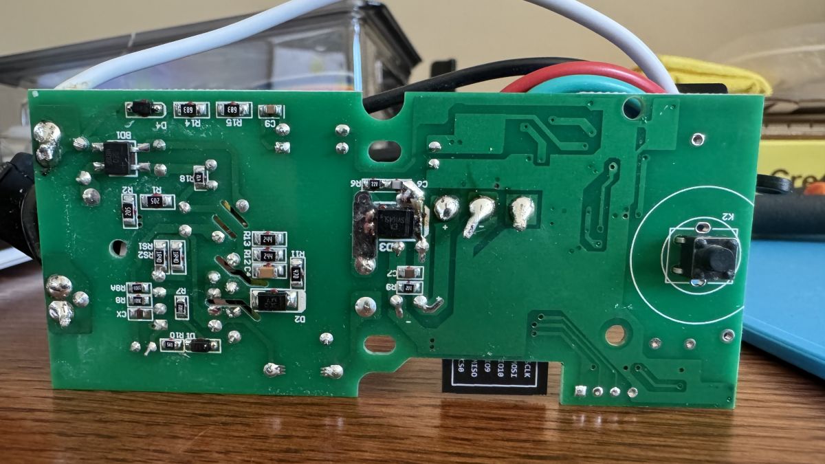

    IC = integrated circuit = this little one black thing with 8 legs (4 on right side, 4 on left). You have two of them on board.
  • #12 21108780
    brianroy86
    Posts: 31

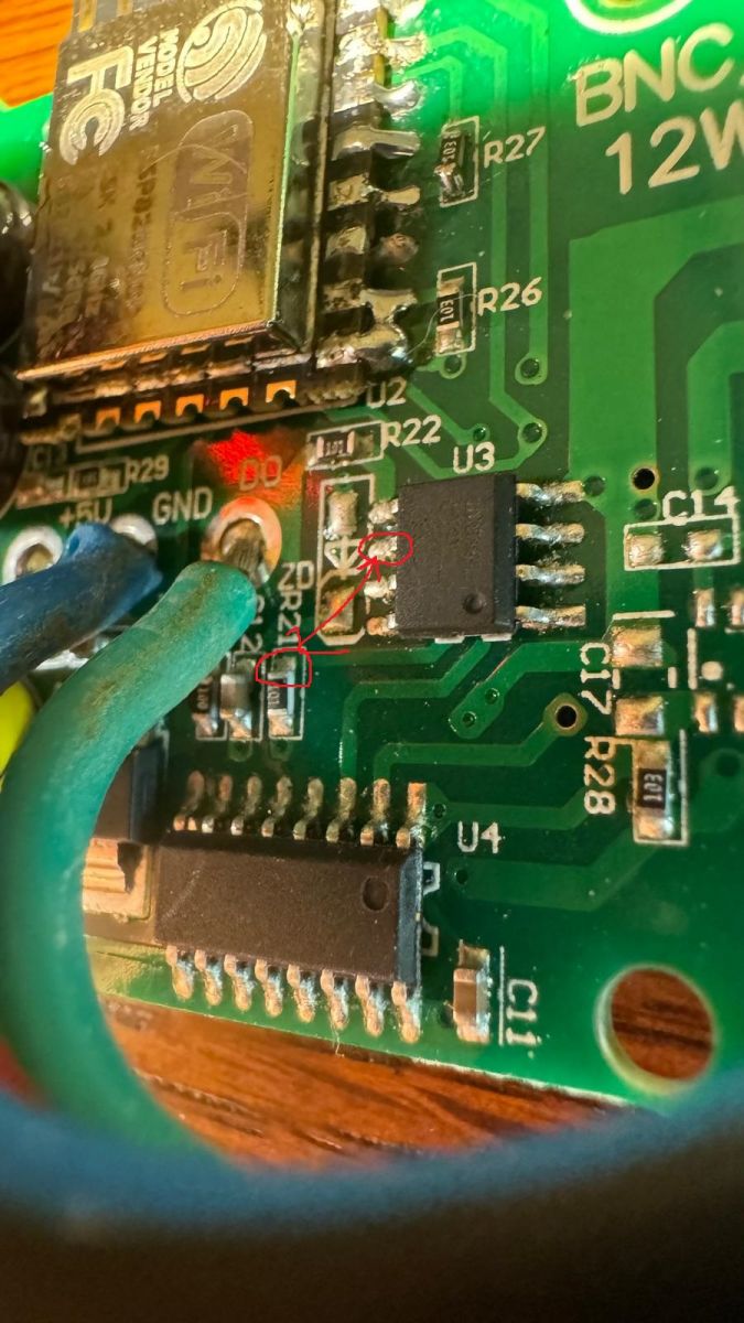

    OK, so I've done some testing and here's the results.
    GPIO1 is connected to the 6th leg on the top row
    GPIO3 is connected to the 7th leg on the top row
    These are the pins near the label U4
    Edit for clarification
    PCB with visible components, connectors, and markings.
  • #13 21108795
    Posts: 14765
    Rate: 12899
    Ok and to which leg does DO wire (marked as DO on PCB) connects to?
  • #14 21108807
    brianroy86
    Posts: 31
    It does not appear to be connected to any of them, can't get a beep out of the multimeter on either IC
  • #15 21108811
    Posts: 14765
    Rate: 12899

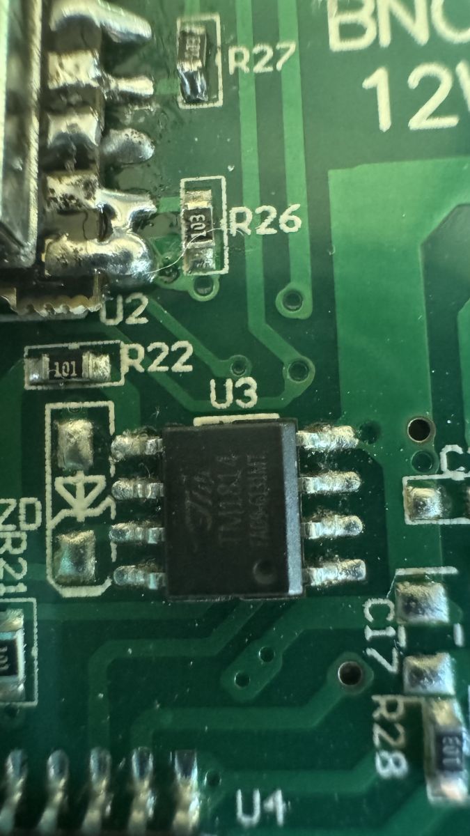

    okay so what is the marking on U3 chip?
  • #16 21108833
    brianroy86
    Posts: 31
    Close-up of a circuit board with visible electronic components and traces.
    It’s tough to see but here

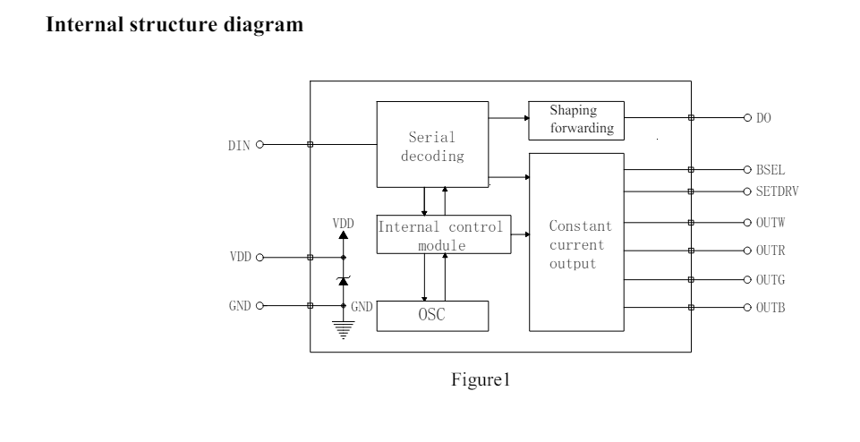

  • Remove TuyaMCU and keep TM1814 for ESP control
    #17 21108854
    Posts: 14765
    Rate: 12899

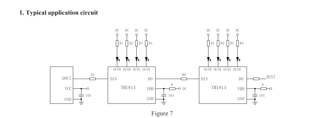

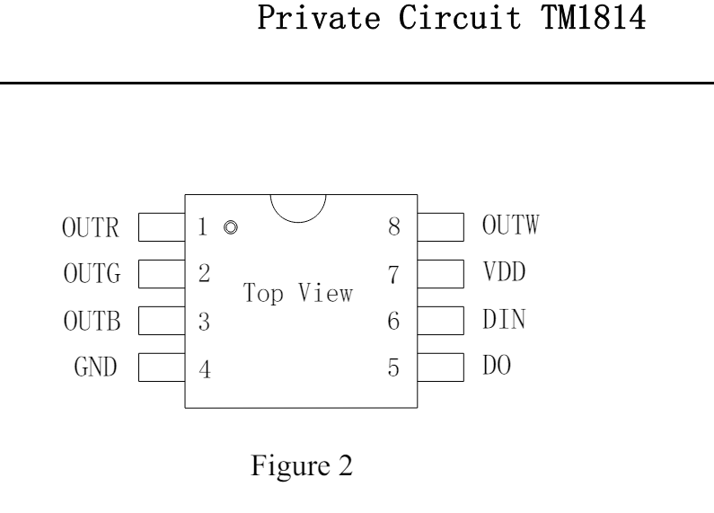

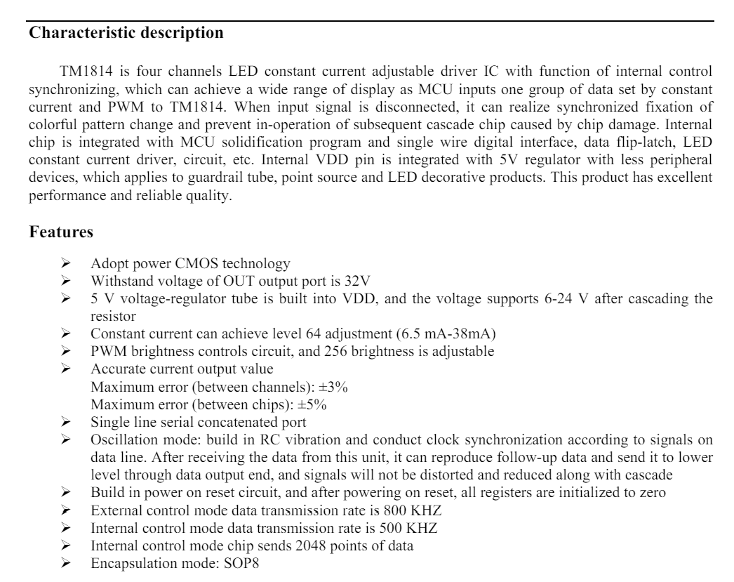

    TM1814..
    Technical documentation of the TM1814 chip Block diagram of the internal structure of an integrated circuit with inputs and outputs.
    usage:
    Typical application circuit for TM1814.
    Does WLED supports TM1814?
    https://github.com/Aircoookie/WLED/issues/1519
    Hmmm maybe it does?
    https://github.com/search?q=repo%3AAircoookie%2FWLED%20TM1814&type=code
    Yea, it seems so...
    So now,. where is the DIN leg connected?
    Diagram of TM1814 integrated circuit with pin labeling.
    DIN leg is probably connected to second IC (black large one with many legs), but where?
    You will have to remove that second large black IC (TuyaMCU) but you have to keep in place TM1814.
    Later we will need to connect TM1814 via DIN to ESP, but first we will need to read on how to connect it.
    PS: related link for future testing: https://github.com/Aircoookie/WLED/issues/3514

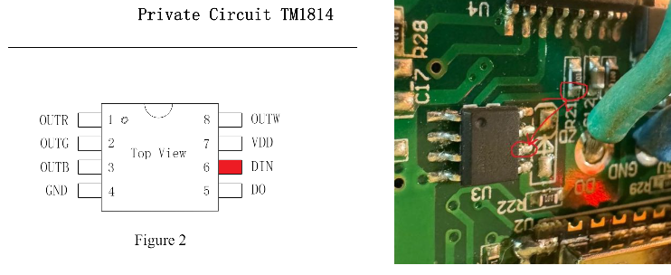

  • #18 21108884
    brianroy86
    Posts: 31
    Image of a circuit board with visible electronic components and a pin connection marked in red.
    I'm not sure if I'm looking at it upside down or not, but I believe that pin connects here
  • #19 21108949
    Posts: 14765
    Rate: 12899
    it seems ok:
    Diagram of TM1814 and photo of a PCB with a marked integrated circuit and connections.

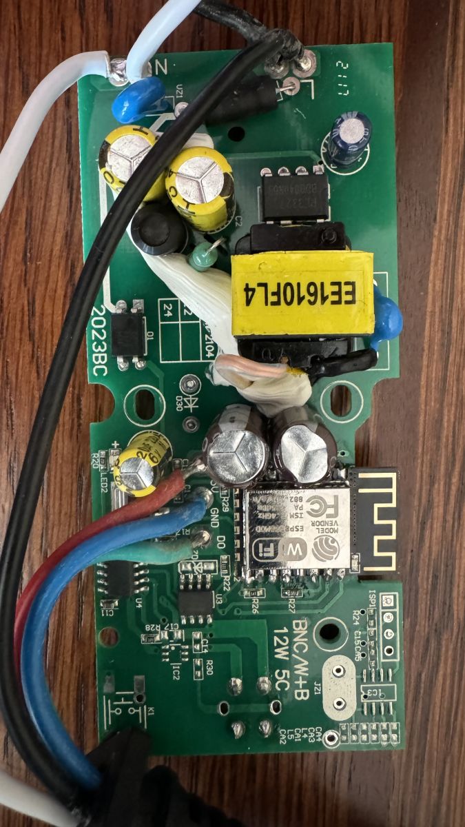

    Now you need to remove TuyaMCU (U4, black IC with many legs), can you do that? Do you know how to do it without breaking the PCB?
  • Desolder WB3S with braid and ask about bridges
    #20 21108975
    brianroy86
    Posts: 31
    I believe I can do it yes. I have a solder braid on the way from AliExpress, I would just put the braid on the pins and heat it up with the iron to suck up the solder, then it should just lift off. It seems a little too tight in there to go at it with a heat gun. I'd end up knocking something else off by mistake.
    Does that sound like a solid plan? Also after I remove that IC, would I have to make any other changes or bridges?
  • #21 21109028
    Posts: 14765
    Rate: 12899
    I think we also need to investigate how is the button connected. Also with multimeter. And connect it to ESP.
    Do you have flux? Flux is necessary. Also some Pb solder on pins can help. Don't forget the flux.
