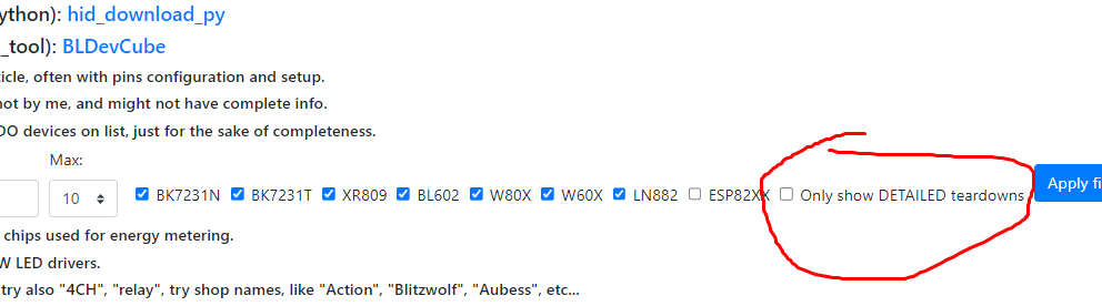

    Also worth a look at the list of devices, here:
    Select "show only detailed teardowns":
    Screenshot showing a list of platform selection options with the Only show DETAILED teardowns option highlighted.
    Then only detailed tutorials, presentations and tutorials from the forum will be shown after performing a search.
