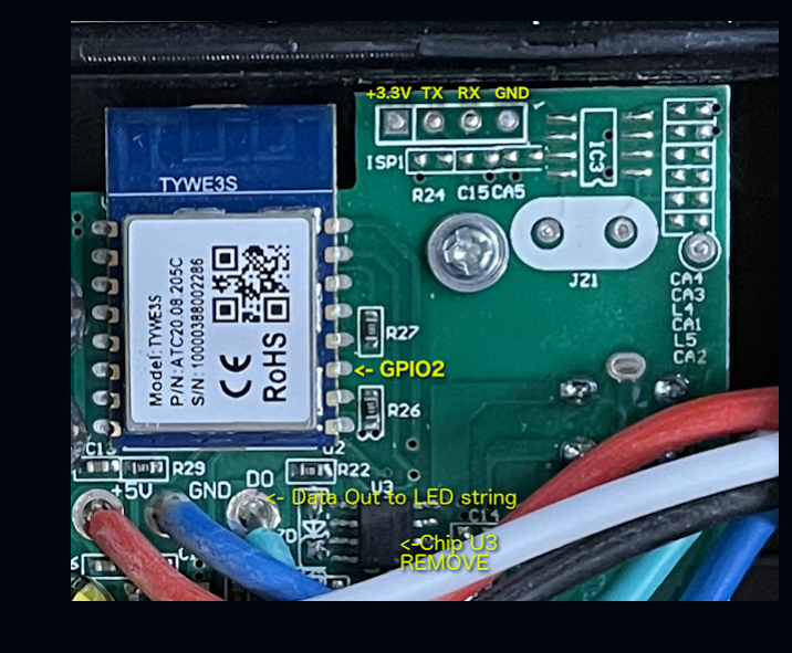

    I have a number of string lights coming from the Atomi Smart brand that were specifically appealing due to being individually addressable. Unfortunately, the Smart Life app does not allow for very much configuration of the lights beyond some poorly made scenes built into it. In digging around to replace that firmware with something more powerful, I've landed on openbeken.
    These lights are a bit odd when it comes to the wifi module. There's a very well written teardown at this blog that is for an older version of these lights using the TYWE3S module based off ESP8266. However, the ones I have (or at least the one I've opened so far) has a CB3S module. See the photos below.
    Close-up of the interior of a lighting module with electronic components and wiring. Label on the power adapter for Atomi Smart string lights with technical information.
    I was able to successfully flash OpenBeken to the device but I'm kind of at a loss for what the next steps are. I've read through this guide but I'm a bit new to this level of hardware hacking and was hoping for some guidance. I did try setting high/low on different pins in the GPIO finder but saw no reaction from my lights.

    BTW, I looked into the linked article, it seems they remove U3 which is the MCU of TuyaMCU, but I don't think it's good solution, it would be better to use it:
    Close-up of a circuit board with a TYWE3S module and pin labels, as well as a removed chip U3.
    Do you have original firmware backup (2MB)?

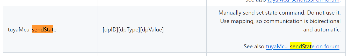

    Is there a way for me to replicate sending the data that was logged when the power/scene button is pressed and modify bits of it to see what changes?
    I would suggest making first UART capture with out analyzer https://github.com/openshwprojects/TuyaMCUAnalyzer and observing what operation in Tuya app causes which packets to be send on original tuya firmware, but in obk, you can also manually send states with:
    tuyaMcu_sendState	[dpID] [dpType] [dpValue]
    Table with tuyaMcu_sendState command in documentation.
    For example, you can use it to send dpID 1, bool, which may be power on or off:
    Info:TuyaMCU:TuyaMCU_ProcessIncoming[ver=3]: processing command 7 (State) with 12 bytes
    Info:TuyaMCU:TuyaMCU_ParseStateMessage: processing dpId 1, dataType 1-DP_TYPE_BOOL and 1 data bytes
    Info:TuyaMCU:TuyaMCU_ParseStateMessage: raw data 1 byte: 1
    Later, you can just remap dpID to a channel in OBK, to get a WWW panel button. Add the following to your autoexec.bat script:
    setChannelType 1 toggle
    // linkTuyaMCUOutputToChannel dpId verType tgChannel
    The following should set channel 1 of OBK to toggle, and then map it as a boolean to dpID 1. Then you will get a button on WWW panel of OBK. When you toggle this button, this will automatically send setting of dpID 1 (boolean) to either 1 or 0 to TuyaMCU. This will also receive changes from TuyaMCU (for example, if your device has a physical button that is connected to MCU).
    Read more at: https://github.com/openshwprojects/OpenBK7231T_App/blob/main/docs/autoexecExamples.md

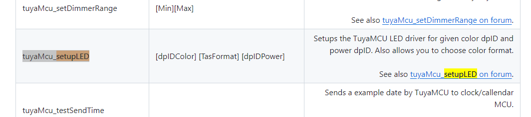

    Hello, it have been some time ago and I don't remember exactly where we've stopped, but have you seen the tuyaMcu_setupLED command?
    Table with tuyaMcu_setupLED command for TuyaMCU.
    Here is more info:
    https://www.elektroda.com/rtvforum/find.php?q=tuyaMcu_setupLED
    Here is our commands list:
    Here are autoexec.bat samples:
    Maybe we can try to use tuyaMcu_setupLED for your device or at least try to alter it to support your case?

    Hello! It's been a while since I had the time to come back to this project. I've had a little success using OpenBeken on some simpler devices and I have more confidence now in trying to get these lights working. As things stand, my personal testing with these lights has found the TuyaMCU chip to be severely lacking in options for controlling the lights. I have given up personally on exploring that anymore as what I want is full control over the individual LEDs and the TuyaMCU at best allows setting 2 alternating colors.
    I have one string of lights that I have wired up as described in the teardown linked from my first post but I am trying to use the existing CB3S module flashed with OpenBeken instead of replacing it with an ESP32. I was hoping you could assist with instruction on what my next step should be in trying this out. The setup is:
    CBS3 chip flashed with OpenBK
    I have removed the TuyaMCU chip entirely from the board to prevent it from conflicting
    A voltage shifter has been wired up between the CBS3 which outputs 3.3v and the 5v the LED lights are expecting (I understand this was previously done by the MCU chip)
    Pin 7/GPIOP_6/PWM0 is wired to the D0 wire through the voltage shifter
    The LED string should be GRBW
    I understand that with this setup I should be sending serial commands to the LED string through GPIO 6. What I'm not sure of is how to configure OpenBK to do so. The individual LEDs use TM1814 chips. The teardown post links to a WLED github issue that explains some of the particulars of this chip. I'm not sure if OpenBK already knows how to communicate with it.
    If this does work then it's slightly more effort than simply flashing the device, but ultimately it's just remove the MCU chip and wiring in the voltage shifter.
