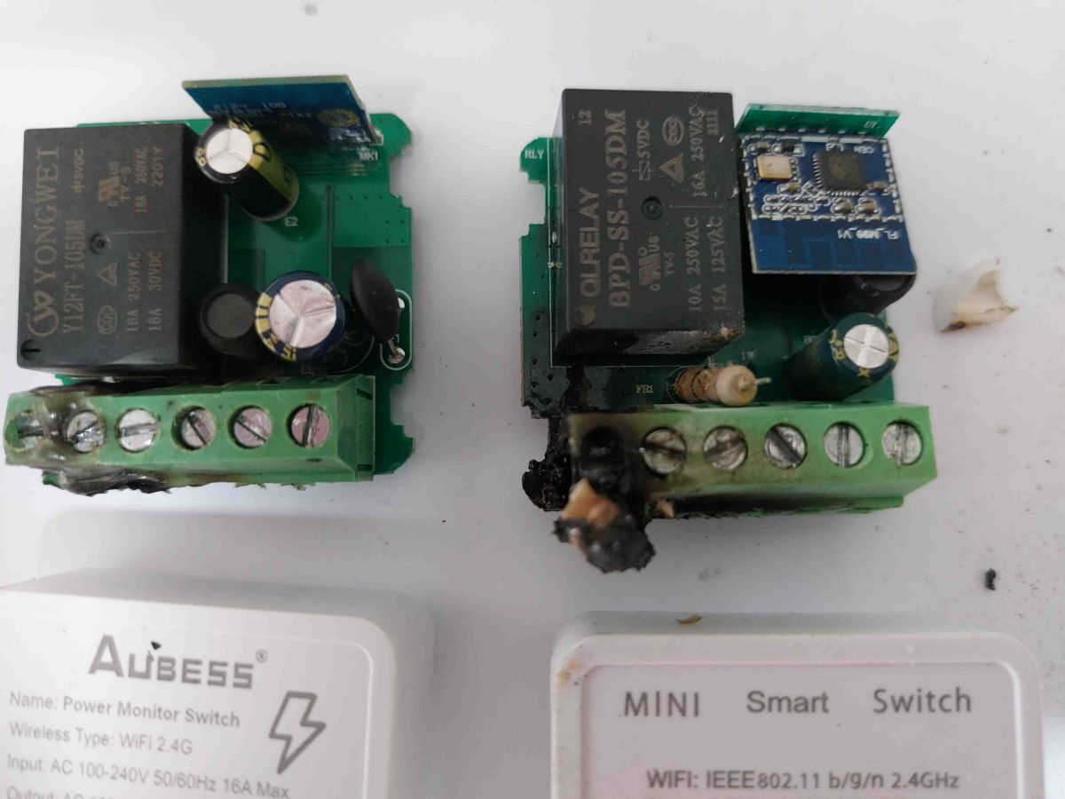

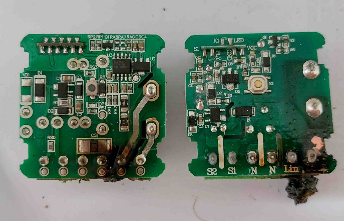

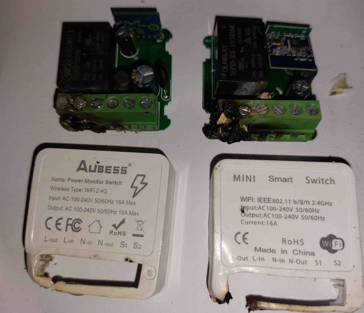

    Hi I used 2 smart switches,
    "Mini Smart Switch" worked for 1 year and blew up.
    "Aubess" worked for 1.5 weeks and blew up.
    I'm connecting those Smart Switches to a boiler which requires about 11000mA (~220V).
    Anyone had this problem? Can I fix it by soldering better components if I get a new one?
    If it is a known problem and can be fixed by replacing components, which components should I replace and what are the best choices for replacement?
    Thanks.

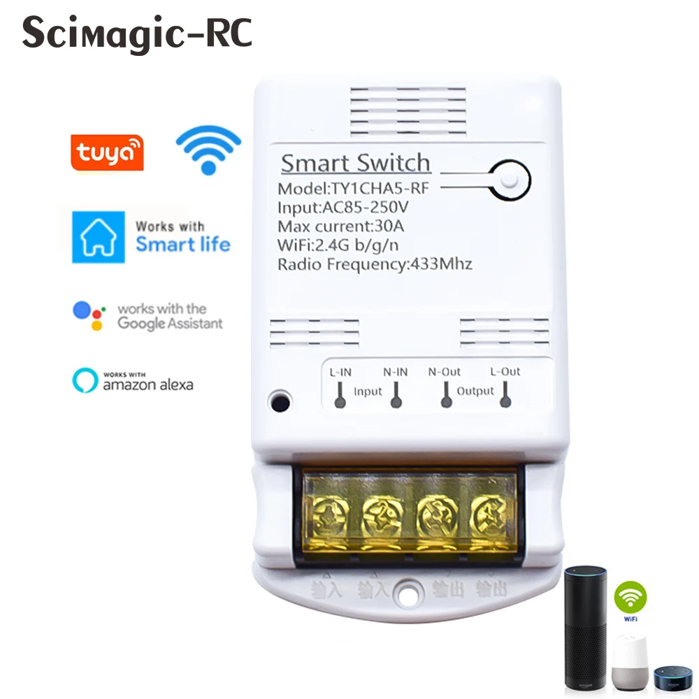

    This looks very bad. That's why I would never use such a cheap low quality device for high-power appliance.
    I'd rather consider going with a higher current model, like that one:
    Scimagic-RC smart switch with technical specifications.

    However, you said that the problem is caused by the device low amp rating, how positive are you that that is what is causing the blow-ups?

    I think that amp rating is not just the relay, it's also the screw terminal. The screw terminal on bigger device looks solid and rigid, while the terminals on cheaper devices are loose.
    Or are you suggesting that it is not the device fault?

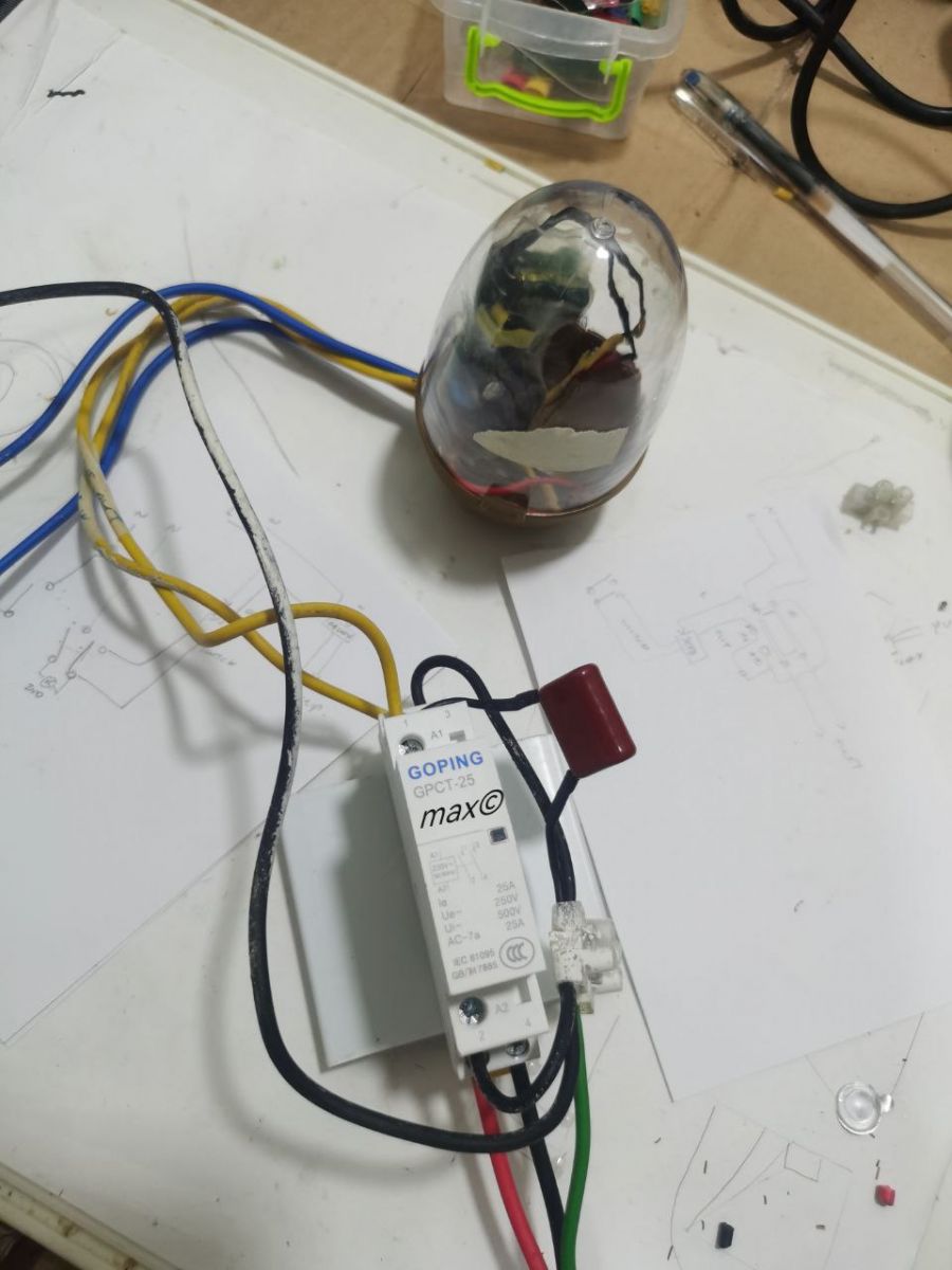

    You could add a contactor to the mini switch
    Electric contactor with connected wires on a workbench.
