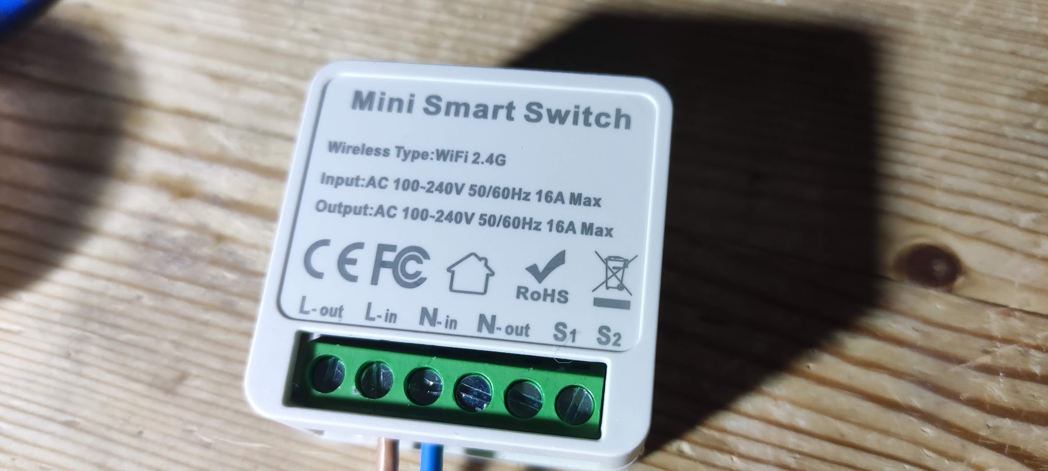

  • There has been many versions of Mini Smart Switch.
    1. Aubess 2gang Mini Smart Switch BK7231N /CB2S
    2. mini smart switch - Belon BL2028N-
    3. ZN268131 WB2S BK7231T WiFi Smart Switch that allows you to connect a bistable button
    4. Cheapest Wi-Fi Switch You Can Buy For Your Smart Home
    I came across another product which has diferrent internals but with CB2S/BK7321N.
    Mini Smart Switch - CB2S BK7231N Based
    Software version was V1.3.8
    I tried tuya-cloudcutter with many different profiles for BK7321N but was not successful.
    Manual Flashing was the only way forward.

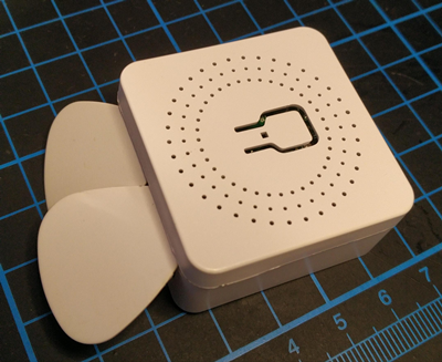

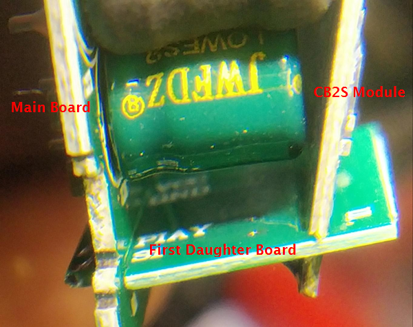

    1. Opening the device was very easy. I used several guitar picks to release the tabs on the four corners.

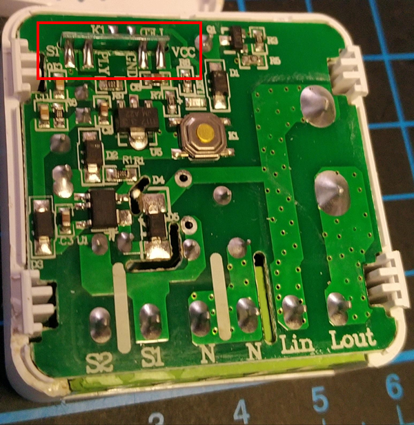

    2. There were two daughter boards with CB2S module connected to a shorter daughter board (very similar to attaching the WB2S module in link 3 above)

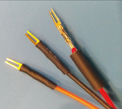

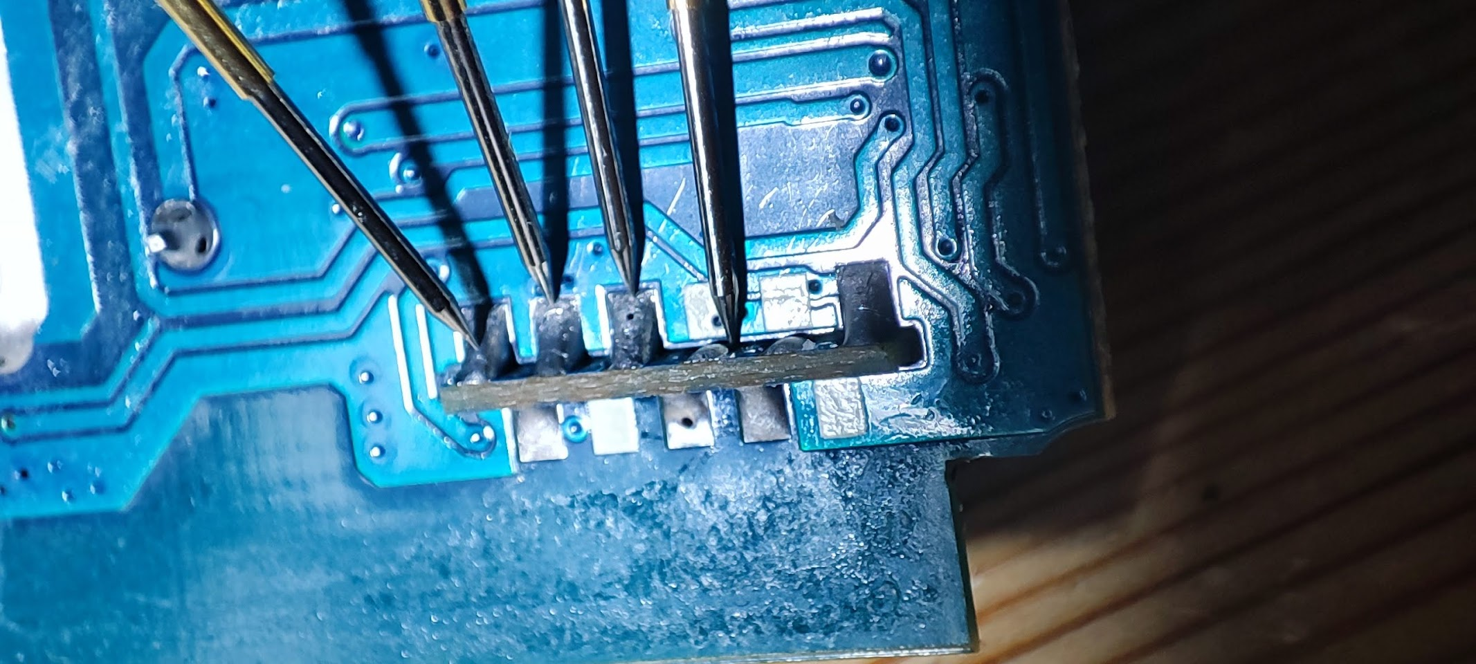

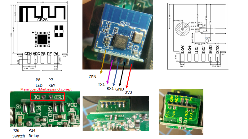

    3. Instead of soldering wires I have decided to try out a different method to secure jumper wires to the soldering pads mechanically using custom made clips like these
    I made these by removing the pins from a female header connector and then crimping the fork like metal pin to a female jumper wire connector as shown.

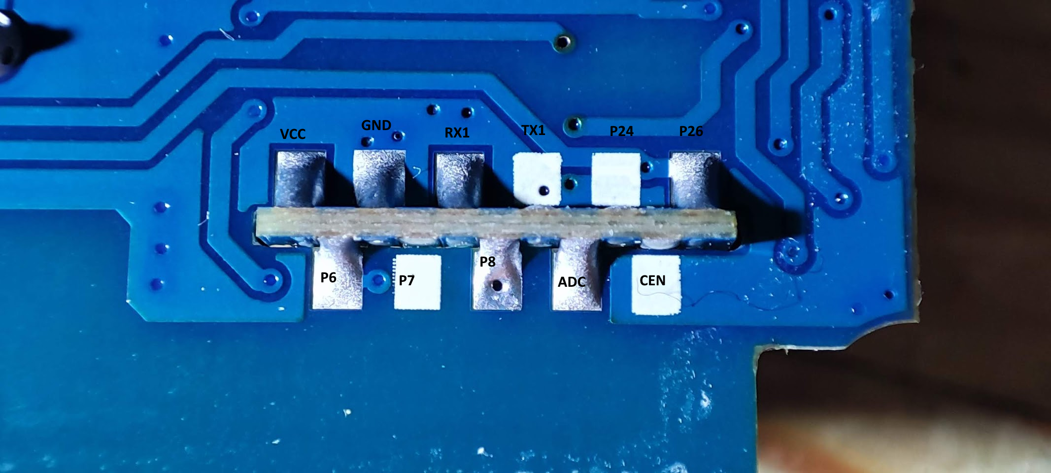

    4. Plan of the connections

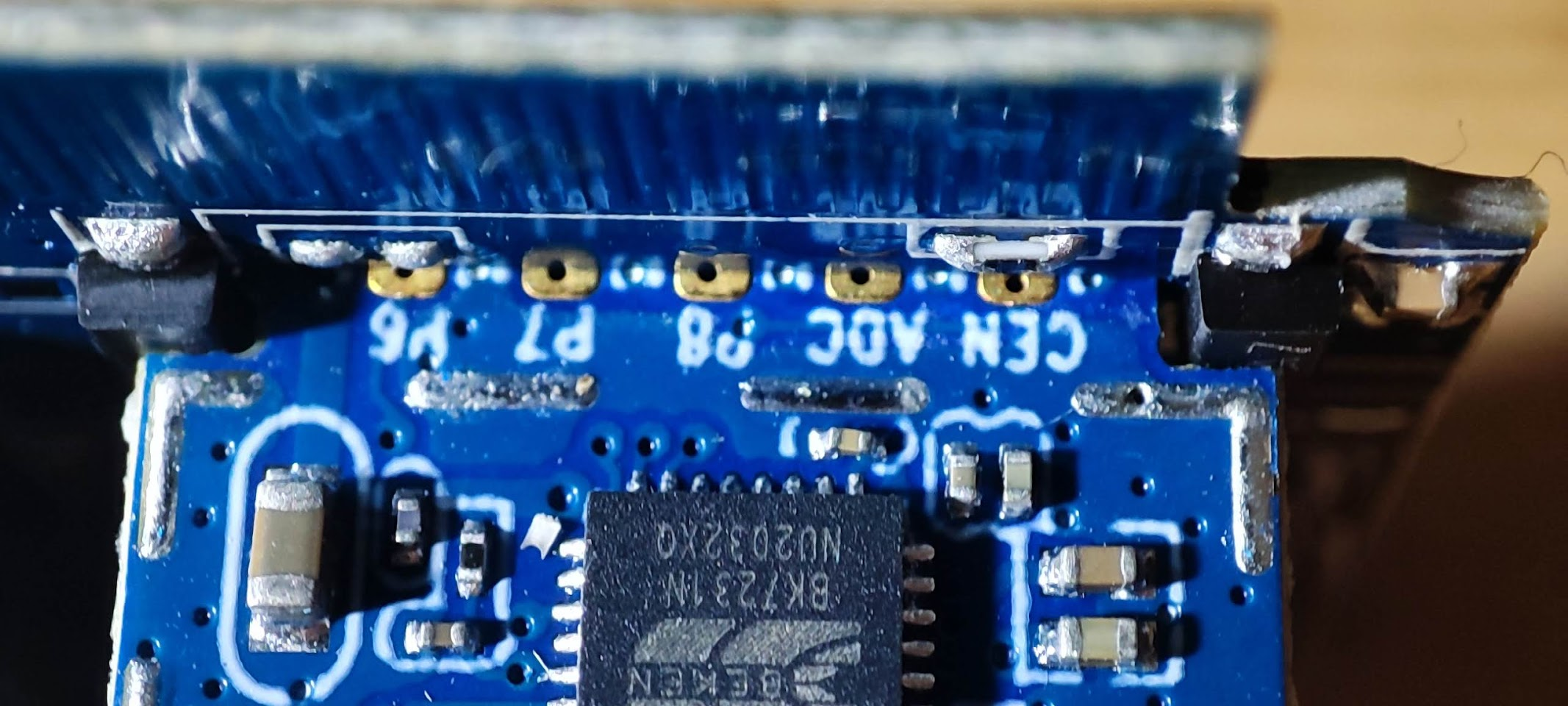

    5. Since the CB2S module has pins on both sides which are arranged as alternate slots, my attachments can be secured so that only one side is touching a pin. However one has to be careful not to let the pin touch adjacent solder pads on either side.
    The leftmost pin touches the solder pad on the top side of the PCB while the rightmost 4 pins touches TX1, RX1, GND and 3V3 solder pads on the bottom side.
    BTW, the TX1, RX1 pins have no connections to the daughter board. So no worry about removing the CB2S module for flashing.
    6. Used python uartprogram for flashing
    During dumping the existing firmware use of default high speed baudrate was successful. I used option to lower the baudrate to a very very low value and it was successful but took a way long time.
    Flashing new firmware at default baudrate was successful.

    Also note: some of similar devices are using RX/TX pin of CB2S/WB2S to control button or a relay, so it might be easier to just desolder whole WiFi module and program it outside of the board.
    The image above shows WB2L_M1 but it's similar for WB2S and CB2S

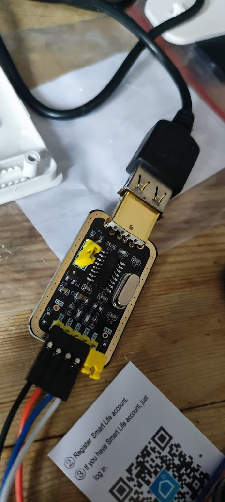

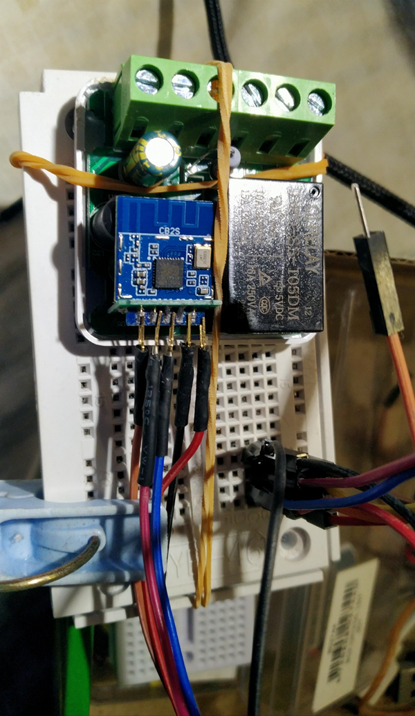

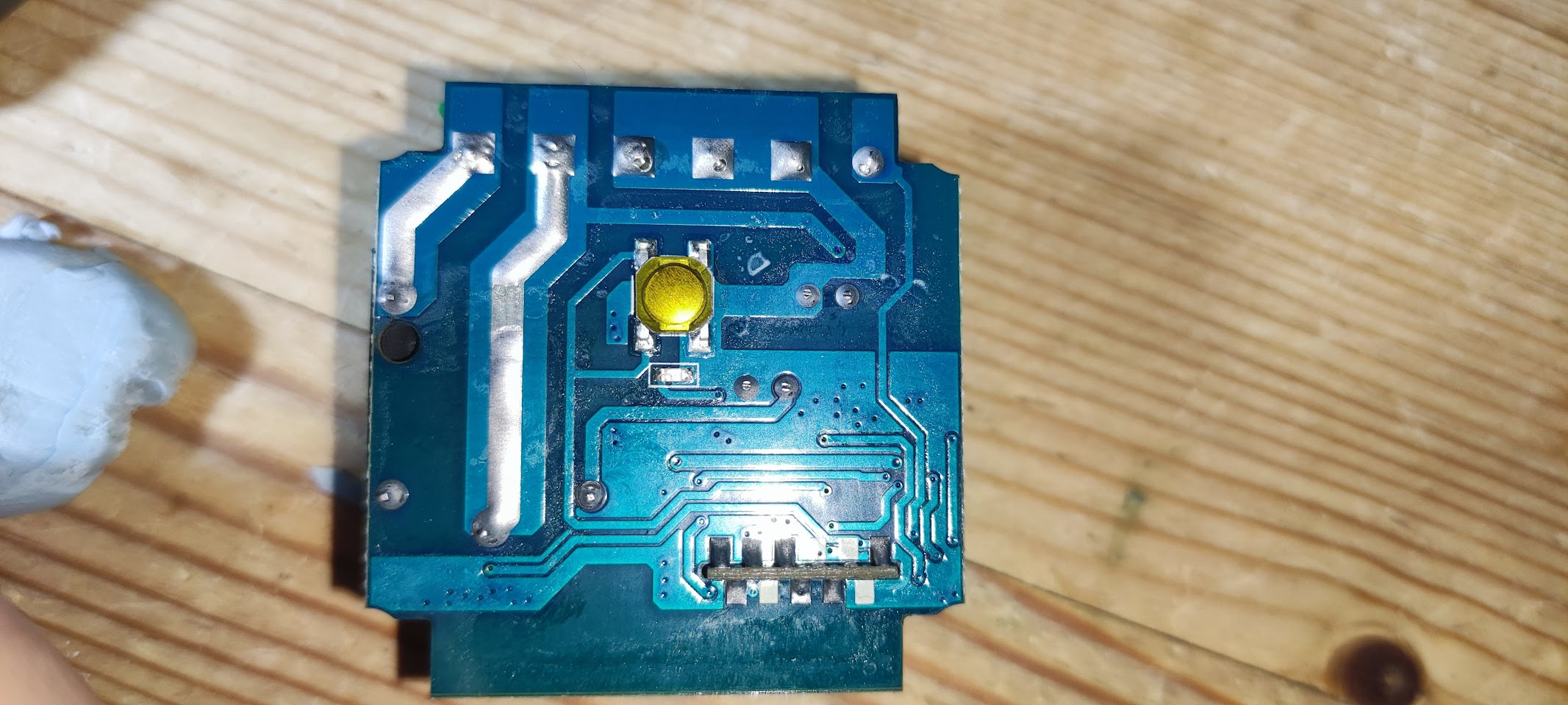

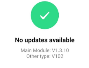

    I've a similar mini switch with CB2S but not a riser/daughterboard. I've confirmed continuity between usb-serial pins and the end of my pogo pins, and the unit is powering so ground and vcc are fine.
    I just cannot get touching CEN to begin acknowledgment in BK Easyflasher, however long I hold CEN connected. Did you have any difficulty with yours @jkwim ?
    also, with the power off/on method - how do you do this without interrupting the com port? mine drops out of device manager and BKflasher just stops with no com port error.
    Close-up of a circuit board with labeled solder points VCC, GND, RX1, TX1, P24, P26, P6, P7, P8, ADC, and CEN.
    Electronic circuit board with a yellow button on a wooden background.
    Wiring connections with an electronic module on a desk. Close-up of a circuit board with several connected pogo pins.
    Screenshot displaying No updates available message, indicating Main Module version V1.3.10 and Other type V102.
    Close-up of a circuit board with visible pins labeled CEN and ADC on a blue background. Mini smart switch with a power-off icon and Common Functions label.
  • #4 20853221
    Posts: 14790
    Rate: 12937
    COM port should never drop, how do you power that? COM may drop if there is a large capacitance on the device and you power it via 5V to the 3.3V LDO on the device board, that's why I usually just desolder the WiFi module. I don't even use CEN, I just do power off/on cycle.
    Also, your wires seem long, this may cause flashing problems.

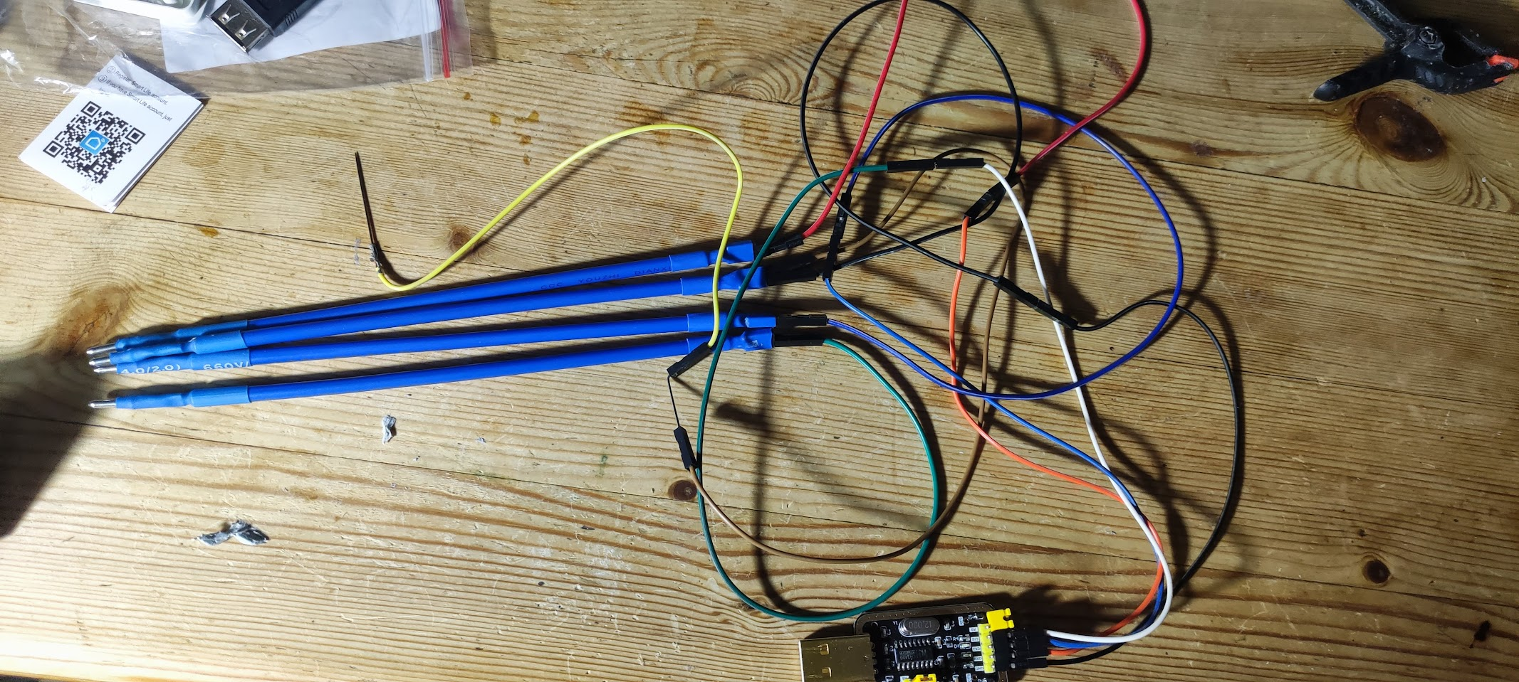

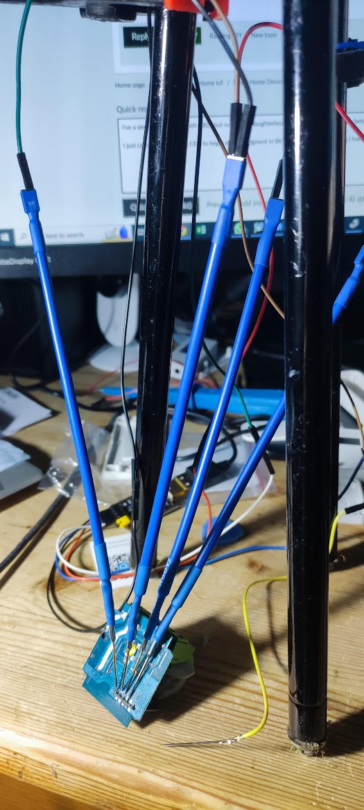

  • Long jumper wires may be causing COM port drops
    #5 20853248
    Posts: 5232
    Help: 449
    Rate: 918
    >>20853216
    hello! thanks for replying so quickly.
    it's just 3.3v from the usb-serial adaptor, not via 5v or anything. I was trying to avoid desoldering because I'm not convinced I'll get it back in again!
    it's possible the wires are too long, I've had to join two jumper wires for each pogo pin to the usb device. I need more male-female. I could try shorter with what I have.
    not sure why the com port is dropping. I am only disconnecting the power pin from the usb adaptor end when I do power cycle :(
    I don't have a breadboard, but surely removing and reinserting into a breadboard is the same as disconnecting from usb-serial...
    Electrical wires connected to a USB-serial adapter on a wooden surface. USB-Serial adapter connected to wires on a wooden table.

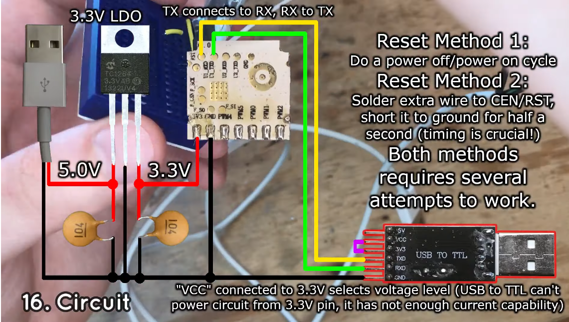

  • #6 20853276
    Posts: 14790
    Rate: 12937
    Have you watched our tutorials?
    It's been stated many times that USB to UART adapter will not provide enough current and it's recommended to use external one. Or at least a better one, like a 3.3V from Arduino, which can be used also as USB to UART converter as long as you put Atmega in RESET state

  • #8 20853328
    Posts: 14790
    Rate: 12937

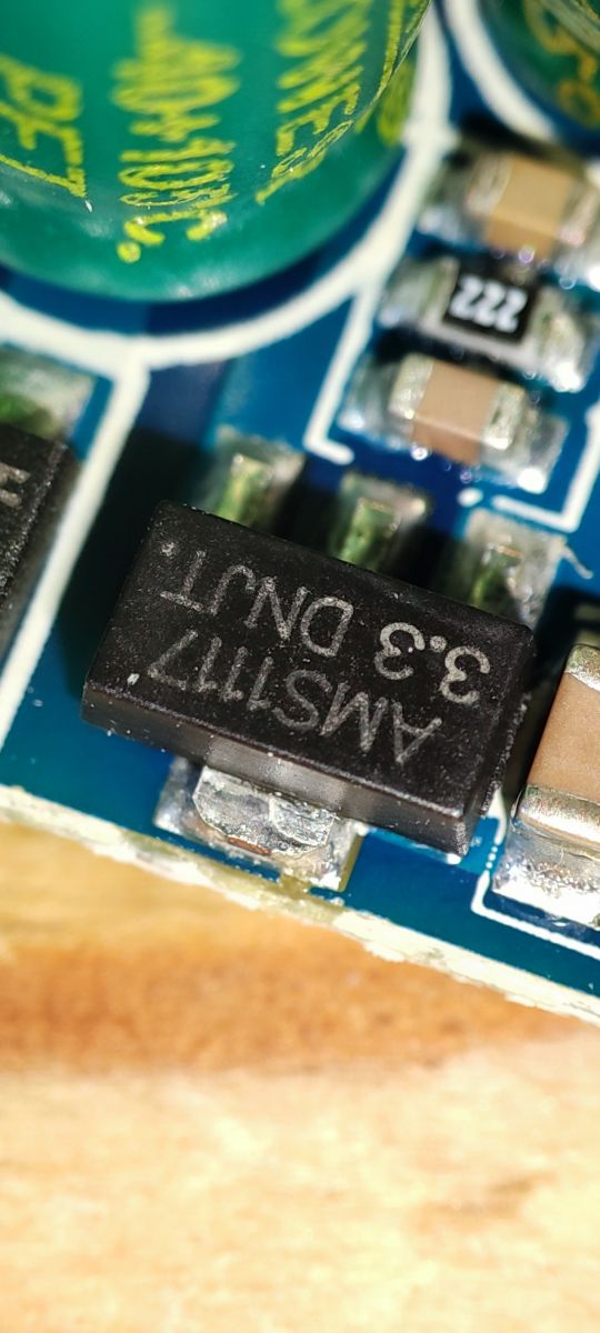

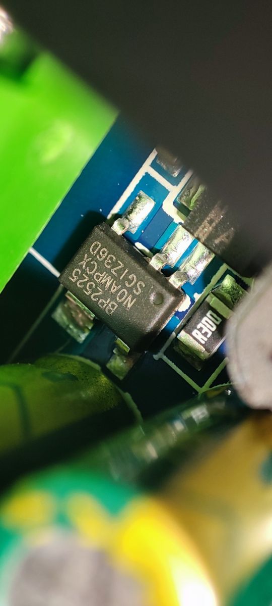

    Maybe that's not needed. Is there an AMS1117-3.3V visible on your board?
    It is possible to connect 5V from USB to the input of that AMS1117-3.3V LDO and reset via disconnecting that 5V connection.
  • #9 20853335
    Posts: 5232
    Help: 449
    Rate: 918
    Yes, there is an AMS and a BP
    Close-up of an electronic component marked as BP2525 on a circuit board.
    Close-up of electronic components on a printed circuit board, including a black chip labeled AMS1117 3.3 DNLT.
  • #10 20853381

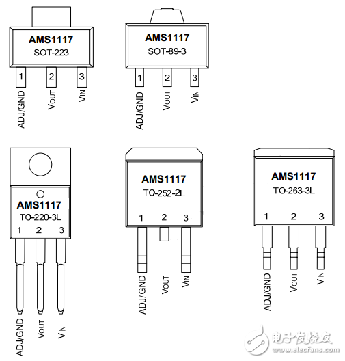

    Posts: 14790
    Rate: 12937
    Here is AMS pinout:
    Pinout examples of AMS1117 in SOT-223, SOT-89-3, TO-220-3L, TO-252-2L, TO-263-3L packages.
    You can flash your device by soldering GND, 5V from USB, RX and TX . Then you power off/on by disconnecting 5V.
  • No flashing despite external 3.3 V and multiple USB-TTL adapters
    #11 20855897
    Posts: 5232
    Help: 449
    Rate: 918
    thank you. I got this yesterday so could have a separate 3.3v and some more male-female wires (and a 10k resistor for BL602 in the future). Yes my external 3.3 and usb-ttl are connected for common ground.
    https://www.amazon.co.uk/dp/B01ERP6WL4
    curiously, there is still no flashing it seems. My wires are now single length between each leg. I've tried 3 different USB-TTL adaptors (CH340 and 2x (probably fake) FTDI). Nothing after CEN or powering on/off 3.3v (COM port no longer drops when external 3.3v is switched).
    I saw in this thread https://www.elektroda.com/rtvforum/topic3977701.html from @erlipan2001 that they updated the original post to warn of RX being grounded, but I do not have continuity to ground with the RX on this device, so don't think it's that (assuming there would be continuity if it was this issue?). There is no power monitoring chip.
    I've tried 115200 and 9600 baud. I'm guessing my next step can only be unsoldering the board. Or trying hid_download_py

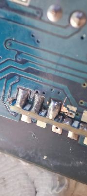

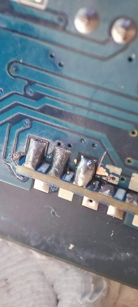

  • RX removal fixed OpenBeken flashing on CB2S
    #13 20857170
    Posts: 5232
    Help: 449
    Rate: 918
    woohoo. finally did it. it was actually the RX in the end. unsoldered it with wick and flux and it flashed straight away to OpenBeken.

My flash still fails—could RX be grounded?
Yes. Some boards link RX to ground or buttons. Remove the solder blob or desolder the module; users reported instant success after lifting RX [Elektroda #20857170].
How do I safely desolder the CB2S module?
  1. Flood the pads with flux.
  2. Heat the row with a wide-tip iron while pulling gently with tweezers.
  3. Wick excess solder, then reflow to reinstall. A full removal takes <60 s with 350 °C heat [Elektroda #20855927].

Which baud rate is optimal for uartprogram?
Stick to the default 115 200 baud. Dumping at 9 600 baud is 12× slower and risks timeouts [Elektroda #20359513].
How can I enter the bootloader without using CEN?
Disconnect 3.3 V for one second, reconnect while keeping TX/RX wired. The chip auto-detects UART and starts the boot ROM [Elektroda #20853221].
What OpenBeken GPIO map works for this one-gang switch?
Configure: P26 Relay1, P23 Channel1 button, P10 Pair button, P8 Wi-Fi LED. This matches the Tuya JSON dump [Elektroda #20857170].
