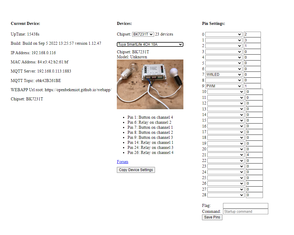

    and there is a 3rd option, to try one of the pre configured "quick config". i tried the 4 gang switch and then removed the none-working buttons. Tuya Smart High Power Switch for Boiler Water Heater
  • #13 20195803
    Posts: 14677
    Help: 656
    Rate: 12701
    Please note that those hardcoded configs are obsolete, now we are using online devices database, here:
