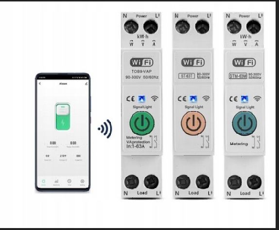

  • DIN rail Tuya relays offer 40A to 63A switching

    At a colleague's place, I used a Sonoff which controls the contactor - only the soft changed to Supla. The upside is that there is no problem and even 3-phase connected heaters can be switched on. The downside is that there is no view of consumption and no voltage reading from which to override the heaters, and you need another energy meter from which to download this to the cloud. It has been running smoothly for 18 months at the moment. I have also added additional temperature sensors mounted on the cylinder to view what is happening to the water.
    Added after 39 [minutes]: .
    I would add that there are also DIN rail versions under Tuya of relays with current and voltage measurement that handle 40A or 50A, and also 63A. There the relays look quite decent.
    If you want to cede these damaged Gosunda's then let me know what and how on prv.

    @madamsz1 then if I have a 2000W heater (maybe one day I will replace it with a 3000W one) - then such a Tuya relay for din rail is enough for me ?
    Gosund SP 111 plug - overheating and excessive current consumption .
    Specifications:
    Supply voltage: AC 76V - 265V
    Relay rated current: 10A 16A 20A 25A 40A 63A
    Frequency: 50/60Hz
    Power consumption of the device: <0.3W
    Device dimensions: 50 x 82 x 18mm
    DIN rail: 35mm
    Width: 1 module
    Operating temperature: -20C - +60C
    I would have to make a small din rail box

    As I've written before, the bus mounted ones in the 40A version and above have visually good relays and will probably hold up better to cyclic operation.
    You can assume they will hold up a lot better than the Gosund, which I think is designed for small devices and switched on/off less frequently.
