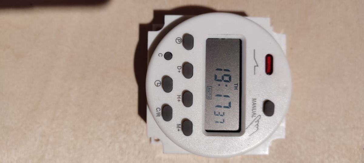

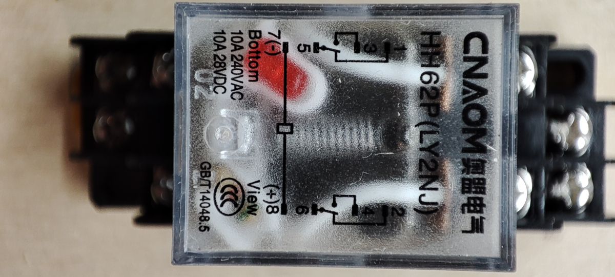

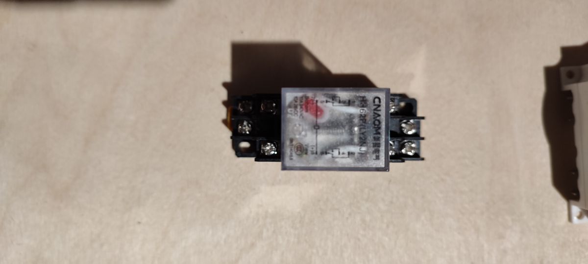

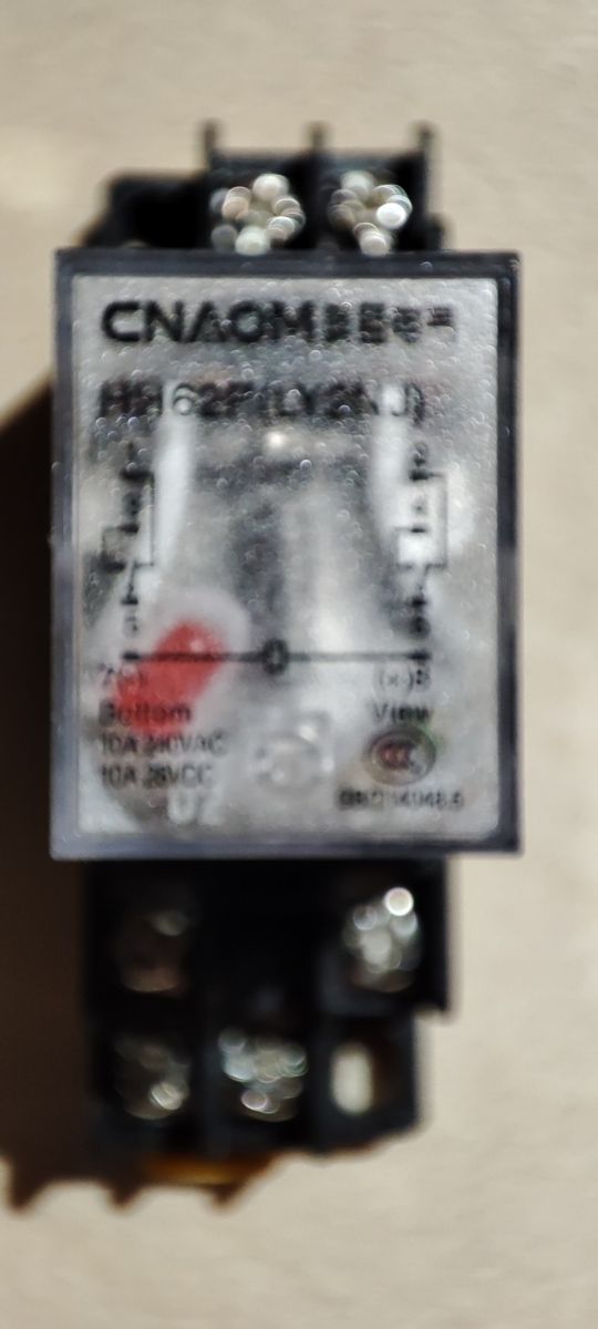

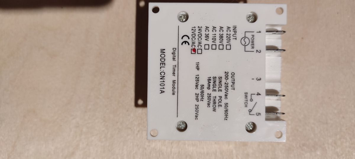

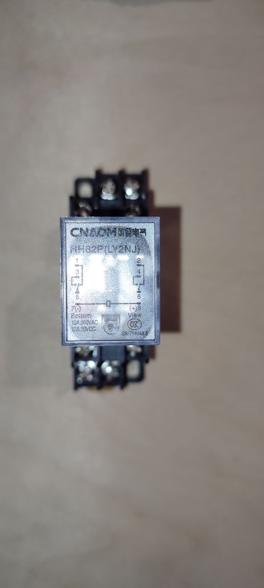

    Please help how to connect this to the battery so that at a certain time the actuator extends and at a certain time it retracts.
    Programmer in working order. When connected without a relay, the actuator responds. How to connect so that the relay reverses the poles?
    Thanks for your help

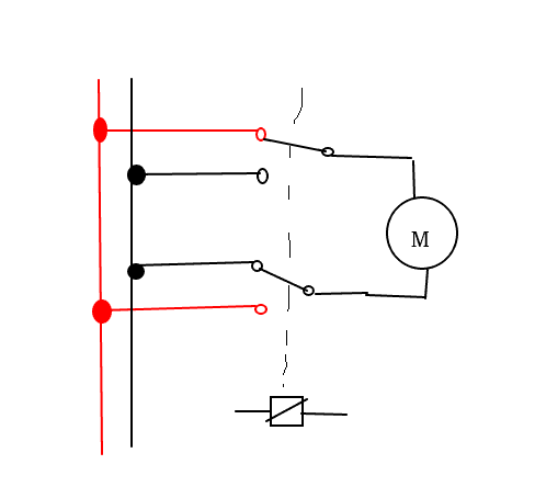

    From the middle ones you go down to the motor, and you have to cross-feed power to the others. Bear in mind that with a simple solution the actuator will always be live. I don't know if something will overheat or eat up the battery - it depends on the design of the actuator.

    Thanks. I might be able to manage. Actuator with built in limiters.

    Electrical schematic with motor and switches
    so fast :) .

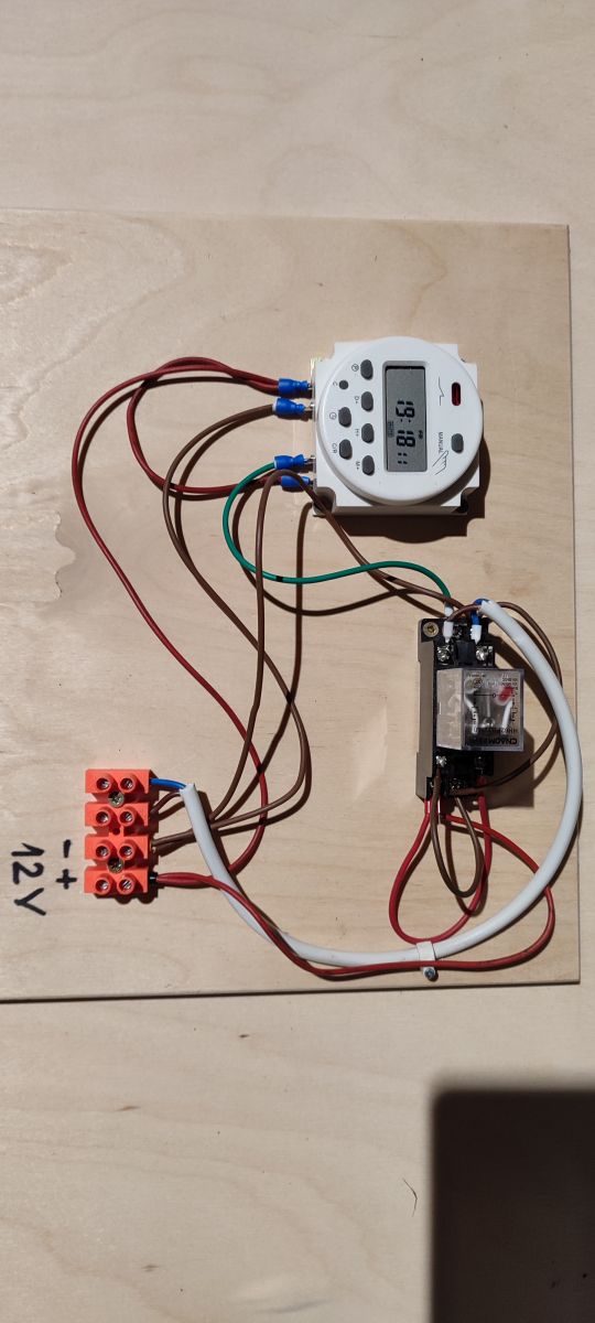

  • #5 20975404
    zutzee
    Posts: 20
    Thanks to YouTube I have managed. Everything runs great.
