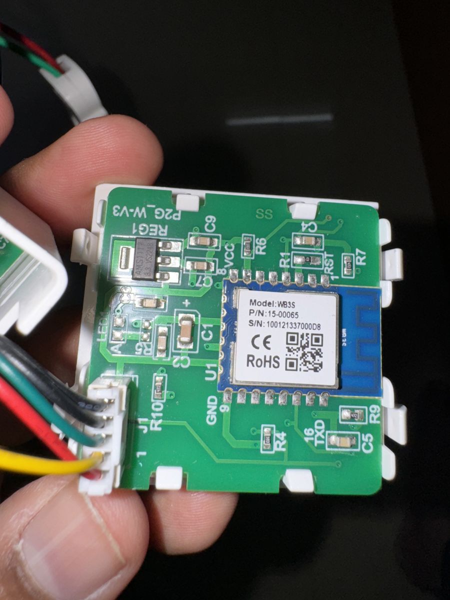

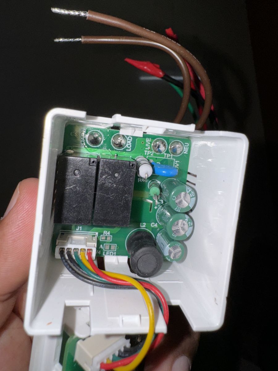

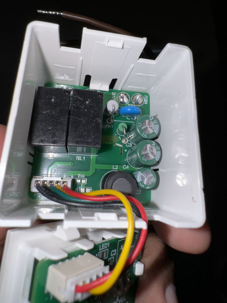

    Couple of months back I had purchased a 2 Gang Tuya switch from Amazon India website and today I was in a mood to check if the device is OBK compatible via cloud cutter, to my surprise the Cloud cut worked fine, and I was able to flash OBK (used Tuya Genric DS 102 2Gang profile) to flash OBK.
    I am now stuck since the device could be Tuya MCU WB3S and unable to identify DpIDs and Pins.

    I don't think it's TuyaMCU because I can't see RX/TX pins of WB3S soldered anywhere.
    Can you try to open Web App and use the GPIO Doctor there to find the roles of the GPIO? Start with relays.
    Alternatively, try to automatic GPIO extraction:

    Hey, the GPIO extraction tool did the trick, and the device is now working perfectly... :)
    Below is the template, please add it
