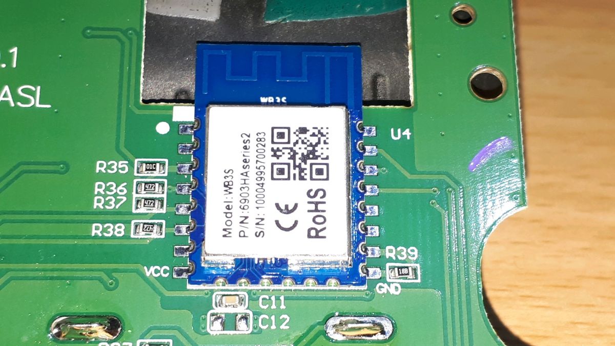

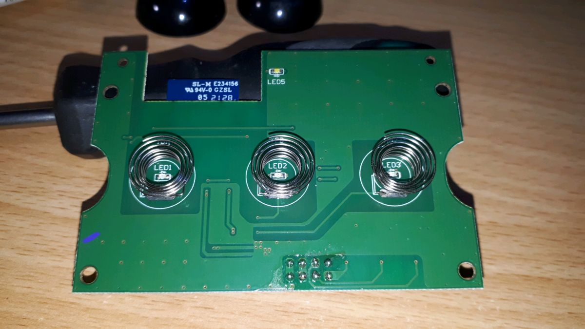

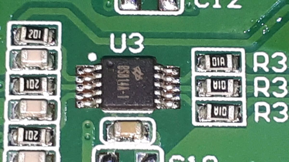

    Short teardown post to complete the series of wall switches offered from Bunnings under the Deta name.
    https://www.bunnings.com.au/deta-grid-connect-smart-triple-gang-touch-light-switch_p0161014
    [BK7231T/WB3S] Deta Grid Connect Triple Smart Switch - 6903HA [BK7231T/WB3S] Deta Grid Connect Triple Smart Switch - 6903HA [BK7231T/WB3S] Deta Grid Connect Triple Smart Switch - 6903HA [BK7231T/WB3S] Deta Grid Connect Triple Smart Switch - 6903HA [BK7231T/WB3S] Deta Grid Connect Triple Smart Switch - 6903HA [BK7231T/WB3S] Deta Grid Connect Triple Smart Switch - 6903HA [BK7231T/WB3S] Deta Grid Connect Triple Smart Switch - 6903HA [BK7231T/WB3S] Deta Grid Connect Triple Smart Switch - 6903HA [BK7231T/WB3S] Deta Grid Connect Triple Smart Switch - 6903HA
    Was flashed in-place with usb to serial adapter and OpenBK7231T_App under Ubuntu.

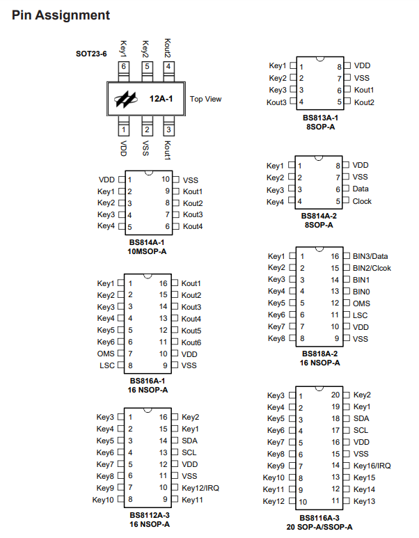

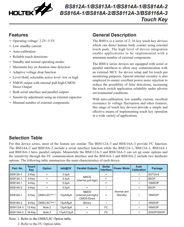

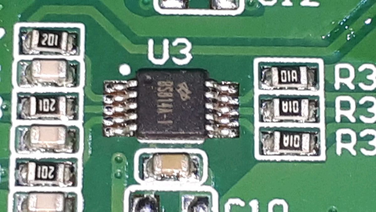

  • BS814A touch controller, not TuyaMCU
    #2 20584215
    Posts: 14792
    Rate: 12937
    It looks like a very nice and easy to flash device. The U3 chip may confuse some people into thinking it's a TuyaMCU (it even looks like routed to RX/TX?), but when you read the marking, you can see it is BS814A, which a touch button controller made by Holtek, so not a TuyaMCU.

    Yes one button is routed to RDX1 but didn't cause any issues with flashing the WB3S in place.
    I'm assuming the BS814A outputs high and low logic levels to the inputs of the WB3S and that the USB-Serial programmer has the capacity to override it.
    It's good the designers of the BS81 series chips have kept I/O usage to the minimum.
