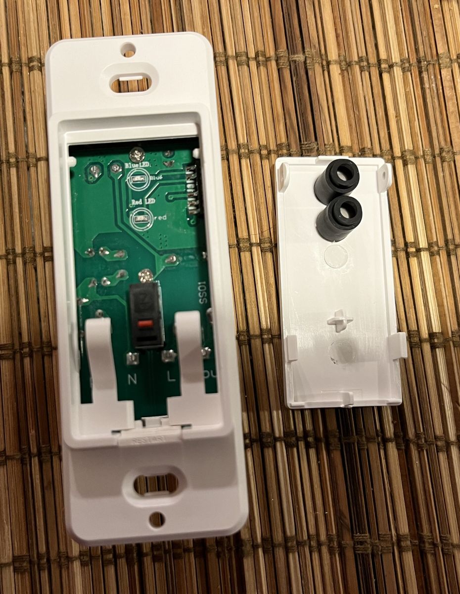

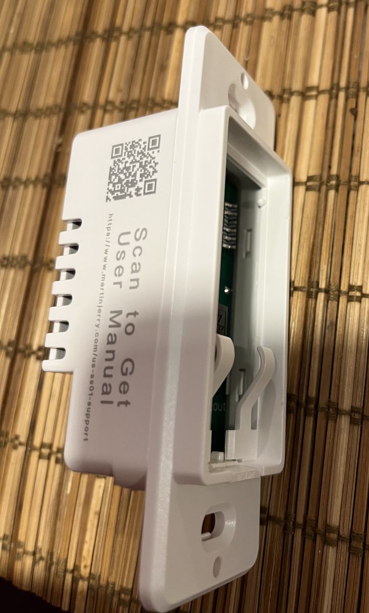

    This switch was actually pretty easy to figure out and flash/configure thanks to the OpenBK team. I am mainly using the Feit Smart Dimmer switches as my local Costco had the $.00 manager clearance sale on them for $7 for a 2 pack a few months ago. So I bought all 13 2 packs they had left. Now nearly every light switch is smart and dimmable in my house. Thanks bleeblak8 for figuring out that one to get me started and have some foundation to figure out this one.
    I wanted to control a few fans and could not easily figure out how to disable the dimmer safely, so I bought a 4 pack of Martin Jerry switches for $52 (almost 4x what I paid for the Feit ones lol) as it seemed like they were all cheap ESP devices that I could easily flash tasmota on, but the US-SS01 has the WB2S WiFi board instead. This is the same BK7231 in the Feit so I poked around to see if I could easily flash it. Turns out it was very easy to open and flash. Took me about 3 hours to figure this all out.
    [BK7231] Martin Jerry Single Pole Smart Switch US-SS01 Flashing Guide & Template GPIO

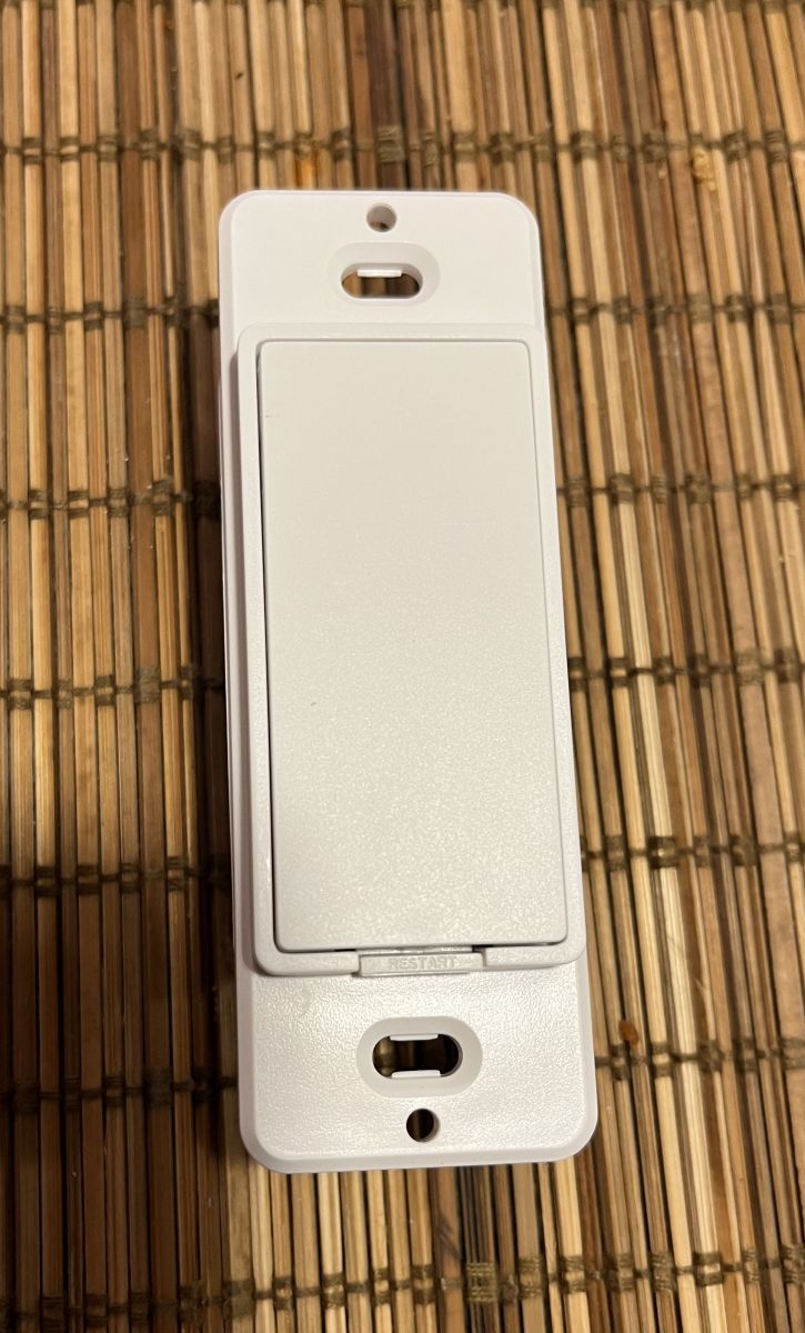

    All the plastic is held together by tabs so it is easily removed. All we need to do is pop off the button.

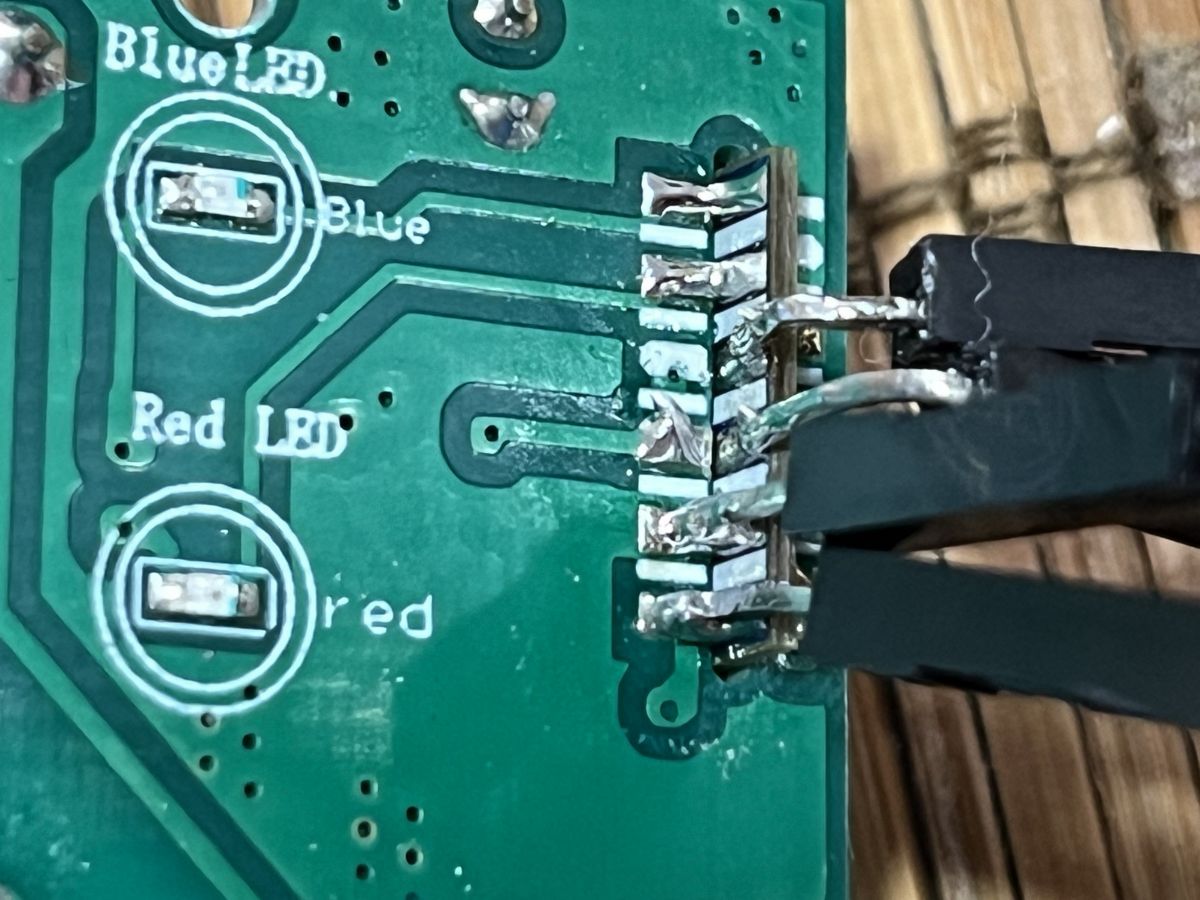

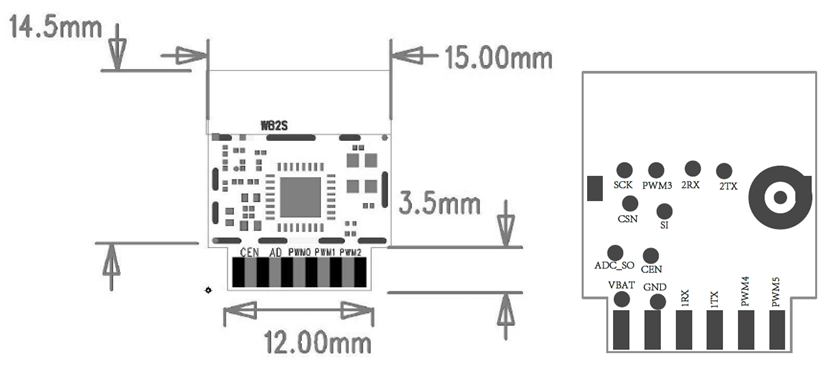

    Now the little board that is sticking out on the top right is the WB2S, luckily everything we need is accessible from this side of the board. Here is the pin out if you want to get a better feel of what we are doing.
    3.3v (VBAT), GND, RX, TX are all facing the LEDs, from the bottom up. We will need to solder leads to each of them or you might even be able to use thin alligator clips as the pins are zig-zagged with gaps or just insulate the other side from making contact. If you are worried about melting the plastic or want more room to work you can completely take the board out. All you have to do is undo 4 tabs between the plate that goes on the wall and the back part of the unit. I did this for my first one as I was figuring it out, but the other 3 I did not.

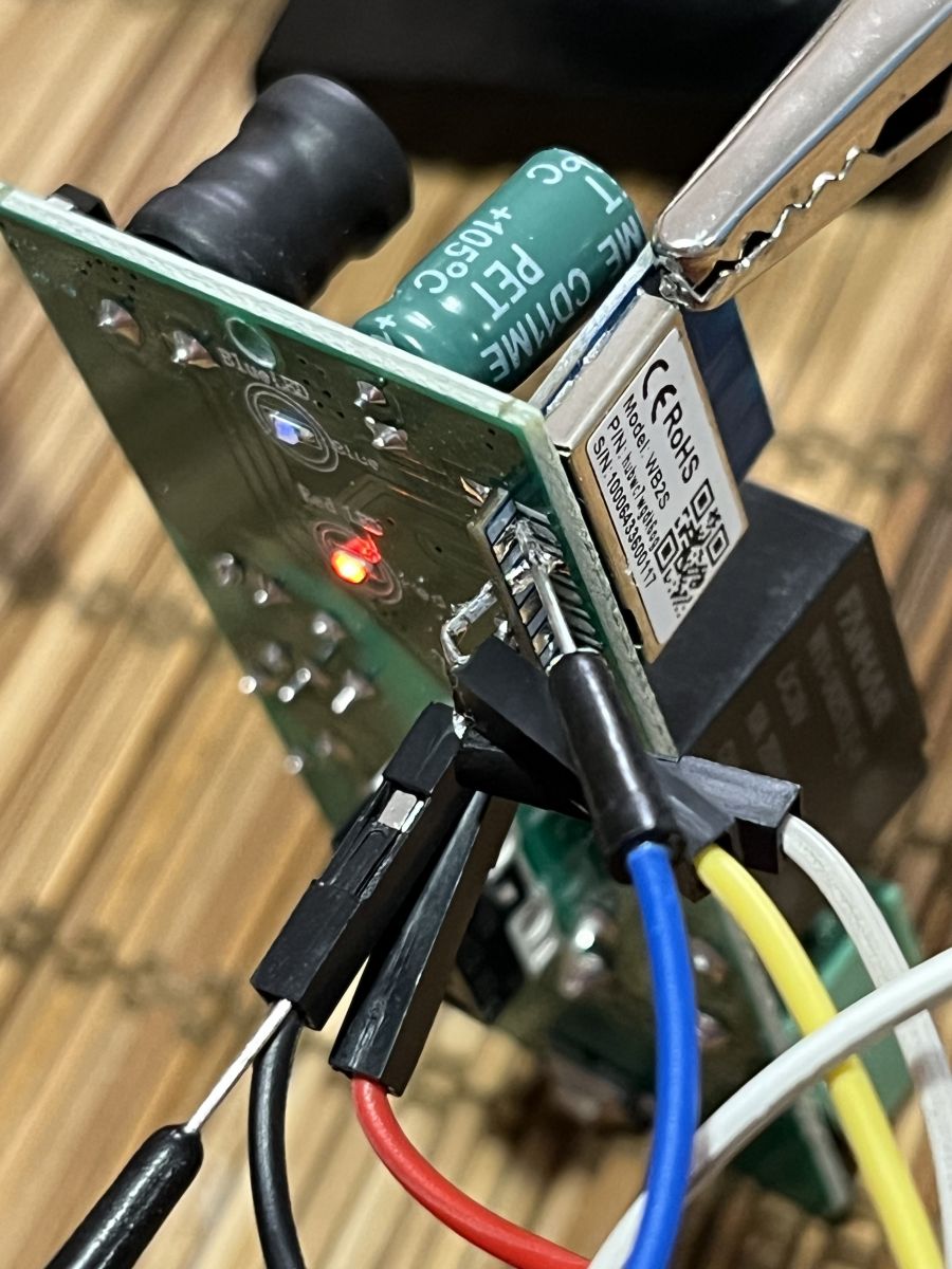

    Now RX is connected to the main board and it will not flash if it is. I used a solder sucker and my iron to remove the connection and add a little back to the WiFi board so I can connect my lead. Other solder removal tricks like a wick should work here too. Hopefully you can see this in my photo below. I would do this connection first.
    You will need 2 leads for ground as you will have to momentary ground CEN on the other side to get into flashing mode. In the photo below the blue lead is actually touching the very top pad, but only looks like it is on the 2nd from the top. The other side is stabbed in the back of the ground lead. You could use a button to make this very easy to get timing correct during flashing.
