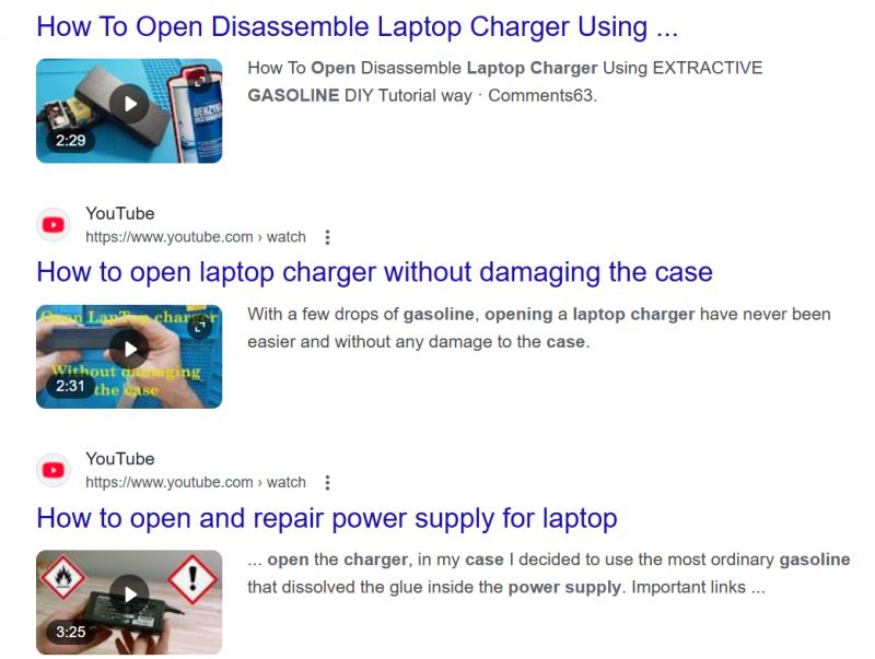

  • #5 21287471
    jtalbotcs
    If anyone has any tips for getting the case open, please let me know.
  • #6 21287504
    Posts: 14622
    Help: 655
    Rate: 12638
    How is it assembled? Maybe it's like a Power Supply? Do you know the gasoline trick?
    Search results with video thumbnails showing how to disassemble a laptop charger using gasoline.
    Of course, it depends on how actually the case is assembled, if it's glued, or snaps, etc
