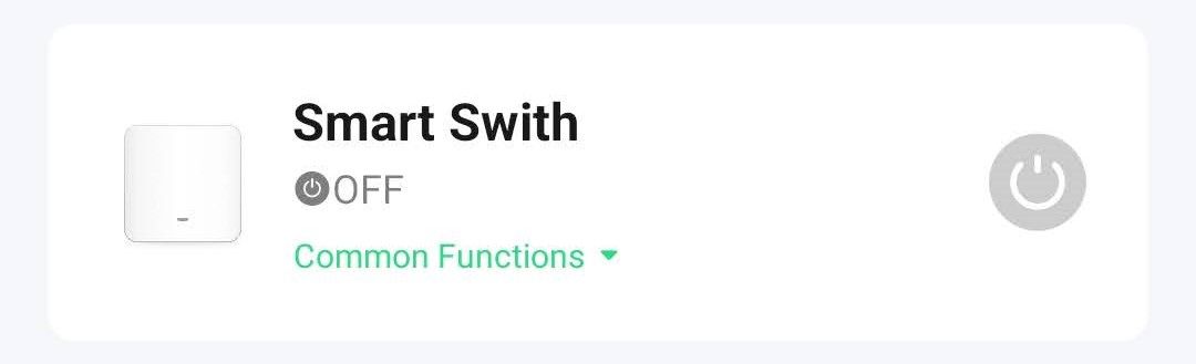

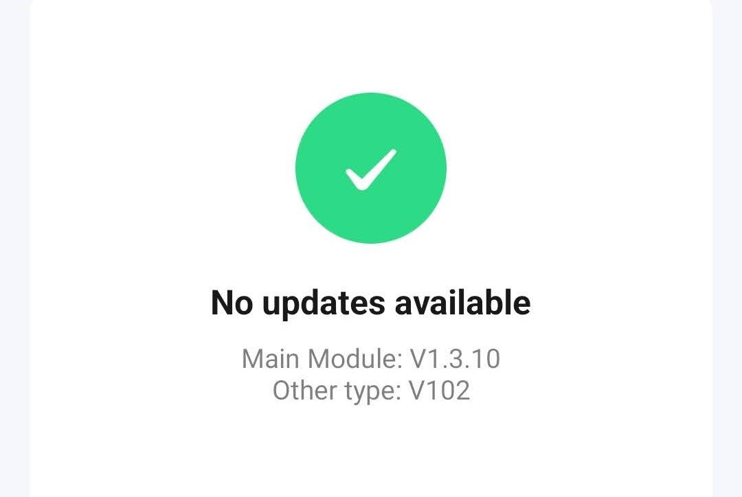

    I do not have an RF remote of the correct frequency so cannot test the RF capabilities, but as far as I can tell only the relay on P8 is shared between the CB2S and the RF module, it seems to not have any communication with the CB2S. Paired with the Tuya app there is no mention of RF.
    Device screen message indicating no updates available, with main module version V1.3.10. Appearance of the app interface for controlling a smart switch.

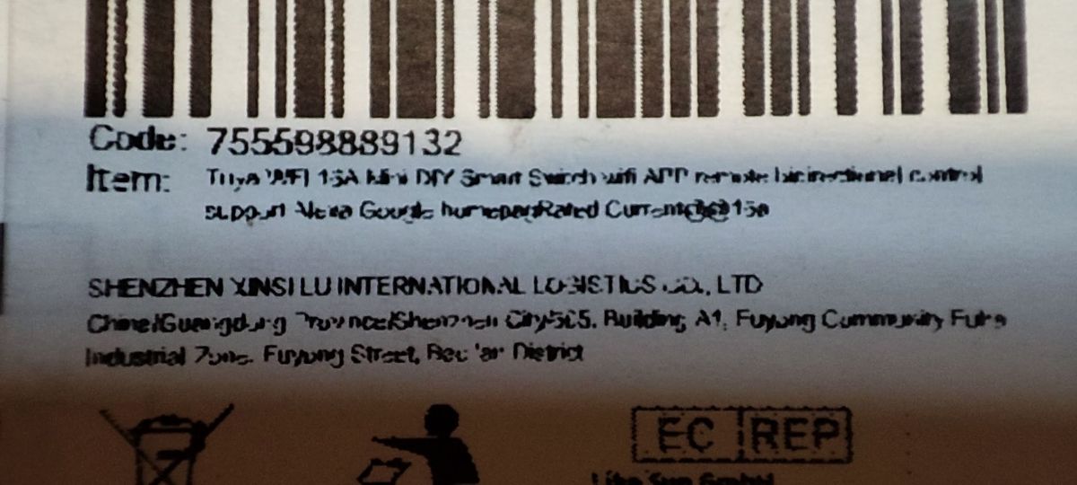

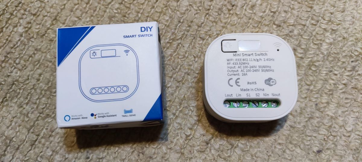

    Some pics of packaging and externals
    Mini smart switch Tuya with packaging Close-up of the label on a mini smart switch detailing technical specifications. Square white casing of a mini switch with ventilation slots. Label of Tuya WiFi 15A Mini Smart Switch User manual with description and technical specifications of the Wi-Fi and RF remote control switch. Instruction manual for WiFi + RF 433 MHz receiver. User manual for a smart switch with RF 433 MHz functionality. DIY Smart Switch packaging and device on a carpet.
