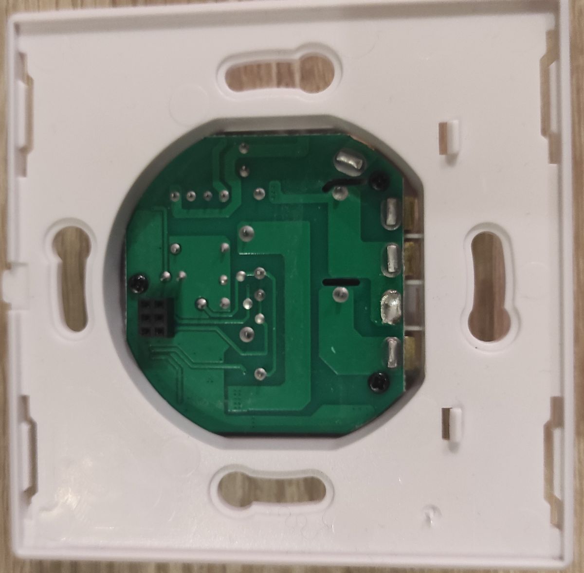

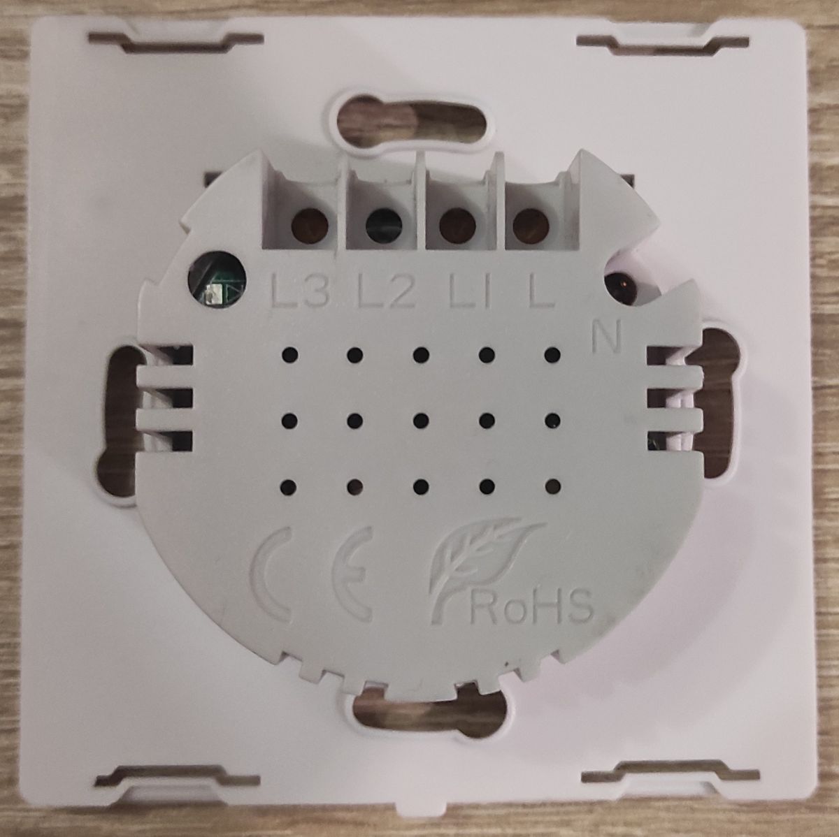

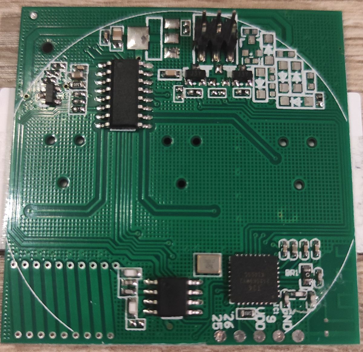

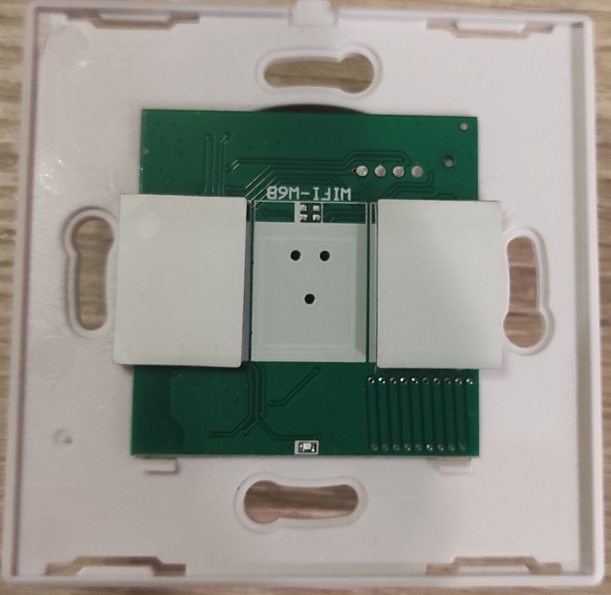

    Some time ago I bought an unbranded Tuya 2 gang switch from aliexpress and recently got around to playing with it.

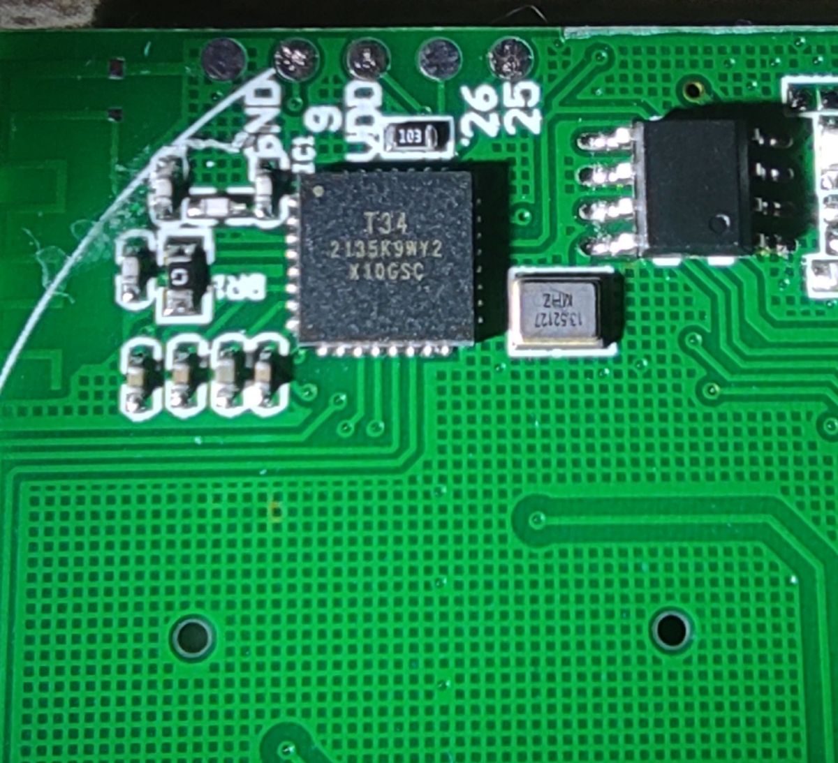

    It's a T34 (BK7231N ) based device with RF capabilities, the PCB has 3 touch/proximity sensors but only 2 are populated (the middle one might still be readable with a custom firmware?)
    I am yet to flash OBkn to it but I got a firmware backup from it.
    The flashing pads on the back were easy to reach no soldering/desoldering needed.
    Close-up of a green printed circuit board with visible integrated circuits and electronic components.PCB board with installed integrated circuits and connectors.
    Seems to be an upgraded version of -Link
    Also seen here -Link
    My current issue is that it could not auto fetch the json from 0x1D1000 (all are 0xff values ), but looking at the firmware file the config might be at 0x1D4000
    Glass Wi-Fi touch light switch with two illuminated buttons.Flush-mounted electrical socket with terminal markings L3, L2, L1, L, N.The image shows a printed circuit board mounted in a white plastic frame, with two white rectangular components.Close-up of a printed circuit board (PCB) mounted in a white plastic frame, likely part of an electrical device.
