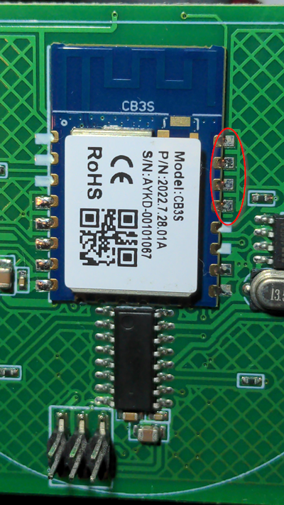

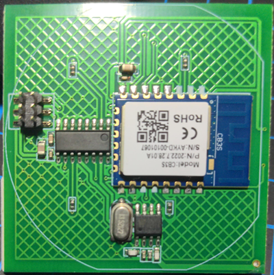

    When you inspect the PCB I discovered that the RX pin is connected to the pin number 3 of the 14-pin chip. I do not know whether this is a simple button controller or a Tuya MCU device. The above cloudcutter profile indicates that the old device was a Tuya MCU based.
    Unfortunately the PCB does not show any tracks that can be broken temporarlily to disconnect the RX pin.
    Since I have a bunch of these switches to work on, I do not want to de-solder the modules completely.
    I am wondering whether I can just heat up the pads and lift the module a little bit because not all the pins are actually soldered.
    CB3S module mounted on a green printed circuit board.
    Any better suggestions?

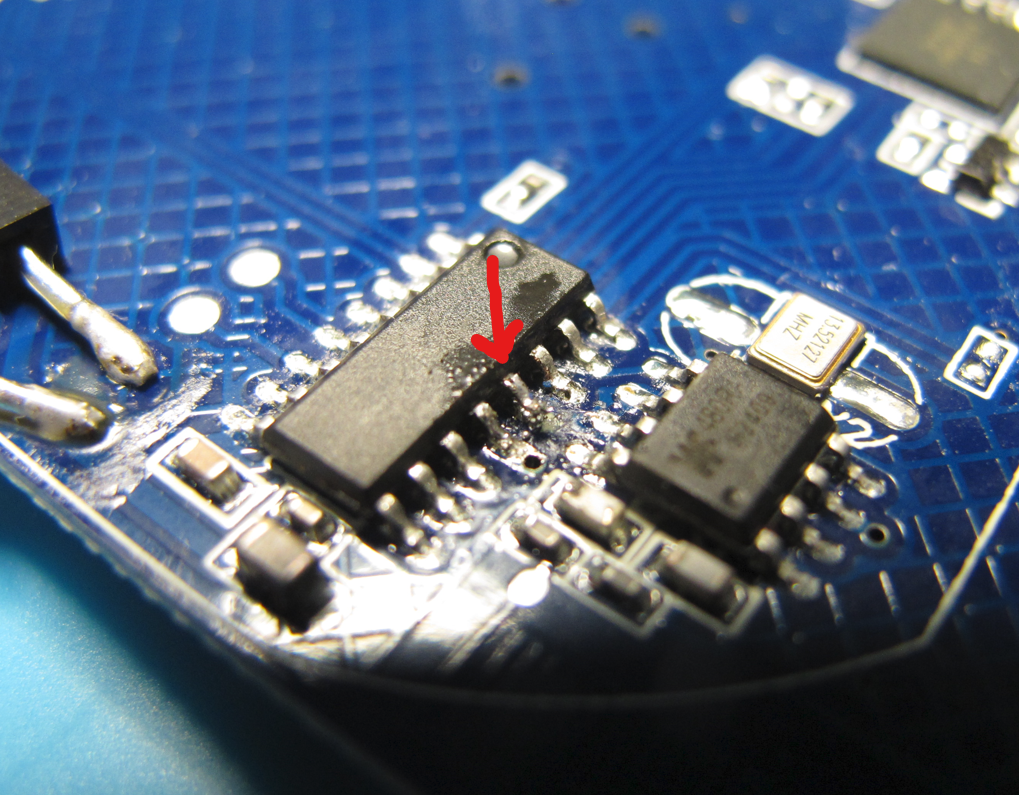

    this is the TuyaMCU. You'll probably find RX1/TX1 on the CB3S trace to two of the legs on the TuyaMCU.
    Close-up of an integrated circuit on a green PCB with various components and traces.
    I think you only have to interrupt the CB3S RX to be get the MCU out of the way so you can backup/flash. I delicately lifted the leg of a similar Bingoelec T34 touch switch MCU before to achieve this. Your MCU legs might differ though

    >>21225880 This isn't a TuyaMCU device, RX/TX pins from CB3S aren't routed anywhere. And cloudcutter profile clearly specifies relay and button pins.

    >>21226430 For RF433, or some other leftovers. Doesn't matter anyway, since those are the most important:
    		"bt1_pin": 9,
    		"bt2_pin": 8,
    		"bt3_pin": 7,
    		"bt4_pin": 10,
    		"rl1_pin": 26,
    		"rl2_pin": 24,
    		"rl3_pin": 14,
    		"rl4_pin": 6,
    		"netled_pin": 11,
