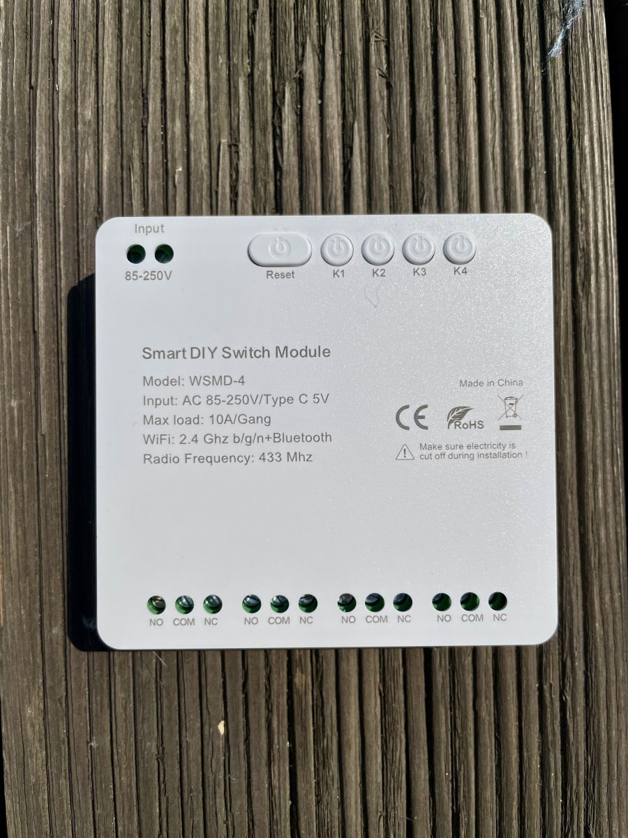

    I purchased an AVATTO WSMD-4 four-channel switcher onto which I successfully uploaded OpenBK.

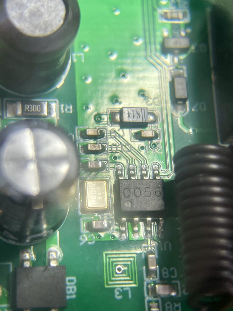

    On board is a 433MHz chip with the mysterious designation 0056

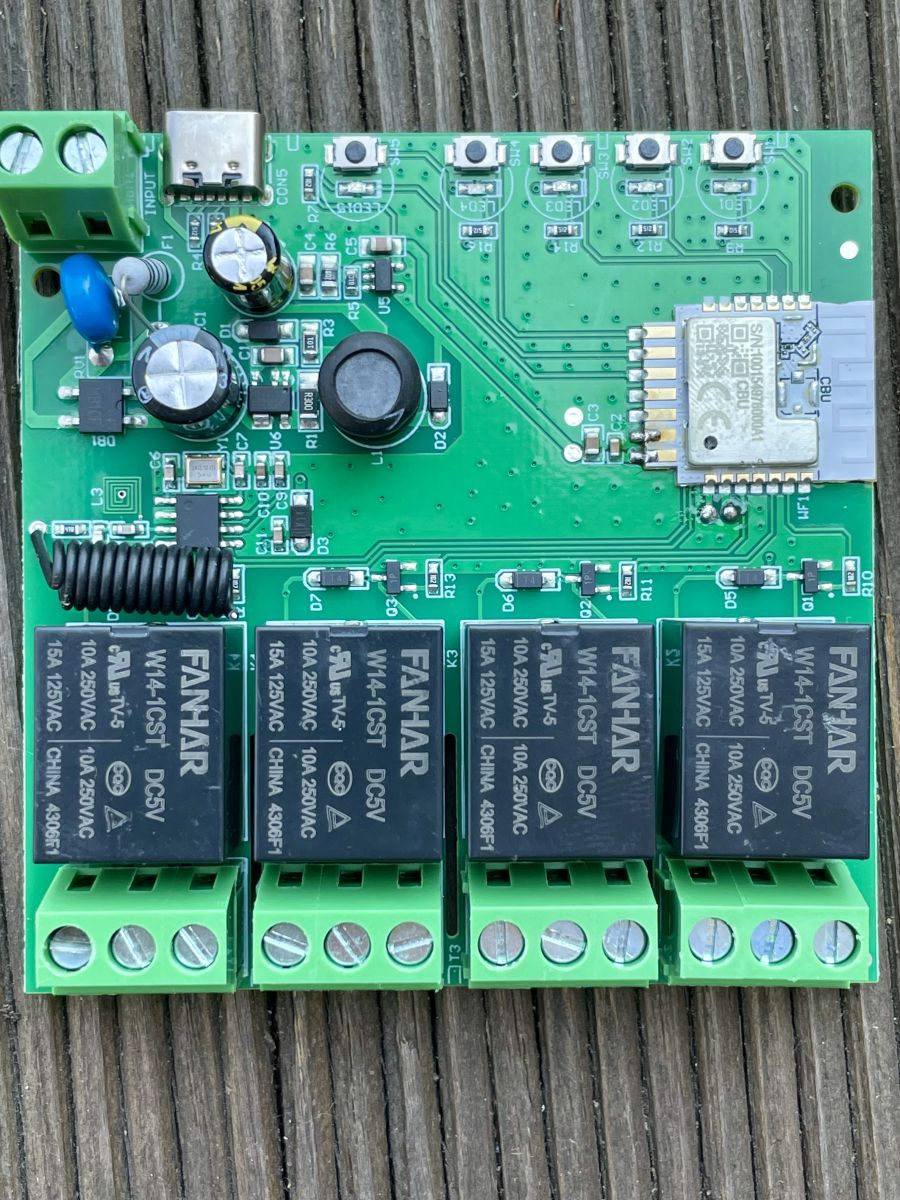

    Unfortunately the config was not extracted during the backup.
    I traced the paths visually and with a multimeter, I attach the config...:

    The relays and buttons work fine but I have two questions.
    1. the device has an additional RESET button which is connected to pin 7 and connects the ground, how can I make a short press do the restart of the CBU module and a long press (5s) do the conversion to AP mode?
    2. the RF chip 0056 is connected by output 8 (in the picture above number 6) to pin P24 of the CBU, I understand that the RF support is not implemented yet and I will not do anything about it for now ?.

    Re 2 This is TODO, so to be done only.

    Also have this type of board with Tuya CBU Chip. May I ask if you desoldered the chip for flashing or just used the soldering pads at the pcb?

    I didn't desolder the chip, in the picture in the first post you can see the thickened tin on two pins and two solder fields.
    As far as I know there is no 433 support yet
