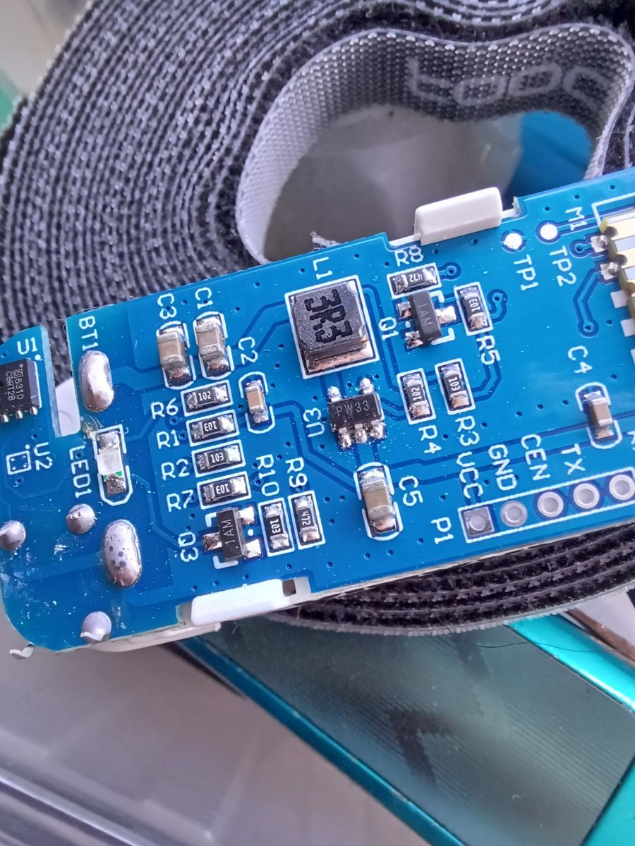

    Yesterday I picked up and used the sensor in question for about 15 minutes.
    Product page for the Tuya WiFi temperature and humidity sensor with a mobile app.
    Worked for 15 minutes then I got a message about a weak battery (inserted new AAA 1,6V) and I changed the batteries as a precautionary measure. After inserting the new batteries the U3 chip heats up a lot.
    Close-up of a PCB with visible electronic components, including the U3 chip.
    Does anyone perhaps have a schematic for this contraption to play around with fixing it?

    U3 is a step up inverter generating 3.3V from the lower battery voltage. Firmware on the board original? What current is drawn by the whole thing?
    There's not much to go wrong there, unless by some miracle you've made a short circuit on the PCB...
    The WiFi module on board should use deep sleep by default so most of the time it draws practically nothing, only then wakes up, reports the measurement to the cloud and falls asleep again.
