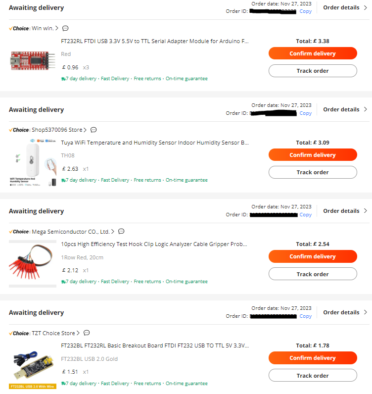

    I'm new to flashing these devices so I've been on a bit of a buying spree, wanting to play with all the IoT variations. AliExpress has fuelled quite a bit of this! This unit is labelled as a TH08 on the buyer's product page as well as the sticker slapped on the tiny box the device comes in. This was the exact store/unit: https://www.aliexpress.com/item/1005005869874007.html
    AliExpress product page featuring a WiFi temperature and humidity sensor.

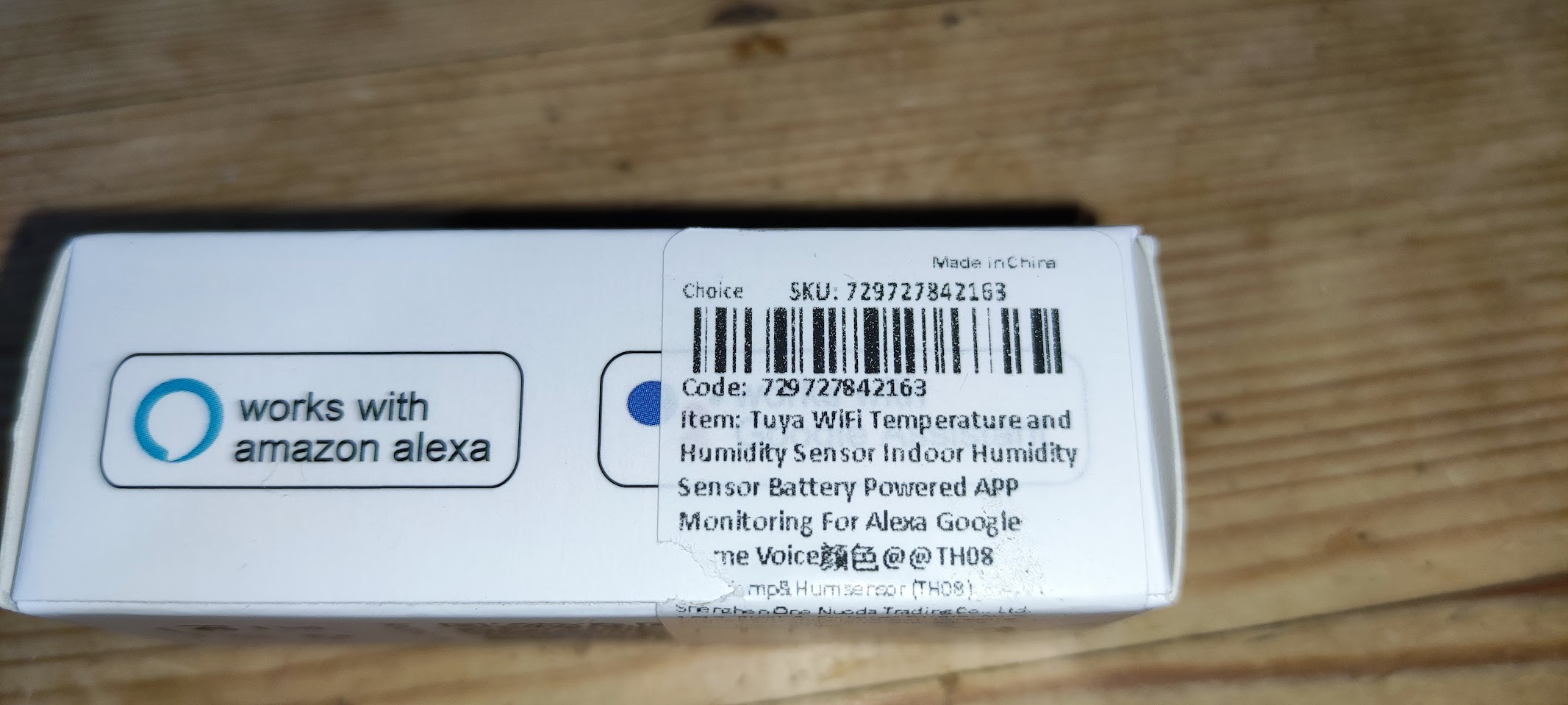

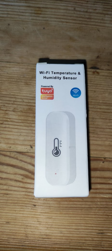

    I thought TH08s were the square temp/hum units with the LCD screen and these were TH01s, but it seems to vary?
    It was bought in a 3 choice items/free shipping bundle, so all these cost PLN6-PLN7 shipped. Ordered 27th October, arrived 7th December. UK
    AliExpress order list with electronic devices, including a humidity and temperature sensor.

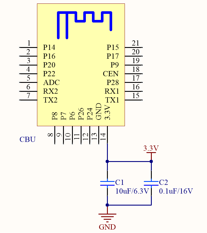

    CHT8310 datasheet
    CBU datasheet

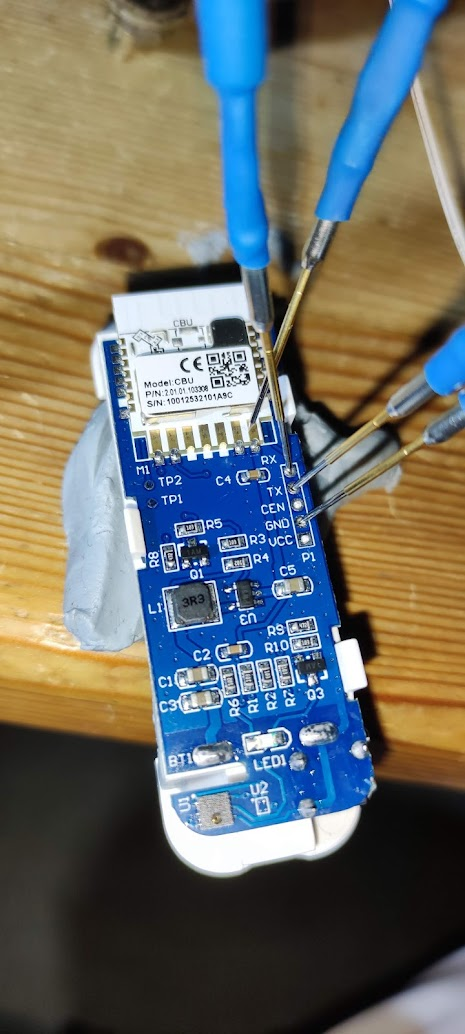

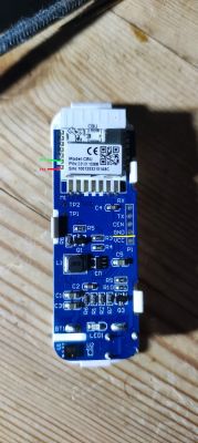

    To get the boot logs I used RX2, TX2 and GND and to capture all the logs from very first power-on, I used 2x AAA batteries in the unit itself (carefully inching one back in to power on). I'm not sure how others are capturing the whole log for non-battery devices without disconnecting the USB-TTL adaptor and upsetting the com port.
    Temperature and humidity sensor module with visible labels and pins.
    Diagram of an integrated circuit with pin labels and capacitors.
    I had great difficulty getting BKFlasher to complete for some reason, so I swapped a few jumper cables out and settled on using VCC direct on the CBU board pin.

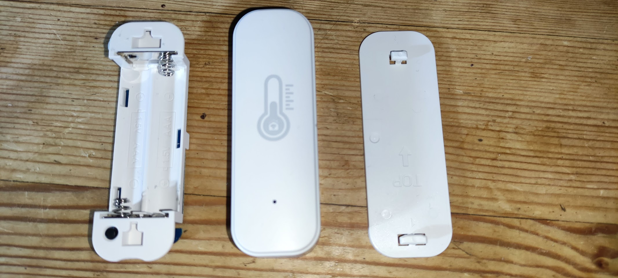

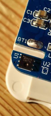

    And now for some pics of the unit, inside and out.
    Interior view of a temperature and humidity sensor with connected wires.
    Close-up of a circuit board with a chip marked S8310 and other electronic components.

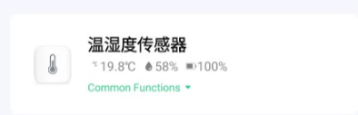

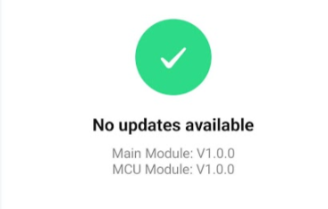

    Yes, I paired it with the Tuya app to check on firmware versions. I guess at 1.0.0 cloudcutter should be an option. I have not tried cloucutter. I might order another one, hope I get the same, then try cloudcutter.
    Screen of a temperature and humidity sensor app with data.
    App screen indicating no updates available.

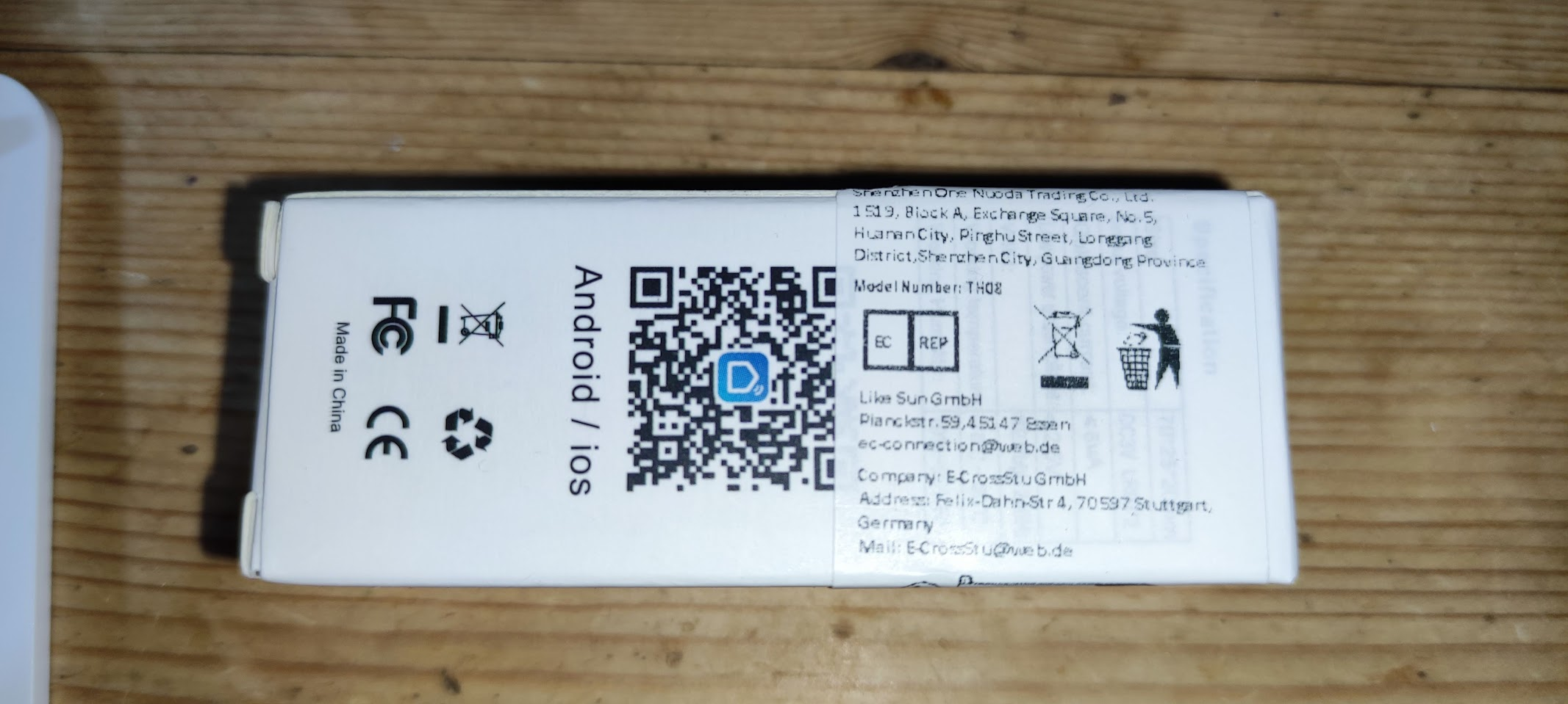

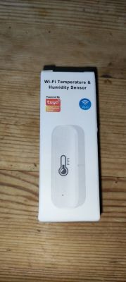

    Box of a white Wi-Fi temperature and humidity sensor with Powered by Tuya logo and Wi-Fi icon.
    Disassembled white plastic temperature and humidity sensor with visible interior on a wooden surface.
    Packaging of Tuya WiFi temperature and humidity sensor with Amazon Alexa compatibility label.
    View of device packaging with manufacturer information and QR code.
    User manual with technical data for Wi-Fi temperature and humidity sensor.
    Temperature and humidity sensor user manual.

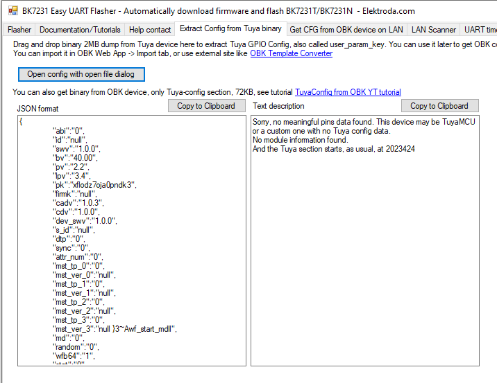

    After using Putty to get the output logs I used BK Easyflasher 1.1.3 to dump the firmware, attached.
    BKEF didn't seem to be able to find any meaningful pin data, however.
    Update: No change in BK GUI Flasher in v1.1.4
    Screenshot of BK7231 Easy UART Flasher software with JSON results.
    Before I proceed to flashing OpenBeken, is there anything else I should dump/do?

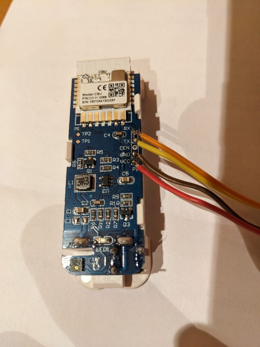

    Posts: 6
    I used the GUI Flasher: https://github.com/openshwprojects/BK7231GUIFlashTool
    Chip Type is BK7231N, selected "Download latest Firmware from Web"
    connected the VCC, GND, TX, RX to a USB to Serial adapter (TX on the Sensor to RX on the USB-serial Interface, RX on the Sensor to TX on the serial interface)
    Circuit board with connected VCC, GND, TX, and RX wires.
    Then I clicked on "Do Firmware write" and shortly disconnected / reconnected the positive lead to the serial interface and it flashed just fine. If you have trouble flashing despite everything seems fine try another serial interface, I first tried it with a CH340 interface and the flash wouldn't start, tried another interface and it worked just fine with the same settings.

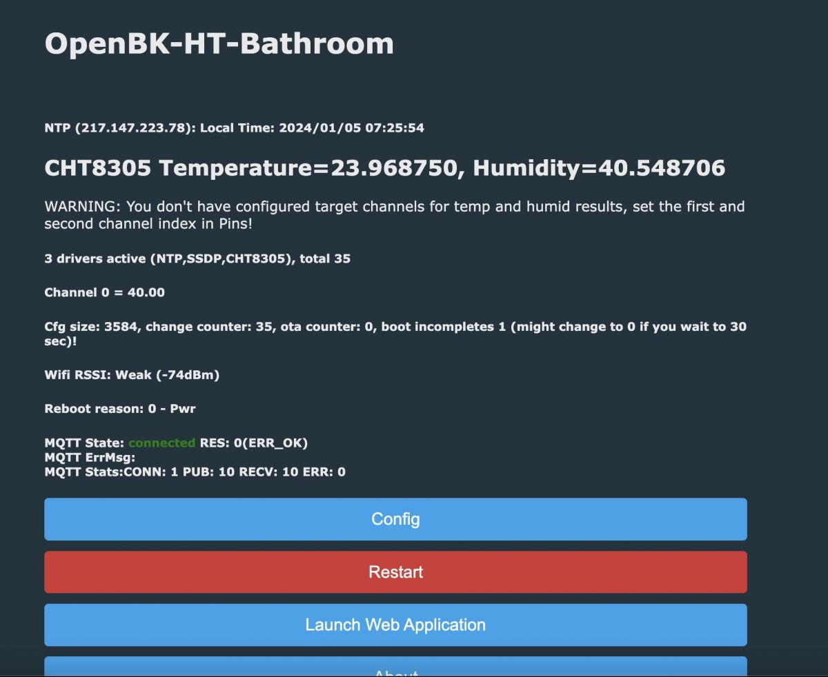

    Thanks to the hard work of our contributor, we have now a CHT8310 support in CHT8305 driver.
    You just need to enable CHT8305 driver, it should handle new kind of sensor as well.
    Please update and try.
    Also, when enabling, watch out for message in log:
    Info:SENSOR:DRV_CHT8305_init: ID: 59 59 8215
    Let me know what kind of ID do you have there.
  • #15 20874819

    Baustromverteiler
    Posts: 6
    Now that's great news, thanks a lot to artin961 :)
    Here's the Log with the Sensor-ID:
    Info: SENSOR: DRV_CHT8305_init: ID: 59 59 8215

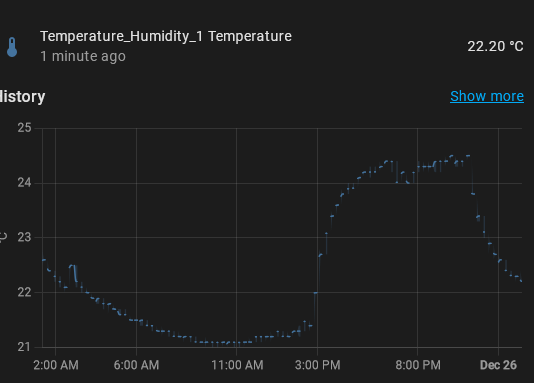

    artin961
    Hello all,
    Just as a follow-up, this is the autoexec.bat I used to make it sleep and not drain the battery as fast. A delay of 50 seconds is enough to connect and send data to MQTT as well as to be able to debug after restarting it. 900 seconds can be increased to preserve the battery even more. It would be great if a timer sleep with button wakeup gets implemented in the future to be able to wake it manually from the button. As can be observed in the screenshots below, it wakes and sends data to HA just fine.
    PowerSave 1
    delay_ms 50000
    DeepSleep 900
    Temperature sensor graph showing changes from 2:00 AM to 11:00 PM on December 26th. Chart showing temperature and humidity with a current humidity value of 40%.
    Hope you find this post useful.
    Regards.

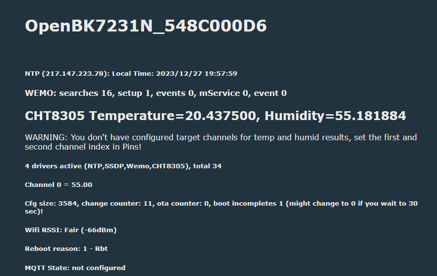

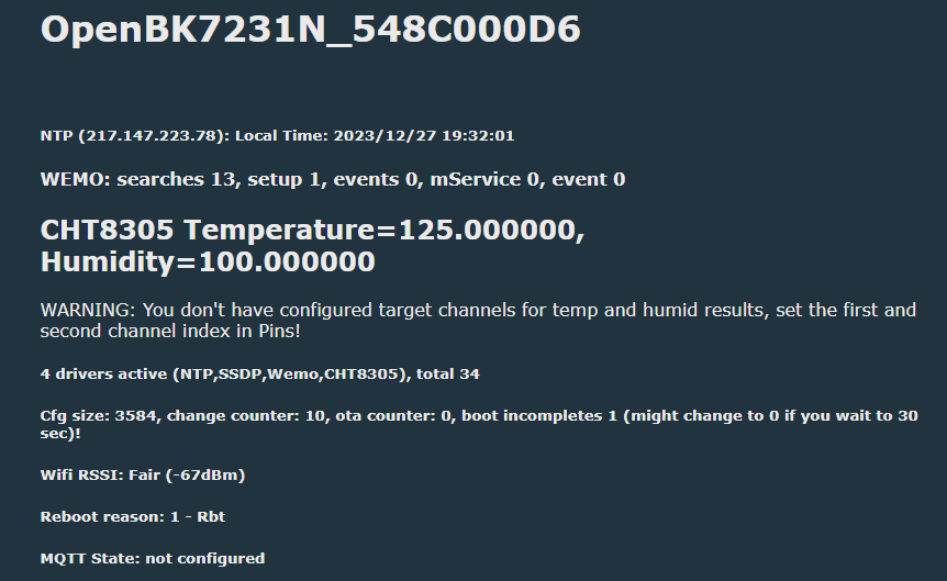

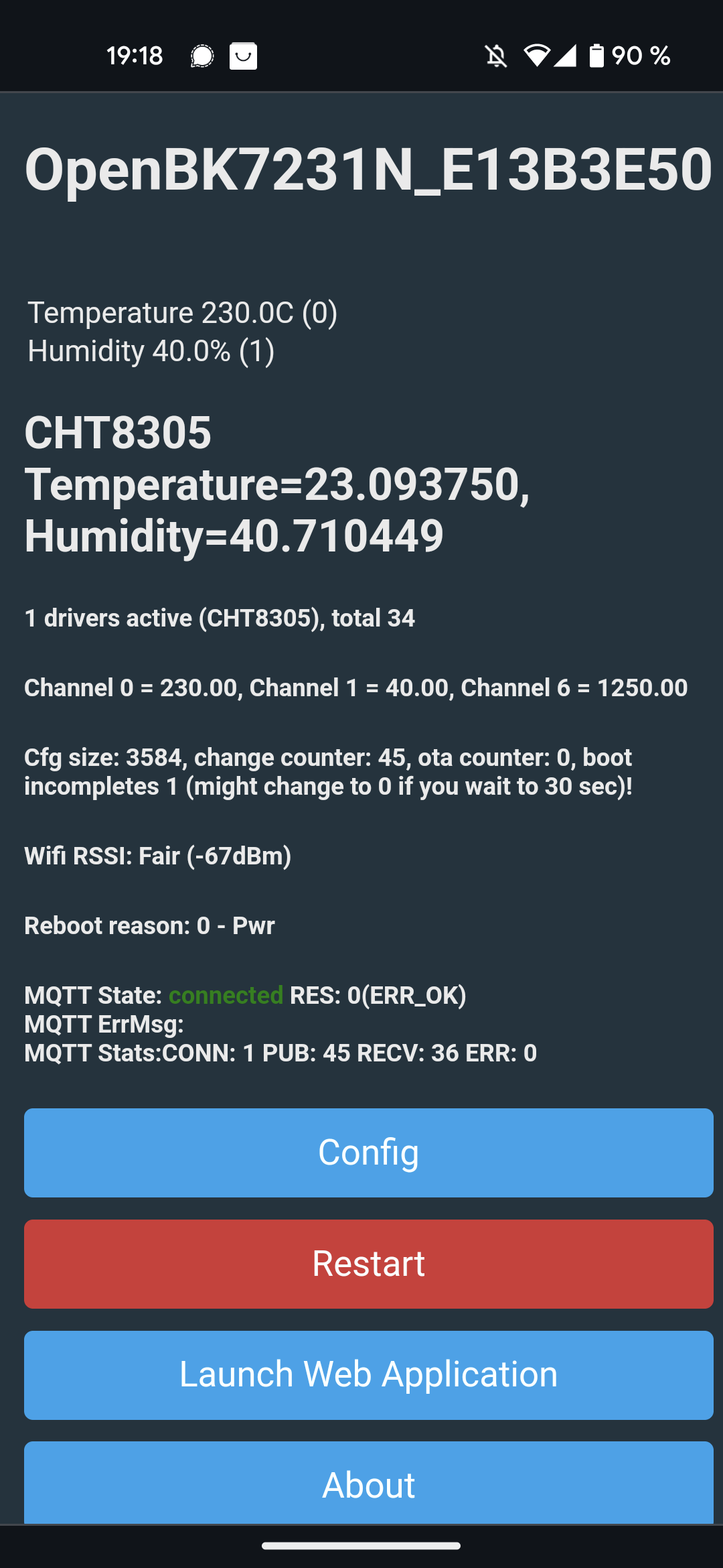

    Curious, mine has 8304 in the log, not 8305.
    Info:SENSOR:DRV_CHT8304_readEnv: Temperature:125.000000C Humidity:100.000000%
    Info:SENSOR:DRV_CHT8305_init: ID: FF FF FFFF
    Error:CMD:command with name CHT_Calibrate already exists!
    Error:CMD:command with name CHT_Cycle already exists!
    Info:MAIN:Started cht8305.
    Screenshot of OpenBK software with temperature and humidity sensor readings.

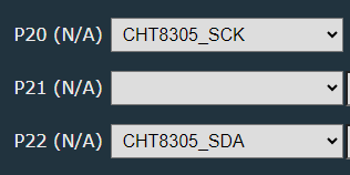

    My startup command is
    backlog PowerSave 1; startDriver SSDP; startDriver Wemo; startDriver NTP; startDriver CHT8305
    What flags have you set @Baustromverteiler and what channel/pin settings?
    Added after 12 [minutes]:

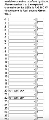

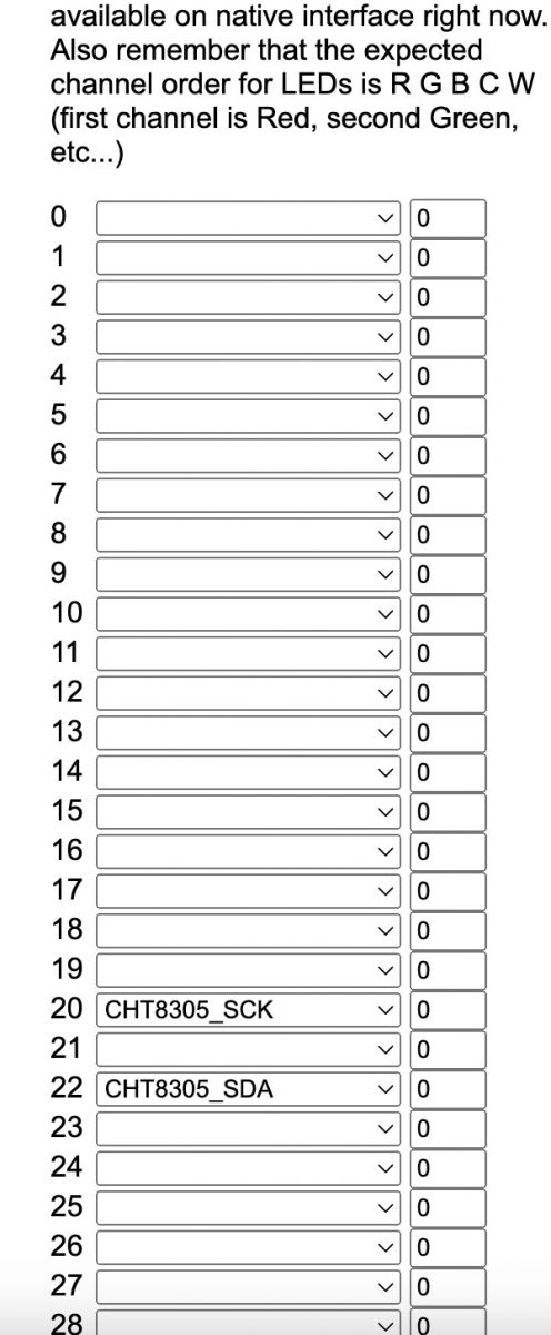

    Silly me https://github.com/openshwprojects/OpenBK7231T_App/issues/983#issue-1997790886
    Screenshot showing interface elements with labels P20, P21, P22 and associated values CHT8305_SCK and CHT8305_SDA.
    Screenshot of the OpenBK7231N interface displaying CHT8305 data and a channel configuration warning.

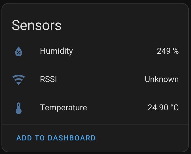

    I have successfully flashed the OpenBK firmware, but I'm observing a strange behavior in the integration with Home Assistant via MQTT. In Home assistant the values of the [b]Temperature[/b] and the [b]Humidity[/b] keeps changing every second.
    Here is one example:
    Screenshot of the sensor panel showing humidity at 249% and temperature at 24.90°C.
    I think that here the [b]Humidity[/b] show the correct value of the humidity in the room while the [b]Temperature[/b] show the value of the humidity in the room / 10.
    after a second those values are changed to the following:
    Sensor panel with humidity at 249%, RSSI unknown, and temperature at 24.90°C.
    I think that here the [b]Temperature[/b] is showing the correct value of the temperature in the room while the [b]Humidity[/b] is showing the value of the temperature in the room * 10.

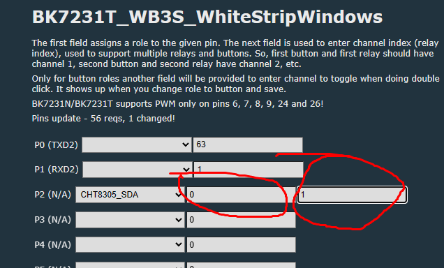

    Here are my PIN settings:
    Screenshot of PIN settings in a configuration interface.
    The index page shows the correct values for [b]Temperature[/b] and [b]Humidity[/b] and there they are not changing like in HA.
    OpenBK app screen with incorrect temperature and humidity values.
    Any suggestions where the problem might be?
    And additionally - what should I do to solve the warning message, which is visible on the index page?
  • #23 20892220
    Posts: 14573
    Help: 654
    Rate: 12596
    This warning tells you what's wrong.
    You need to configure second channel for SDA/DAT pin to be other channel than first:
    Pin configuration settings for BK7231T_WB3S with selected channel for P2.
    That's done in Configure Module...
  • #24 20892560
    kikokbg
    You need to configure the second channel for SDA/DAT pin to be a different channel than the first:
    Thank you very much! The correct configuration has solved the issue.
