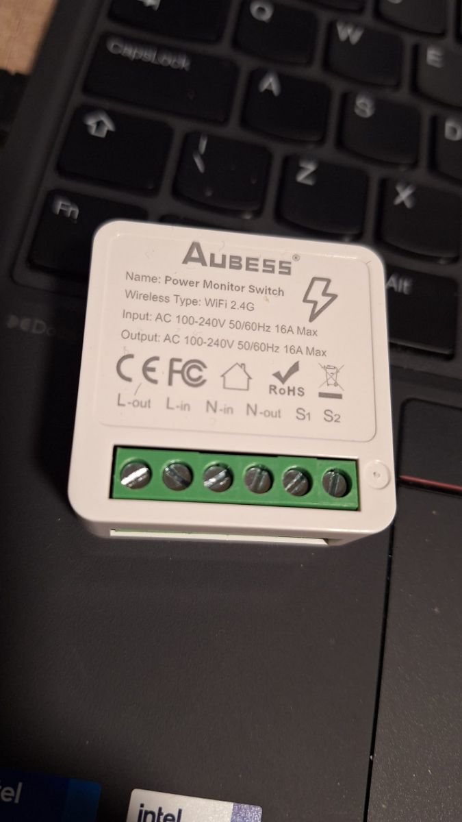

    Here are some of the devices I found, which are based on the BL0942:

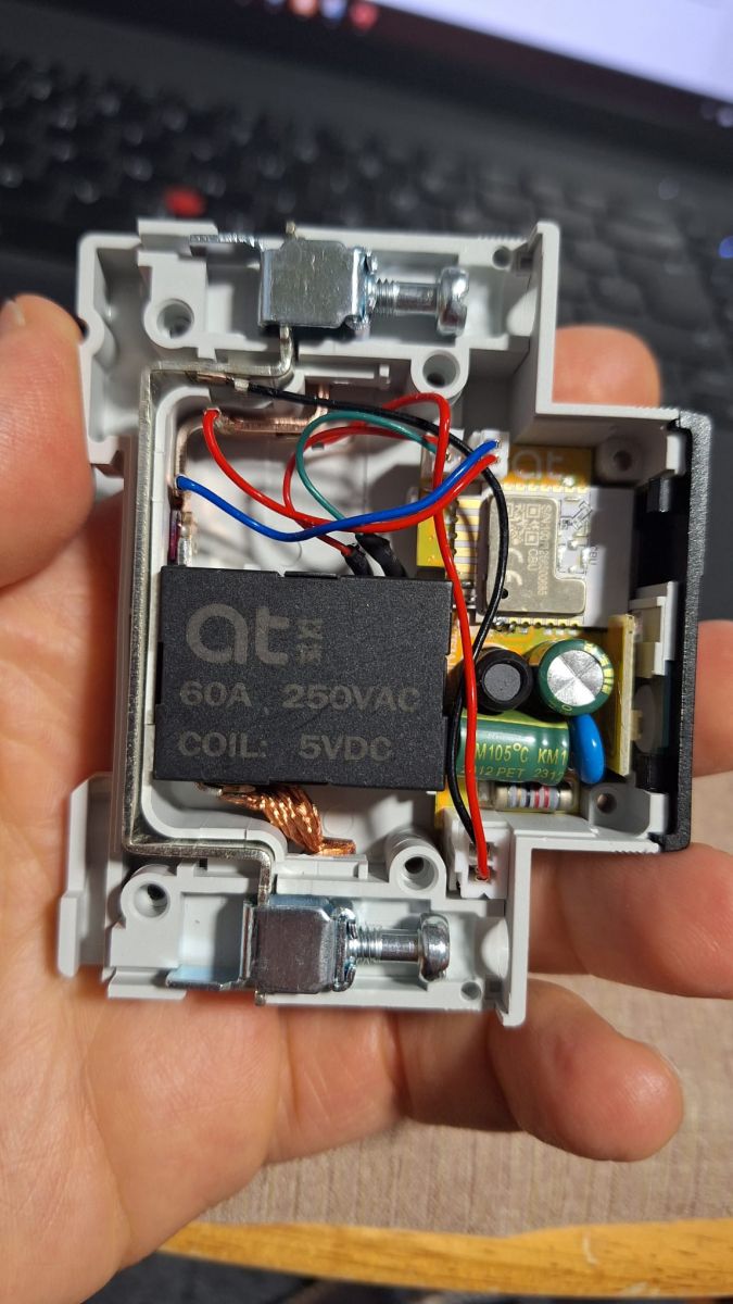

    The Aubess is by far my favourite. The relay cuts the Neutral (So you can wire it bypassing the relay), Power save works fine, reducing self heating, it's cheap, easy to open and easy to program. But It's limited to 16A as the current must go through PCB traces, so it's a stretch to use it in an incoming house supply. Particularly, in case of short circuit, I don't know if the surface mounted sense resistor would survive.
    Aubess power monitor switch on a keyboard Electronic measurement devices on a laptop keyboard.

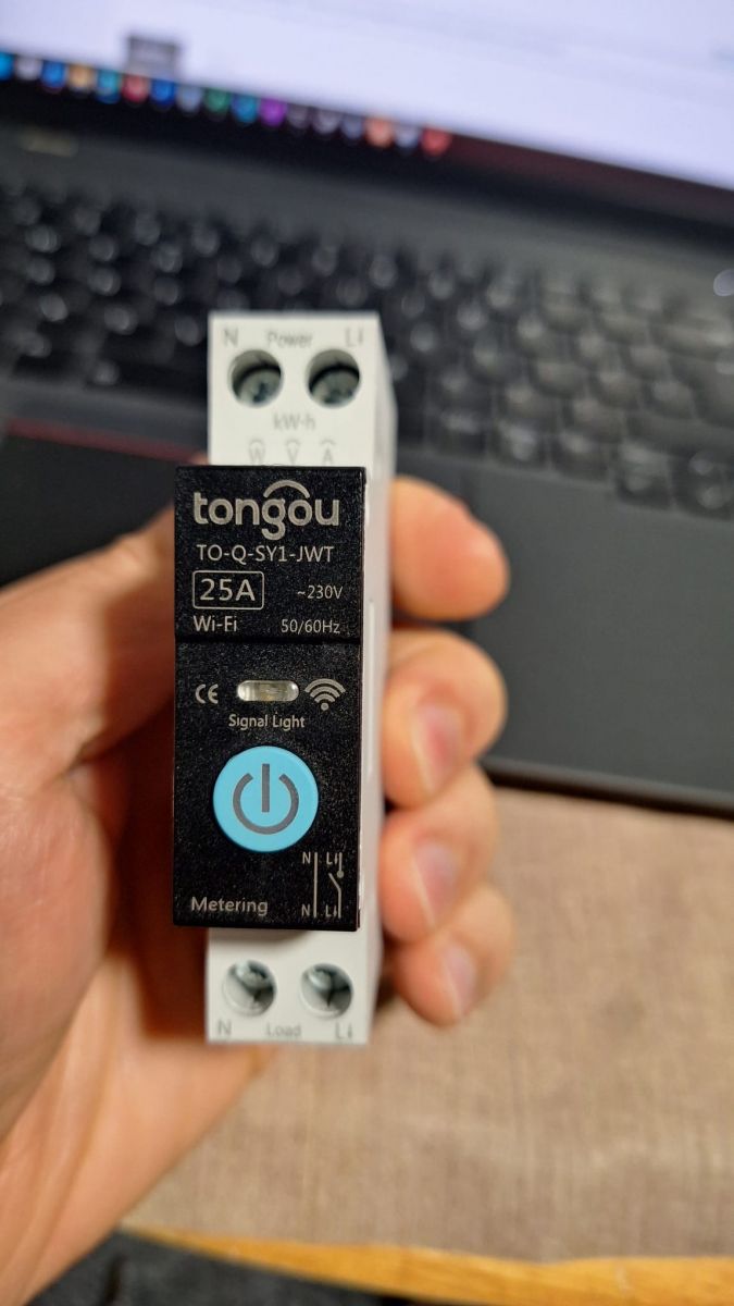

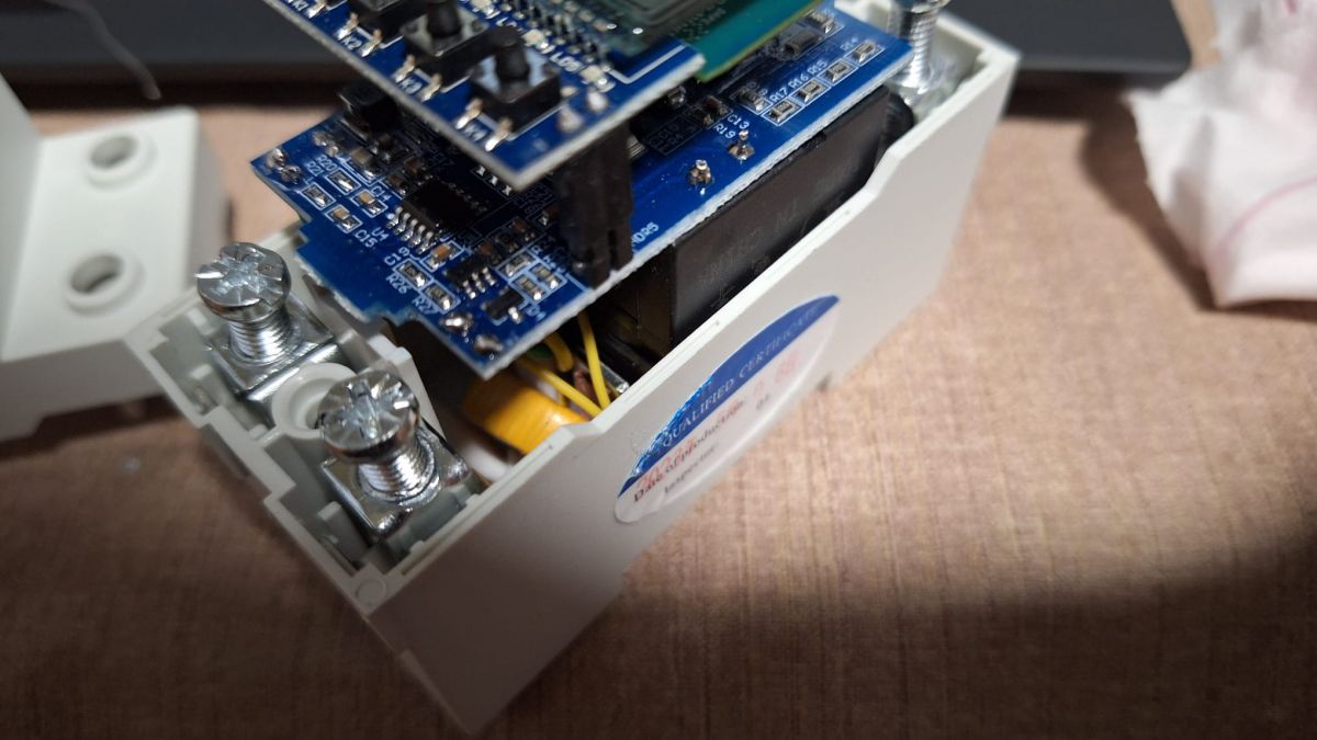

    The Tongou TO-Q-SY1-JWT is possibly the most promising. The Relay is bystable (it keeps states without power), so that means a failure won't result in loss of power to the house. It is rated up to 63A and it's relatively easy to program once open. But I don't like that it is riveted and so, it's hard to close it back again. It also seems to draw 1W regardless of what, so I wonder about the durability of the caps inside, which run pretty hot. The power supply regulates at 12V, for the relay, and an LM1113 steps down the power to the WiFi module. So 3x it's consumption are just wasted as heat.
    Tongou TO-Q-SY1-JWT relay held in hand Close-up of the bottom part of a device with mounting holes and markings. View of the interior of an electronic device with a 60A 250VAC relay.

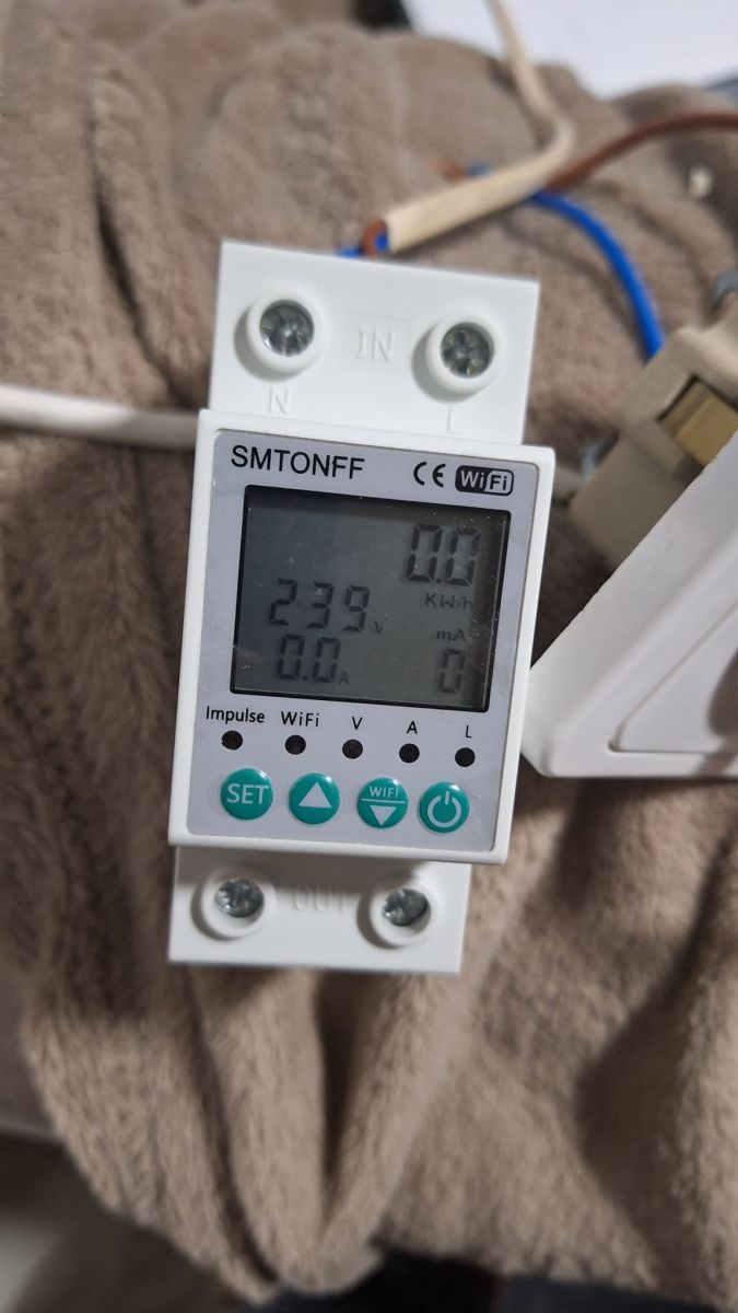

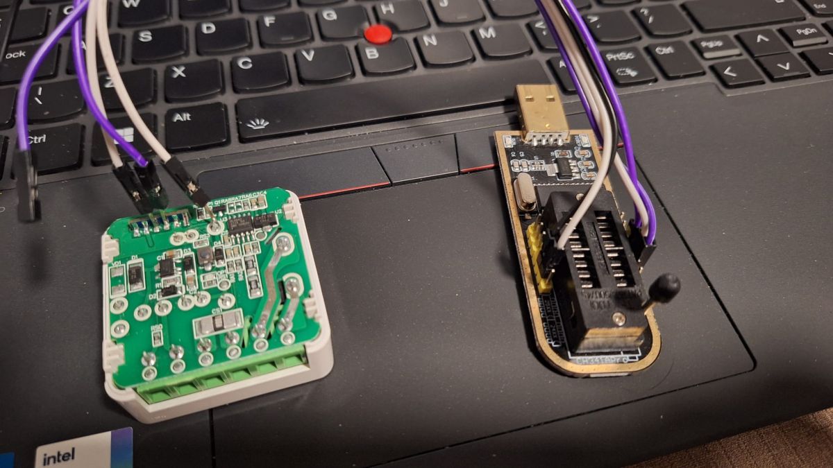

    Another interesting device is The SMTONFF. It appears to be the same device covered (https://www.elektroda.com/rtvforum/ttopic4022907.html
    The WB3S module has to be removed to program and it's obviously a larger device. There are others that can be programmed as the WiFi module can be de-attached from tuya MCU, releasing the Serial port. (https://www.elektroda.com/rtvforum/topic3995777.html and https://www.elektroda.com/rtvforum/topic3933839.html)

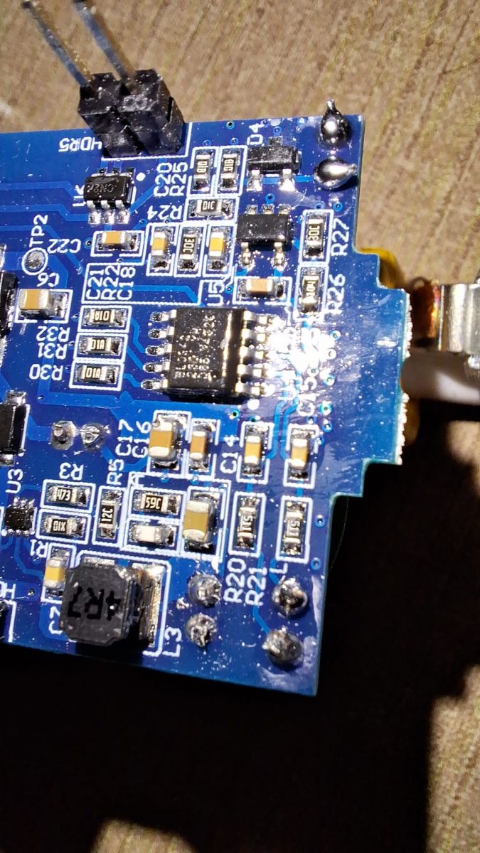

    I am not fully sure how to read from the Tuya MCU - Who manages the communication with the BL0942 - guess I will figure that out.

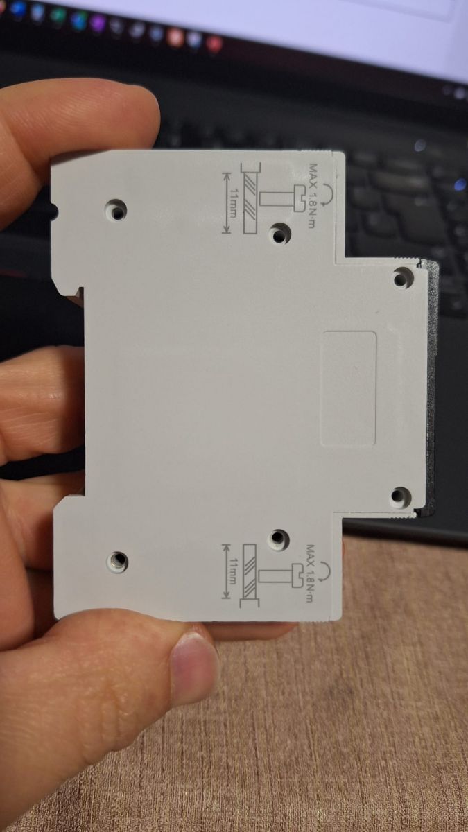

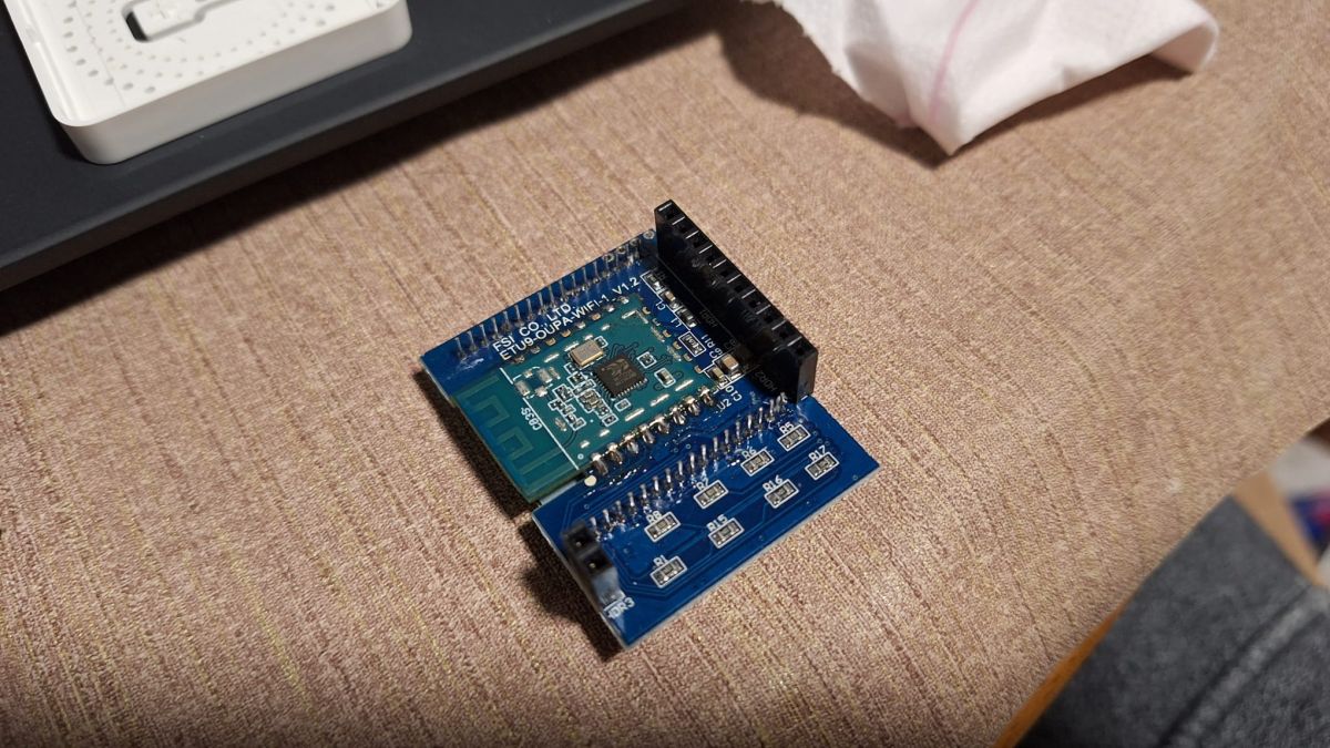

    This device can easily be opened (only two screws on the back), however, it relies on a relay that must be constantly powered, so a failure of the device will result in loss of power to the circuits downstream. The current measurement is inline with the relay, so no option to bypass without modifying it. It also heats up a bit inside, drawing the same 0.8W whenever the relay is on or off - I suspect some kind of current limited shunt power supply.
    My version doesn't measure negative values, and since communication with the BL0942 is managed by the tuya MCU, I guess there is not much that can be done other than waiting for tuya to update it's firmware. I also found it annoying that the display shows KWh and instantaneous voltage and current, but not power.
    Electronic module lying on a table with components and pins. Close-up of internal electronic components of a power measurement device. Close-up of a PCB with a BL0942 chip and electronic components. SMTONFF measuring device with a digital display showing current and voltage values.
    If you know of any additional devices based on the BL0942 or how to get under the hood on the programing of the BL0942 under Openbecken, please write here. I think we can all benefit. Meanwhile I will slowly update as I make modifications to the devices.

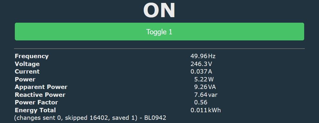

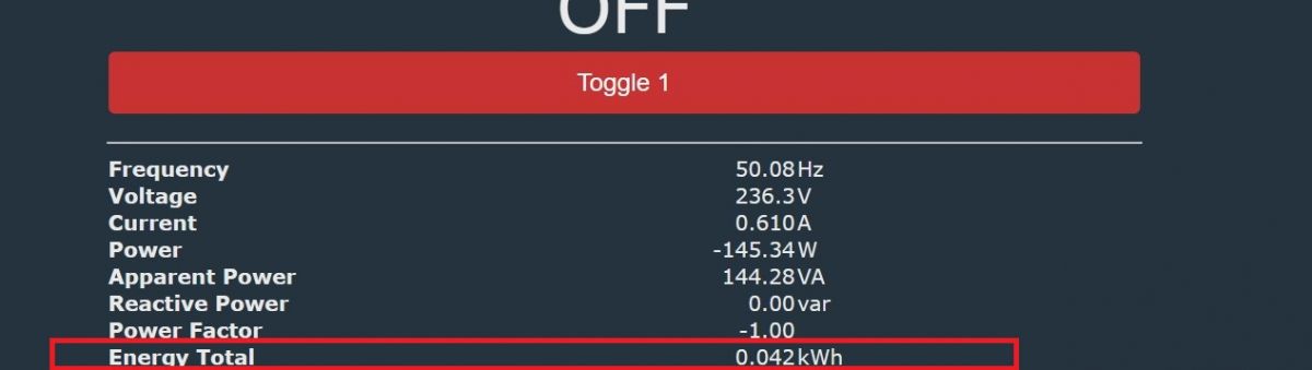

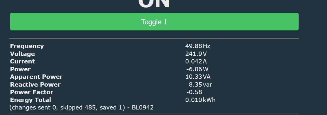

    Here's an overview using the AUBESS Power monitor switch, showing both positive and negative energy flow:
    Screenshot of the AUBESS power monitor switch interface showing parameters. Power monitor AUBESS screen displaying energy data.
    You can see in one direction there's about 0.7W more. That's due to the device measuring its own power consumption :-)
    For this to work, the following flag must be enabled under 'CONFIG' -> 'CONFIGURE GENERAL FLAGS'
    Screenshot of a flag setting in a software.
    Don't be fooled by the description, this doesn't work with the BL0937.

    Hi p.kaczmarek2.
    Thanks for your help.
    That flag only solves half of the problem. It does give me instantaneous power in both positive and negative directions, but it doesn't solve the fact that the total counter only goes up, regardless of the power direction. There should be two counters and a check to increment the correct one based on the instantaneous power being positive or negative.
    Screenshot of an interface displaying electrical network parameters showing the device is off.

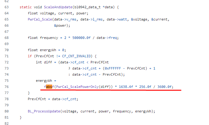

    There is no need for that. You can just search for "abs" in the code, here:
    https://github.com/openshwprojects/OpenBK7231T_App/blob/main/src/driver/drv_bl0942.c
    I think this fabs here may be the culprit, it was submitted by contributor some time ago:
    Code snippet showing a function calculating energy based on power scale.
    Do you want to get a build without this fabs?

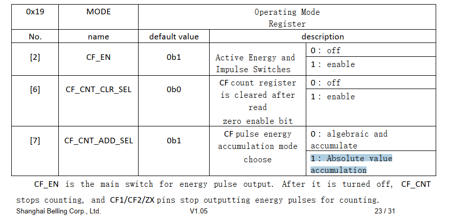

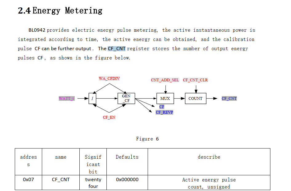

    I was able to replicate this behavior on another system initialized with the defaults (only the command 0x58 and 0xAA given to the chip to perform a reading), so I don't think this is a coding issue, rather an initialization.
    If my understanding is right, the total counter is derived from reads to the CF_CNT register
    Diagram and table describing the CF_CNT register in the BL0942 system.
    Assuming that is true, this register is initialized by default as '0b1' which means the absolute value (positive) is accumulated. I think if we were to initialize it as 0, it would count negative. We could initialize it as: 0xA8(Write command);0x19(Address) and then the 3 bytes of data 0x00; 0x00 and 0x04, which keeps everything on its defaults, except bit 7 which is toggled from 1 to 0.
    Operating Mode Register table with descriptions and default values.
    Unfortunately I can't send them directly through the serial terminal, but I think the following line of code issued at the startup of the BL0942 driver would do the trick:
    UART_WriteReg(24, 4)
    Added after 50 [minutes]:
    Having a closer look at the code, it seems we could do something a bit different:

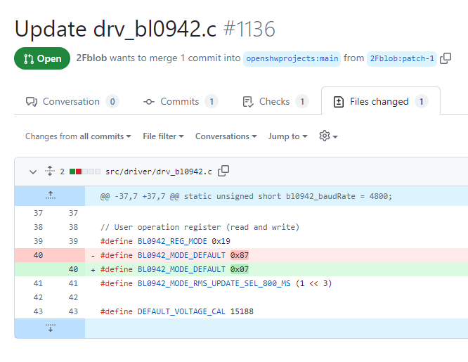

    It seems like the user mode register is initialized as 0x87, as suggested on the datasheet
    #define BL0942_MODE_DEFAULT 0x87
    I suggest, instead initializing it as 0x07. This effectively clears bit 7. It's then possible to write a define as below, in case we want to re-enable it.
    #define BL0942_MODE_CF_CNT_ADD_SEL (1 << 7)

    I have approved your PR, so we should get binaries soon:
    Screenshot showing a webpage with a request to merge changes in the file drv_bl0942.c on the GitHub platform.
    What about that abs call? Did you remove it? The only change I see is:
    The image shows a proposed change in the drv_bl0942.c code file, where the value defined as BL0942_MODE_DEFAULT was changed from 0x87 to 0x07.

    I didn't remove the abs call, wanted to do one at a time.

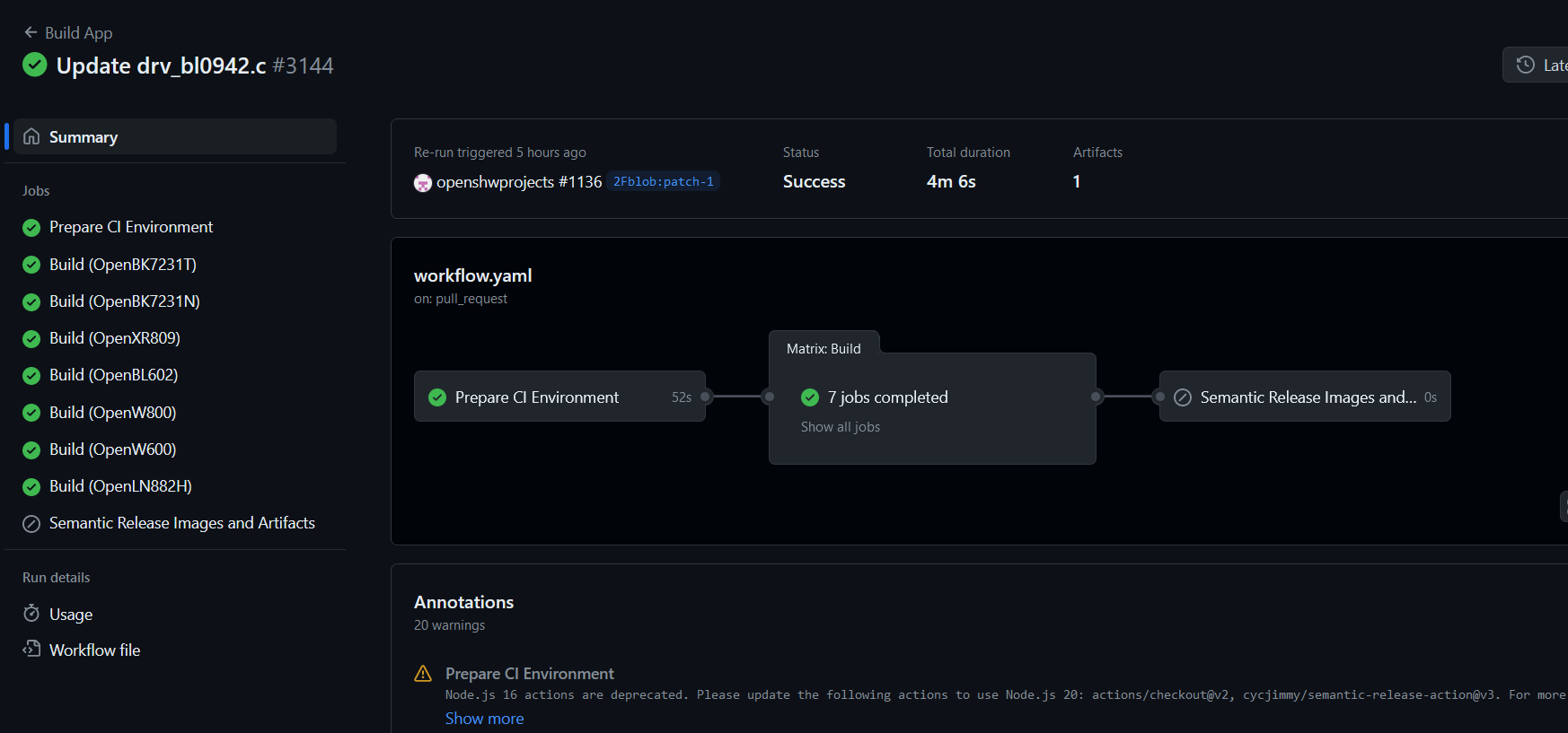

    PR is not released yet. You need to download binaries from PR. See guide:
  • #10 21016484
    cdtdsilva
    Posts: 173
    Rate: 15

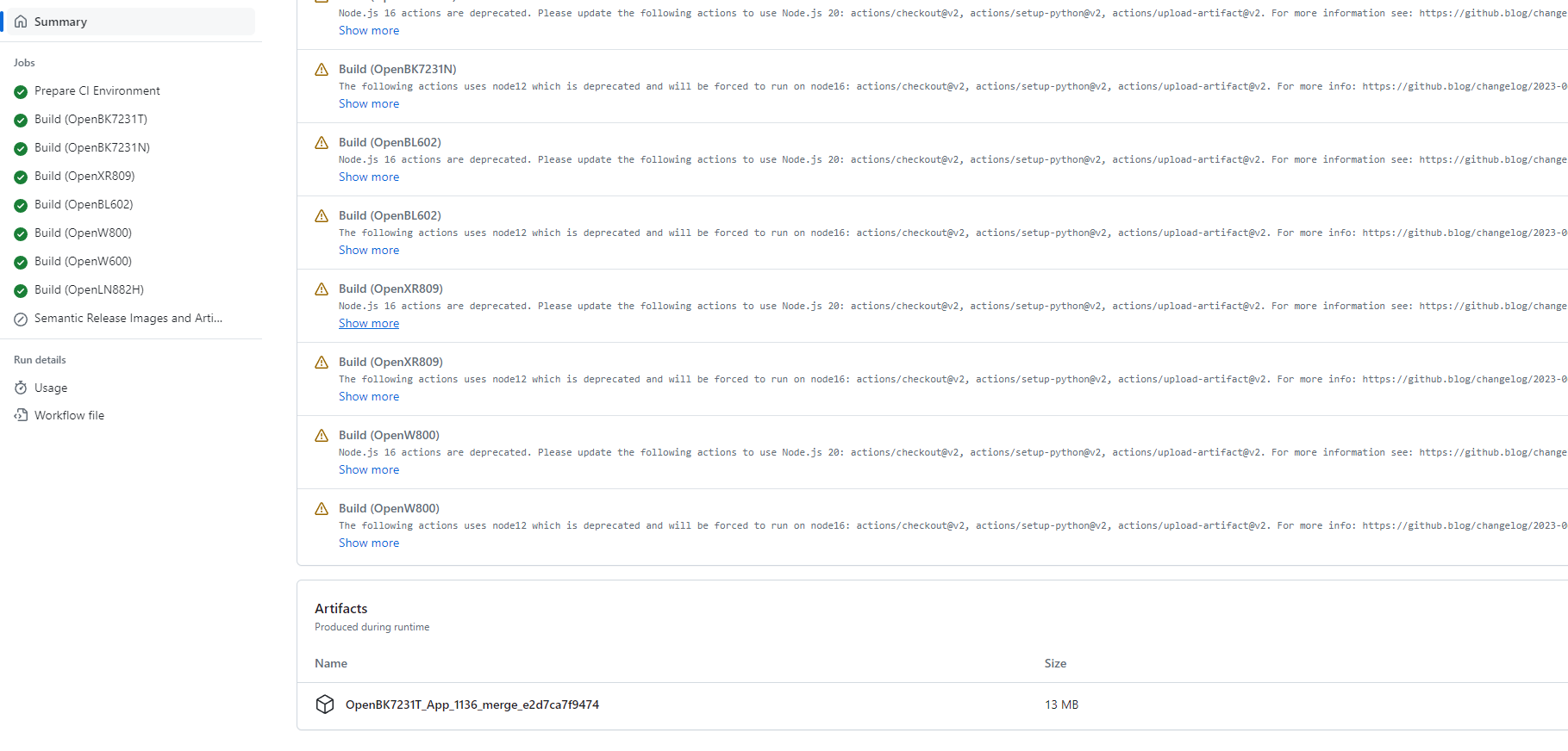

    I checked this, but the images were 'skipped' according to this page
    Computer screen showing results of an application build process on GitHub.
    So I created my own fork. Removing the function results in the counter not working. I'm investigating why.
  • #11 21016717
    Posts: 14760
    Rate: 12886
    This skipped is not a problem. Only main release is skipped, binaries are still created.
    I am speaking about this PR:
    https://github.com/openshwprojects/OpenBK7231T_App/pull/1136
    https://github.com/openshwprojects/OpenBK7231T_App/actions/runs/8398182427?pr=1136
    Binaries are here:
    CI/CD actions summary on GitHub for the OpenBK7231T project.

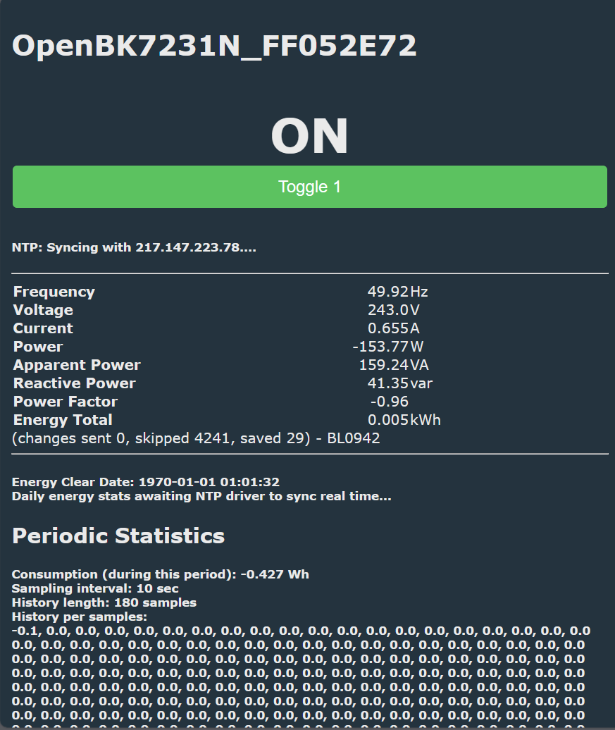

    I made a pull request to the OpenBK7231T_App repository with the changes to allow the BL0942 to measure forward and reverse energy flow.
    2 file edits: drv_bl0942.c & drv_bl_shared.c
    Summary of the changes:
    CF_CNT - the 24bit variable that collected the data from active energy accumulation could overflow, causing false readings periodically. The way this varianble reports data was changed, to be cleared after every reading (by setting CF_CNT_CLR_SEL (bit [6], reg 0x19) to one). This also simplifies the calculations, without a need to deduct previous readings (Values are simpply summed to those exixting).
    CF_CNT_ADD_SEL was set to it's default (bit [6], reg 0x19) - counting positive, so the variable doesn't roll over. In order to identify the direction of power flow, CF_REVP_F (bit [0], reg 0x09) is monitored. This bit indicates the direction of the last energy Pulse CF
    0: forward; 1: reverse. Therefore when performing the reading, the value of CF_CNT (Accumulated energy) can be assigned to either the forward or reverse register. At the moment, being there is only one counter register, it increases it or decreases it. In order to get this behaviour, a line on the drv_bl_shared.c file had to be commented out, to allow negative values.

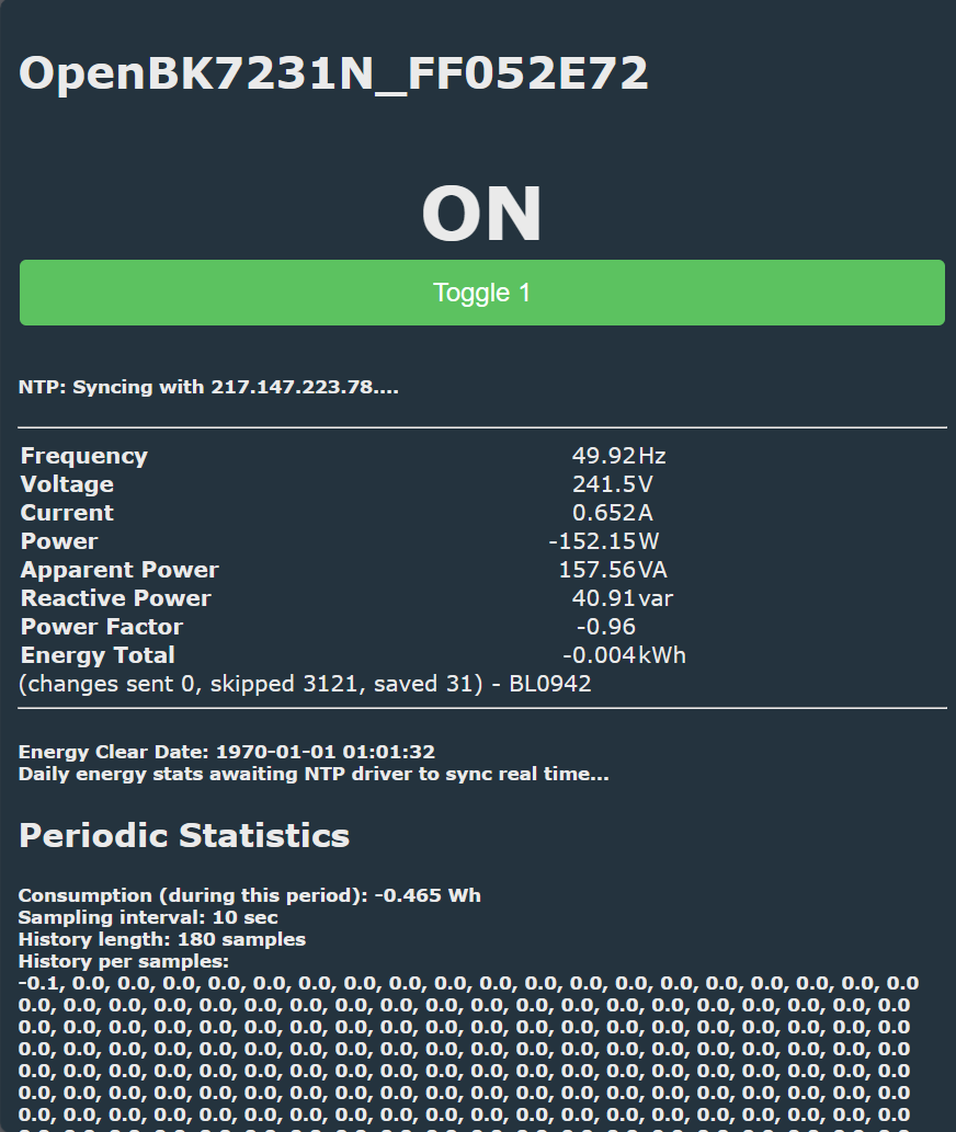

    One other modification: register 0x14 (Active power anti-passage register) was programmed to zero out the instantaneous power at idle (for example, when device measures noise or it's own power consumption). A Value of 64 works well and still allows a 6W light bulb power consumption to be measured. It would be good to have an entry on webpage to adjust this value.
    Energy monitoring panel OpenBK7231N with negative power reading. Screenshot of the OpenBK7231N user interface with active power measurement mode.
    The 'Periodic Statistics' doesn't work well under negative flow. As it can be seen on the pictures above, only the first value can be read negative. Following ones default to zero, which caps the field 'Consumption (during this period)'.
    Where I now need help:
    Fix the inability of the periodic statistics to deal with negative readings
    Add 3 counters, instead of 1, for total power.
    - Forward Energy (Consumption)
    - Reverse Energy (Production)
    - Absolute Energy (Consumption - Production)
    I would like statistics to apply to the "absolute energy" - with an option to set a timer, with an adjustable duration, to reset it. This is to assist with net metering, where utilities allow 15 or 60minutes net metering. After that period, any left over unused energy is 'given' to the network, so the counter should be reset.

How easy are these units to open and flash? Any gotchas?
AUBESS is easy to open and program, with a neutral‑cut relay you can bypass in wiring. Tongou has a riveted enclosure that’s harder to reassemble. Some SMTONFF units require removing the WB3S Wi‑Fi module to access programming. If the Tuya MCU owns BL0942, you may not get directional data until firmware changes. Plan access before installation. [Elektroda, cdtdsilva, post #21012850]

How do I enable negative flow on an AUBESS/BL0942 device in three steps?
  1. Flash OpenBeken onto the BL0942-based device (e.g., AUBESS).
  2. In CONFIG → CONFIGURE GENERAL FLAGS, enable the negative-power direction display.
  3. Verify Live View shows positive and negative readings; expect ~0.7W offset from self-consumption near zero. [Elektroda, cdtdsilva, post #21014044]
