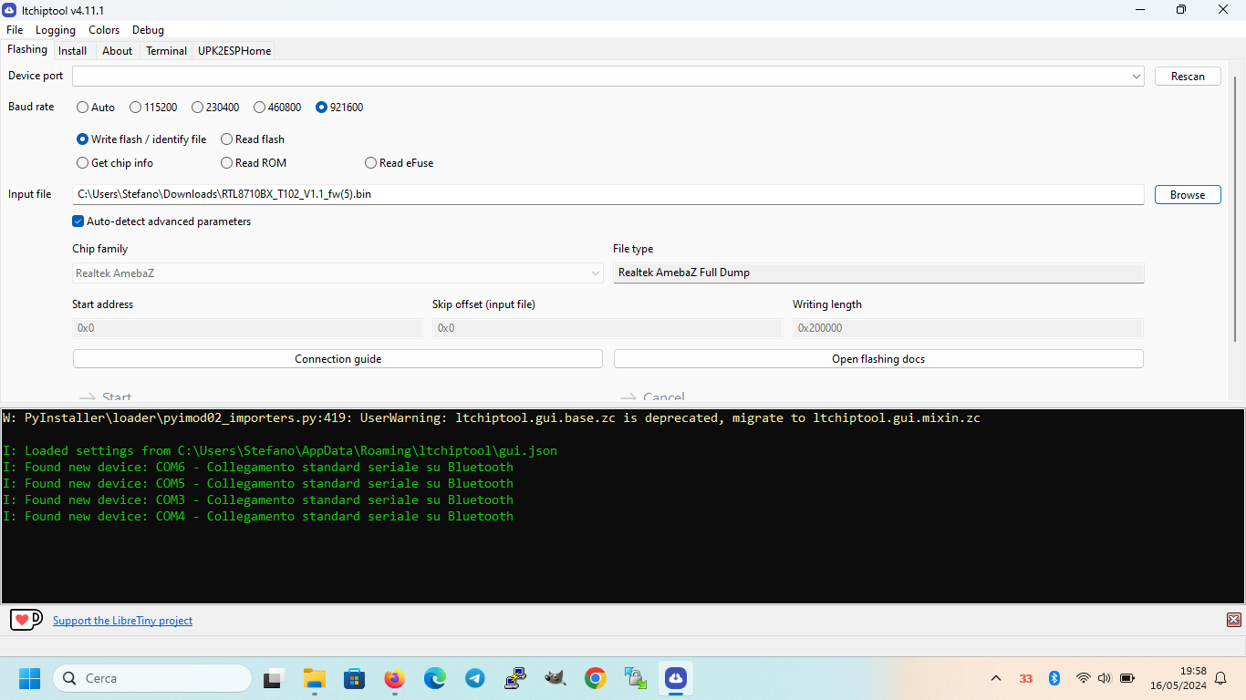

    I haven't figured out how to implement it, do I need to recompile libretiny?
  • Patch wiring_irq.c to use IRQ_RISE workaround
    #5 21015321
    so_meone
    Just find the file wiring_irq.c and modify it.
    It should be in "%userprofile%\.platformio\platforms\libretiny@1.4.1\cores\realtek-amb\arduino\src\wiring_irq.c" (or something similar depending on os and version of libretiny used)
    Theres a #if block which throws the error at line 64.
    Editing it to use IRQ_RISE(or FALL) instead of failing works around this problem with pulse_counter, it will probably change the returned pulse count as well but this is handled by the calibration.

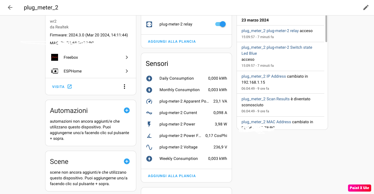

  • #6 21016145
    SteIta
    Posts: 8
    Ok, i changed the file, but i'm not able to using PlatformIO, Then I'll try in a few days.
    You've looked at my yalm, it works pretty well.
    User interface displaying data for device plug_meter_2, including energy consumption, automations, and events.

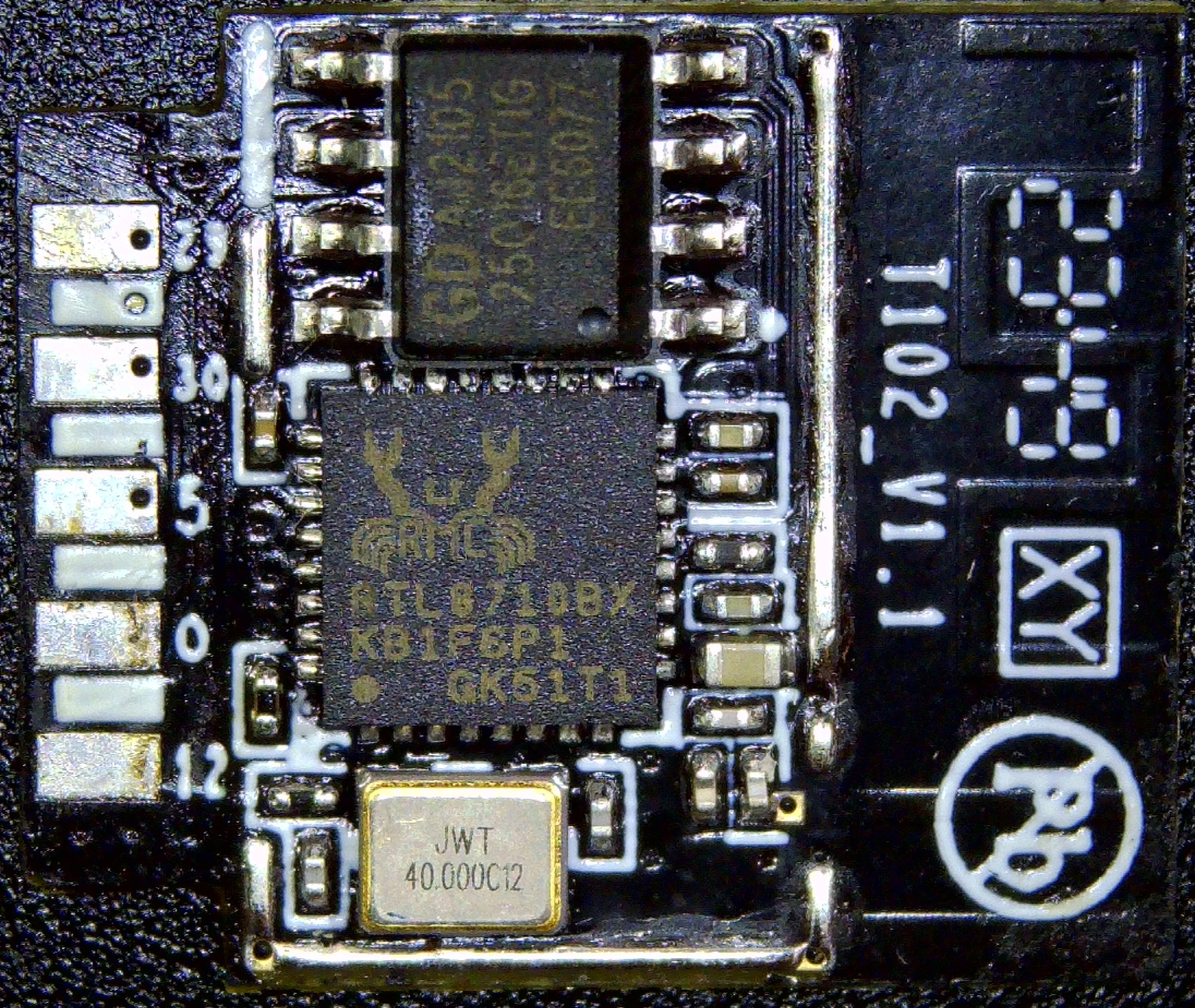

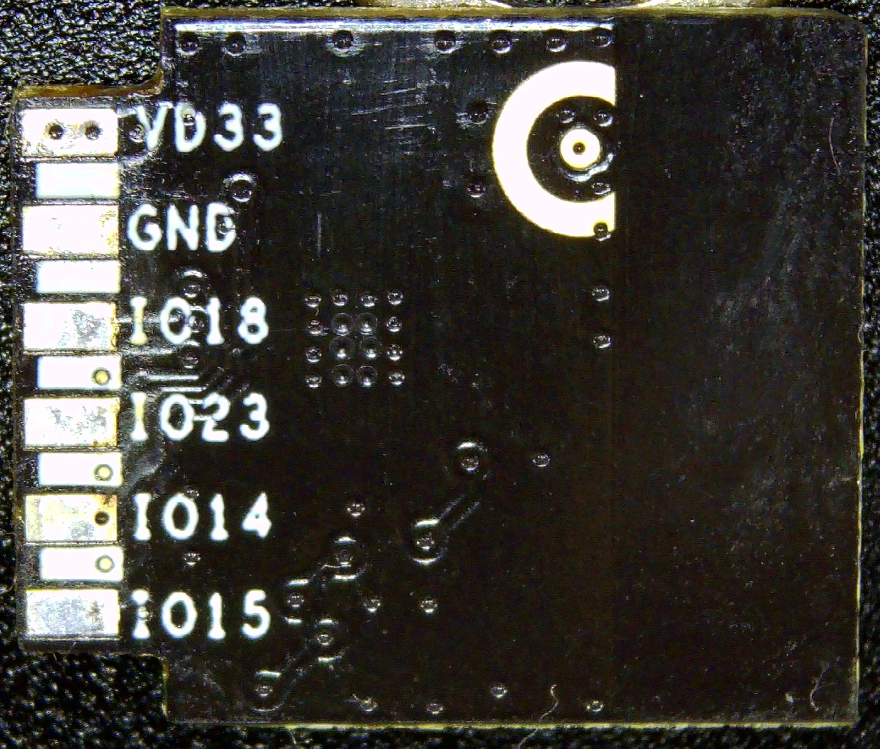

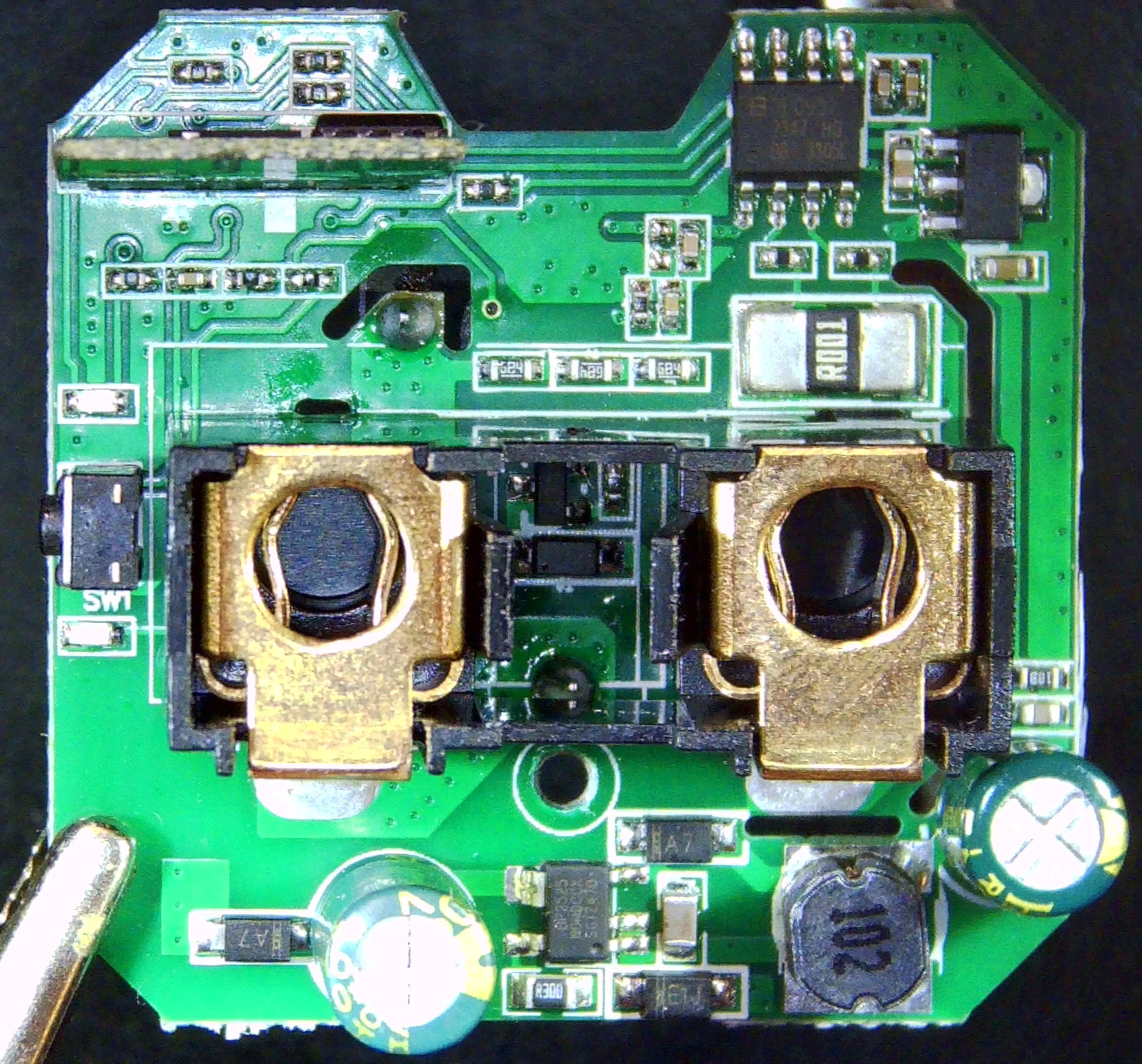

  • RTL8710BX socket teardown with BL0937 chip
    #7 21033002
    Raufaser
    Posts: 47
    Rate: 16
    Hi.
    I order this RTL8710BX smart socket for 2,50€ in sale a few days ago and it arrived today. I was surprised, that it has this rather exotic chip. So I am in for some testing. And hopefully OpenBeken development for this chip will continue someday :)

    I have T102-V1.1 with RTL8710BX chip. According ESPHome boards list T102-V1.1 has RTL8710BN chip. BX clocked at 62.5 MHz (instead of 125 MHz for BN). I think this is important or?
    I don't know, if this is reason, but board can not connect to WIFI.
    [I][wifi:303]: WiFi Connecting to 'ov593'...
    E [33.201] WIFI: Connection failed; ret=-1

  • #13 21085028
    SteIta
    Posts: 8
    No ota, no uf2.
    The bin file is exactly, You can flash it like you did the first time:
    Screenshot of ltchiptool software for firmware flashing.

    We can close my issue. I examined the board under a microscope and found a ball of solder on one of the chip legs. I removed it and everything worked. Thanks for your help.
