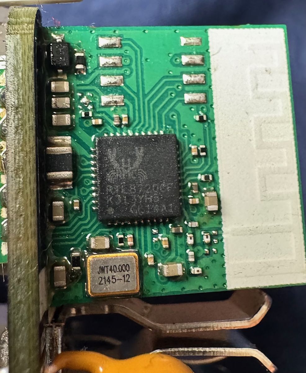

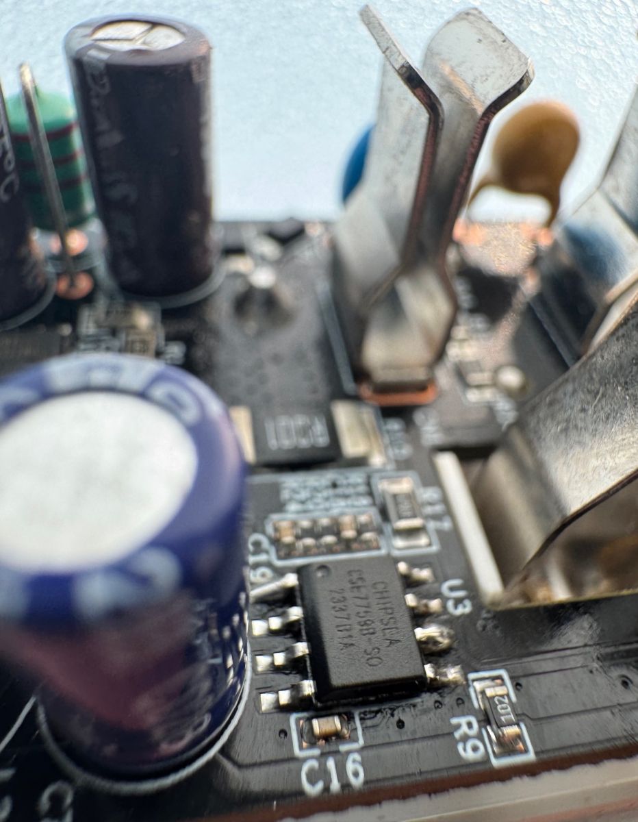

    I've been trying to get this smart plug with energy monitoring working on OpenBeken. I was successfully able to flash the new firmware after desoldering the chip. The button, relay, and leds all work fine. However, I can't get the CSE7759B working for the life of me.

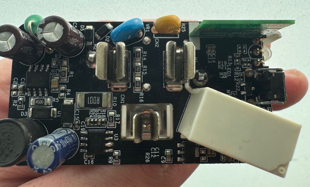

    Any help with this would be appreciated. I plan to do a proper teardown once I get this working.
    Attatched are pictures of the board

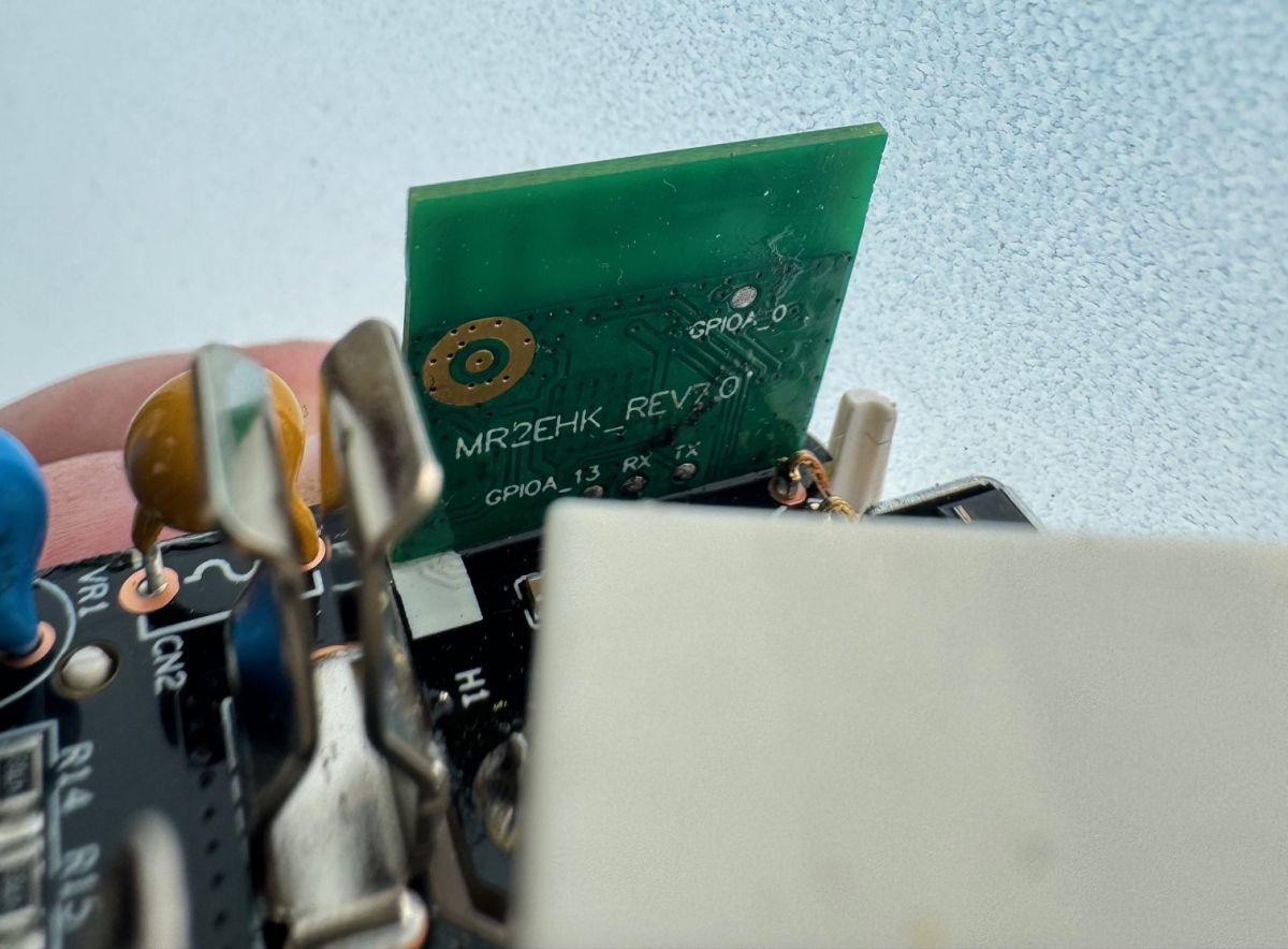

    Circuit board with electronic components held in a hand. Close-up of a circuit board featuring the RTL8720CF chip. Close-up of a circuit board featuring a green card labeled MR2EHK_REV30 with pins marked as GPIOA_13, RX, TX. Close-up of a circuit board featuring CSE7759B markings.

    Check which pins of the mcu the power monitoring chip is connected. It might not be using default UART pins. There is a configuration setting to use alternative uart.
    Data captures seems fine they start with 0x55 as espected
  • #3 21421070
    A6uh
    I believe TX of the cse7759b is connected to GPIOA_13 and RX is on GPIOA_14. However, the alternate UART setting just stops all the logs altogether.

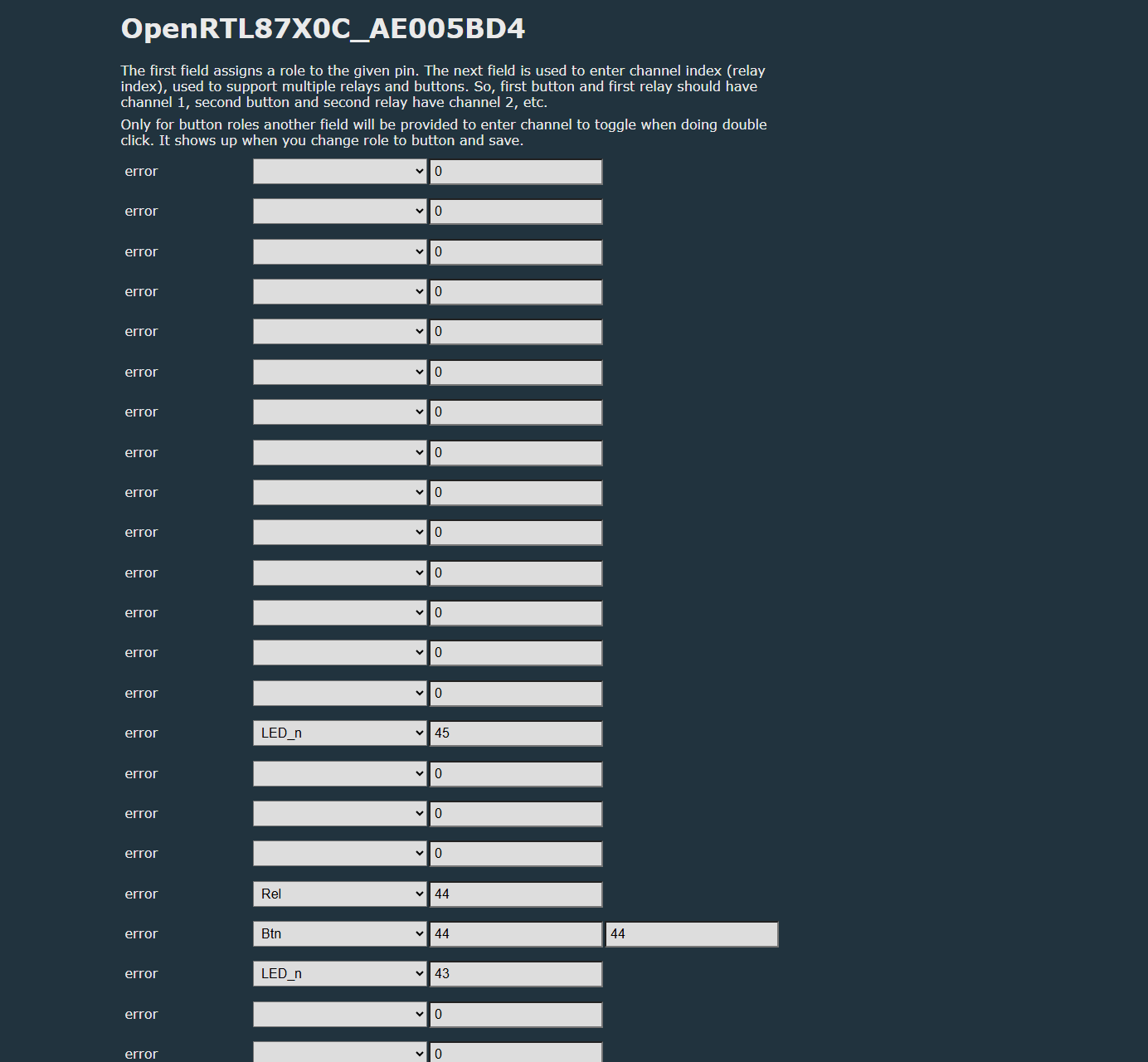

    Unfortunately still getting the same thing, except all the pins in the Module section show "error" with this one. Earlier, I did make a build that just dumps all the UART packets to logs. I can reflash that one and post those logs if it'd be useful. Those logs definitely didn't match up with what I was seeing when connected directly to the cse7759b.

    Screenshot of a module pin configuration where all pins show error.

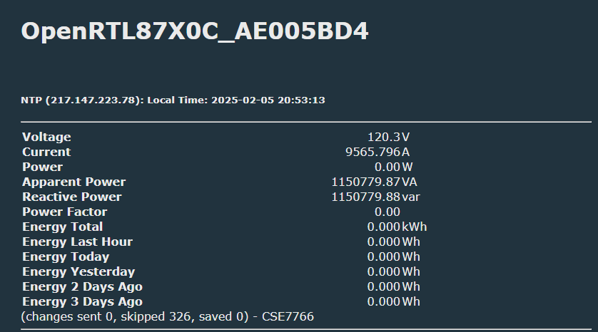

    Edit: Actually, there is something happening? I'm unable to trigger the relay, leds, etc though. Reflashing with a regular build restores use of the relay and leds with the same config.
    Screenshot of OpenRTL87X0C interface displaying energy data
    Edit 2: I rebuilt the firmware with the change you made and the pins all work correctly now. No idea what happened with that build. I need to find something I can use to properly calibrate it in the meantime. However, the voltage has been reporting correctly so far. Only the Power and Current have been a little weird.
    Edit 3: After calibration, it seems to be working fine. I did notice Power reports initially, but after about 10 seconds, drops to 0w and will occasionally jump back up to the correct wattage.

    Kill-a-watt or equivalent device should be best to calibrate. You might try to use some old incandescent bulb with rated wattage, but that won't be very accurate.
