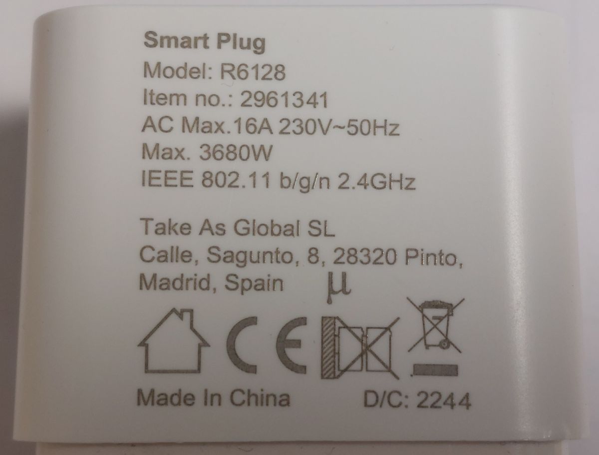

    About The Device
    Woox - Smart Plug
    Model: R6128
    Item no.: 2961341
    4 box ean: 8435606729147
    (BK7231N/CB2S - BL0937) WOOX R6128 Smart Plug with Energy Monitoring

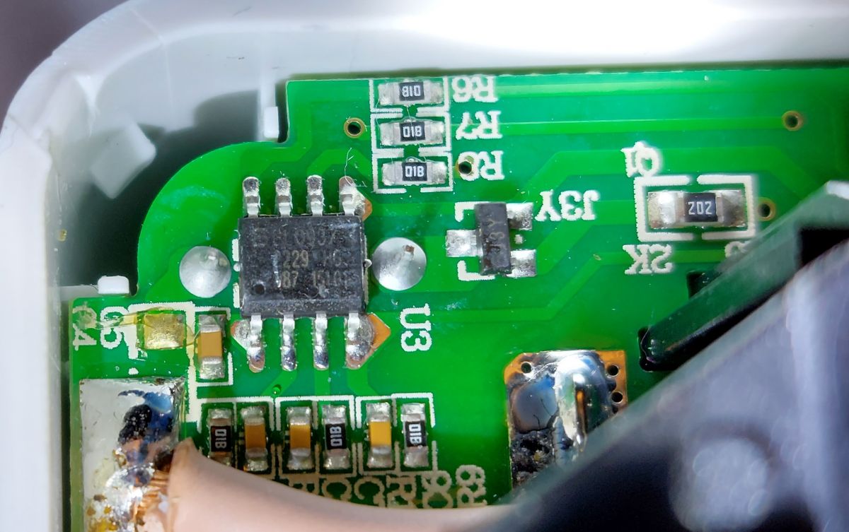

    Disassembled
    CB2S BL0937

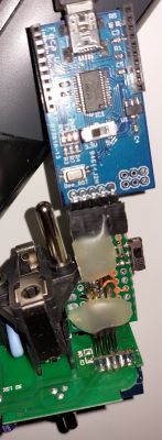

    Flash / backup virgin state:
    https://github.com/libretuya/ltchiptool

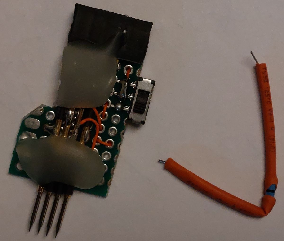

    Pogo-pin jig and 0 Ohm resistor for the reset

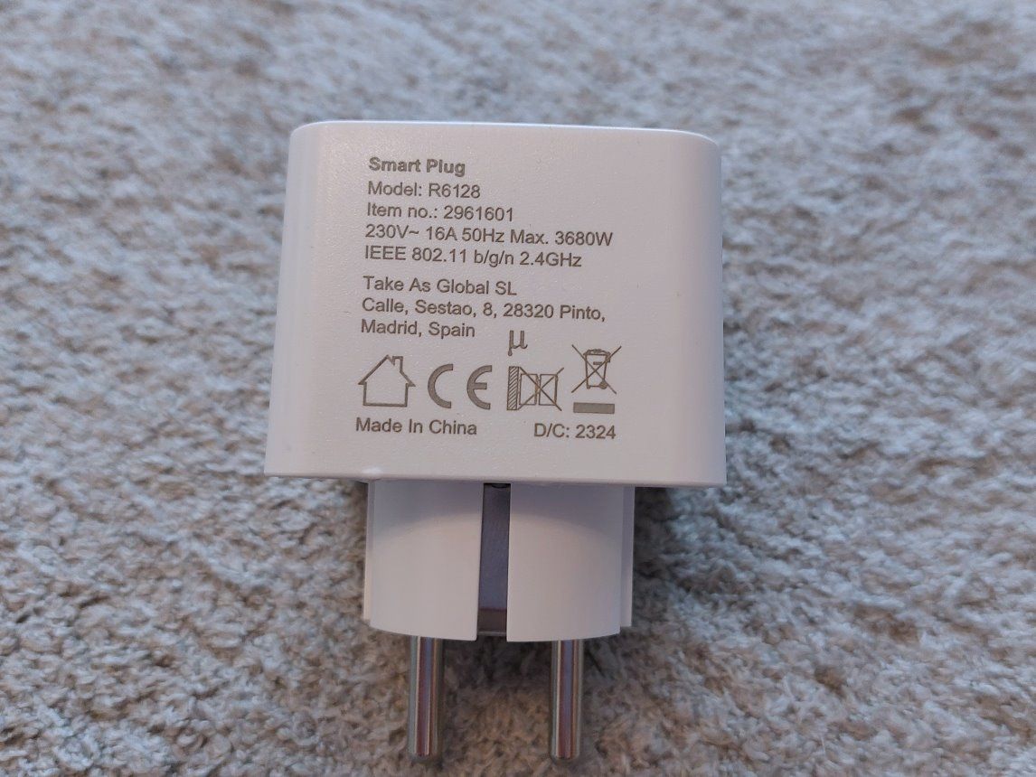

    I've bought the same smart plug more recently, here are some updated information.
    Ordered as "WOOX R6128 Smart Plug 16A FR Type E with Energy Monitor" in Czechia from Alza.cz.
    (BK7231N/CB2S - BL0937) WOOX R6128 Smart Plug with Energy Monitoring WOOX R6128 smart plug lying on a gray surface, shown from the back with technical information visible.
    Smart Plug
    Model R6128
    Item no.: 2961601
    230V~ 16A 50Hz Max. 3680W
    IEEE 802.11 b/g/n 2.4GHz

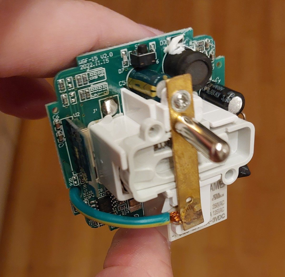

    The case can be opened by prying out near the corners (not the flat sides), as noted in the other Nedis plug thread that uses the same housing.
    Some damage to the plastic edge must be expected, but fortunately from the back/wall side.

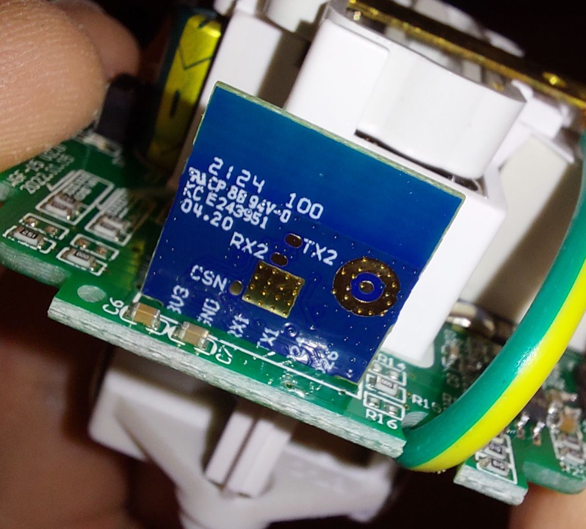

    Close-up of internal components of WOOX R6128 smart plug. Close-up of a smart plug circuit board with a blue module.
    PCB
    WGF-15 V2.0
    2022.11.15

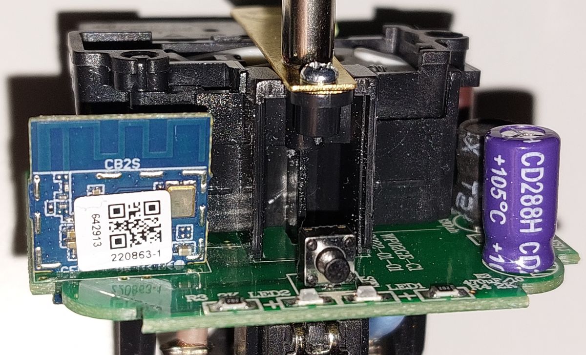

    Module
    Model: CB2S
    P/N: 2.01.01.105610
    S/N: 1000940850....

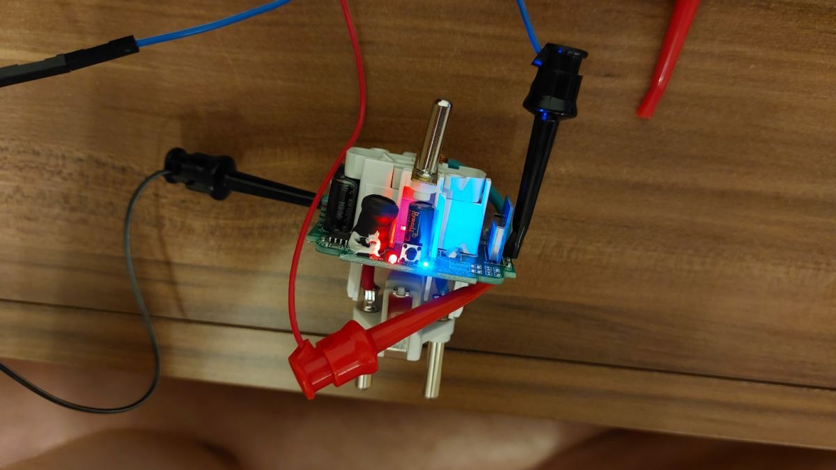

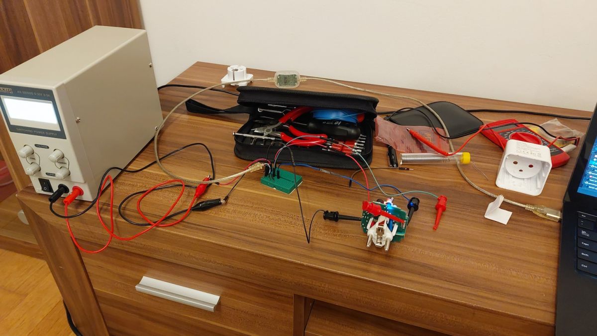

    I've used a lab power supply to give the module the 3.3 V power and a some generic old trusty USB/Serial cable for communication.
    I decided to connect everything with just test hook clips, so no soldering was needed.
    GND was easy to hold on to some long component leg from the other side, for example (I traced some fat PCB line, verified with connectivity test).
    Well, one clip had to be held by hand a bit, but flashing with the BK7231GUIFlashTool was so easy and quick that it was not a problem.

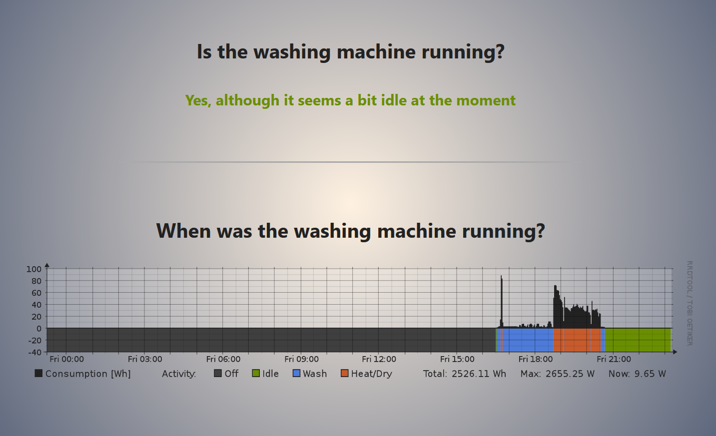

    I set the plug up with NTP and SetupEnergyStats at first, but I ended up not needing them in the end.
    As the device's state is periodically polled over the HTTP API `/cm?cmnd=SENSOR` from another box on the LAN instead.
    And then graphed with the venerable rrdtool.
    Used to monitor the washer/dryer operation 🙂
