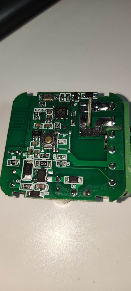

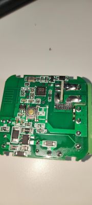

    This is a generic smart switch from Aliexpress.
    I try cloudcutter but without success
    Please can you help me to understand how to flash, and where to solder cables?
    Thanks

    Hello, with such low quality photo, I am unable to point which pads are RX, TX, 3.3V and GND, but you should be able to figure it yourself with:
    BK7231N Generic Smart Switch: Aliexpress Flashing, Soldering Cables & CloudCutter Issues
    But isn't it similar to the switch here:
    [BK7231N+BL0942] DIY Smart Mini Switch - WBP-1G - configuration, pinout, program
  • #3 20538882
    giovannij600
    Posts: 16
    Hello and thanks for the reply. Yes, it looks the same as what you posted, I couldn't find it before! Please now can you tell me how I can proceed with flashing? Thank you

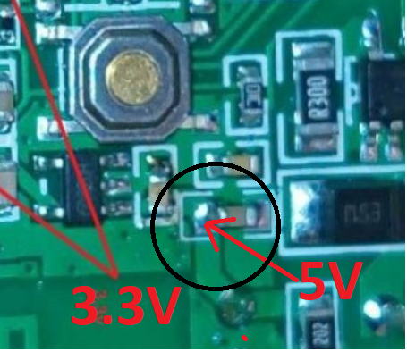

    It is N.
    I understand how to use the flash tool but I do not understand how to connect pins to USB to TTL.
    Also I do not understand why in the videos she does not connect the 3.3V directly to USB to TTL but uses an external 5V with a level converter?
  • #6 20538948
    Posts: 14756
    Rate: 12883
    3.3V from that tiny LDO on USB to UART converter does not have enough current capability to power WiFi module and with this approach you may get flashing issues.
    You can always just find the AMS1117 3.3V LDO regulator on the board of your device and just connect USB 5V to the input of AMS1117-3.3V so it outputs 3.3V for WiFi module

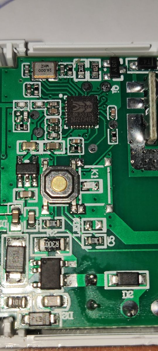

    Sorry just now I realized the link you posted and also the image is for the T version, I have the N version.
    The pinout is the same?
    I attach a more detailed image
    #8 20538978
    Posts: 14756
    Rate: 12883
    The pinout is the same for both versions - RX, TX, GND and VDD are in the same places.

    Do you mean I can find it on the smart switch itself or in the USB to TTL?
    #10 20538998
    Posts: 14756
    Rate: 12883
    I think this topic has marked pads, please open the image:
    It has shown which is RX, TX, 3.3V, etc...
  • Clarifying USB-to-TTL wiring for BK7231N flashing
    #11 20539031
    giovannij600
    Posts: 16
    Sorry, I ask for a little patience but I need to understand well.
    I have to connect to device to USB to TTL in this way:
    DEVICE ---------USBtoTTL
    RX --------------TX
    TX---------------RX
    CEN ----------- for flashing mode
    and from a USB connected to the PC I take the 5V and the GND
    USB-----------Device
    GND -----------GND
    5V ------------ 5V indicated on the image (I attach the detailed image here)
    Is this correct?
    Added after 5 [hours] 41 [minutes]:
    Added after 39 [seconds]:
    I get it!!
    Flashed with the last OpenBK Version
