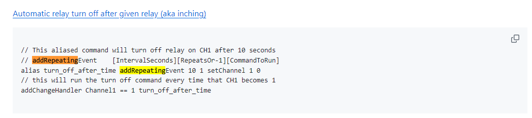

    Is it possible to program the output in the switch so that after pressing 'toggle' On, it automatically switches to the Off state after a few seconds?
    This switch controls the garage door and I would like to emulate turning On the switch only for a moment.

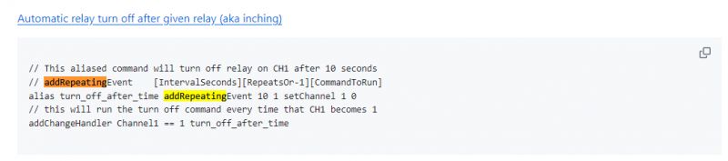

    Please check the following examples:
    Is this what you need?
    Screenshot of example code for automatic relay turn-off.
    EDIT: but if you have dInput (not button) on the same channel, then it will require some futher adjustements

    Perfect example - this is what I need... but there is one challenge: I have an LN882H, so the filesystem (autoexec.bat) is not supported right now (or I'm wrong)
