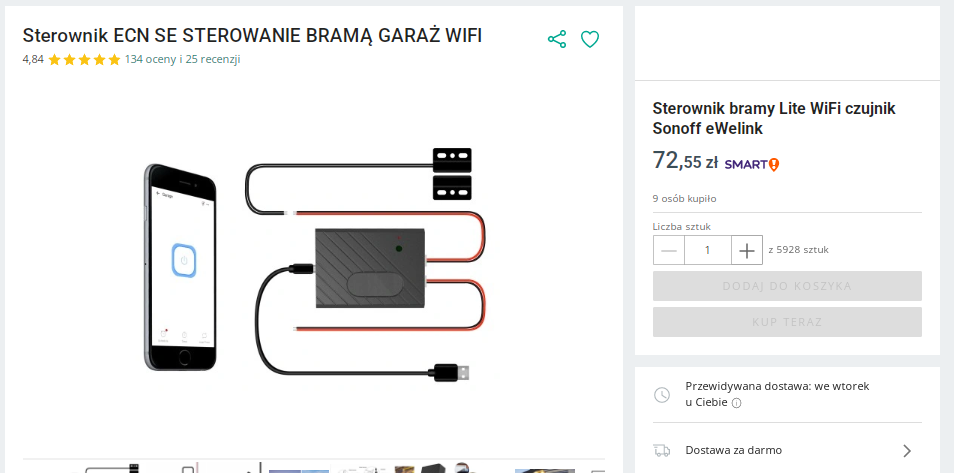

    Purchase of the ECN SN kit
    The set was bought on a Polish auction site for about PLN 73:
    [ESP8285] SE831L intelligent garage door controller - interior, analysis
    Let's take a look at its description so you know what kind of product it is:

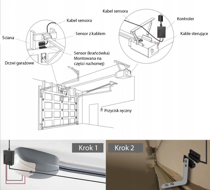

    Assembly instructions:

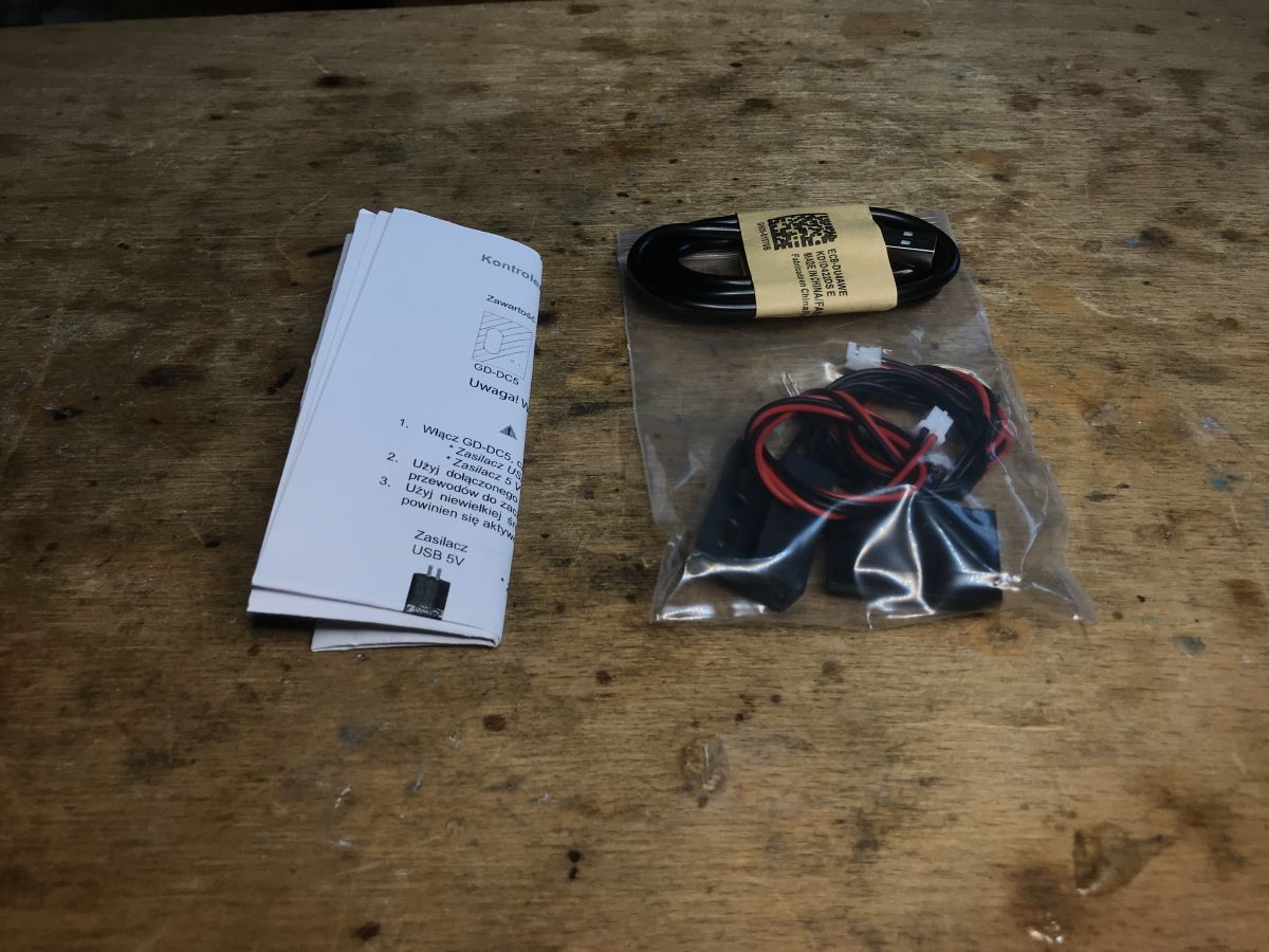

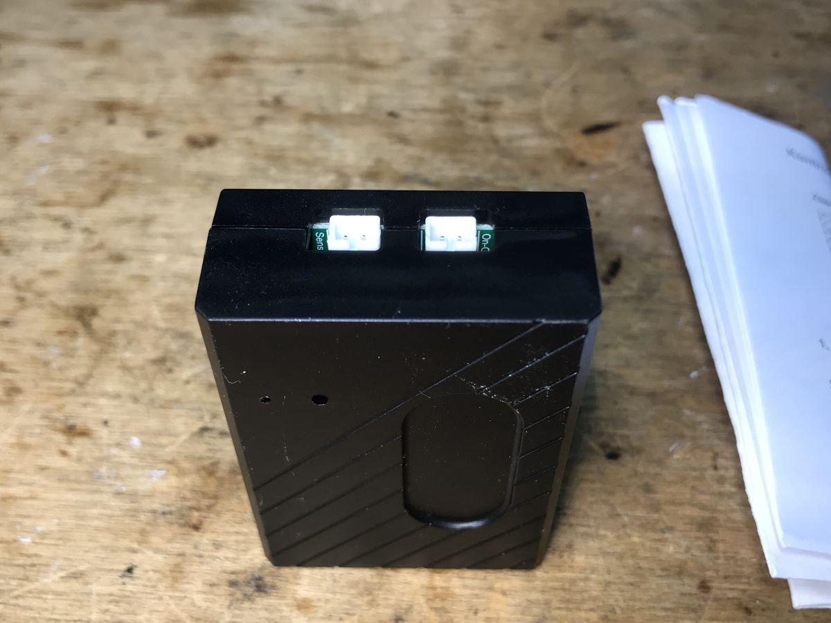

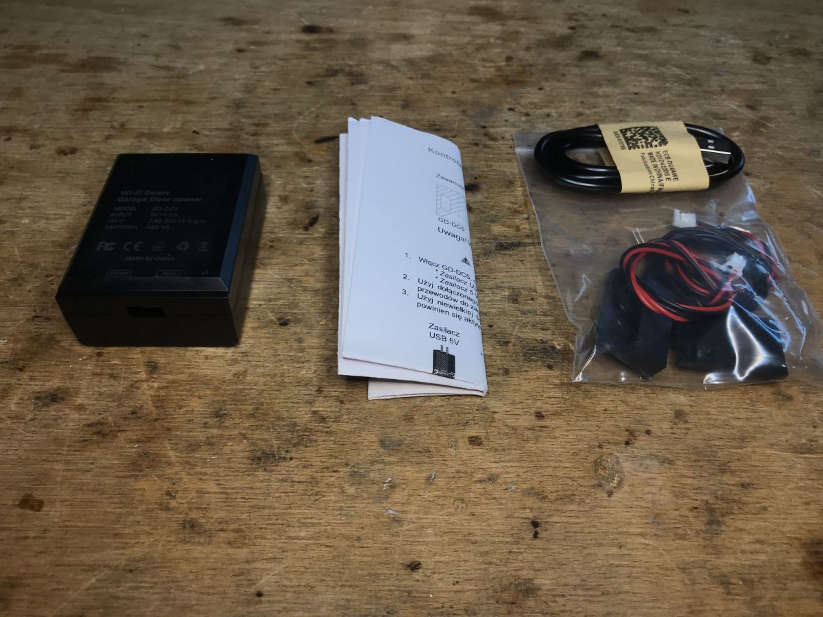

    Received set
    Let's see what we get in practice:
    [ESP8285] SE831L intelligent garage door controller - interior, analysis [ESP8285] SE831L intelligent garage door controller - interior, analysis
    Everything is there, there is an opening sensor, there is a cable to connect the button, there is a USB cable for power supply, and the manual and the device itself are also present.

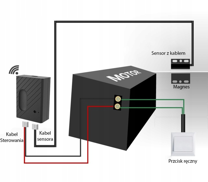

    How does such a controller even work?
    I already described this in the previous topic about the gate, there was a controller on CB3S (BK7231N):
    WiFi garage gate controller, Smart Garage Opener Tuya - Home Assistant

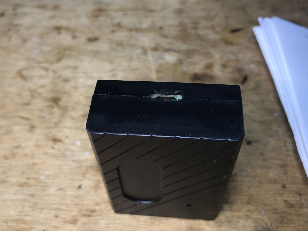

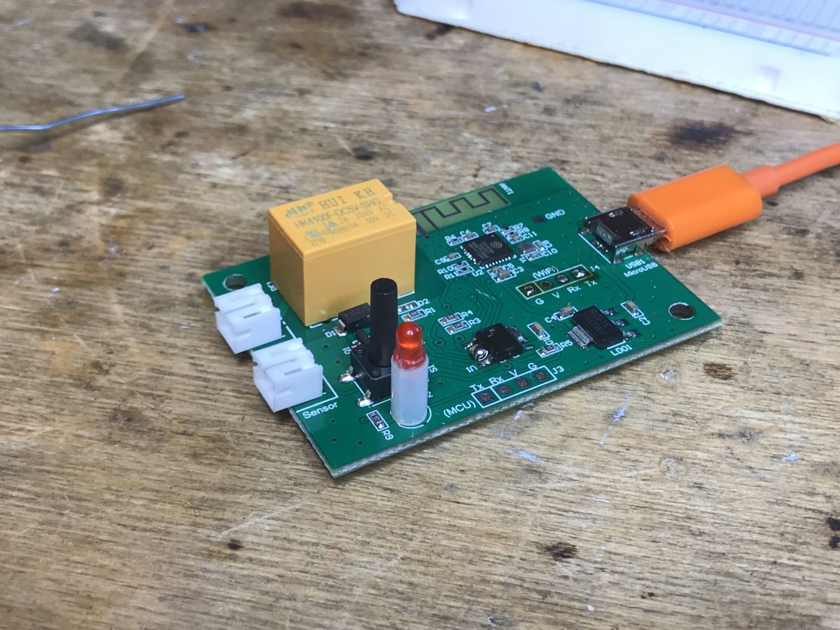

    The inside of the controller

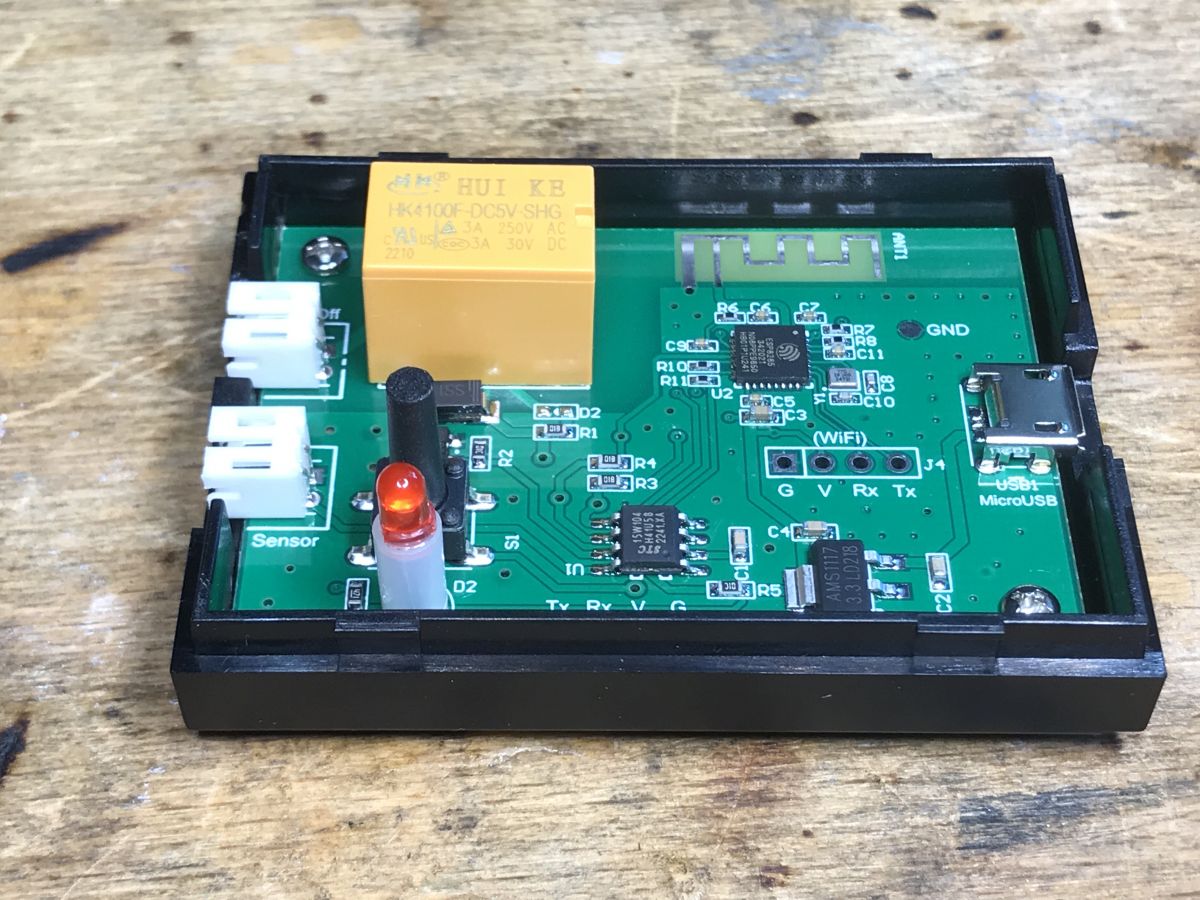

    I skip the tests with the manufacturer's application, we immediately look inside. Just pry the cover up.

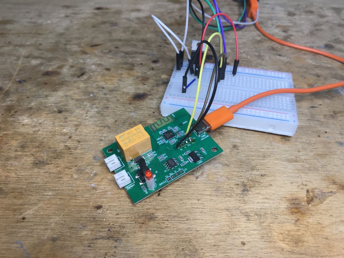

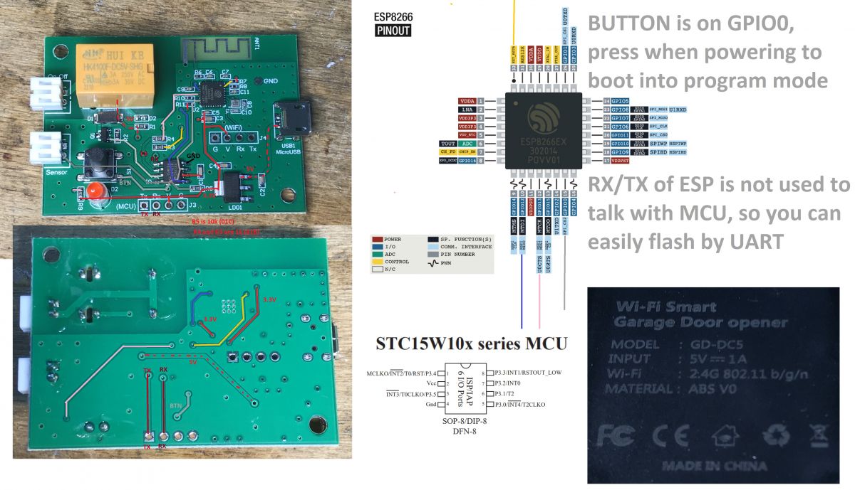

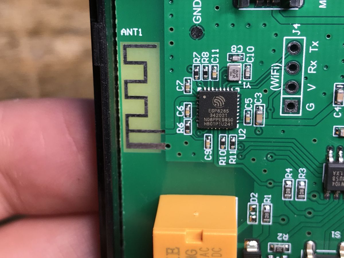

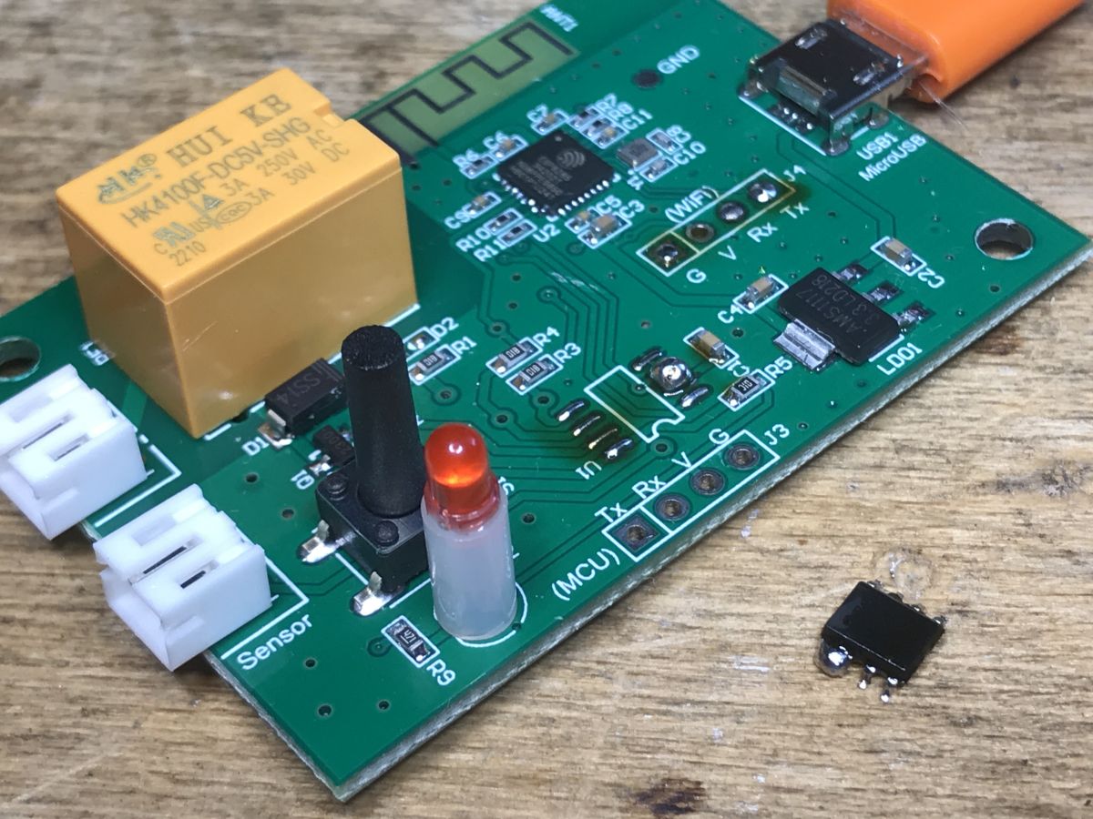

    The ESP8285 is directly on the PCB here. There is also AMS1117-3.3V, because ESP requires 3.3V, and the input is 5V from USB. There is also a small SOIC8 chip inside, STC 15W104 H41U58 2241.XA. It is a microcontroller, core 8051.
    Pinouts:

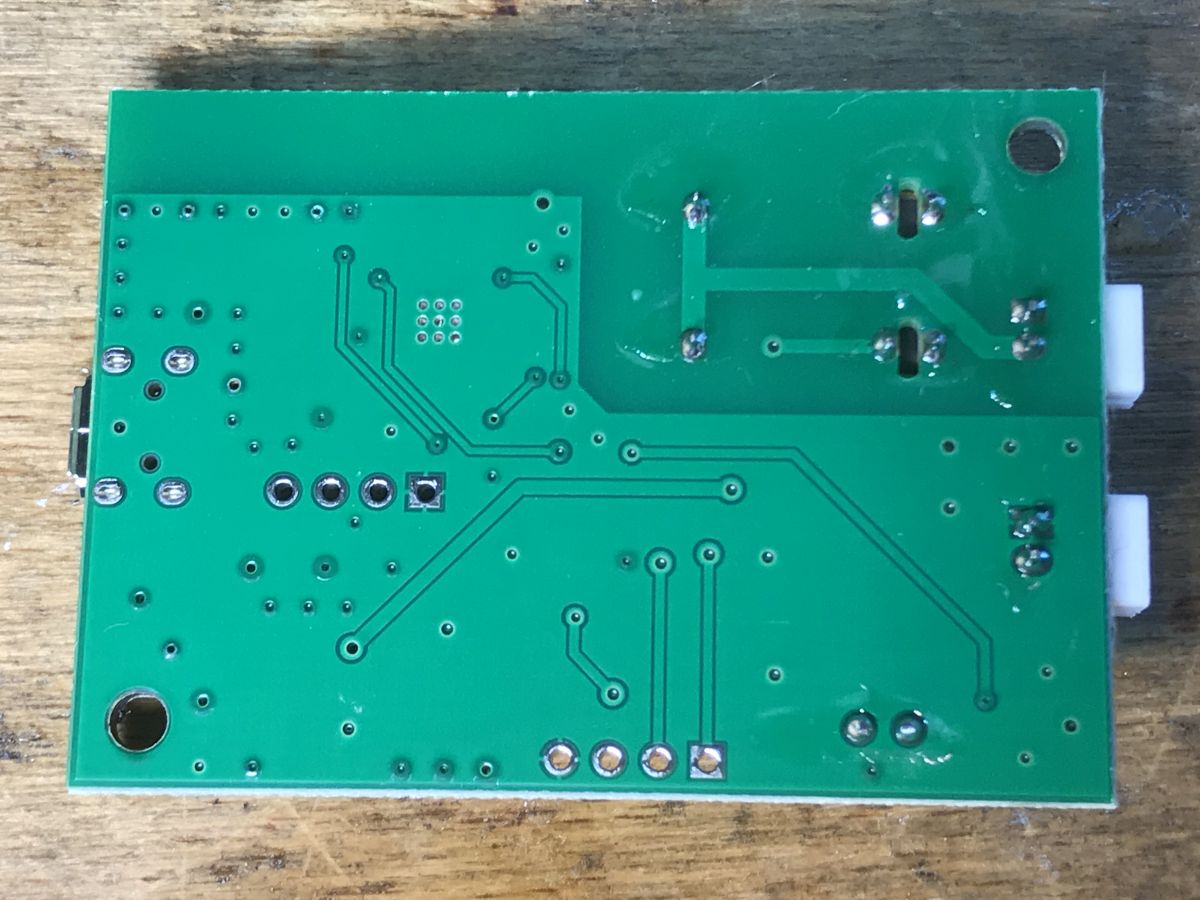

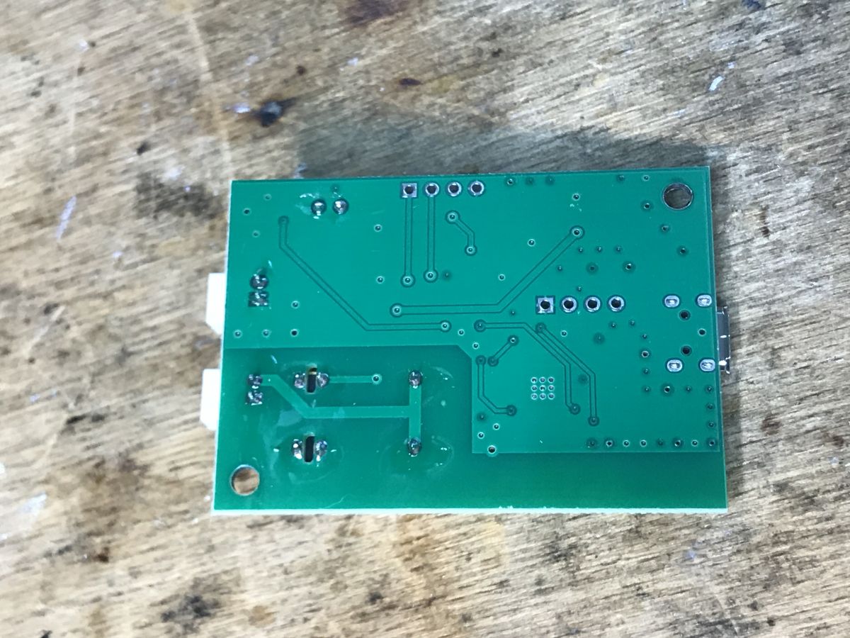

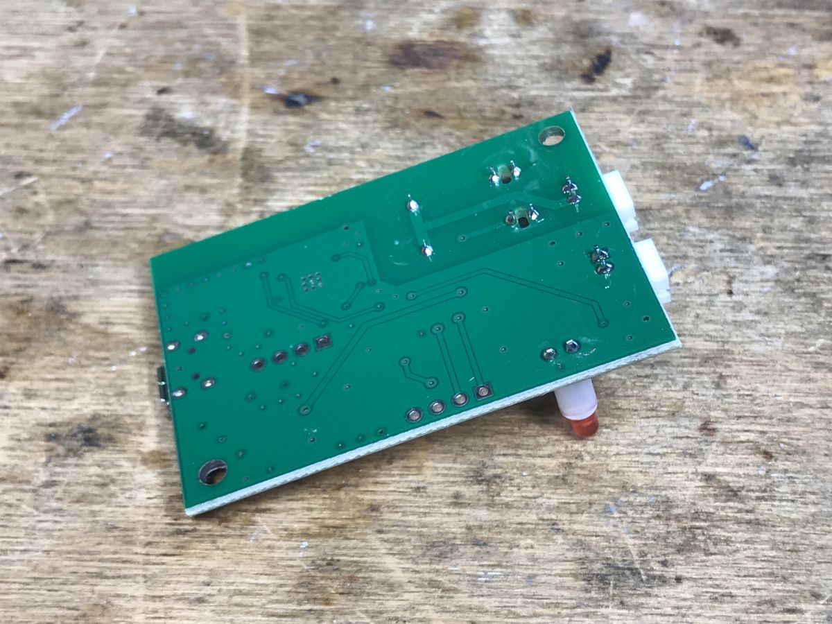

    There is nothing interesting on the bottom of the PCB:
    Based on the photos, I made a list of connections - it will also be useful for setting the Tasmota's GPIO:
    Only that... if there is an additional MCU here, how can we set the GPIO? About that in a moment.
    Firmware change

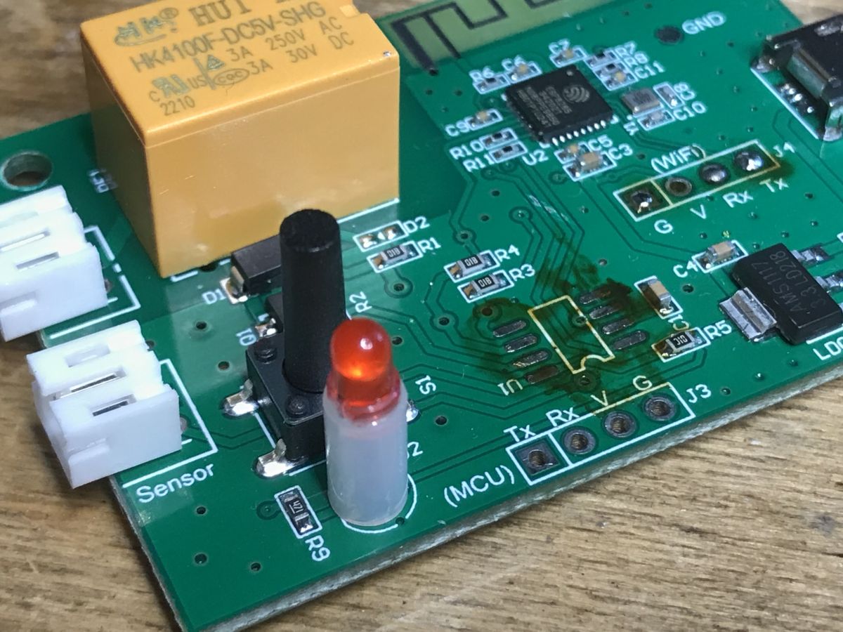

    You can easily upload Tasmota here. RX and TX is available. The UART port is not occupied by the MCU, it is not a TuyaMCU device. This microcontroller is on a regular GPIO.
    GPIO0 is on the button, just press it before connecting the power.
    esptool.py works, as I have already described several times:
    https://www.elektroda.pl/rtvforum/topic3866386.html
    The only thing left is what about the MCU...
    My suggestion is to desolder it. First, we apply flux, then additional lead binder (we make bridges on its pins), and then we quickly heat both sides with a soldering iron. The layout can be removed after a while with tweezers:
    And that's it for now. Then it is enough to make jumpers and program the Tasmot IO, but more on that another time.

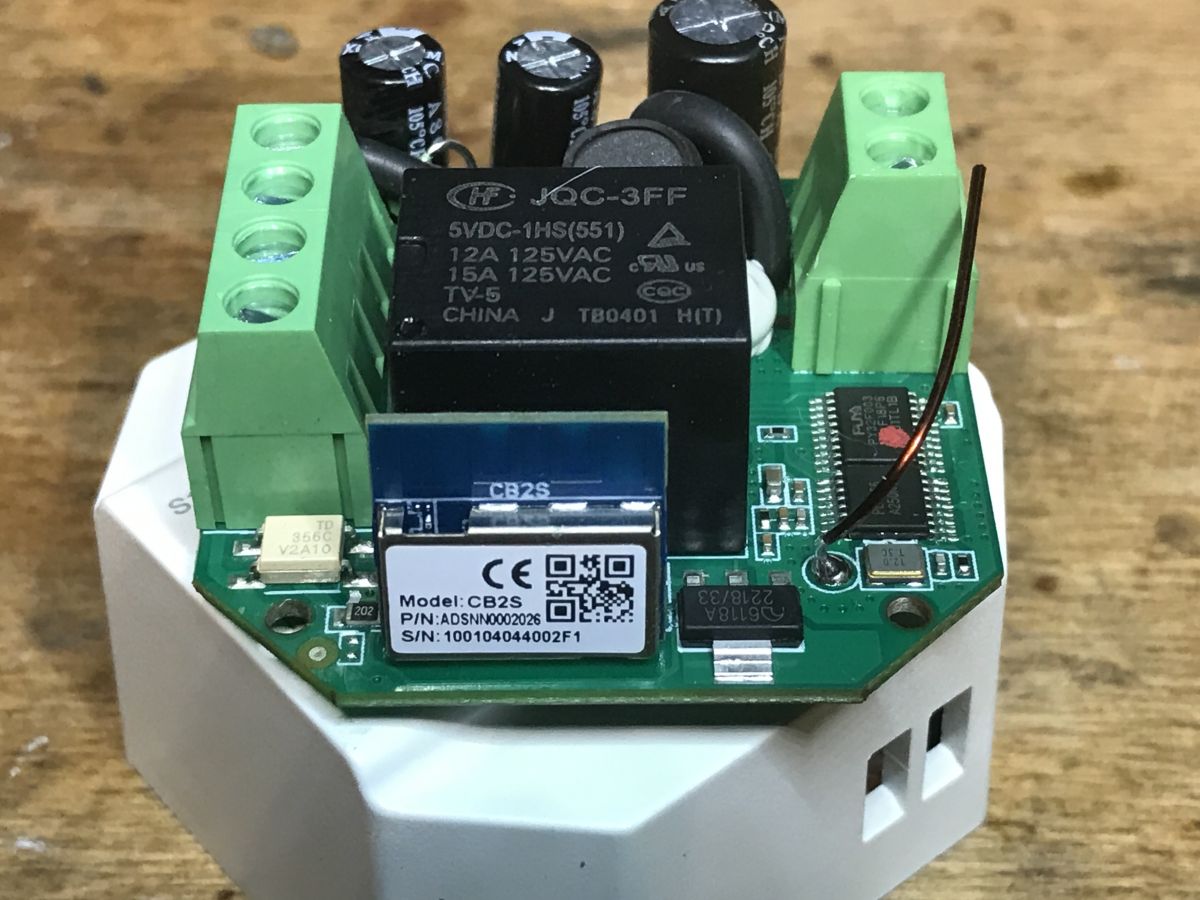

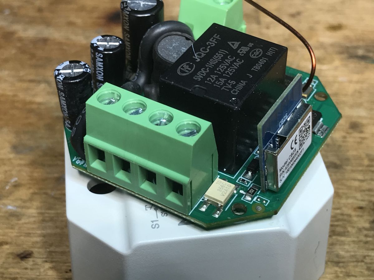

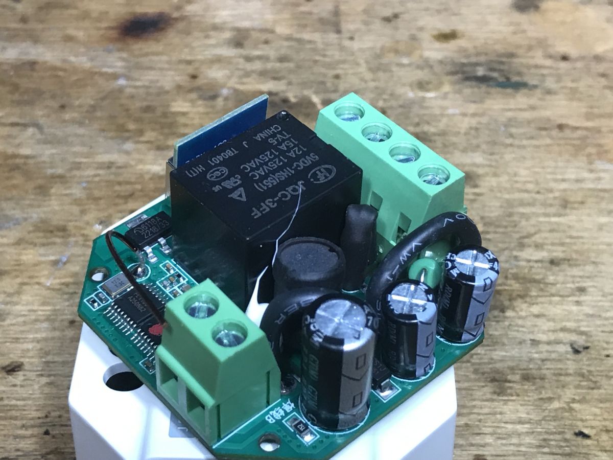

    @krzbor I'm already used to this type of quirks. Below is a photo of an ordinary MiBoxer WL_SW1 smart relay based on the WiFi CB2S module and an external MCU controlling the button and relay, where the MCU communicates with the WiFi module via the TuyaMCU protocol.
    [ESP8285] SE831L intelligent garage door controller - interior, analysis [ESP8285] SE831L intelligent garage door controller - interior, analysis [ESP8285] SE831L intelligent garage door controller - interior, analysis [ESP8285] SE831L intelligent garage door controller - interior, analysis
    Why is there an external MCU connected to the WiFi module via UART (TuyaMCU operates on UART)? Unfortunately, I do not know.

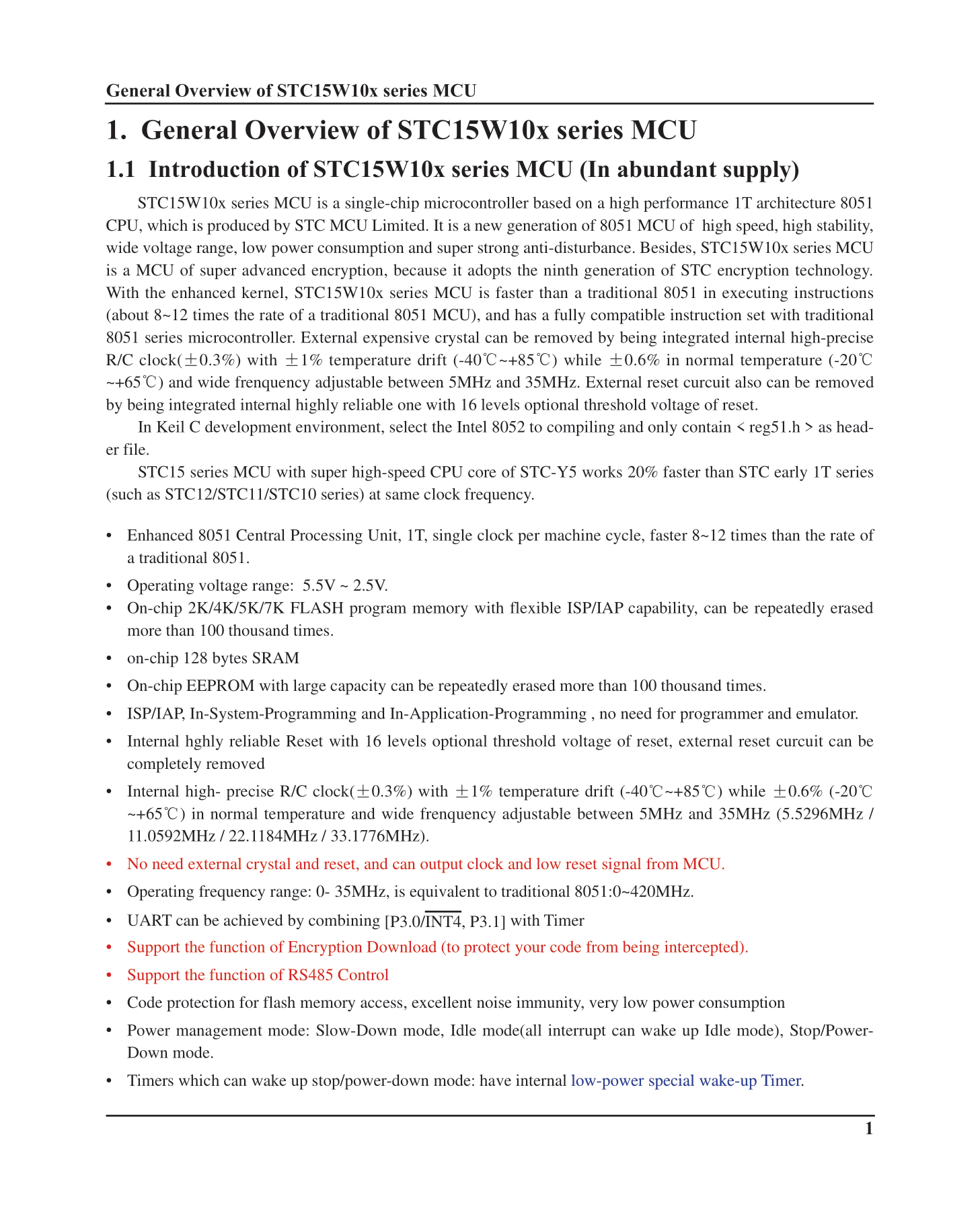

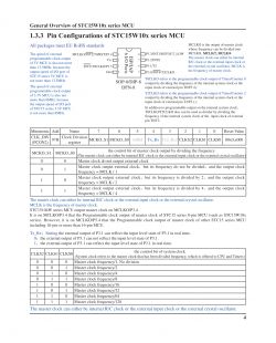

  • Power enters as 5 V from USB, then an AMS1117-3.3V regulator feeds the ESP8285 at 3.3 V. [#20638623]
  • The extra onboard MCU is identified as STC 15W104, an 8051-core SOIC-8 microcontroller, separate from the ESP8285. [#20638623]

How do you flash Tasmota onto the SE831L/GD-DC5 garage door controller with an ESP8285 using esptool.py?
You flash it through the exposed ESP UART, because RX and TX are available and the extra MCU does not occupy that port. 1. Connect to the ESP8285 serial pins. 2. Hold the front button while applying power, because that pulls GPIO0 for flashing mode. 3. Use esptool.py to upload Tasmota. The author says this part was "very simple" and had no GPIO0 problem. [#20638623]
What GPIO connections were identified inside the SE831L controller, and how should they be mapped in Tasmota?
The thread confirms only the high-value mappings in text: GPIO0 goes to the button, RX/TX are free for flashing, and the extra MCU sits on regular GPIO rather than UART. The author also says he made a full GPIO connection list from PCB photos for later Tasmota setup, but this excerpt does not print each pin-to-function mapping in text. Use the post’s board photos and diagram before assigning every Tasmota GPIO. [#20638623]
Why is there an STC 15W104 8051 MCU inside the SE831L garage controller if the ESP8285 can handle the reed switch and relay by itself?
The thread does not give a confirmed reason; the author explicitly says he does not know. He notes the STC 15W104 is an 8051-core MCU and shows another smart relay where an external MCU also exists, even though the Wi-Fi module could handle simple I/O. In this SE831L case, his practical conclusion is that the MCU can be desoldered and the ESP8285 can then use the I/O directly. [#20639748]

Why does pressing the button while powering the SE831L put the ESP8285 into flashing mode through GPIO0?
It works because the front button is wired to GPIO0, and the ESP enters programming mode when GPIO0 is held during power-up. The author first worried about access to that boot pin, then confirmed the signal is already brought out to the button. That means no PCB trace cutting is needed just to enter flashing mode on this board. [#20638623]
