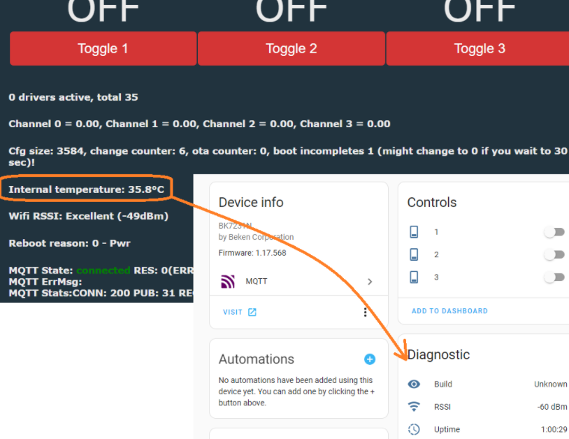

#1 21068940 03 May 2024 18:40 yarix2 yarix2 Level 6 Posts: 23 Help: 1 Rate: 15 Topic author Post #1 21068940 03 May 2024 18:40 hiis there a way to expose the internal temperature, shown on the main page as a sensor in home-assistant?thanks!
#2 21070994 05 May 2024 17:57 p.kaczmarek2 p.kaczmarek2 Moderator Smart Home Posts: 14767 Help: 659 Rate: 12909 Helpful post? (0) Post #2 21070994 05 May 2024 17:57 This can be done manually via scripting, the HA integration is not yet here. Would you find it useful? You know, this internal sensor is not very precise... I am creating multiplatform open source firmware (Tasmota replacement), right now supporting BK7231T, BK7231N, XR809, BL602, W800, W600, LN882H and soon supporting RTL and W701: https://github.com/openshwprojects/OpenBK7231T If you like my work, support me at: https://paypal.me/openshwprojects Helpful post? Buy me a coffee.
#3 21088891 20 May 2024 00:50 p.kaczmarek2 p.kaczmarek2 Moderator Smart Home Posts: 14767 Help: 659 Rate: 12909 Helpful post? (0) Post #3 21088891 20 May 2024 00:50 This has been added in todays release: https://github.com/openshwprojects/OpenBK7231T_App/pull/1243 Hass discovery should support it. I am creating multiplatform open source firmware (Tasmota replacement), right now supporting BK7231T, BK7231N, XR809, BL602, W800, W600, LN882H and soon supporting RTL and W701: https://github.com/openshwprojects/OpenBK7231T If you like my work, support me at: https://paypal.me/openshwprojects Helpful post? Buy me a coffee.

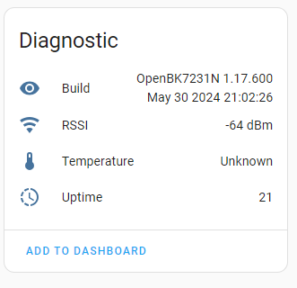

#4 21101929 31 May 2024 11:44 yarix2 yarix2 Level 6 Posts: 23 Help: 1 Rate: 15 Topic author Helpful post? (0) Post #4 21101929 31 May 2024 11:44 thanks for pushing that feature !I've upgraded to version 600, i can see that a temperature sensor is published, but the value is unknown.do i miss something? BTW - also the uptime doesn't seems right.
#5 21633306 12 Aug 2025 18:42 Advian1 Advian1 Level 7 Posts: 41 Rate: 1 Helpful post? (0) Post #5 21633306 12 Aug 2025 18:42 hi, Was wondering if there was any update to this. it still shows as unknown on my devices.
