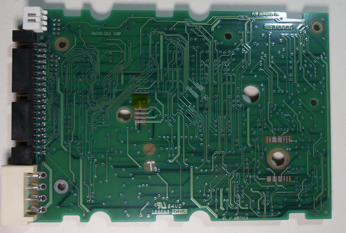

    On the other side of the board you will find no electronic components, only the contact fields for the platter motor and the contacts for controlling the head arm and communicating with the head. This is how it will look like for all other disks.
    View of the back side of a hard drive PCB with PATA interface, showing traces and contact points without visible electronic components.

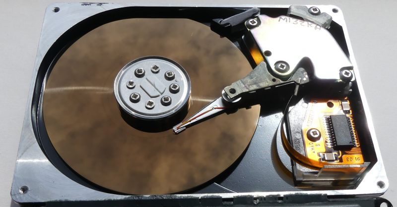

    Data is stored on one platter by two heads.
    Inside of a hard drive with visible platter and head arm.

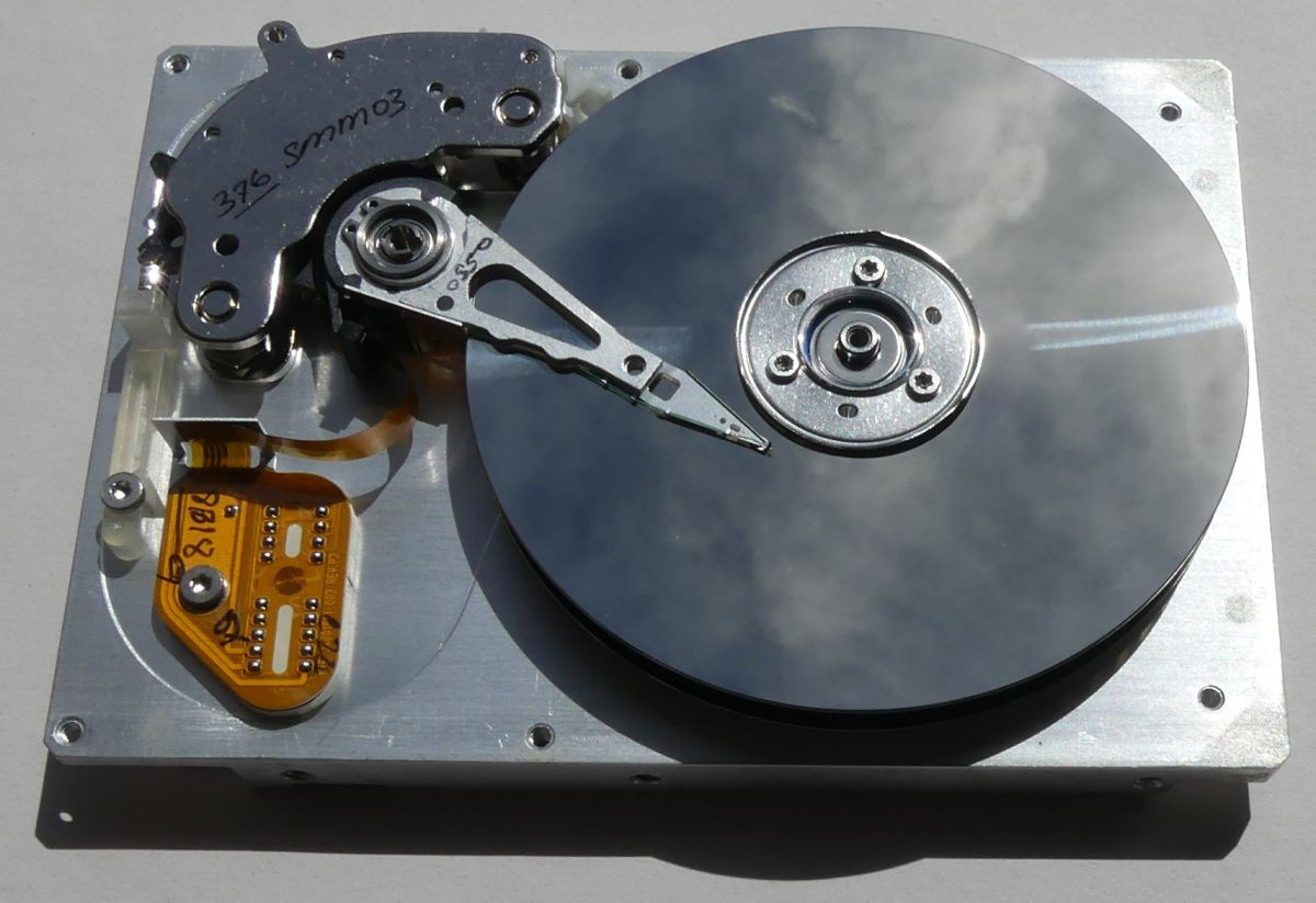

    Two platters and four heads.
    Image of a hard drive interior with a visible platter and read/write arm.

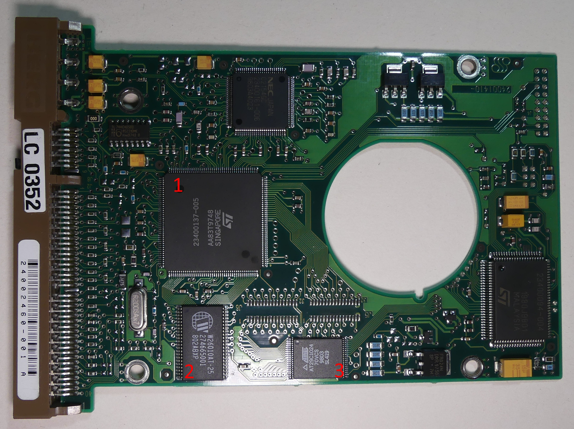

    W 40GB drive with ATA133 interface we see a further increase in the scale of integration. Such drives provided transfers up to 10x faster than the 4GB predecessor.
    1) interface chip and disk controller
    2) RAM - SDRAM 512k x16b
    3) power chip
    Printed circuit board of a hard disk drive with three main components labeled with numbers.

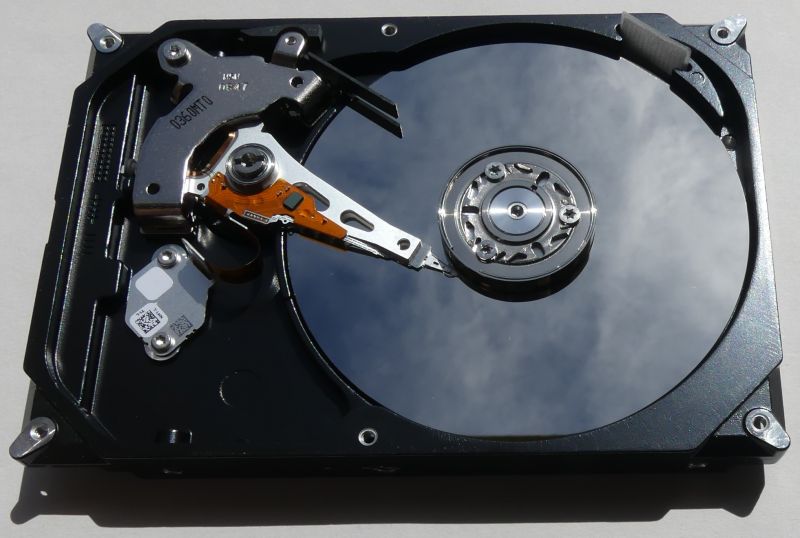

    One platter two heads.
    Interior of an open hard disk drive showing the platter and head.
    One disc.

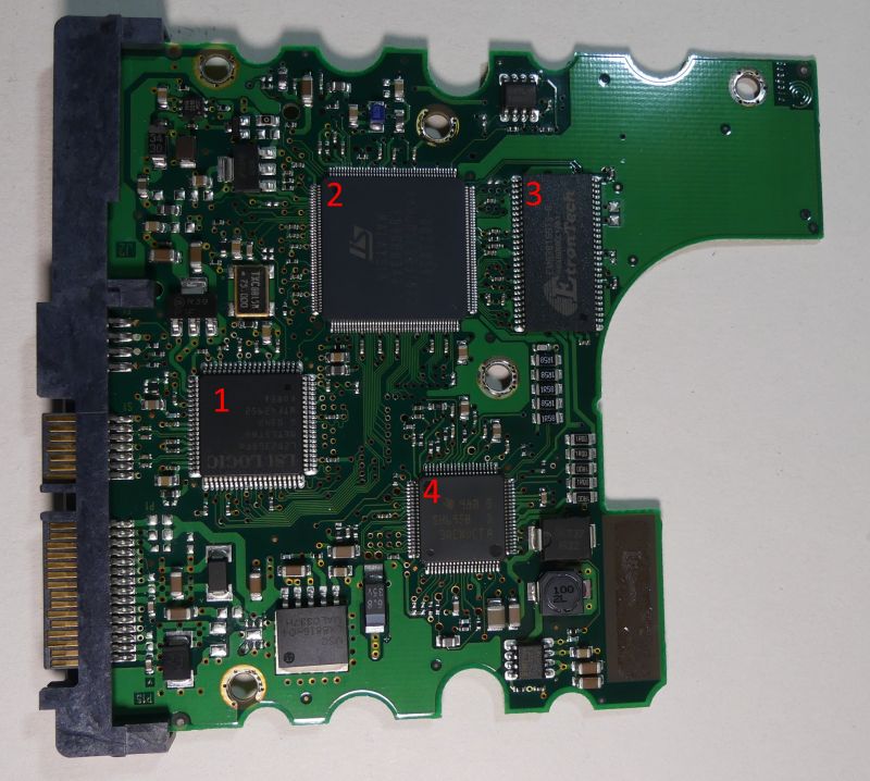

    Disk 80GB changed to serial SATA interface.
    1) interface circuit
    2) disk controller
    3) RAM - SDRAM 1M x 16b x 4 banks
    4) 'power' circuit.
    Hard disk drive circuit board with four marked integrated circuits.

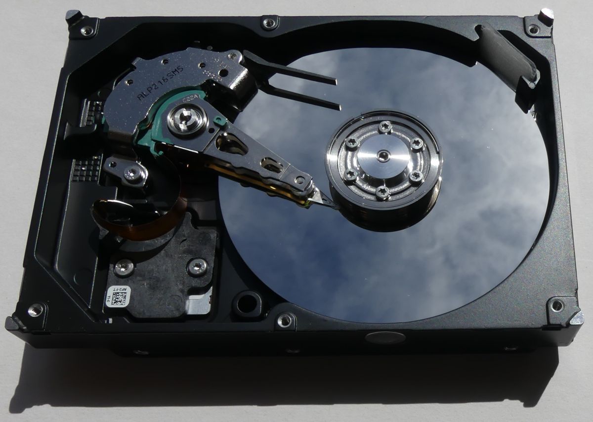

    One plate and two heads.
    Interior of an open hard drive showing the platter and read/write arm.

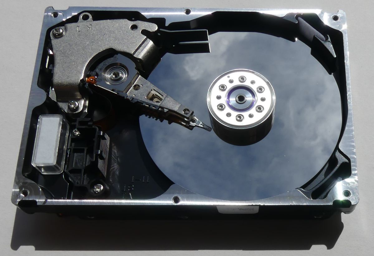

    One platter and one head.
    Interior of a hard drive with visible platter and read/write arm.

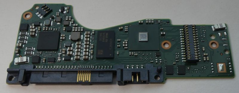

    Disc. 10TB a drastic reduction in the size of the electronics board can be seen.
    Why are there still 3 main circuits on the PCB?
    PCB from a SATA hard drive featuring various integrated circuits and connectors.
    I suspect, that the "power" chip is made in a different process/lithography than the disk controller, as is the RAM, and it still pays to put two separate chips. RAM in a separate module is perhaps an easy production model with a different amount of cache?

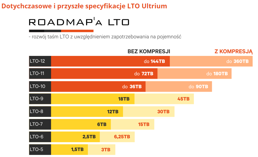

    Tape drives are still present,
    often as part of robots that translate tapes from storage bins to a group of drives.
    They have them at CERN or e.g. in Poland at CI TASK.
    Tapes are cheap, durable and do not draw electricity when put into storage....
    Noisy was the solution :)
  • #22 21093608
    CMS
    Posts: 8468
    Help: 258
    Rate: 2601
    18TB on such a cartridge? That's something amazing, by what miracle I ask.

    Standard LTO9 tape capacity without compression. With compression it is 45TB.
    Graphic showing the specification of LTO Ultrium tape capacities from LTO-5 to LTO-12 in terabytes, with and without compression. .
    While cartridges are relatively inexpensive per terabyte, the drives and equipment needed to write and read them, have very cosmic prices.
    Some time ago I wrote about the interchangeability of media and devices, in hard drives this is unlikely to work and is not easy to do (I do not know how the cost of production of the platters themselves with heads and the cost of production of all the rest is distributed), but in tapes, as much as possible. It's hard to imagine a 'drive' that would actually be a streamer with a built-in and non-replaceable tape, where one unit would cost several thousand or more. And so, someone being 'on the money' will buy one streamer and then, as needed, just buy tapes for a couple of hundred apiece. And if the streamer breaks down, there is no risk of losing the data, because the cassette can easily be restored in another device.
