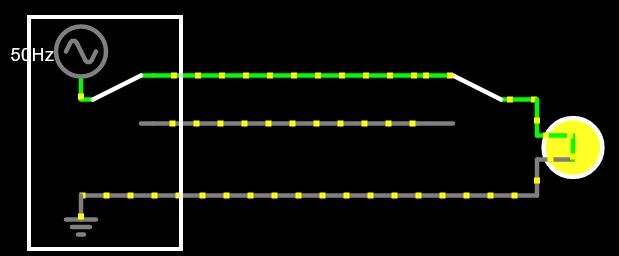

    Staircase switch project on ESPHome. AC 230V light circuit with two stair switches.
    Diagram of a lighting circuit with two stair switches and a bistable relay.
    Access is only to the box marked with the white square. I want to replace one stair switch with a bistable relay, the other switch is to stay as it is.
    How do I do the detection that the light is on? I am considering a current sensor (e.g. ACS712) between the power source and the bi-stable relay.

    I was considering a comparator and only from the comparator to the ESP32.
    If anyone has a suggestion for another sensor or any other concept for the aforementioned problem then my ears are humbly open. :) .

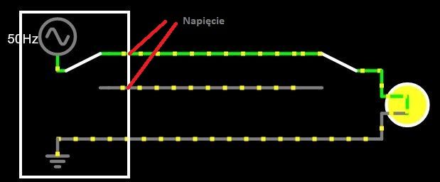

  • Suggesting optoisolator testing for off-state voltage

    exey
    Posts: 19
    @jarzabek666
    Develop your thought, because I don't get where and how you want to measure voltage.
  • Optoisolator current detection needs over 30 mA
