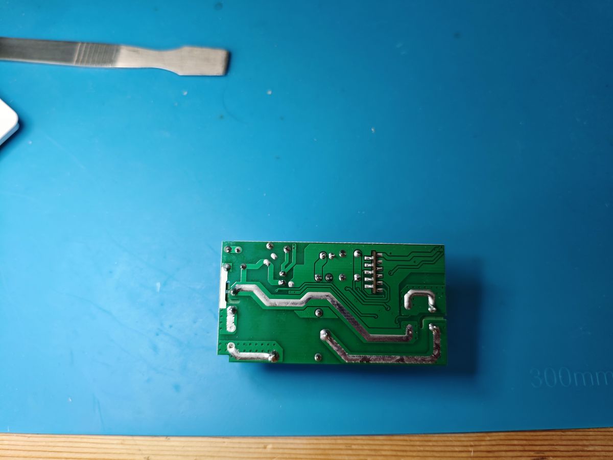

    and inside
    Circuit board of a switch with ESP-C2 module. Photo of the DOIT ESP-C2-02 N2 module on a PCB, with visible connection terminals. Photo of an electronic module on a blue background with visible components such as a YONGWEI relay. PCB with visible traces and solder points
    The module is a DOIT ESP-C2-02 N2. I think N2 means it has 2Mb flash.

    Before I unsolder or solder up too much, in case the ESP is locked and I cannot flash it (and so it can go into the resale pile), I attached 3.3v and ground and used a sewing needle on TX to capture the UART log (74880 baud).
    So it's a Cozylife device, also evidenced by the logo in the QR code in the manual. No mention of Secure Boot or encrypted flash.
    Proceeding to solder RX/TX and using a pogo pin to ground BOOT pad to pull it low and into flash download mode:
    ESP-C2-02 N2 soldered on a printed circuit board.
    The ESP enters download mode when powered:

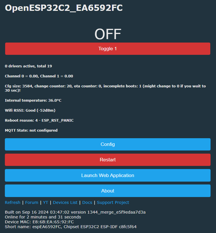

    With wires unsoldered and the unit back together
    White Wi-Fi switch with connected wires on a blue background. Electronic circuit with connected wires
    and powered from the mains the device does not brownout when AP is joined.
    OpenESP32C2 system interface displaying device information and configuration options.
    I went through each GPIO pulling all those available on the module high - 4, 5, 6, 7, 10, 18, 19, 20 but they had no effect. Taking the unit apart again it seems the button is GPIO5 and the LED is GPIO7. The button always seems to have continuity with GPIO5, pressed or not. I've not found the GPIO for the relay.
    The main GUI is responsive, but I am finding I need to power-cycle the unit quite a lot. The logs sometimes come through and sometimes nothing shows for a while.
    lots of malloc errors appear sometimes.
    With the button set and after a quick push, these will sometimes show in the logs
    I might flash original firmware back to be sure all works as expected.

    Very interesting experiments, I wonder if there is OTA possiblity for this platform, or is it too secured? I mean, before flashing via UART.
    The decreasing amount of free 22804 memory usually means that something is blocking TCP sockets of HTTP server and they don't free HTTP buffer. It's an unexpected behaviour of LWIP. Maybe we can fix it by adjusting some LWIP settings, like a socket timeout, etc, I don't know, just speculating at the moment. @insmod might have some ideas. Does it happen only on this ESP module or on others as well?

    >>21225735 The RAM problem i encountered only on C2. I now pushed some changes, which should increase amount of free RAM on C2.

    hmm. untouched, the free memory slowly decreases towards unresponsiveness. the device seems to be staying up, but there are periods where it is unresponsive. When it comes back it'll splurge a load of mallocs into the log.

    >>21225771 Pushed further optimizations, i have about 40-60k free heap now on 500s online. No malloc errors yet.

    There's a BP2525 (bottom middle) and there appears to be continuity from at least 2 of the legs to the D3 side of the T4 component, the other side of which is connected to the leg of the relay in that corner. Not sure what this means for an OBK config at this point though.
    Close-up of a circuit board with visible electronic components and markings.

    genius!
    OpenESP32C2 user interface with Toggle 1 button in off state.
    Screenshot of a device pin settings interface with fields for IO4, IO5, IO6, and IO7.
    relay, button, LED all work as normal. I didn't mention that I'd hooked up a logic analyser to LED and relay contacts and there was no sign of PWM, so this makes sense.
    Added after 2 [hours] 53 [minutes]:
    unless there are other, yet to be identified, issues this could be considered a complete conversion to OpenESP32C2. In which case the template would be
