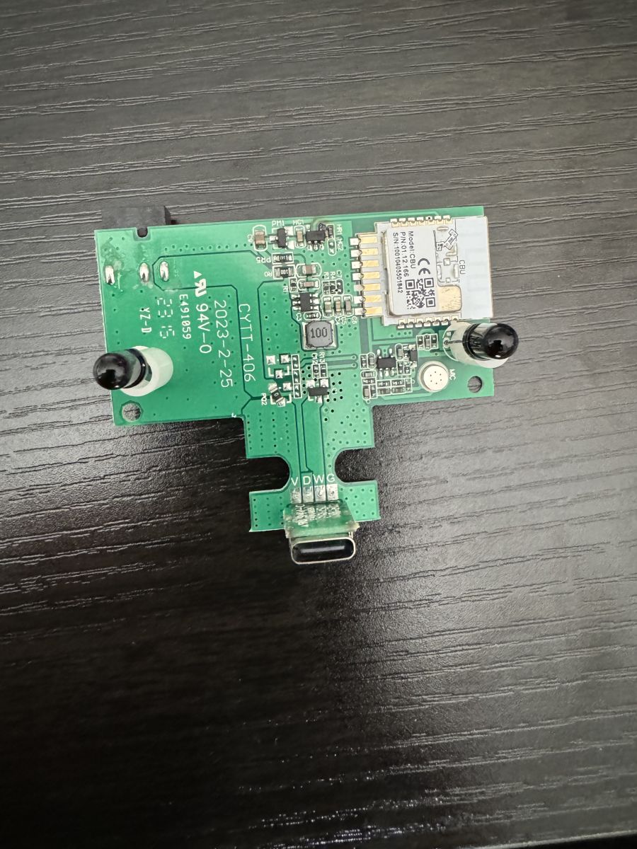

  • #3 21082796
    jonathanwilletts31
    Posts: 6
    Thanks for your reply. It’s a Casalux Smart Corner Lamp. It has a BK7231N - CBU chip. I had a look at the chip and I’ve attached a photo. My goal is to get the lamp working one way or the other. Your help is appreciated. Printed circuit board of Casalux smart corner lamp with BK7231N - CBU chip.
  • #4 21082825
    Posts: 14795
    Rate: 12945
    Can you provide more information on this device? Is it using PWM, or individually addressable LEDs like WS2812B?
  • #6 21082922
    Posts: 14795
    Rate: 12945
    It's WS2812B-like LEDs, they are supported in OBK, maybe you should try it?

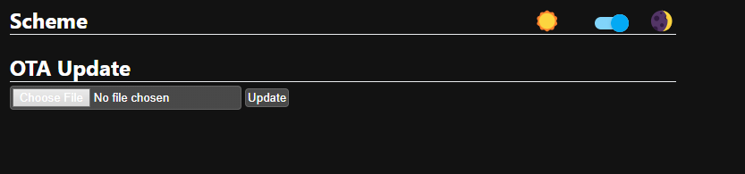

    #10 21092268
    MnM1
    Posts: 175
    Rate: 13
    See here:
    https://www.elektroda.com/rtvforum/topic4018150.html
    Can you browse to the IP address of the device? normally ESPHome has a web page with an OTA Update section (if it was configured that way). You can point to a file from the above github and upload OBK to it. Then you can update to the latest OBK.

  • #11 21092575
    jonathanwilletts31
    Posts: 6
    I can’t access the webpage via the IP. It’s connected to my router but always says page can’t be displayed when I try to access it like my other ESP’s. I think I’ll have to do a serial flash
