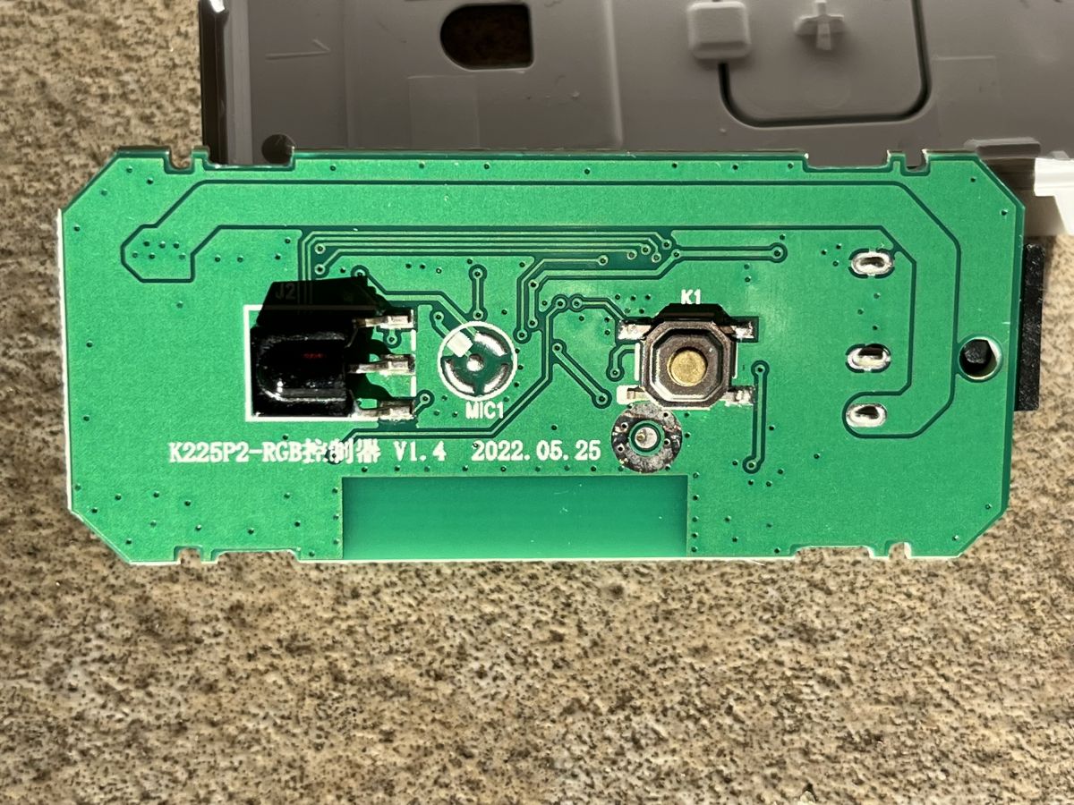

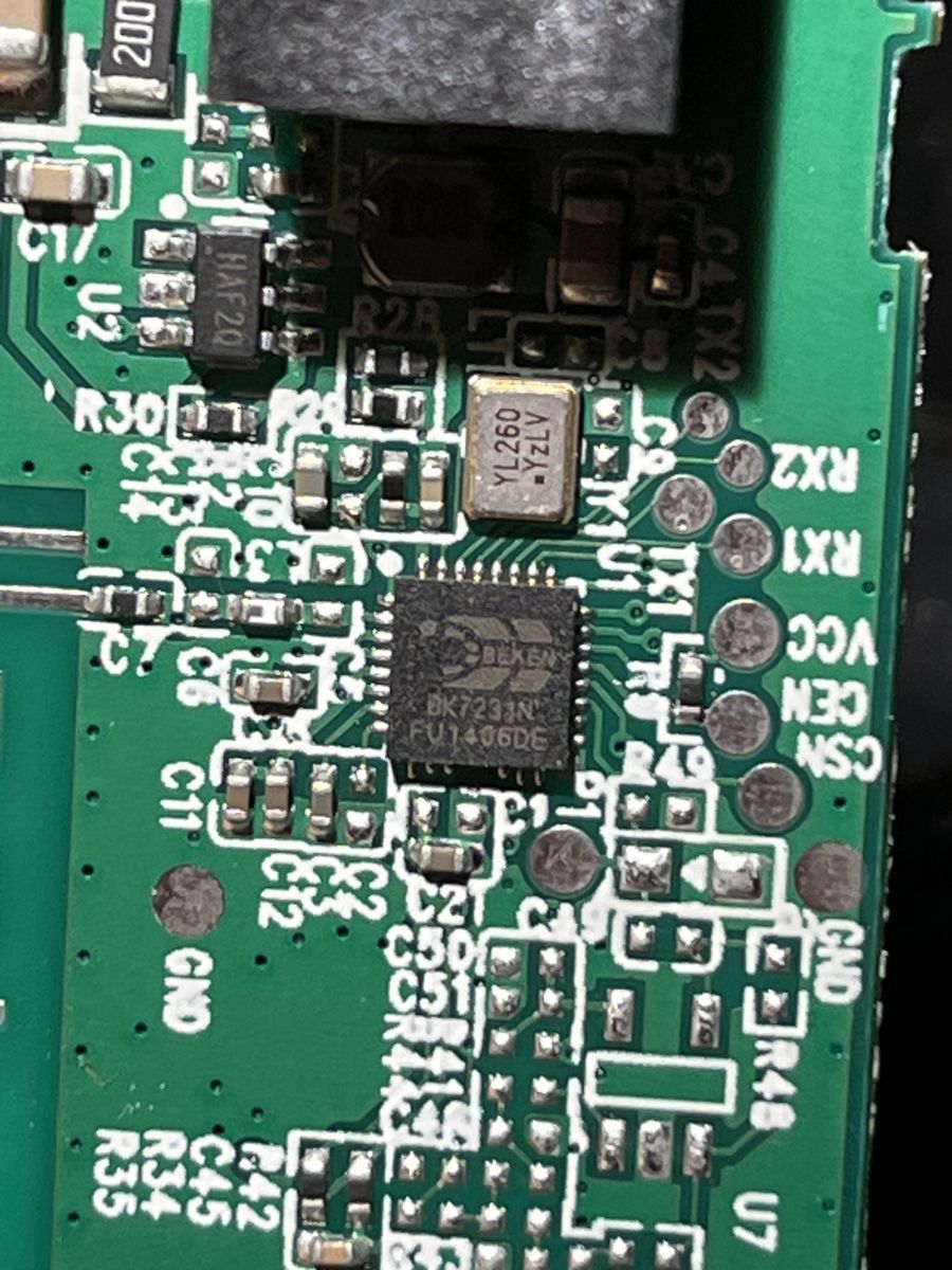

  • Aldi Casalux smart WLAN LED strip appears to be a BK7231N-based RGB controller board with IR receiver and button support.
  • Identified parts include PCB K225P2-RGB v1.4 and an SLS3400 RGB MOSFET marked A09T.
  • Pinout maps P6, P7, and P8 to Green, Red, and Blue LED PWM outputs, with P20 for IRRecv and P26 for Btn.
  • PCB identification came from online information only, so the exact board revision may still need confirmation.

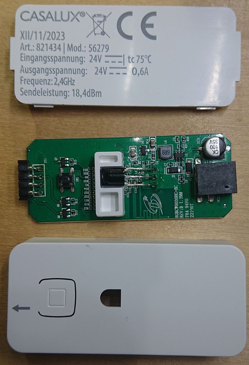

  • Box and content:
    [WIP] New BK7231N device - Aldi casalux smart wlan LED strip

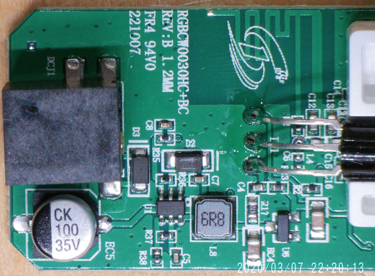

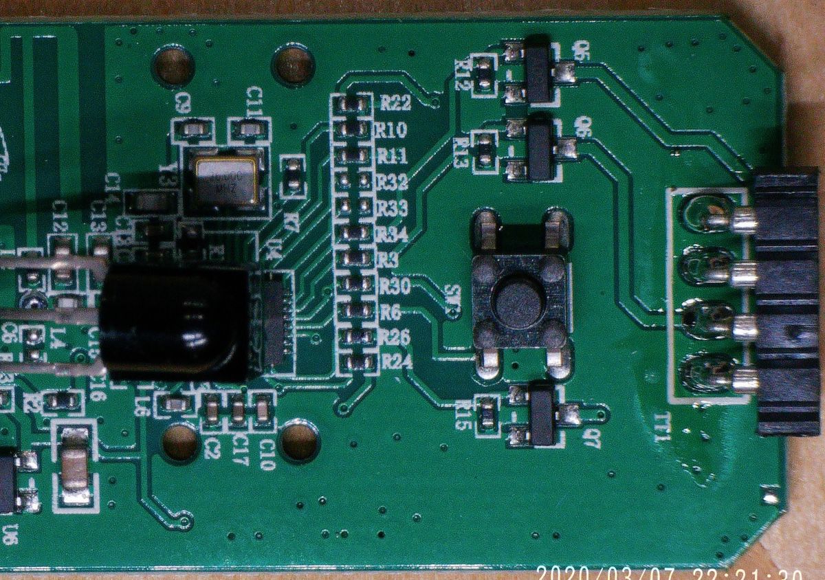

    Components:
    - PCB: K225P2-RGB v1.4 (only info I found online)
    - RGB Mosfet: SLS3400 (marking A09T)
    [WIP] New BK7231N device - Aldi casalux smart wlan LED strip [WIP] New BK7231N device - Aldi casalux smart wlan LED strip [WIP] New BK7231N device - Aldi casalux smart wlan LED strip
    Pinout:
    PinModeValueFunction
    P6 (PWM0)PWM1Green LED
    P7 (PWM1)PWM0Red LED
    P8 (PWM2)PWM2Blue LED
    P20 (N/A)IRRecv - IR Receiver
    P26 (PWM5)Btn - Button
    fiobe
    fiobe wrote 5 posts with rating 4. Been with us since 2023 year.
  • #2 20410586
    Posts: 14743
    Rate: 12839
    Hey, good luck with flashing this device, I see you have all pins available and marked on PCB. It should be easy.
    I can also see you've found an interesting video - seems like a recording from the PCB factory. That's new to me, I wonder who released it.
    What is the marking on Q1, Q2, Q3, etc?

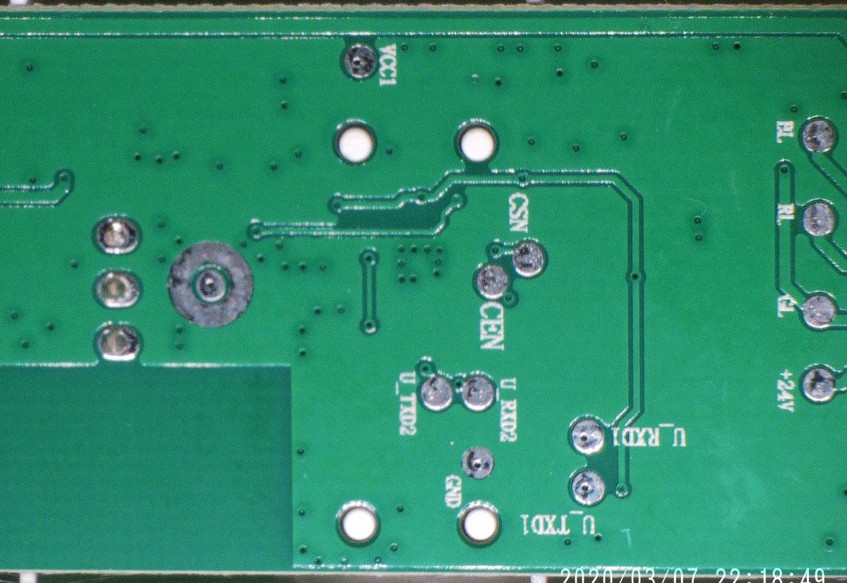

  • #3 20410590
    dkayukov
    Hi, I've flashed this one today. In the log on TX2, I can see that OpenBK7231T_App booted up and created AP but it is not visible. Any pointers where to look?
  • #4 20410591
    Posts: 14743
    Rate: 12839
    @dkayukov please post here full OBK log from TX2, from the earliest boot up to 30 seconds online (maybe use Realterm to capture to file).
    It's possible that new batch of BK7231N has the issue that we just resolved there:
    I flashed my switch that has a BK7231N chip on it,. Now what?
    but let's not judge too early. Let's check log first.
  • BK7231N boot log shows startup delay loop
    #5 20410593
    dkayukov
    @p.kaczmarek2 This is log output:

    #6 20410792
    fiobe
    Thank you! Flashing was pretty easy. I only realized too late I dumped the original firmware from the wrong start address (0x11000 instead of 0), so there's no way to go back :-)
    Mosfets are marked with "A09T".
    I updated my 1st post with the pinout for the R, G, B PWM channels.
    Any advice on how to get the pinout of the button and IR inputs? Is it OK to just brute force "IRRecv" and "Button" values in the Config?
