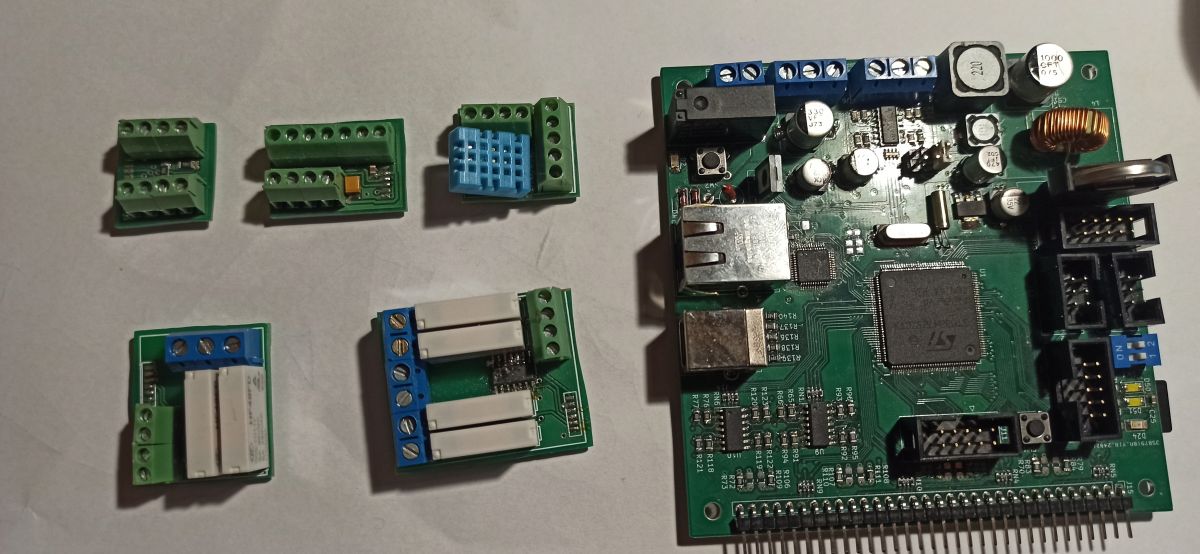

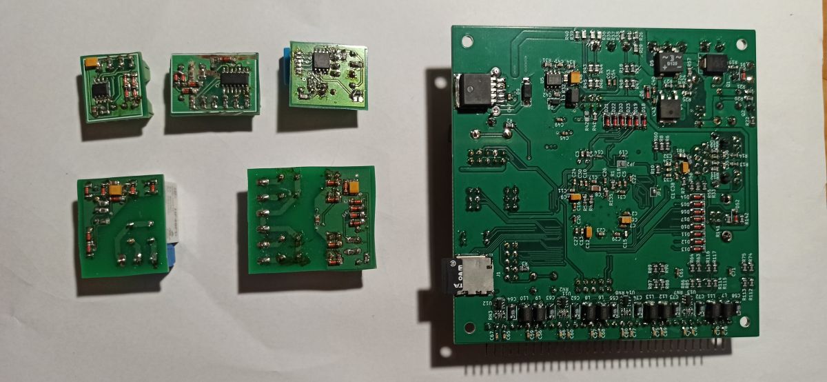

  • Hi,
    I have finally decided to share the design of a home automation system that I have implemented at my home and has been running successfully for several years. To begin with, I would like to describe the assumptions and general outline of the whole thing and in the following parts I will focus on specific parts.
    Several small and one large PCB modules for a home automation system arranged on a white background. .
    Home automation modules and a main controller board with STM32 microcontroller and Ethernet ports. .

    I/O modules:

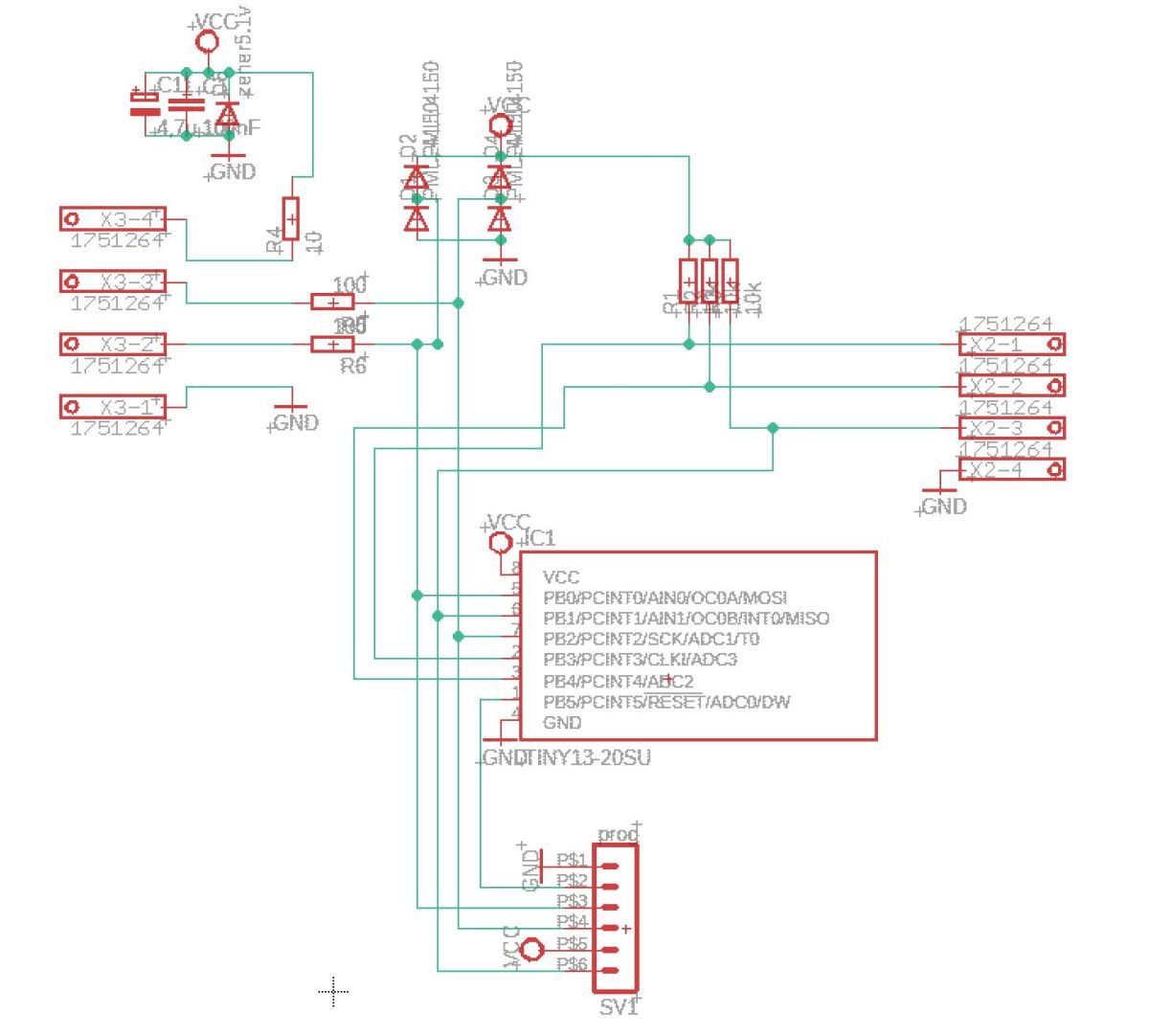

    To date, several types of executive modules have been developed, the basic ones being input modules - 3 channel and 6 channel - and output modules - with 2 and with 4 relays. In addition to these, single modules have been developed that support 8 outputs and combine input and output functions. Another module is a module for humidity and temperature measurement, it supports the DHT11 and DHT22 sensors. There is also a module for atmospheric pressure sensor and a module with 3 PWM outputs for controlling RGB led lines. More modules are planned, for example for measuring electricity consumption. Despite the small flash memory, I managed to pack in the most important functions in the programme, such as error checking, retransmissions or protection against duplicate frames. The programme has been running for the last 10 years without any changes, mainly because any changes would require the extraction and reprogramming of all the dozens of modules buried in the boxes; so far I have not found a bug requiring such a service action. Below I give a schematic diagram of the pushbutton module, the number of components is minimal which translates into the price and size of the module.
    Schematic diagram of a button module based on the Attiny13 microcontroller. .

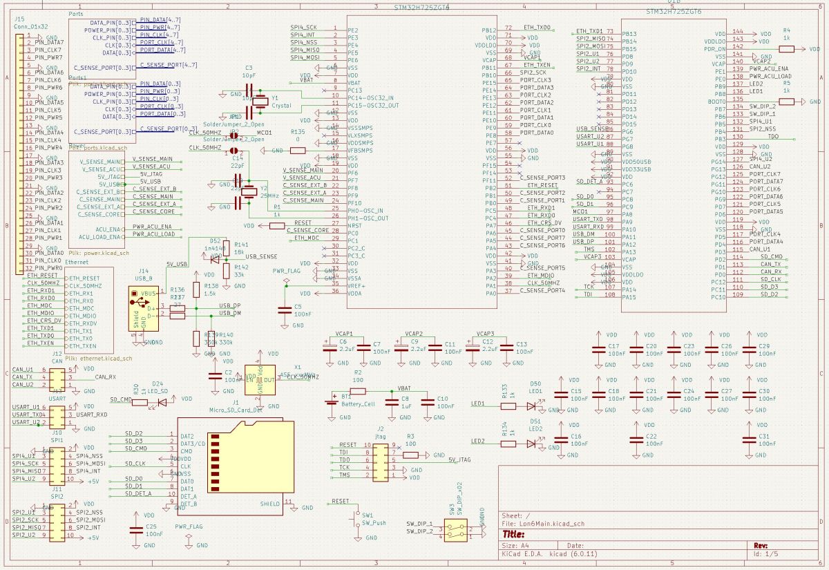

    This element of the system has the most eventful history over the years various versions were created in succession and of course each time it was to be the final version, well that I like to experiment and improve so changes were inevitable. The first versions were realised using an Atmega32 uC, which worked but was quite simple and slow, then I moved to ARM chips, which made the whole thing work smoothly, and most importantly, the possibility of communication via ethernet appeared, which made it possible to realise a simple http server and support for an SD memory card.

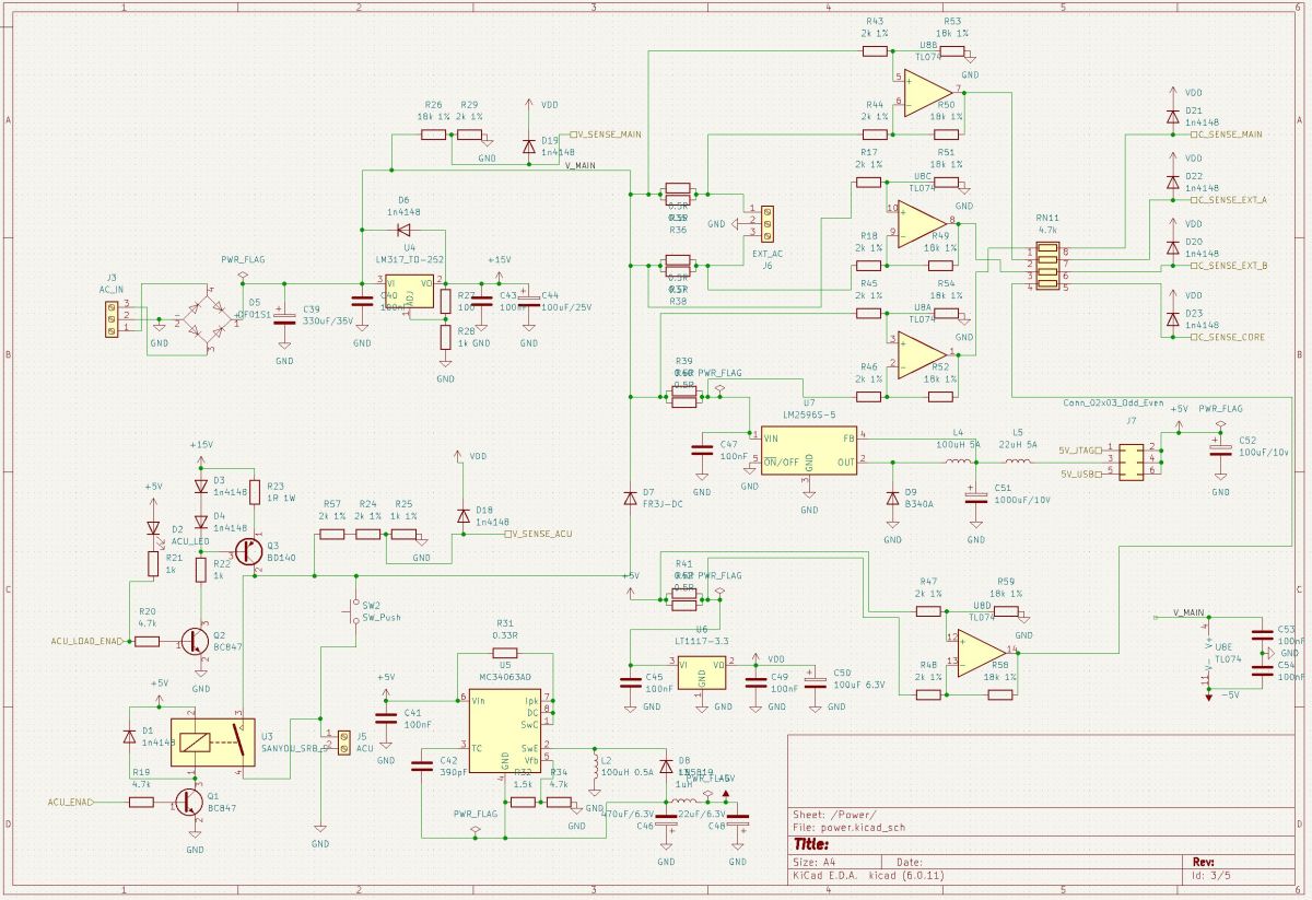

    The main module in the current version is based on the STM32H725 chip. It supports 8 buses. An ethernet input supporting http, telnet and ftp protocols is used to configure and communicate with the module - operation is possible from a web browser and via a telnet terminal. An SD memory card is used to store data collected from the sensors and html files, the basic system configuration is stored in the uC's flash memory for greater reliability. The power supply part of the module, in addition to the inverter that provides power to the entire network, also contains circuits for measuring voltages and currents at important points in the module and a module that supports a gel battery to power the system in the event of a mains power failure. The software is based on the FreeRTOS real-time system and uses the HAL library, the rest of the code is already written by me from scratch. Below is a schematic diagram of the main module.
    Block diagram of a home automation main module with STM32H725, connectors, passive components, Ethernet controller, and SD card reader. .

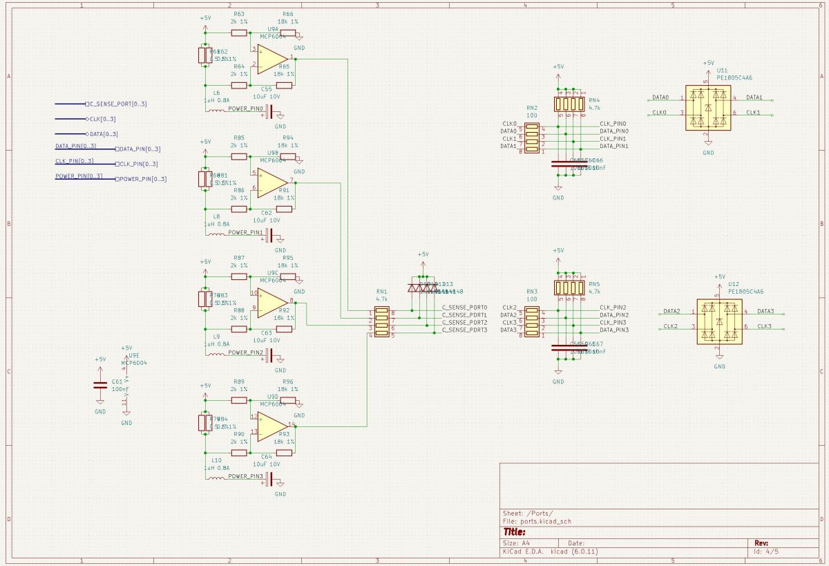

    Schematic diagram of power supply and measurement circuit for a home automation main module. .
    Block diagram of an input/output module for a home automation system, showing connections between ICs, connectors, resistors, and capacitors. .

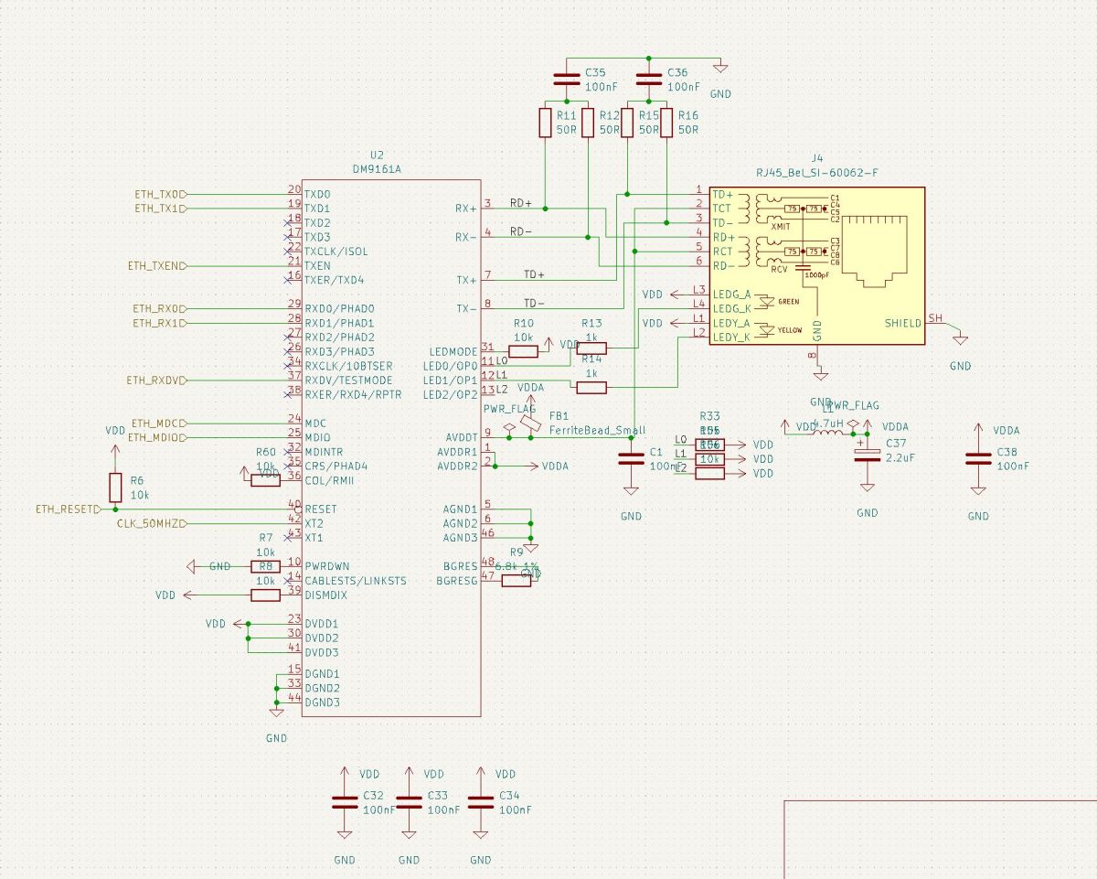

    Circuit diagram of the main module’s Ethernet section with DM9161A chip and RJ45 connector for a home automation system. .

    In this section, I will focus on the core module itself.
    The main functions of this module are:
    -Operating the actuator modules, i.e. detecting them, configuring them and cyclically checking their status.
    -Serving data from the executive modules, e.g. from buttons, and performing programmed actions, e.g. setting the appropriate output
    -Checking the current time in order to carry out scheduled events, e.g. timers, smooth switching on and off of LED lighting at a scheduled time, etc.
    -Cyclical download of sensor data, recording on SD memory card and possible operation of outputs, e.g. switching on a fan.
    -FTP server - allows reading and writing of files on the SD card, Currently the server supports up to 2 clients.
    -TELNET server - allows communication with the main module for reading the system status, monitoring resources and above all for managing the configuration of all modules. This server also supports up to 2 clients.
    -Http server - Enables selected data such as output status, current and historical data from sensors to be read out using a web browser. It is also possible to change the status of the outputs and configure the timers. The server supports up to 12 clients in the current implementation.
    -NTP protocol support - the chip synchronises the time with a time server.
    -The module has a built-in battery management circuit for power supply backup, with basic functions such as charging, voltage control and over-discharge protection.
    -Power supply circuit is adapted to be supplied from a typical 16V AC transformer for control panels, It has a built-in converter to obtain 5V on which the entire system operates. the 3.3V voltage for the uC is obtained using an LDO linear stabiliser.
    -Current and voltage monitoring to control operating parameters and energy consumption. The input voltage, on the battery and on the battery are measured, The currents consumed separately by the uC and the individual buses are measured.
    I chose the STM32H725 chip because, firstly, I like ARM chips from this manufacturer, secondly, it has everything I need, i.e. sufficient memory, both Flash and RAM, and a built-in Ethernet controller, and thirdly, because it was at a good price.
    One of the objectives was to implement remote software updates without any noticeable impact on system operation. To this end, I decided to divide the available memory so that I could have two versions of the software at the same time, where during the execution of one version, the other could be updated and then there would be a quick reboot and the new version would be launched, possibly automatically reverting to the previous version in case of problems.
    The STM32H725 chip has a total of 1MB of Flash memory divided into 8 sectors of 128kB each. In this project I have divided it in such a way that sector 0 contains the bootloader, sectors 1-2 contain the first version of the program, sectors 3-4 contain the second version of the program. The remaining 3 sectors are used to store the system configuration.
    The purpose of the bootloader is to copy the appropriate version of the software into the ITCM memory and then jump to that location in, i.e. run that version. The software could be run directly from Flash memory but this would require compiling the code already with the choice of which slot it would be loaded into, in the current implementation the code is compiled to run in the ITCM address space. Unfortunately, however, I will most likely have to forfeit running the program from Flash memory or optimise the memory usage more Flash because I am finding it difficult to allocate more than 192kB of ITCM memory and the programme is slowly reaching this size. I'm hoping that I still have a little left over to reach the next threshold of 256kB. The program is based on FreeRTOS and is divided into several processes which communicate with each other. If there is interest in the subject, I can describe the structure of the program in more detail.

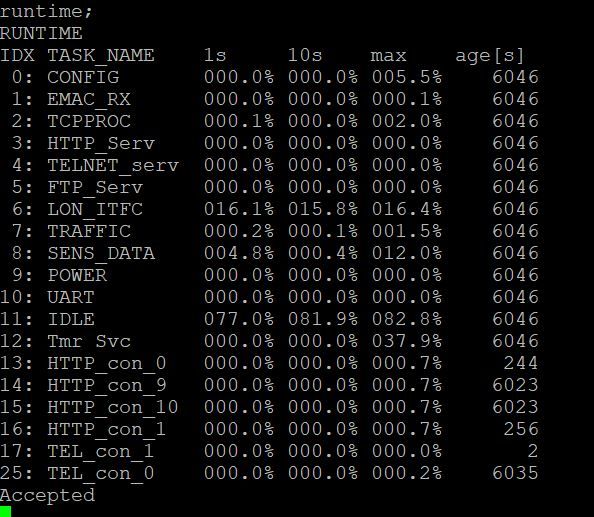

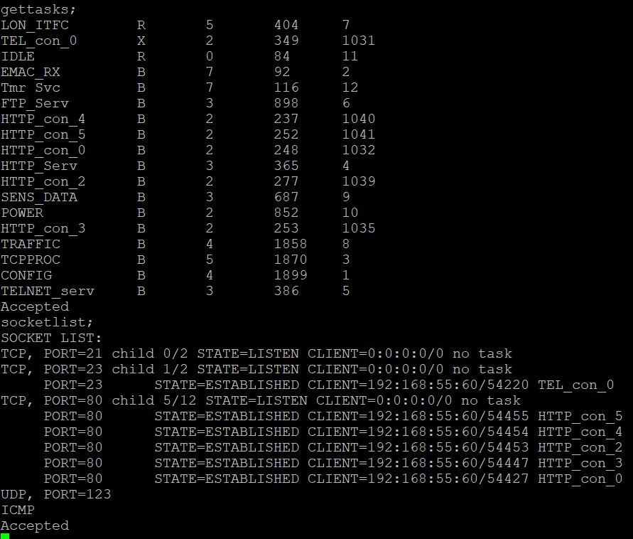

  • FreeRTOS task structure for modular home automation
    #18 21541259
    nuclear
    Posts: 194
    Help: 18
    Rate: 145
    I am adding the promised short description of the code structure in the main module. With this level of complexity, I decided to use a real-time system, I chose the already known FreeRTOS. This allowed me to divide the functionality into individual processes. Below I paste a printout with all the processes and another with the sockets.
    Terminal output showing a list of active FreeRTOS system processes and current network socket connections. .
    The Tmr Svc and Idle processes are system processes. The CONFIG process is to configure and start all peripheral chips after a reboot and later check their status, such as the status of the memory card. The TRAFFIC process is the main process handling network events, i.e. button state changes, all timers, sensors. The LON_ITFC process handles directly the receiving and sending of frames on the buses, This is done purely software using only GPIO. The other processes are already optional. The SENS_DATA process has the task of storing sensor data on the memory card and also handles requests for data from the HTTP server. POWER, on the other hand, handles the monitoring of all voltages and currents as well as the battery status.
    Serving the Ethernet lines is the TCPPROC process, which handles all incoming packets; it also handles the ARP, DHCP, ICMP and NTP protocols directly. Auxiliary to it is the EMAC_RX process which pre-filters incoming packets and monitors the connection status. Further processes are the server processes (FTP_serv, HTTP_serv and TELNET_serv). When a TCP connection is established, a separate process is created for it which is deleted when the connection is terminated. Several such processes are visible on the printout, and can be associated with the listed sockets.
    The program is divided into 2 repositories - in one there is a part directly related to this project, in the other one, the common one, it contains libraries written by me to handle the TCP stack and the FAT file system.

    Other system commands:
    getmeminfo; - displays memory usage statistics
    gettasks; - displays a list of processes

    In addition, I have started a module to measure CPU load by process. When executing the programme from flash it is quite good:
