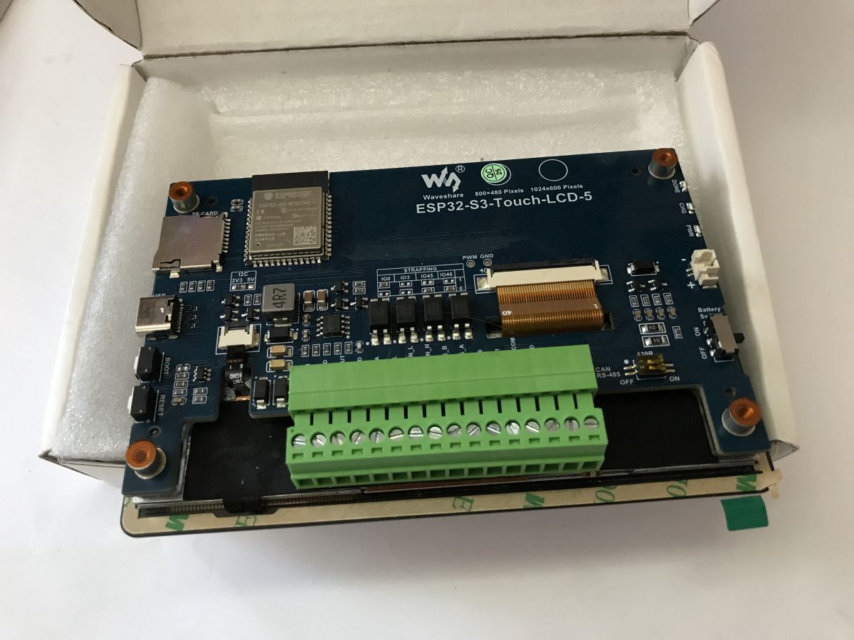

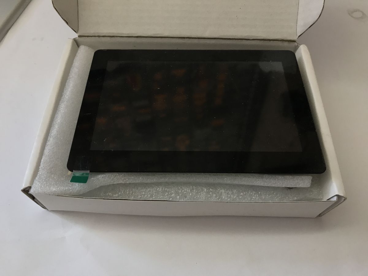

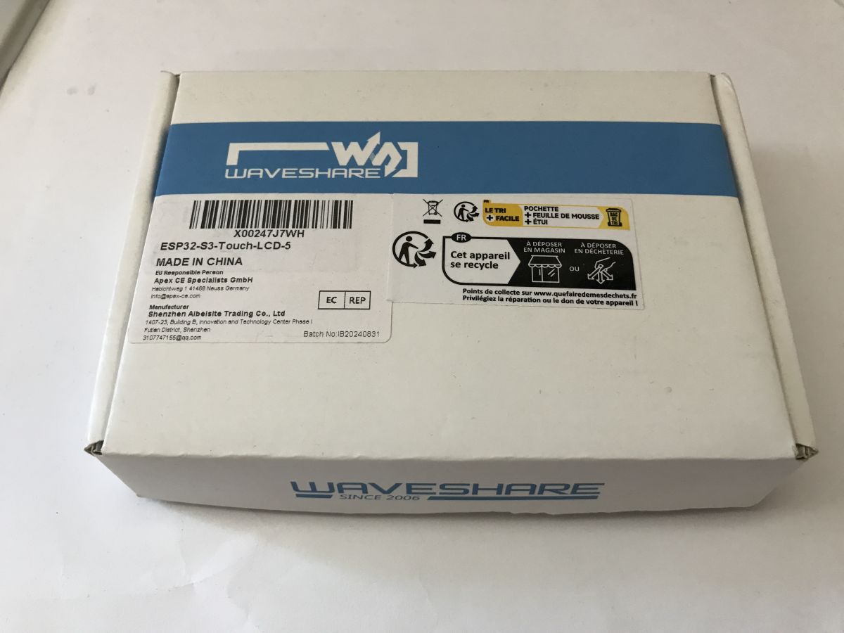

    Waveshare ESP32-S3-Touch-LCD-5 product box with visible labels and markings. 5-inch Waveshare ESP32-S3-Touch-LCD-5 touch screen in a protective box, top view. Waveshare ESP32-S3-Touch-LCD-5 development board with connectors, ESP32 module, and screw terminals, placed in foam packaging. .

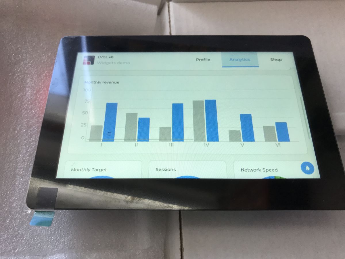

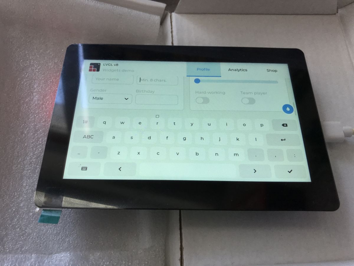

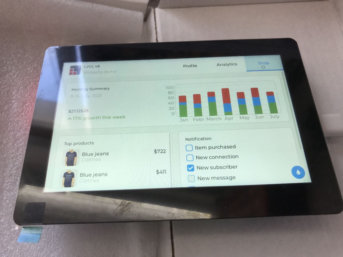

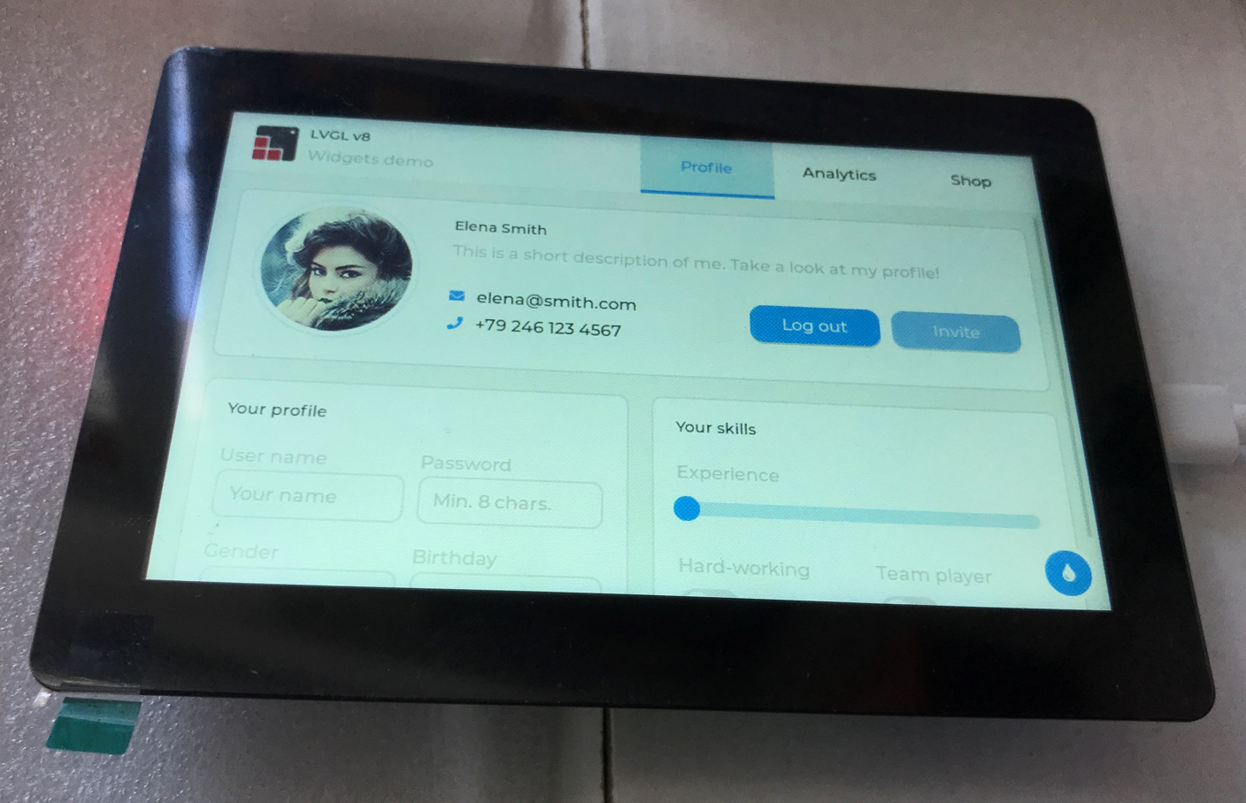

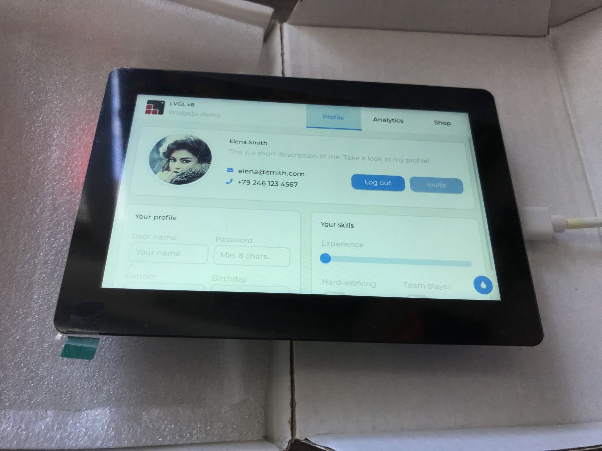

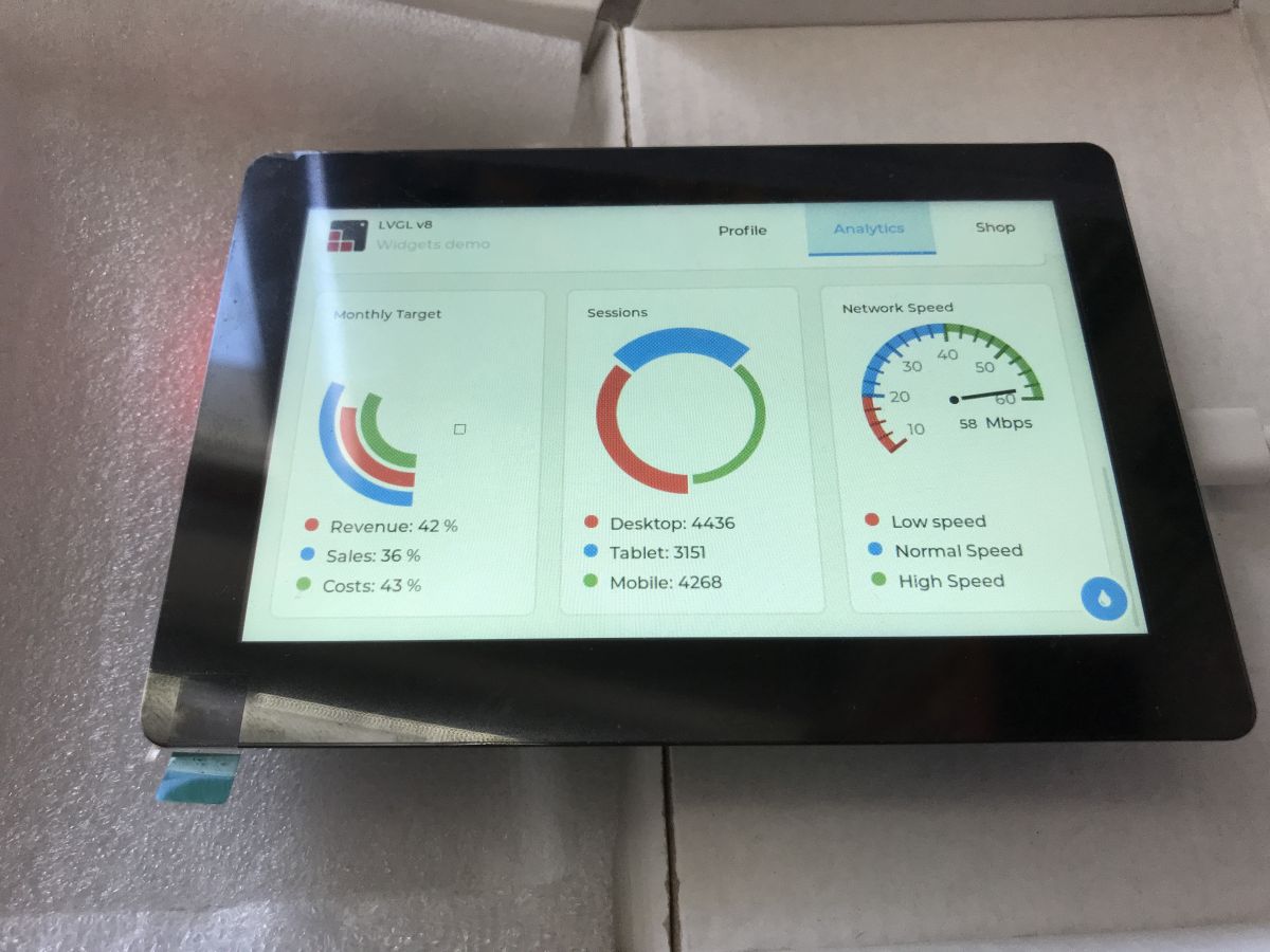

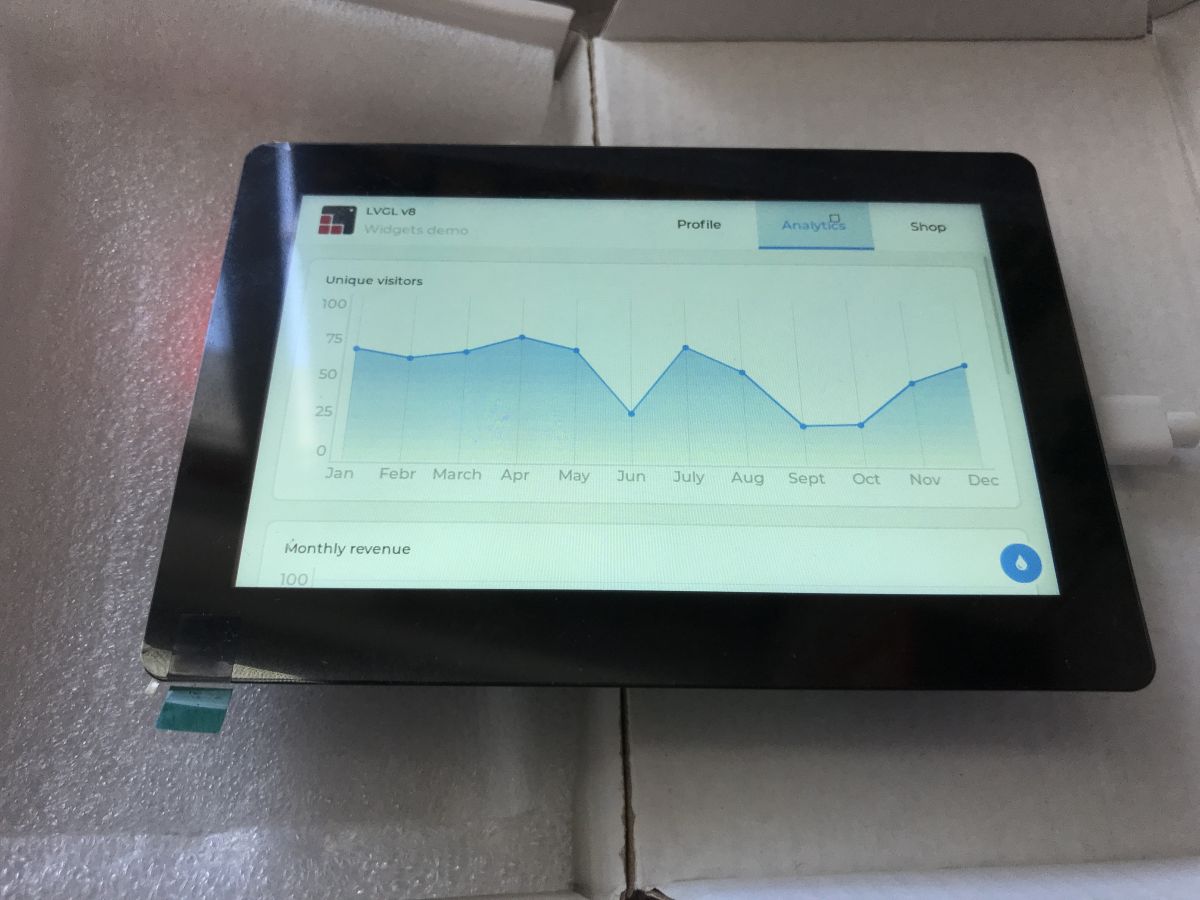

    Out of the box, we immediately have the LVGL demo uploaded. It shows the use of the various controls available in this system, it is even possible to draw graphs.
    Waveshare ESP32-S3-Touch-LCD-5 displaying an LVGL user profile demo interface. Waveshare ESP32-S3-Touch-LCD-5 showing LVGL v8 demo with an on-screen touch keyboard. Waveshare ESP32-S3-Touch-LCD-5 display running an LVGL demo with a line chart on screen. .
    Waveshare ESP32-S3-Touch-LCD-5 display showing LVGL demo with a bar chart on the screen. Waveshare ESP32-S3-Touch-LCD-5 touchscreen displaying an LVGL analytics interface demo. Waveshare ESP32-S3-Touch-LCD-5 5-inch touchscreen showing LVGL demo with charts and product list. .

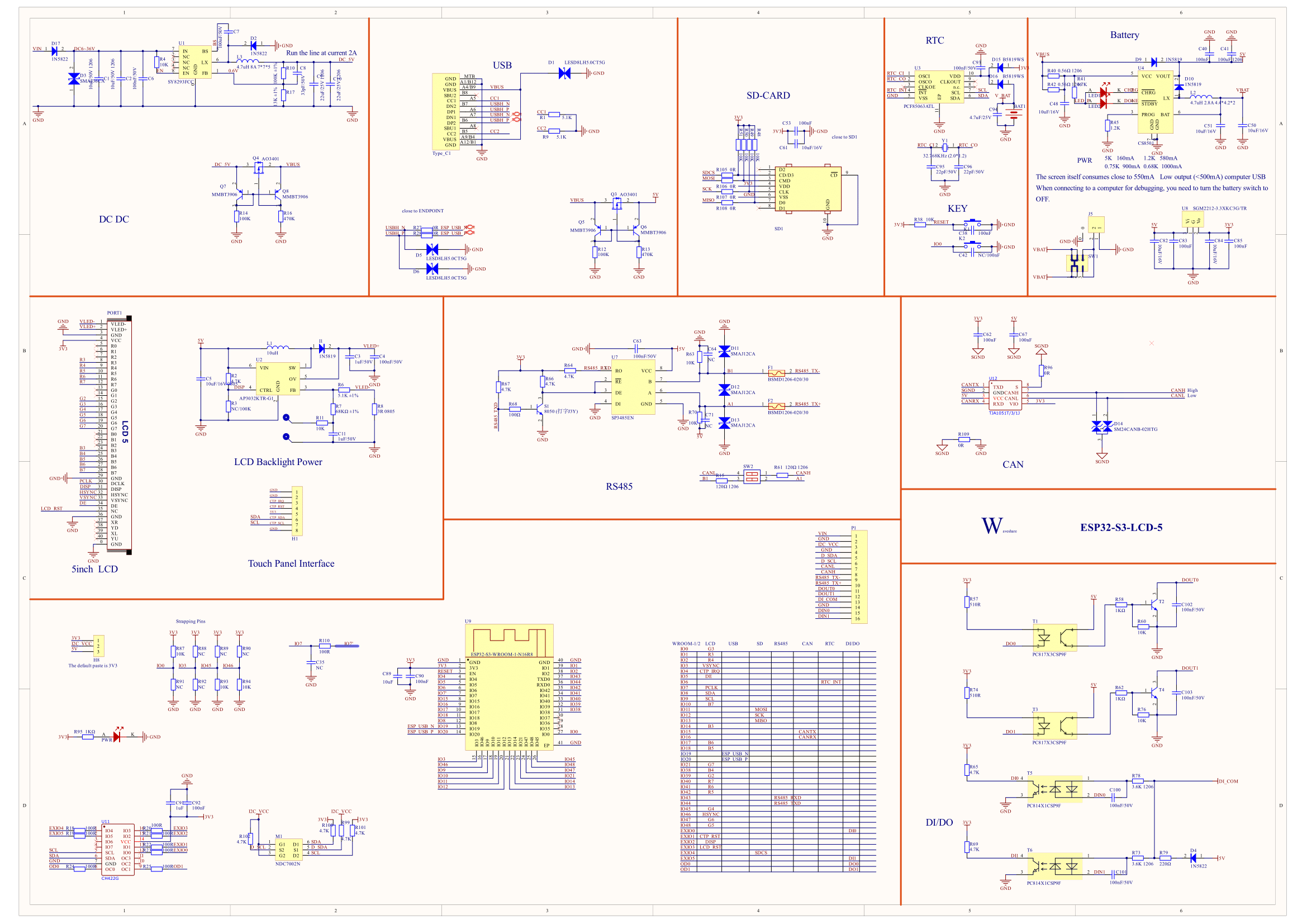

    Schematic:
    Block diagram showing connections and modules of the Waveshare ESP32-S3-Touch-LCD-5 board, including LCD, power, USB, RS485, CAN, battery, RTC, and SD slot.

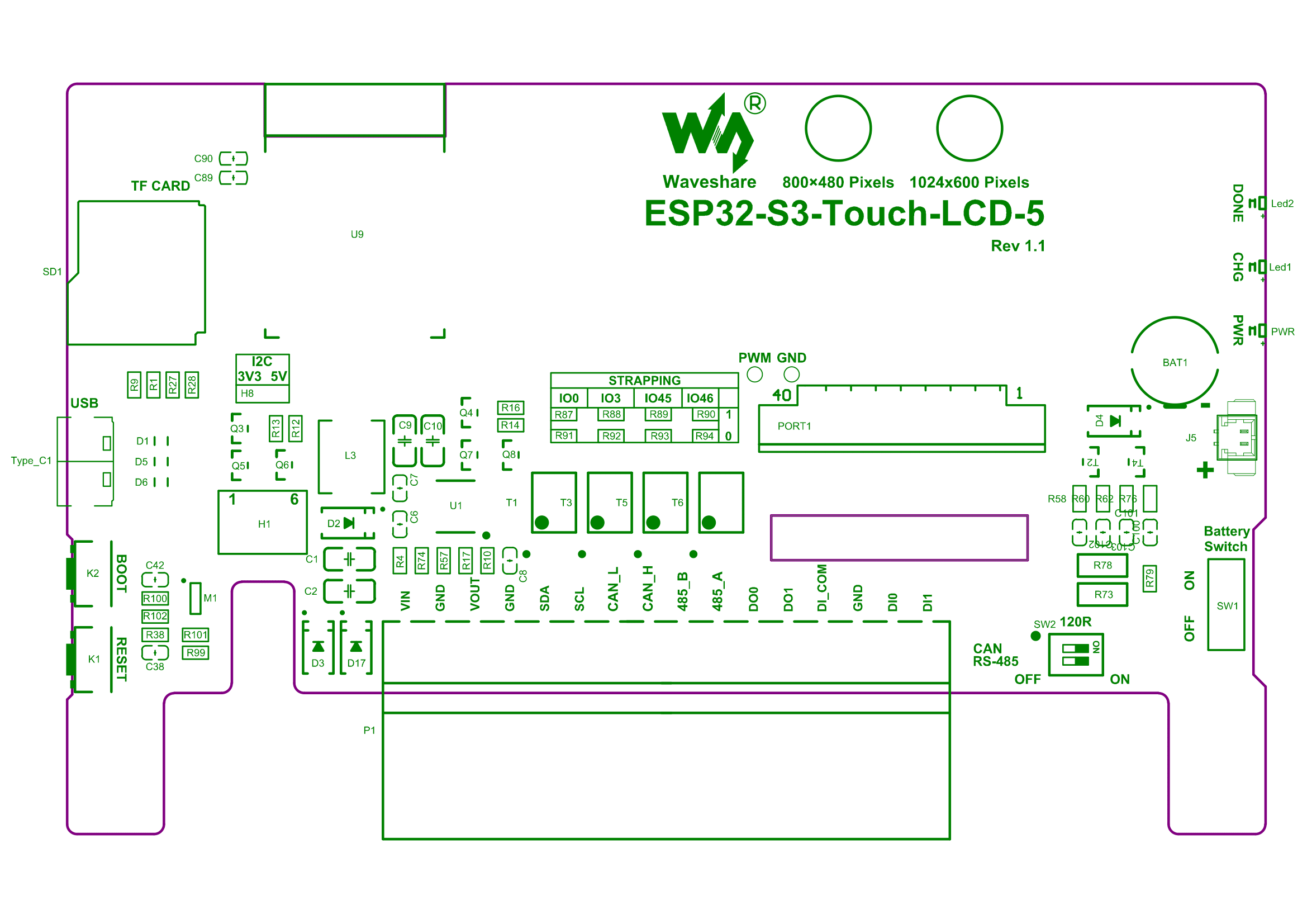

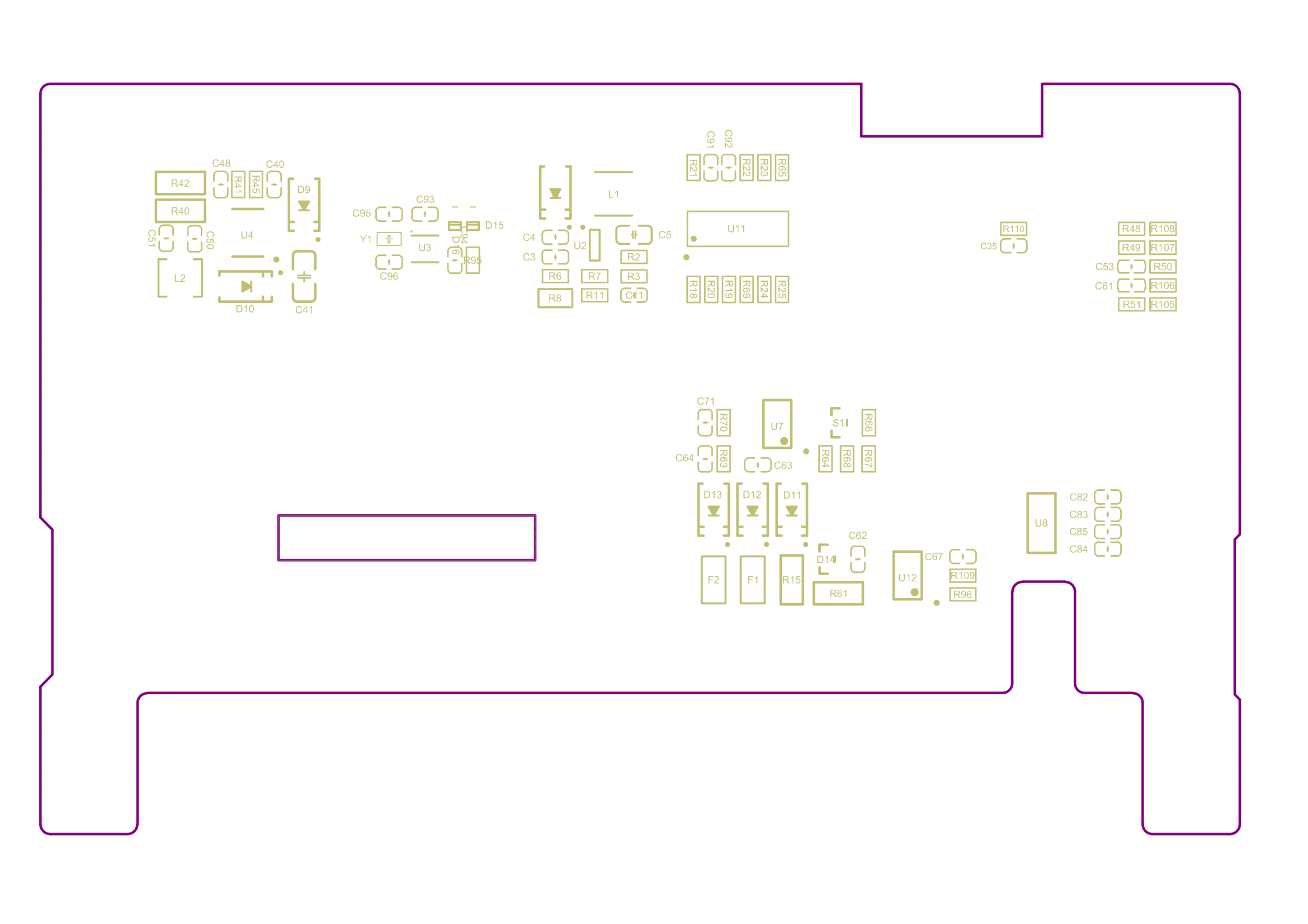

    PCB view:
    Diagram of the Waveshare ESP32-S3-Touch-LCD-5 board layout, showing connector and component labels.
    Layout diagram of components on the Waveshare ESP32-S3-Touch-LCD-5 PCB with labeled electronic components. .

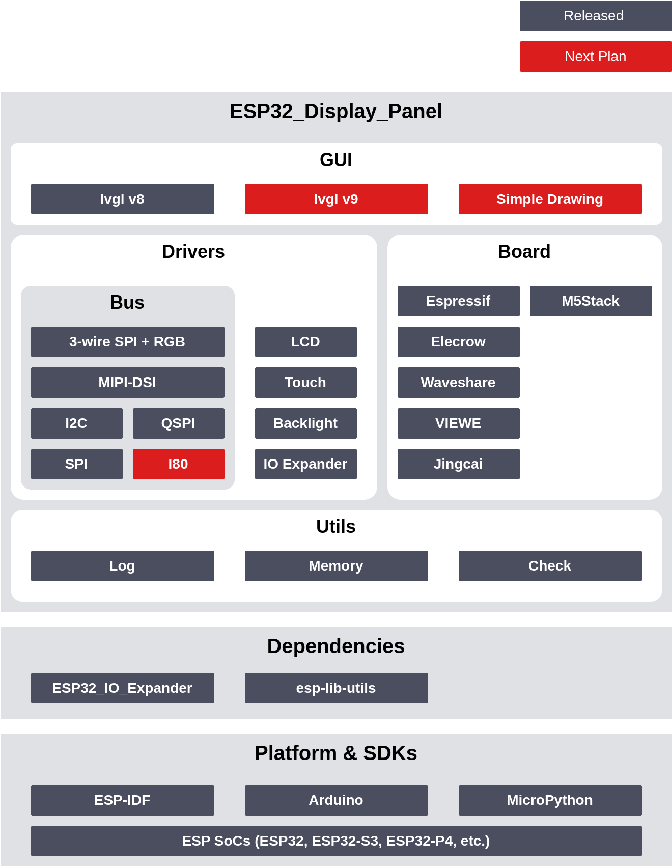

    The ESP32_Display_Panel project offers support for various display modules from ESP, and supports M5Stack, Elecrow, VIEWE and just Waveshare products. The structure of the ESP32_Display_Panel is shown in the diagram:
    Block diagram showing the software architecture of ESP32_Display_Panel with layers and supported components. .

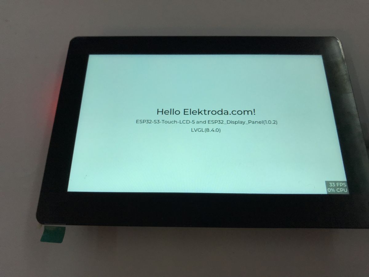

    Then you can compile and start testing by editing main.cpp:
    Code: C / C++
    Result:
    5-inch Waveshare ESP32-S3-Touch-LCD-5 touchscreen showing a welcome message “Hello Elektroda.com!” with test parameters. .

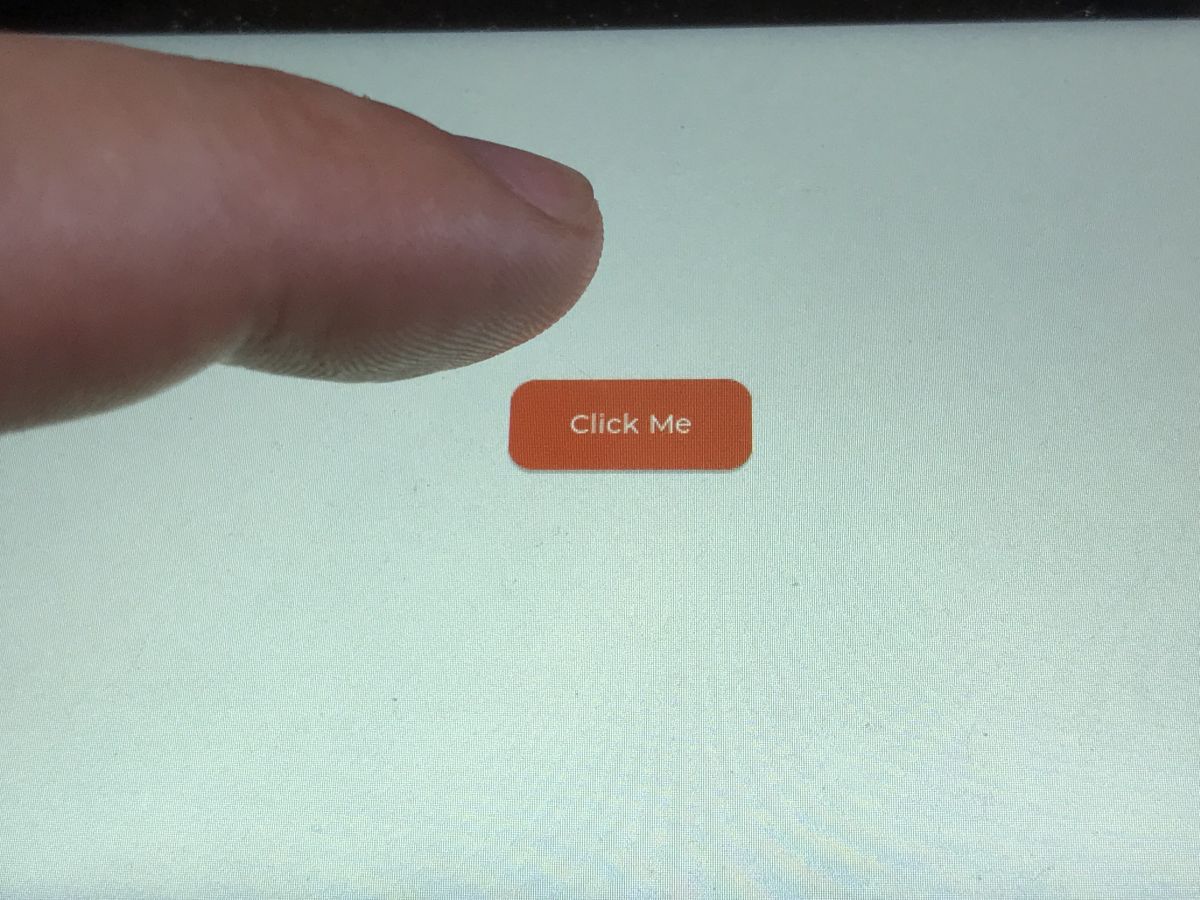

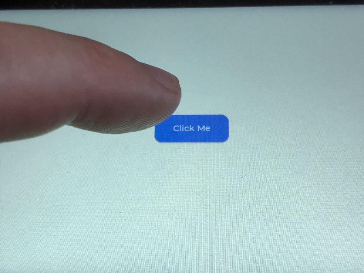

    You can still test that the touchscreen also works:
    Code: C / C++
    The above code creates a single button together with a click event handler. When clicked, the colour of this button changes.
    Everything works:
    A finger approaching an orange button labeled Click Me on a touchscreen. An index finger touches a blue button labeled Click Me on a touchscreen display. .

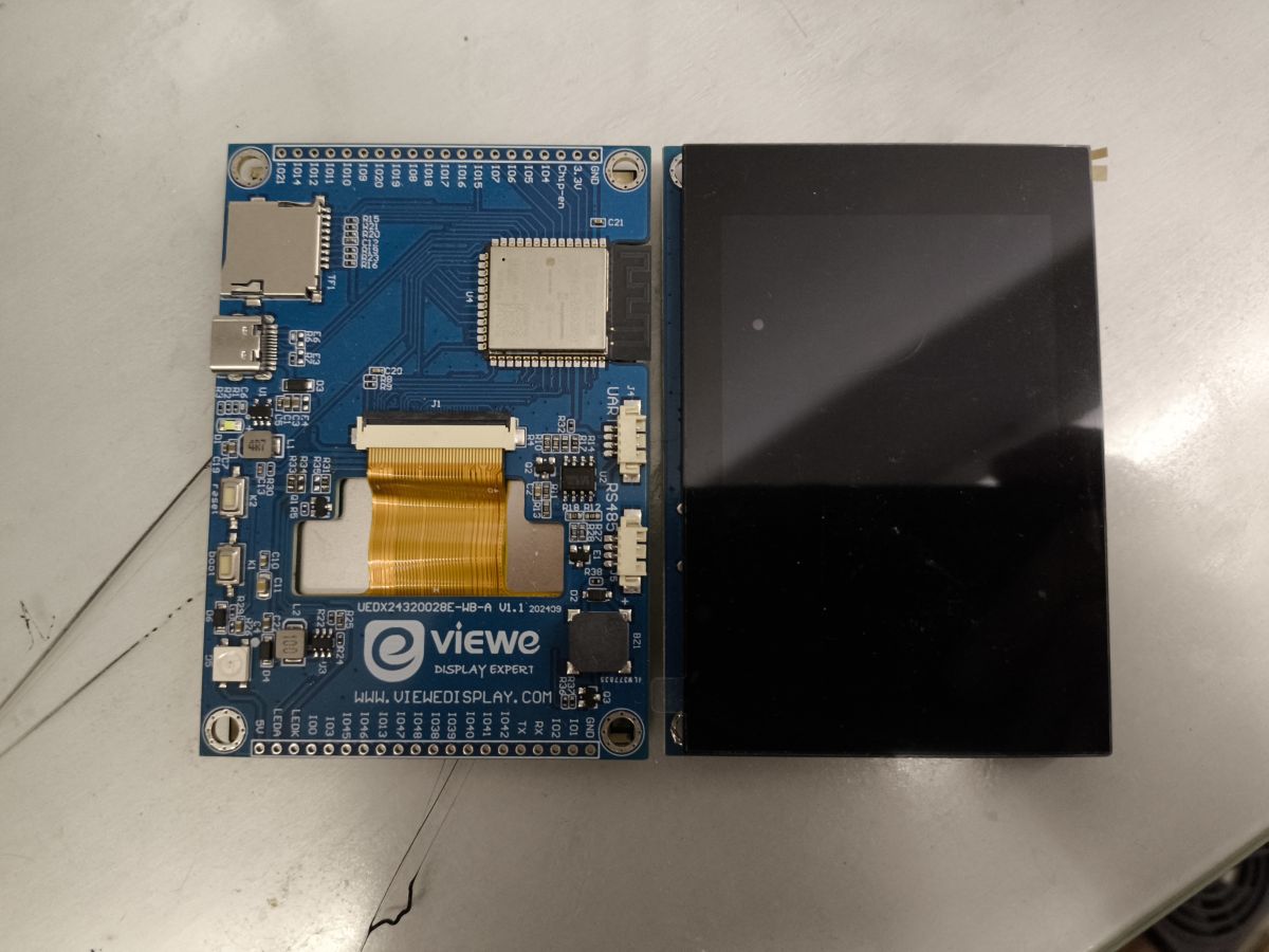

    I have 2 similar ones too, bought once from ali from coins for a few $ each. I was planning to put them in instead of switches, for HA control.
    It was also tempting to make this into a portable terminal com ;) .
    Electronic module with blue PCB and attached 320x480 touchscreen LCD display.
    There sits the same demo, s3 with ram and lcd 320x480 with capacitive touch

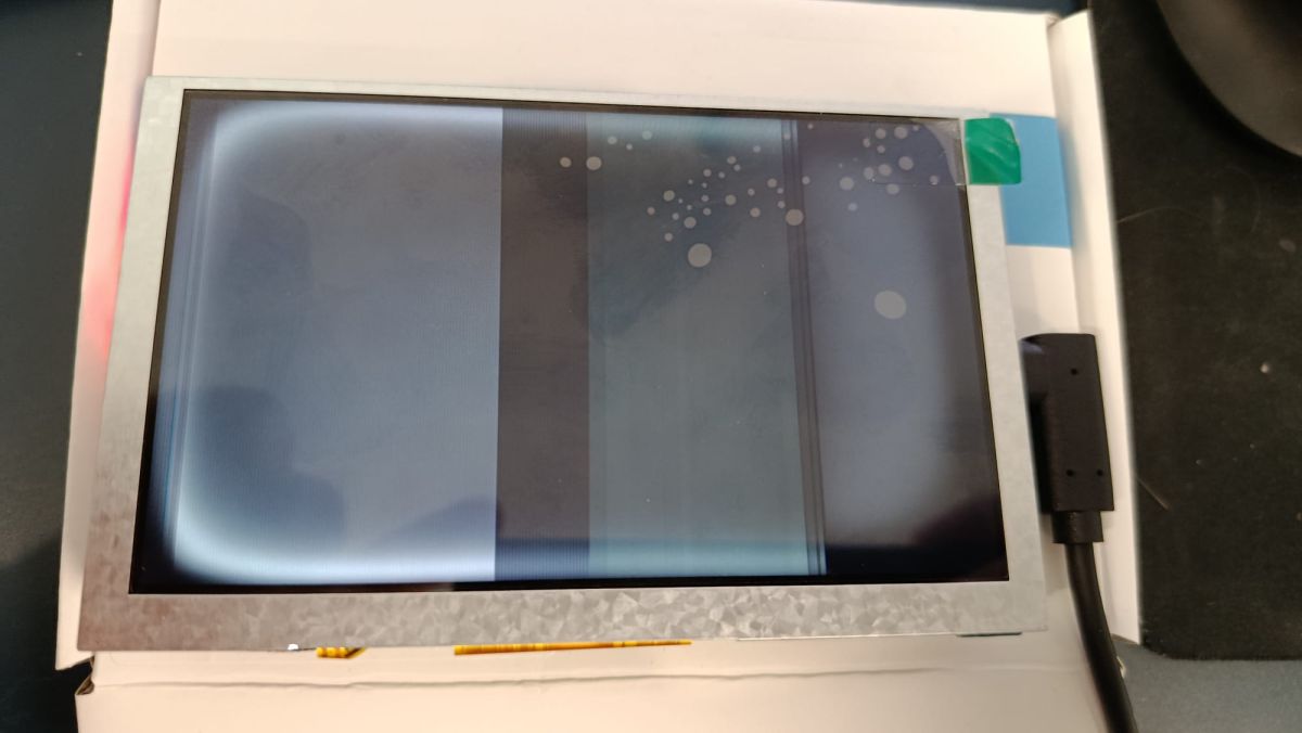

    Hi, super you describe and show it, I have had this screen for a few months, now I have decided to run it through the Arduino IDE or through PlatformIO (this is my first exposure to PlatformIO ) but I keep running into some problems.
    I can't get the plain Hello world text to display on the screen.
  • #11 21709449
    Posts: 14589
    Help: 654
    Rate: 12611
    Provide full error messages and screenshots - at what stage is the problem, what is not working?
  • #12 21709620
    dariusztomczyk54
    I managed to compile and upload a sample program from Waveshare : 08_DrawColorBar.ino to the board - it took an awfully long time through the Arduino IDE.
    Previously I was getting an error - error 1 and nothing else, I got this error when I had the board selected in the Arduino IDE as ESP32-S3 Dev Module, when I changed the board in the Arduino IDE to Waveshare ESP32-S3-Touch-LCD-5 - the compiler copies for 10 minutes and finally uploads, but the screen at this point looks like it's broken.
    Waveshare ESP32-S3-Touch-LCD-5 - Wi-Fi, BLE, CAN, RS485 and 800x480 touch screen .
    I have now run the simple_port.ino compilation from ESP32_Display_Panel's github.
    Added after 10 [hours] 3 [minutes]: .
    I managed to upload a working example project : 08_DrawColorBar.ino and it displays as it should, unfortunately trying to upload anything from SquareLineStudio, it dumps me errors :
