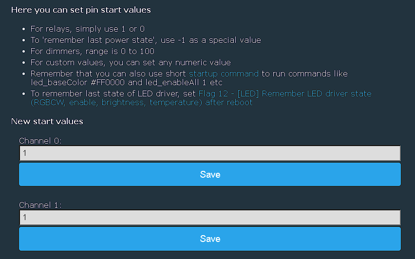

    Hello, I have a relay switch, Use BL602 as its MCU.
    Every time the device is powered on or rebooted, it will turn on the switch first and turn it off quickly.
    I want to disable it so that every time the device is powered on or restarted, it defaults to the off state, or remember the last state. What should I do?
    Because I now have a problem, when the device is connected to the WIFI, but the WIFI does not have the Internet, due to the watchdog mechanism, the device will repeatedly restart and switch the relay state, which bothers me.

    OBK template
    "vendor": "Tuya",
    "bDetailed": "0",
    "model": "enter short model name here",
    "chip": "BL602",
    "board": "TODO",
    "flags": "10",
    "keywords": [
    "TODO",
    "TODO",
    "TODO"
    "pins": {
    "2": "TglChanOnTgl;1",
    "14": "LED_n;1",
    "20": "Btn;1",
    "21": "Rel;1"
    "command": "PowerSave 1",
    Added after 9 [minutes]:
    Screenshot of the relay channel startup settings.
    I have tried to change the value of Channel in config startup, which is not valid.
    The picture shows that the device has been turned off by default, and the device will be turned on once after it is powered on and turned off immediately.
    If I change it to 0, the device will be turned on once after it is powered on, then off, and on again.
    #2 21121848
    Posts: 14770
    Rate: 12913
    This sounds like an internal BL602 SDK bug. We need to investigate app and SDK code for the possible issue.
    @miegapele , you seem to have some experience with BL602, do you have any ideas where to look for?
    As a quick solution, you could just move relay to another pin with a jumper (change the hardware connection, solder a wire)
  • #3 21121951
    gzq127981
    Posts: 9
    >>21121848
    I burn the firmware of ewelink for the device, it is normal, this problem will not occur.
